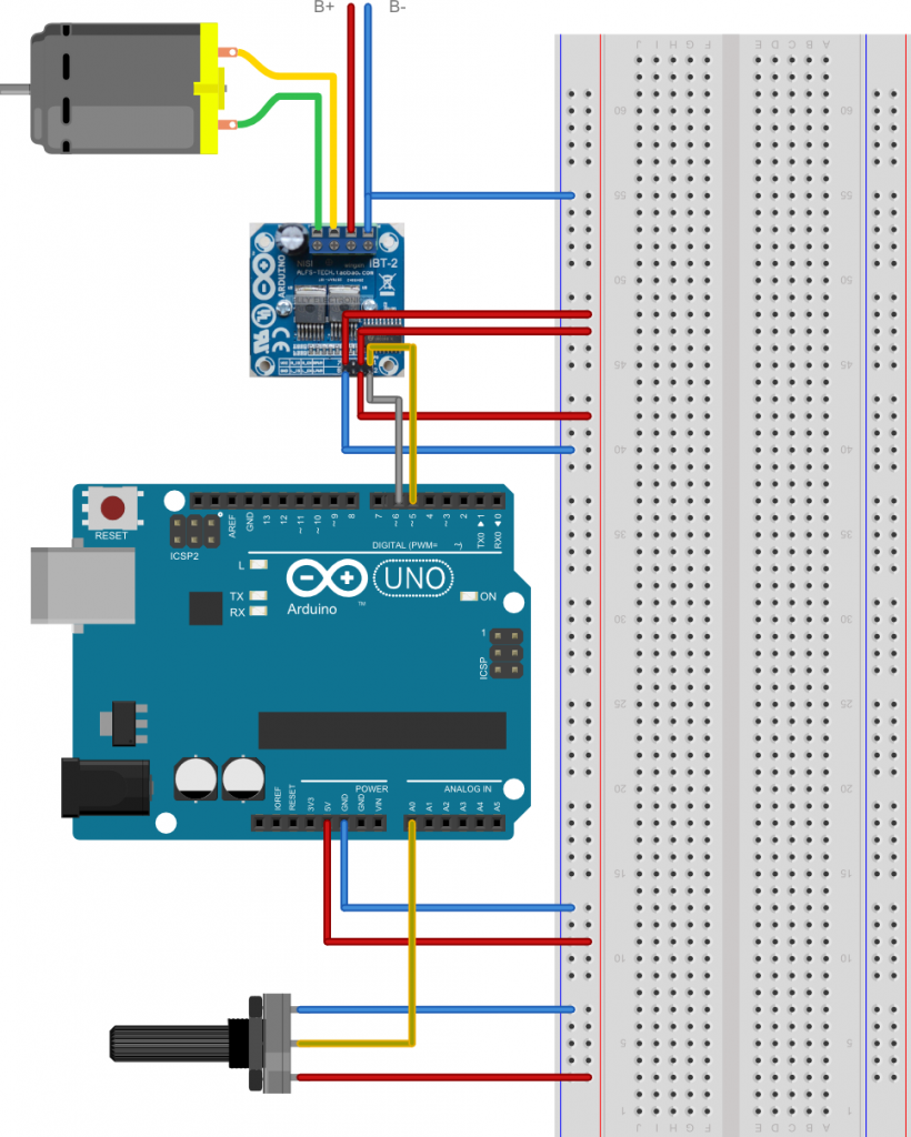

    Bear with me man, all my knowledge of motor driving is through RC servo boards..these are my first hbridges.

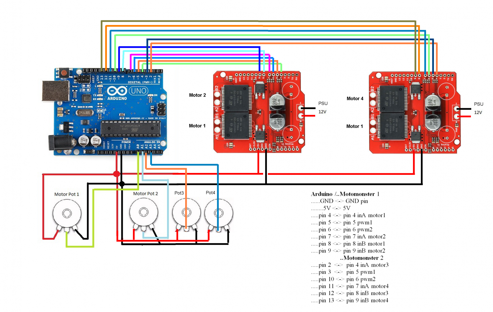

    Well I found an arduino sketch Racing Matt posted for 2 directional pin hbridges. I uploaded it and started with my wiring when I noticed the diagram he had showed the 2 pins for direction and an additional two pins for pwm control. I have everything wired up as shown in the diagram below with slight adjustments to the directional pins to match up to Racing Matt sketch, so my problem is I lack the additional two pins for pwm control. I went back and read through your posts about how all you need to do to make a closed loop system is to use the analog function sketch, and that other people use more elaborate sketches for "stand alone" control. I'm guessing maybe this is what Racing Matt did? Can you shed some light on this for me. And given the diagram on the bottom that i manifested what do you think would be the easiest way to get things working with simtools? The diagram on the top 2motomonster.png is the one Racing Matt has listed IBT-2-with-Arduino_bb-820x1024.png
  19. Kirk
    Kirk Member
    May 19, 2014
    91
    Sr Software Engineer
    Texas
    15,087Coins
    +114 / 2 / -0
    2DOF, DC motor
    I'm at work, so I can't verify this at the moment, BUT, I believe you can get by with a single PWM pin and use the two Enable pins as direction pins, rendering it pretty much identical to (half) a monster moto and even use the exact same sketch.
    To control 4 motors (as with the upper graphic), you'll need 4 of the IBT-2 boards.
    Arduino: | IBT-2 (board #1)
    5 (pwm1) | 1 (RPWM)
    4 (inA) | 3 (R_EN) (forward)
    8 (inB) | 4 (L_EN) (reverse)
    Arduino: | IBT-2 (board #2)
    6 (pwn2) | 1 (RPWM)
    7 (inA) | 3 (R_EN) (forward)
    9 (inB) | 4 (L_EN) (reverse)
    Arduino: | IBT-2 (board #3)
    3 (pwm1) | 1 (RPWM)
    2 (inA) | 3 (R_EN) (forward)
    12 (inB) | 4 (L_EN) (reverse)
    Arduino: | IBT-2 (board #4)
    10 (pwn2) | 1 (RPWM)
    11 (inA) | 3 (R_EN) (forward)
    13 (inB) | 4 (L_EN) (reverse)
    Obviously, for each of the IBT-2 boards, connect
    7 to VCC and 8 to GND. (they are 5V parts).
    The green connectors on each board: + / - go to your 24V power, and M+ / M- go to your motors.
  20. kimballfount
    kimballfount Member
    Oct 12, 2015
    88
    greer,sc
    879Coins
    +15 / 3 / -0
    No motion, Should I try attaching the LPWM to the RPWM on pin five?
