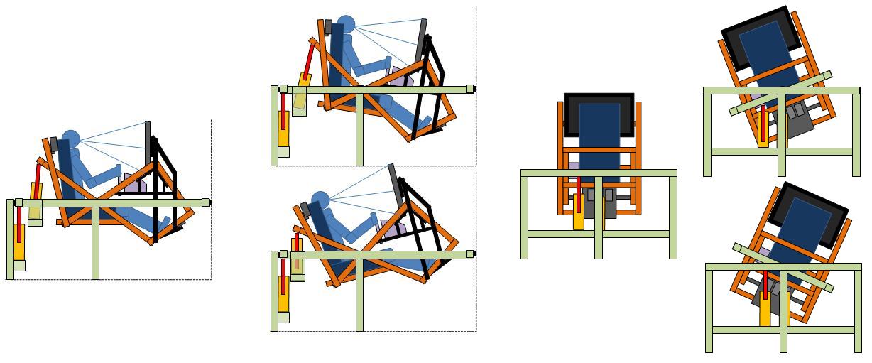

    Hello bvillersjr,
    Thanks for your answer, I have already found your webside (really great) but unfortunately I dont know how this squares with the delivery to Austria or control with the duty and taxation .... so I do not dare to order.
    I would be interested especially for your motion starter kit but I'm not sure whether the actuators are suitable for my design? According to my calculations I would need a force of min. 500N and speed of 100mm/s especially, I fear that the stroke of the actuators (150mm) is not sufficient.
    maybe you'd even sell only the control without actuator? I wonder whether that is to use actuators instead of windshield wiper motors ...? Perhaps I would use wiper motor instead of actuators.
    Sure you know the simcraft 2dof wood construction. I think I would imagine my simulator also.
    Thx :)

    @Puma
    For your case, I would suggest the SCN6 given that the details of your design can accomodate it. Since you are planning to move the wheels and pedals also, I would suggest more than 100mm /sec!! When you move the wheels and pedals, you need to move at much higher speeds to achieve a realistic feeling IMHO.
    If properly implemented, the SCN6 actuator may work for you. I can provide SCN6 actuators as well. You can find the specificatrion of an SCN6 in this document:http://www.simxperience.com/LinkClick.aspx?fileticket=xTZlrfT-mtY=&tabid=135&forcedownload=true. I have not added the SCN6 to our website yet but I can perpare a quote for you. I am not an expert in shipping to your country, so I cannot comment on duties, etc.. FedEx claims to offer a service that pre-prepares all of this paperwork so that costs are known up front. I have not used this service from FedEx before, but I examine it to see if it may help you.
    In a few weeks I will update the website to sell the electronics separately.
    :cheers:
