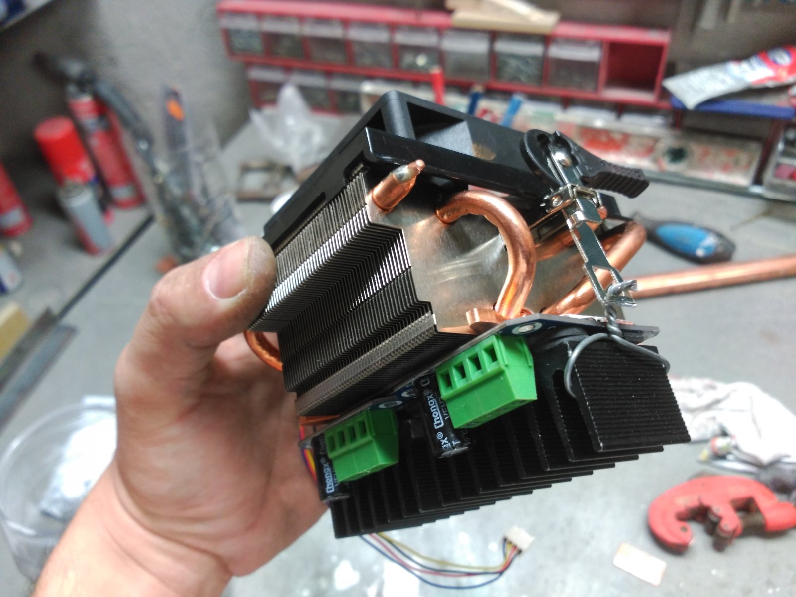

  15. evolaco
    evolaco Member
    Sep 27, 2015
    264
    Spain
    694Coins
    +29 / 0 / -0
    http://s.aliexpress.com/f22MZ32M?fromSns=Copy to Clipboard
    if you use a pc cooler do not get hot

  20. minimus1899
    minimus1899 Member
    Mar 7, 2016
    65
    retired/broken/falling to bit
    lincoln
    163Coins
    +58 / 1 / -0
    Is mounting it to the dboard and to what ever it going on hard? With the fact it’s a funny shape ?
