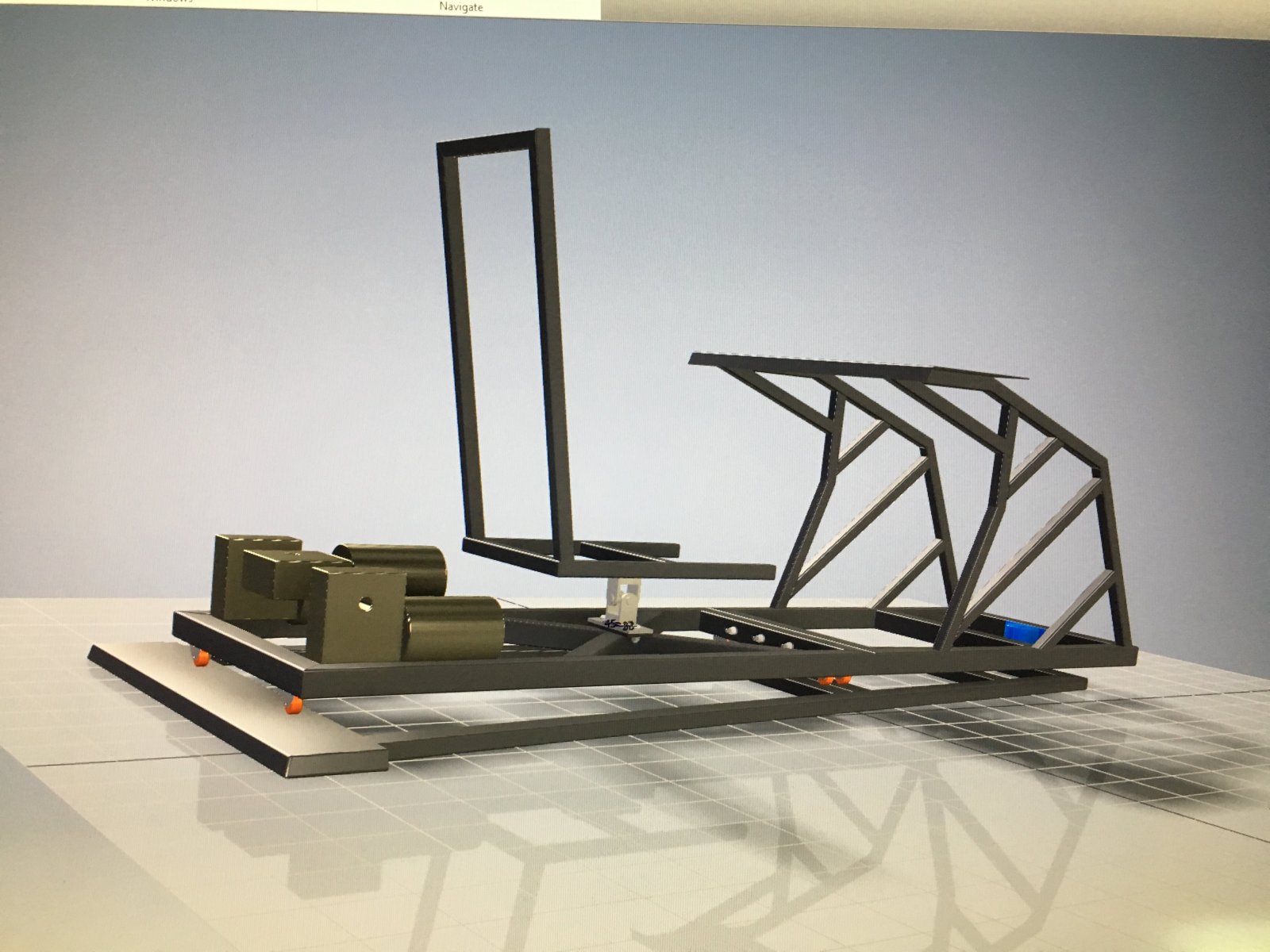

    New Sim.jpg Hello chaps, I'm just starting a 2DOF motion simulator, maybe with traction loss for iRacing and AC predominantly. I've decided on a seat mover setup as I have a CV1 and I understand that the relatively small motions of a seat mover do not cause issues in VR?
    As you can probably tell, I'm not 100% sure on all of the specs of the simulator yet but I'm making this post now to welcome input so I can make more informed decisions before I get too far in!
    So far the plan is:
    • JRK12v12 Controllers
    • 12v DC Gear motors - Very hard to come by in the UK, would appreciate advice! 25:1 or 50:1?
    • I like the Battery Idea rather than going for a big power supply, any disadvantages with the battery setup?
    • If I were to include rear traction loss, would I need to mount the Rift sensor on the pivot point at the front of the rig or can it stay off it?
    I haven't even looked at the Simtools software yet, is it worth doing that before buying parts?
    Many thanks, Peter.

    Spend whatever time needed to research your build and wrap your head around how it all goes together.
    Generally speaking with fast and accurate small axis movement sims you won't notice the lack of motion cancellation but we also now have the option to use motion cancellation: https://www.xsimulator.net/community/threads/vr-motion-cancellation-time-to-test.10241/
    You can have a play with SimTools prior to starting your project using the demo version of Live For Speed and this 2DOF simulation program: https://www.xsimulator.net/community/faq/simulating-a-2dof-simulator.278/
    Batteries can work fine and are less sensitive to peak power spikes.

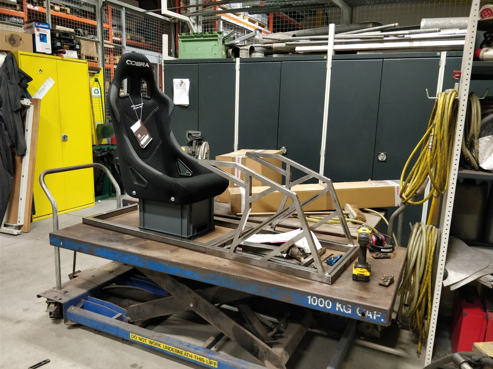

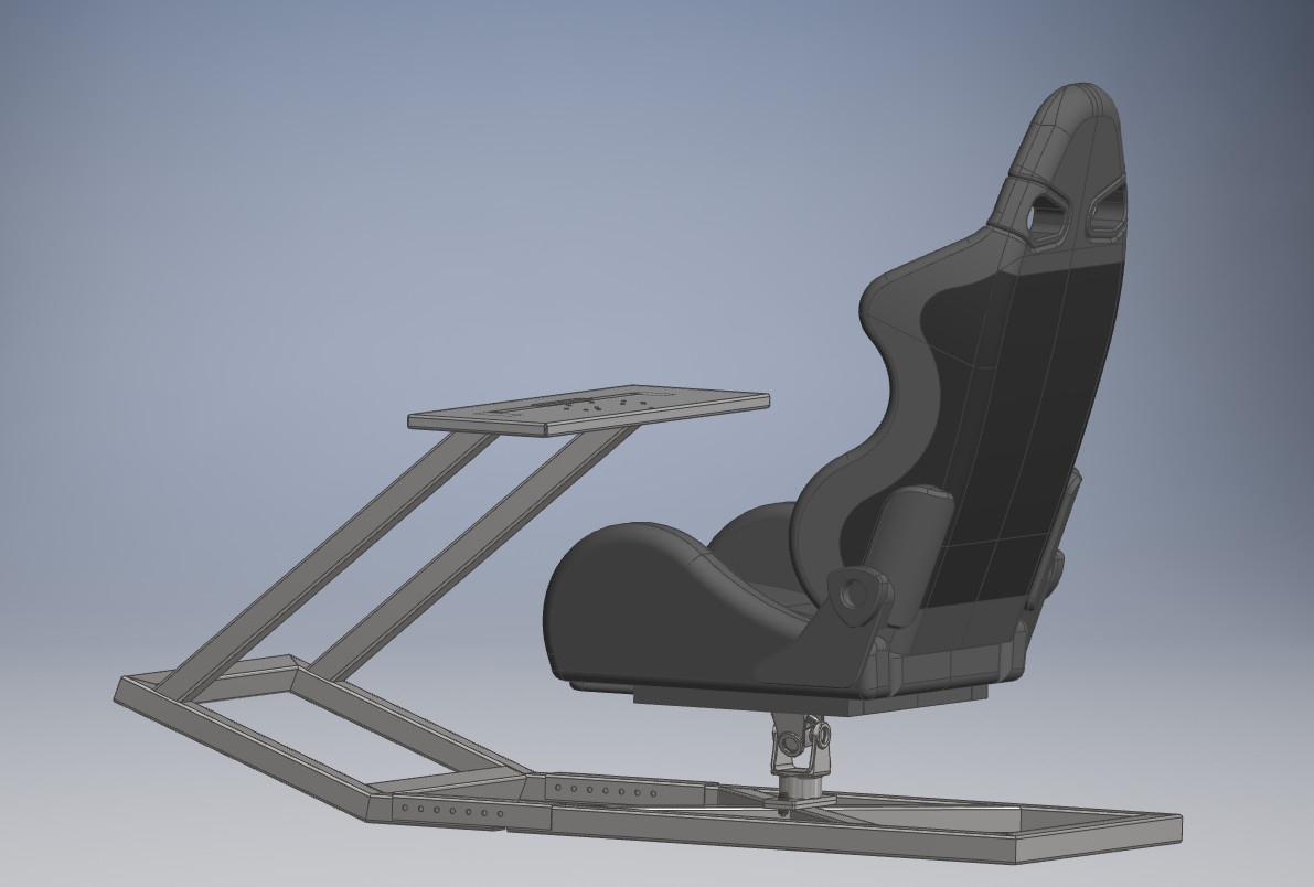

    I've been a bit slow to update this but I pretty much finalised the frame design and have begun building. No real problems as of yet, still waiting on the motors - hopefully will have them by the end of next week. Once I have those I can start playing with the electronics side. Hoping to house it all in a neat sheet metal box. Not sure if I'll have the space to mount it on the rig yet.

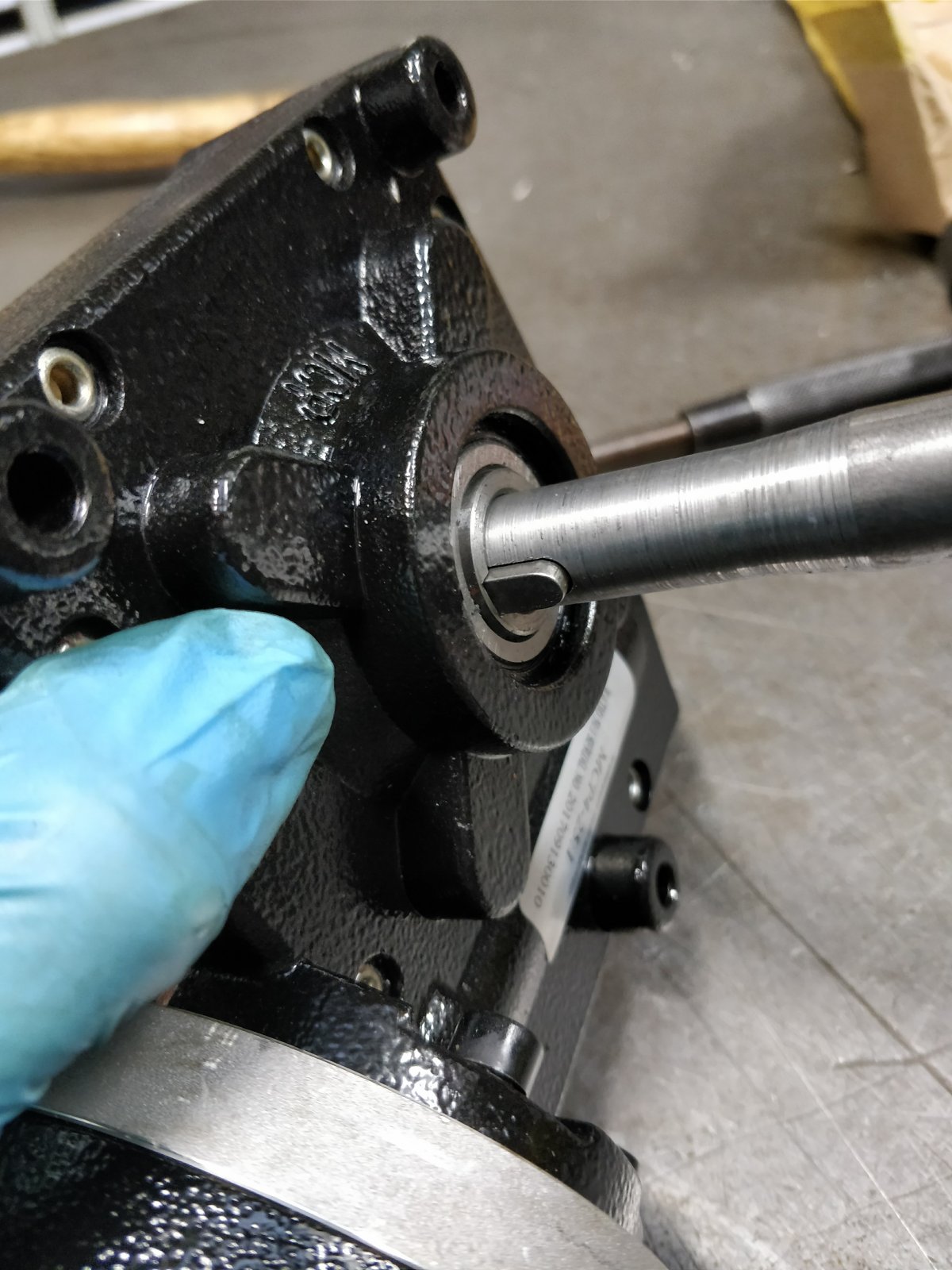

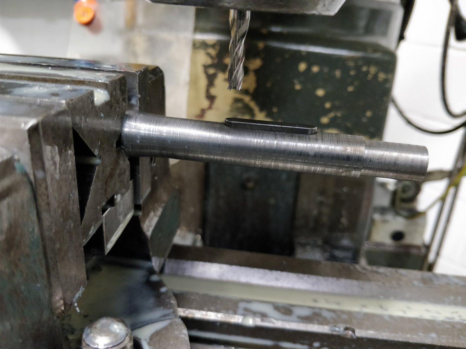

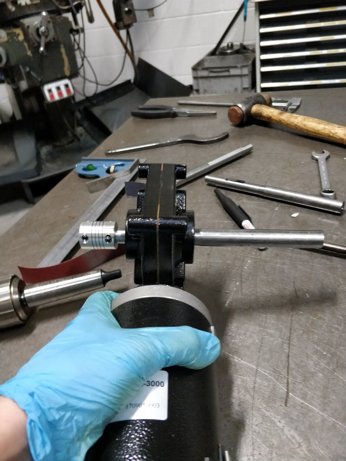

    Just a quick update, turned and machined the shafts for the motors today (Motion control products ZYT90 155-12V 3000rpm 25:1) IMG_20171220_151125.jpg IMG_20171220_151213.jpg IMG_20171220_151301.jpg IMG_20171220_151322.jpg

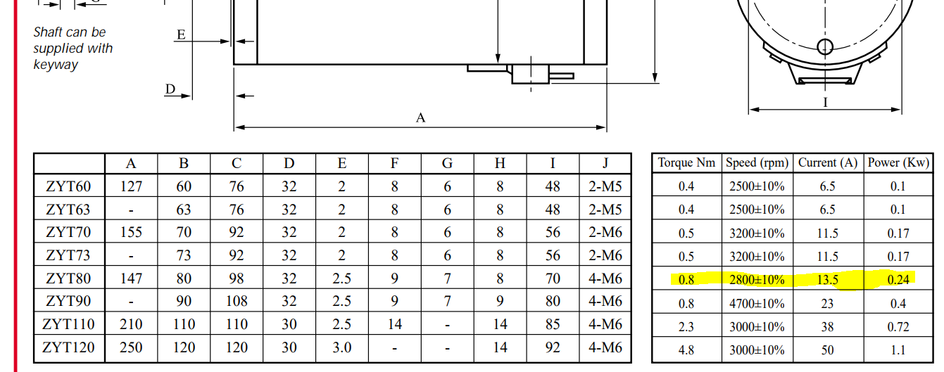

    I've been a little late noticing your thread, but I see that you went with the ZYT90 motors, do you know how many amps are they drawing?
    I had these:
    90ZYT-155-12-MCP4 - 250W 5000 RPM 25:1 ratio
    Rated Voltage: 12v
    NoLoad Speed: 5000 RPM - 200 RPM with 25:1 gearbox
    Current (Peak): 23A
    Nominal Power: 250W
    And I had troubles with them and JRK's, with JRK's not being able to handle that power. AFAIK Jrks can handle around 30-35 amps with good cooling, but these motors were drawing more amps causing Jrks to produce motor driver errors and erratic / stall movements.
    I remember somebody else here had the same problems - @Avenga76 , he needed switching to 60:1 ratio boxes and slow down the motors so the JRK's could handle it.

    Hi! Hugely useful thread there, unfortunately I hadn't read it before buying the motors! I wasn't provided with a data sheet for the specific motor I have, I found the guy advising from Motion Control Products pretty unhelpful if I'm honest. My options were quite limited on motors, I was going to get the PG saw ones but then saw these on eBay and thought I'd have a try since they're from the UK. I do have the 3000rpm version with the 25:1 box, looking at this data sheet it states that my current should be 13.5A rather than the 23A yours were.
    If that's right or not I don't know! I'll keep my fingers crossed, @Avenga76 's thread shows that there may be some way to get it to work if I hit problems so I think I'll stick with them and see how it goes.

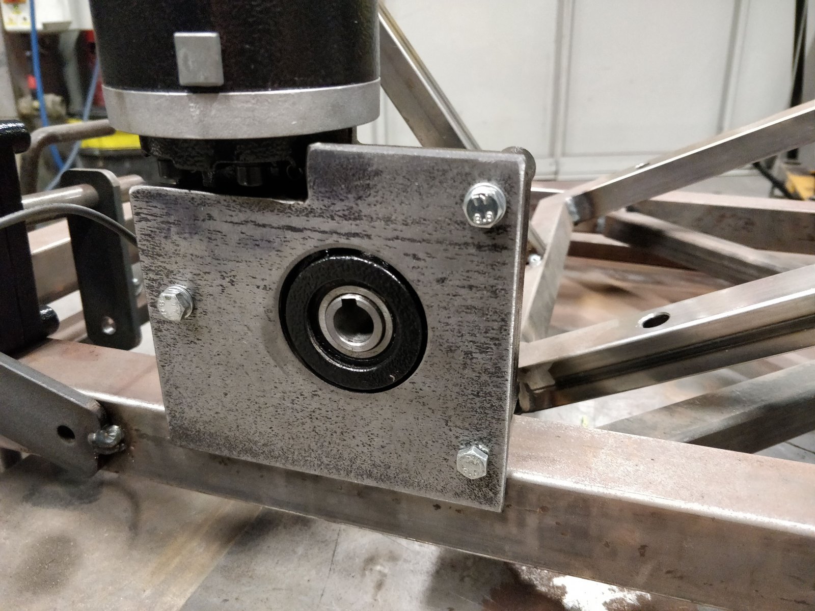

    I first built some sturdy motor mounts from 6mm plate, had to drill a 5omm hole so they would sit flush against the motors mounting holes.

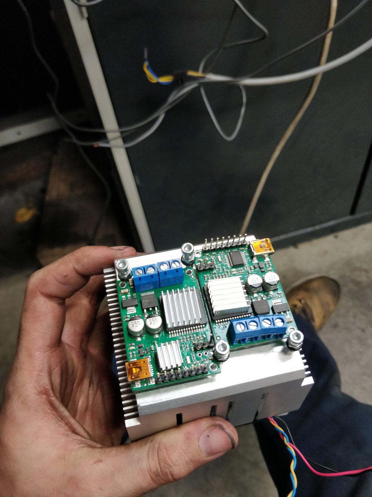

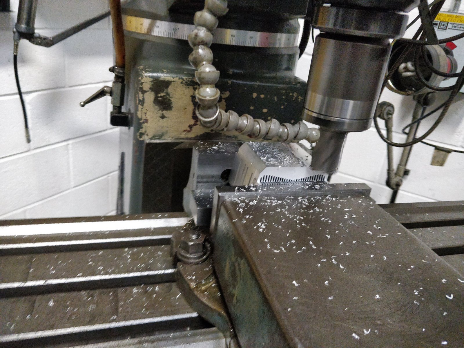

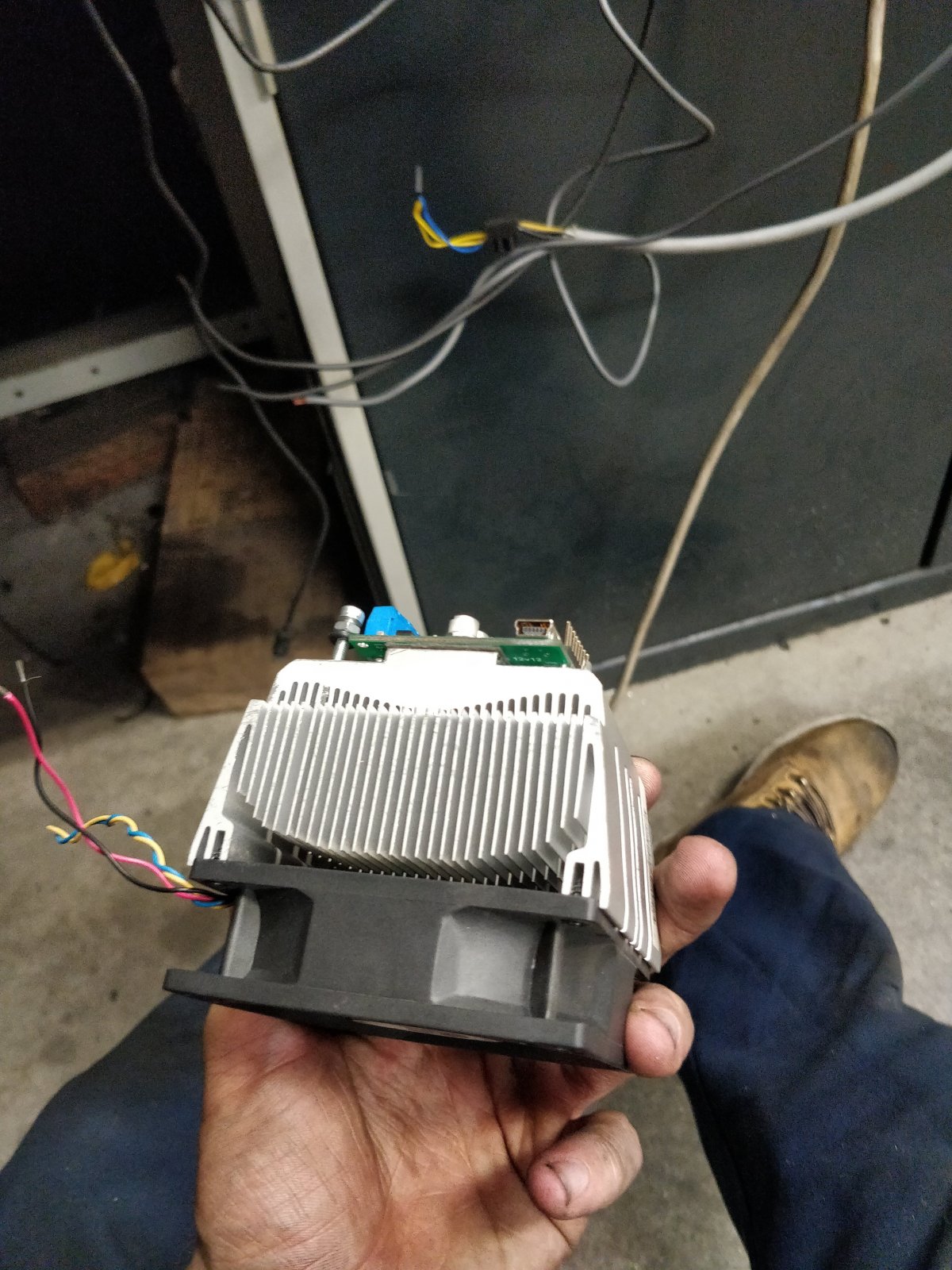

    I bought an old AMD processor heatsink and fan to modify to cool my JRKs. I opted to mill the heatsink away to provide a relief for the soldered connections which protrude from the bottom of the board, leaving a flat surface in the middle for good contact.
    I did fail to follow the JRK setup guide the first time I tested and blew a JRK as I had not set up anything in the configurator. This has made for a useful reference PCB for wiring though :p

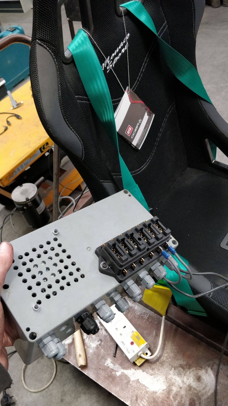

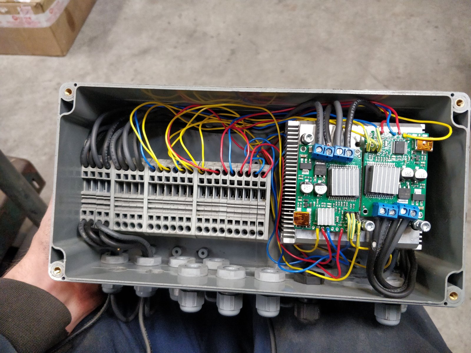

    Having finally found a power supply setup that worked I've now started to finalise the wiring. I found an old electronics box with din rail terminals already installed. I took half of them out to make space for the JRK/heatsink assembly and drilled some holes for ventilation. The DIN terminals meant that I could solder wires directly to the JRKs but still be able to unplug the potentiometers etc in case of a failure. I also have routed the motor power to and from the JRKs through the DIN terminals, I may have to change this as I've just read that the terminals I'm using are only rated for 24A. Looks tidy though! On the back of the box, I've mounted a fuse box for the power in to protect the JRKs from 30A+ and me in case something shorts. I'm going to be wiring up a panel for displaying the JRK staus and allowing quick resets from my seats thanks to @Archie 's guide.
    I think that's about it for now! I will apply for my simtools license now and press on with the last things I need to do which are:
    Finish wiring box and figure out how to wire in an E-stop (any advice appreciated)
