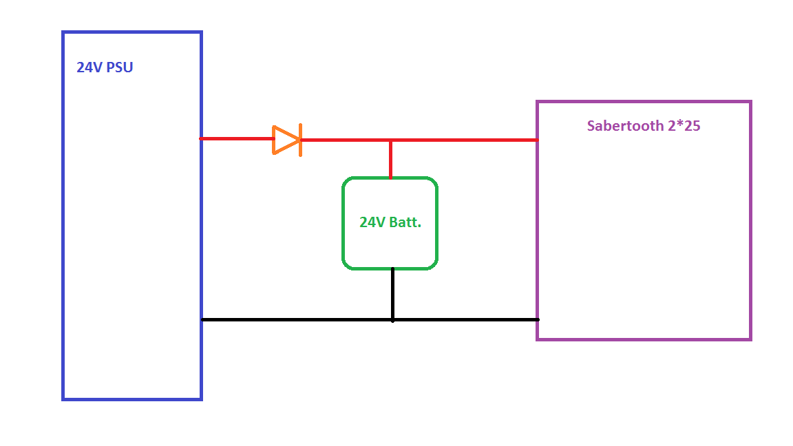

    So I have done the first tests with the DC wipers in 24V with the sabertooth, using pots to drive the wipers.
    I have an issue with the sabertooth: its regenerative function makes the PSU not happy : they enter security mode at some point of time. I thought of adding a diode to prevent current being sent to the PSU but dimensionengineering advised I shouldn't as it could damage the sabertooth which. They said I sould put a battery in parallel to "buffer" the regenerative current. http://help.dimensionengineering.com/knowledgebase.php?article=2

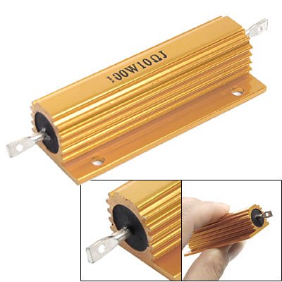

    you can use a battery or maybe a power resistor to dissipate the current? like on our DIY wheels

    Hum. Looks a good idea :) How do you wire it so it gets involved only to sink the current the DC motor is sending back ?

    With the new 2x32 2 power resistor (10W) are delivered by dimension engineering ! But this new version have 2 more pins especially for the resistors...
    Battery seems to be the best practice.

    yes, when it's possible to use dissipating resistors, you have to look into the specs for the dedicated pins.

    Well well well.... I opened a ticket with dimensionengineering, and we came to the conclusion that the diagram attached should be OK.
    I also asked them for a swap from my 2*25A which I ordered some weeks ago for a 2*32 which is at the same price, with many many more features (looks like a JRK , no ?). And they said YES !
    So I'm sending back my current sabertooth which will take some days, allowing me to build the rig in the mean time.
    V.

    What will keep the PS from possibly overcharging the battery?
