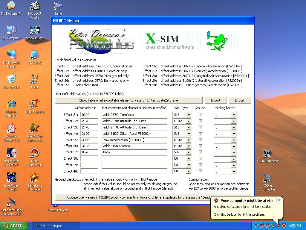

    I was busy with other projects. Now i am back with my simulator. But i ve problems now.
    Now i have nearly build whole body.
    I am trying to send data to amc board
    In LCD
    128 128 560 401
    24 PWM v1.0 SFGT
    I can take feedback from pots. The right side values are changing. But the first two X and Y axis values are always same.
    I cant send data to them. In AMC_video_guide_part4 video tronicgr use x-sim v1.8, i have the newest one and its a bit different.
    Anyone can suggest me what to do ?
    Not: The problem has been solved. I was using 24mhz osc changed it to 18 and the Hex in it. But still at first run i connect 14 then shut and change back to 18.... When only i do these everything works :)
