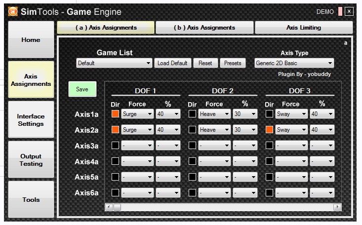

    Have you created an Axis Assignment for LFS, as that is required.

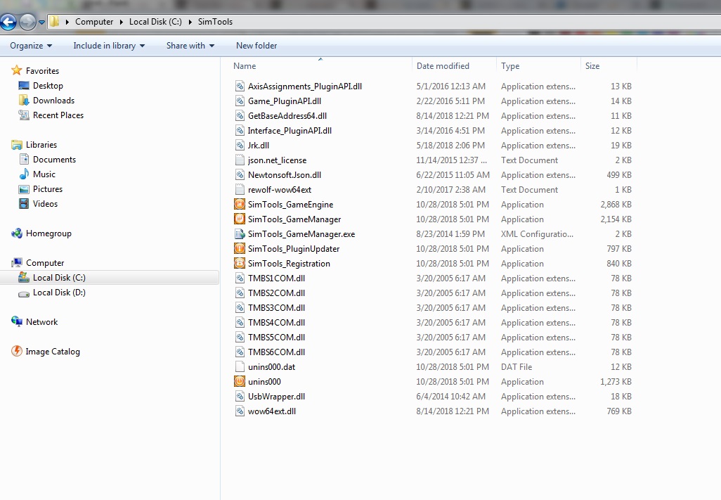

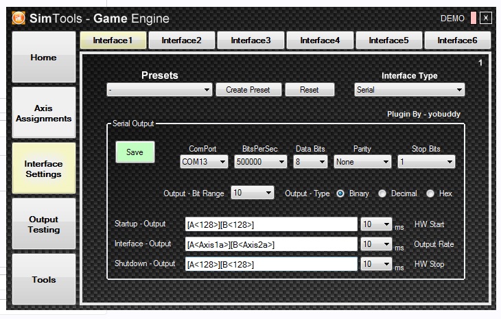

    Hi @noorbeast
    I tried several times. delete and reinstall but still not.
      File size:
      226.2 KB
      Views:
      553
      File size:
      175.9 KB
      Views:
      523
      File size:
      92.4 KB
      Views:
      574

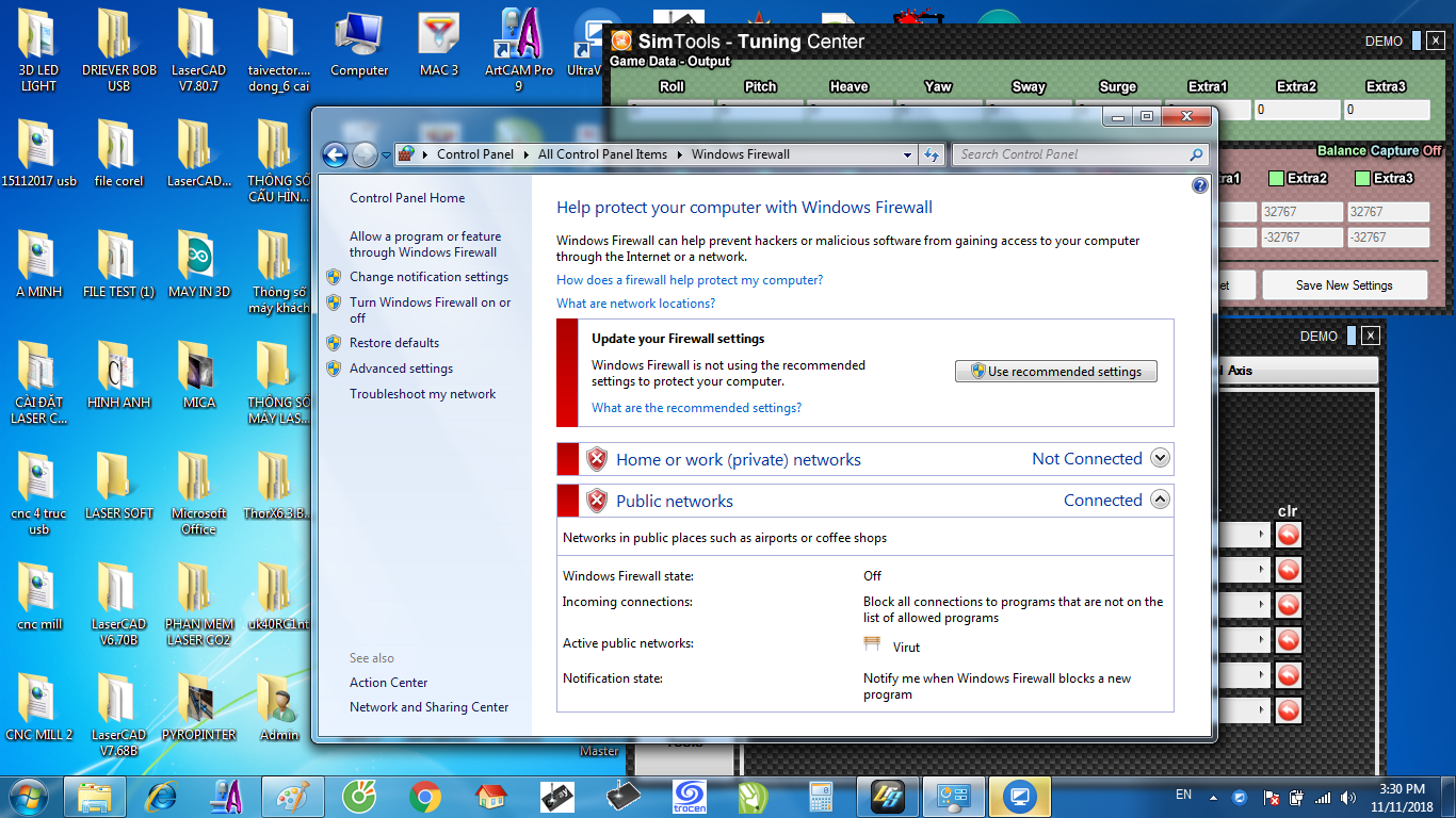

    SimTools works with all versions of Windows, 32 or 64 bit, except for XP.
    Can you please confirm you have created a motion profile for LFS and post a picture of it.
    Also shut down any firewall or antivirus temporarily and make sure there are no processes running for either.
    Then remove the LFS patch.
    Close SimTools.
    Run LFS in Single Player first person mode and drive some laps.
    Start SimTools.
    Patch LFS.
    Test LFS.

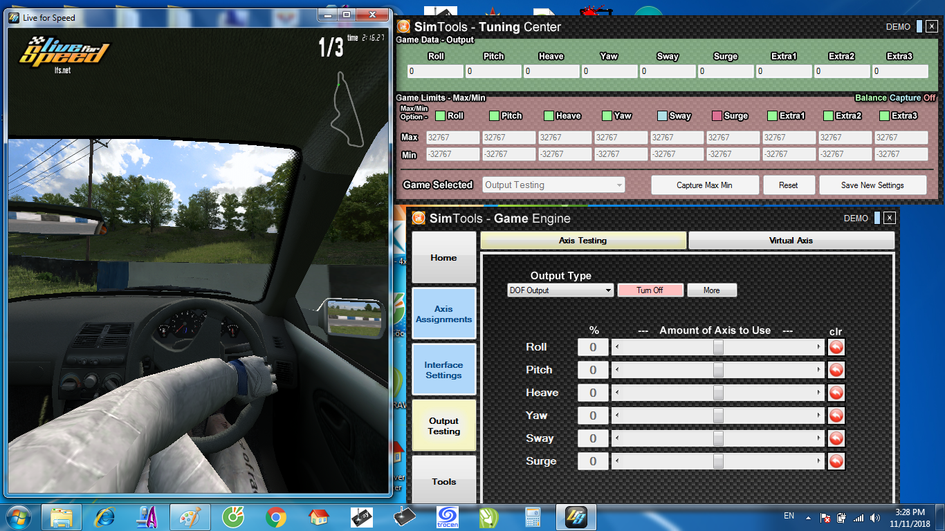

  13. noorbeast
    21,909
    153,065Coins
    +11,117 / 56 / -2

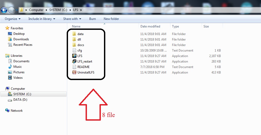

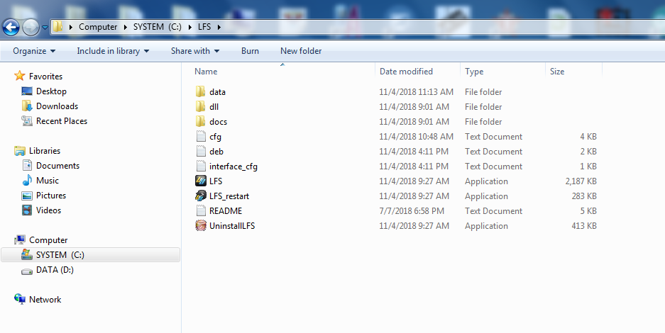

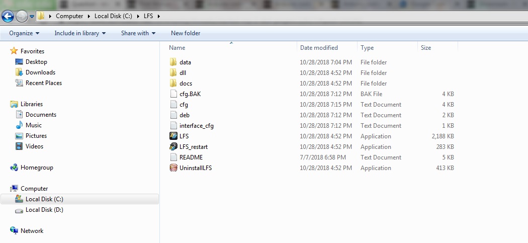

    Output Testing verifies that SimTools is working OK, the issue is either with your settings for LFS or something is blocking LFS like Firewall or Anti-Virus.
    Your Tuning Center picture shows it is set to Output Testing when it should be set to LFS.

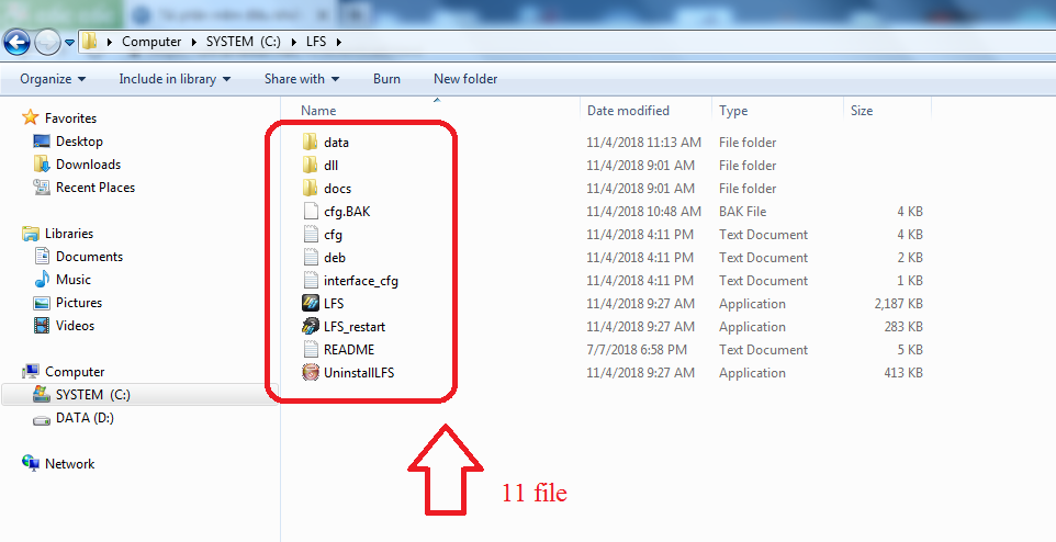

    So I need your to please verify and do the following:
    Please post a picture of the Axis Assignments for LFS.
    Please post a picture verifying LFS is patched correctly.
    Please post a picture of the Tuning Center while LFS is running and LFS is the Game Selected.

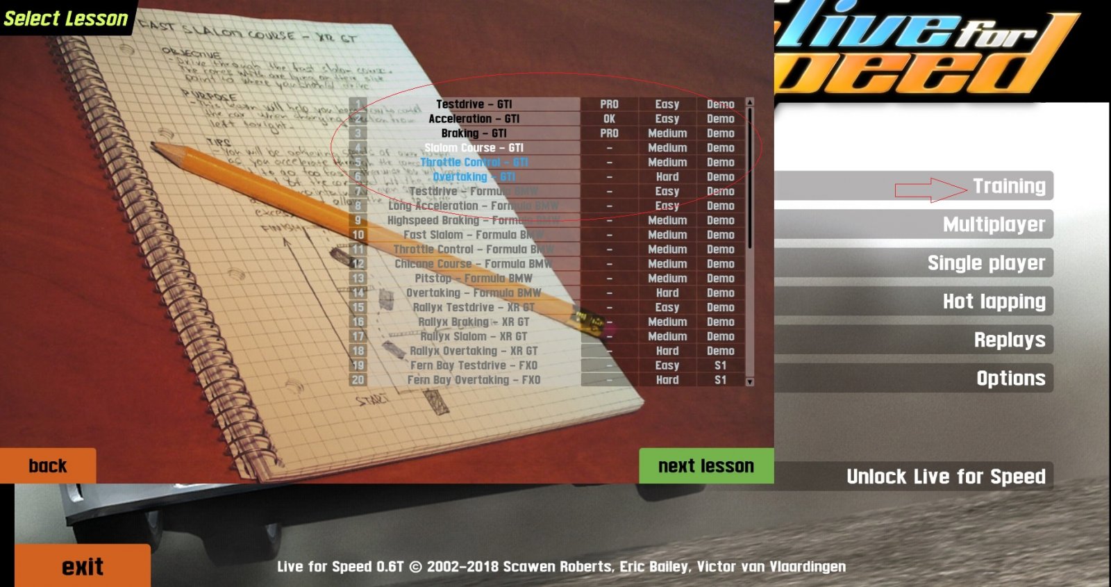

  15. noorbeast
    21,909
    153,065Coins
    +11,117 / 56 / -2

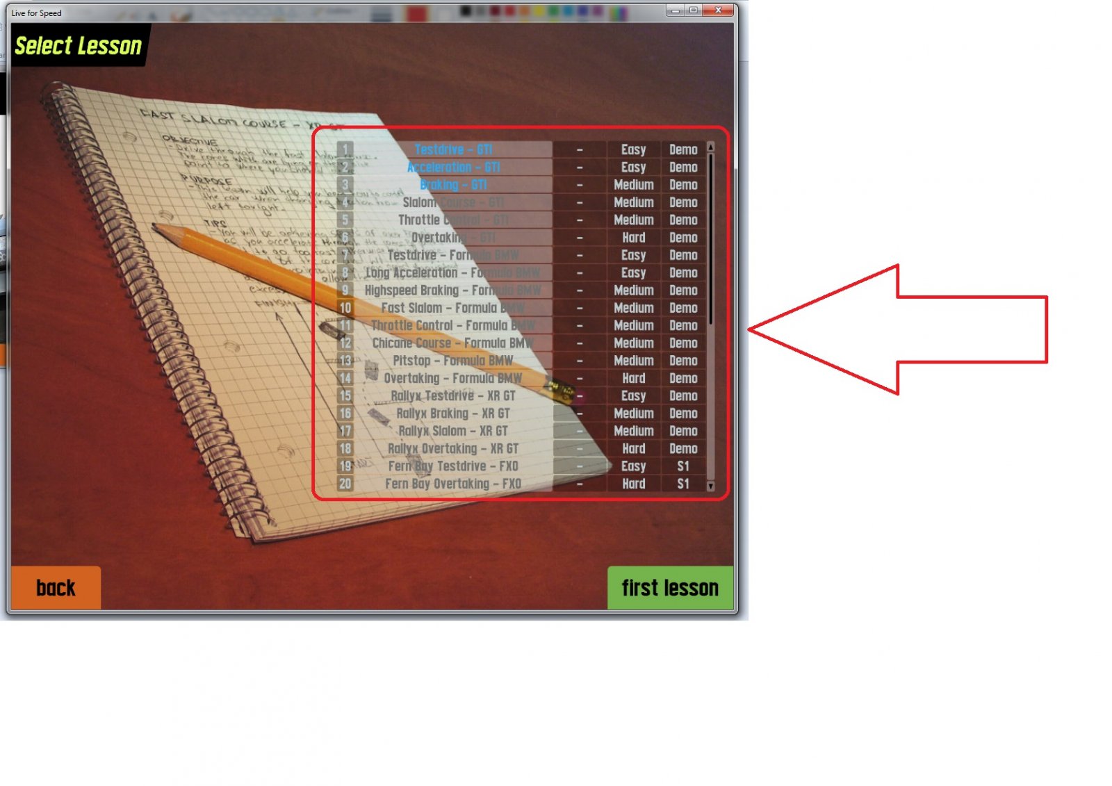

    Please use the Single Player mode to do the laps in LFS, not the Training mode.
