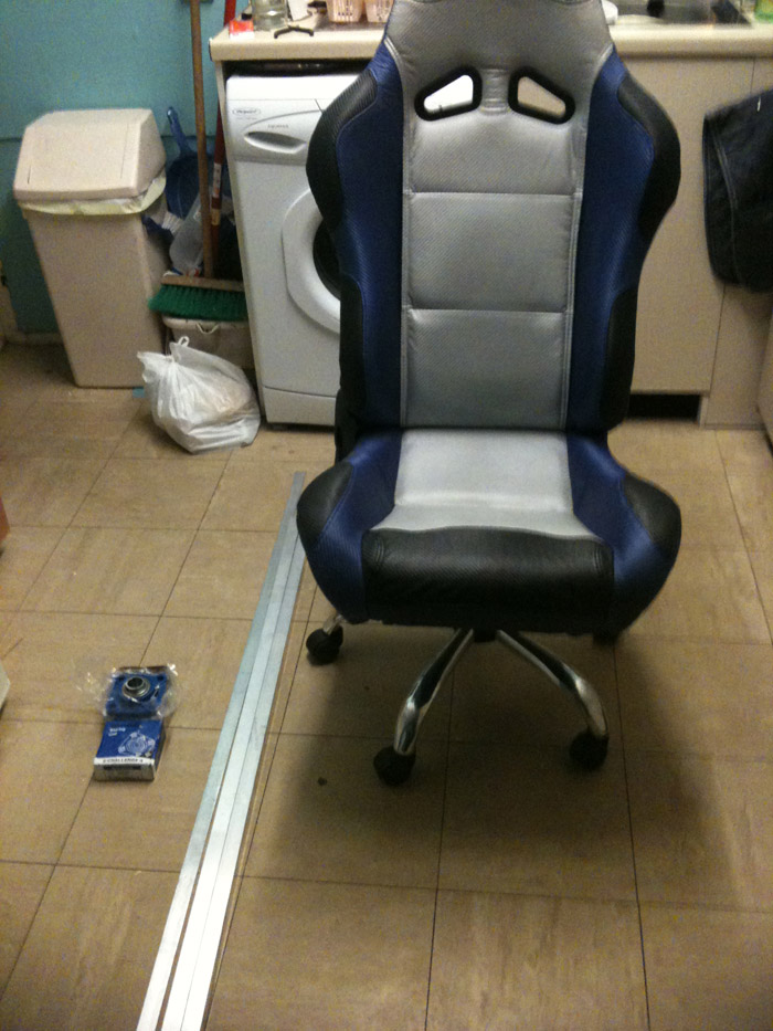

    ok chair, box aluminium, and bearings have arived so i will build cockpit on sunday.
    i have decided to start in the middle and build out, easyer to adapt if i measure something wrong, rather than getting into the middle and finding my chair wont fit.
    it will be a joyrider style but with some ideas of my own thrown in, when its done nobody will look at it and say joyrider.

    well built the cockpit today.
    feels great to be started and i never new an angle grinder was so easy to use.
    will get pictures posted tomorow
    to exhusted now
    still no responces about the motors
    it is a joyrider sim made from aluminiun box section
    anyone know if the motors will work as they will be so much easyer to mount than wiper motors and i think they are faster but i dont know if they are strong enough i hope so as they are bi directional so no modding
