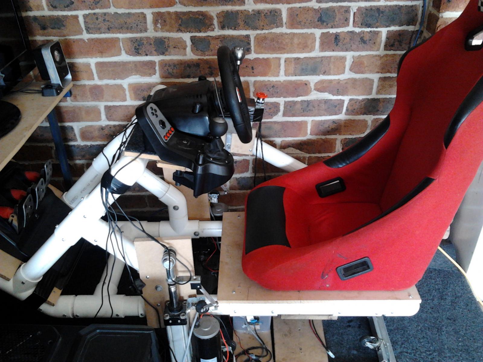

    I used PVC for a full frame race sim a while ago, mind you , I only weigh 85 kg, but it withstood 120 kg driver no problem
    A joyrider should be sturdy enough for your weight, use PN18 rating, thickest possible and you may still need to strengthen the frame with steel though

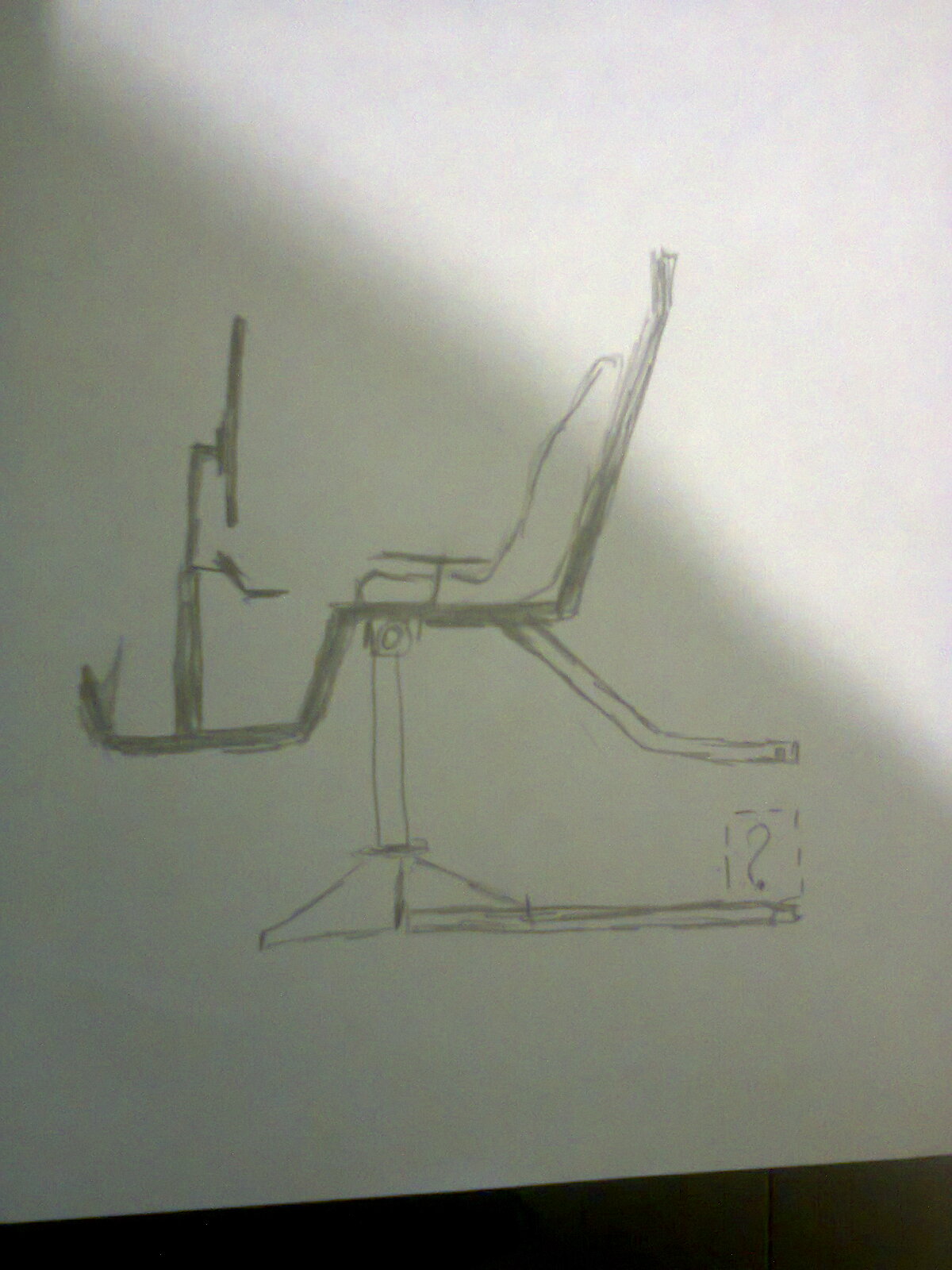

    Я теперь также выбрать платформу, но эти проекты, которые я видел не внушают доверия. В то время как в сборке, и по цене дешевле. Я все еще склоняется к этой конструкции

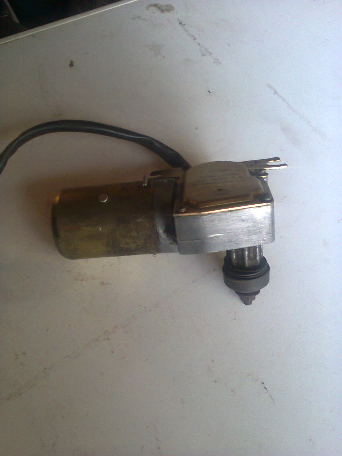

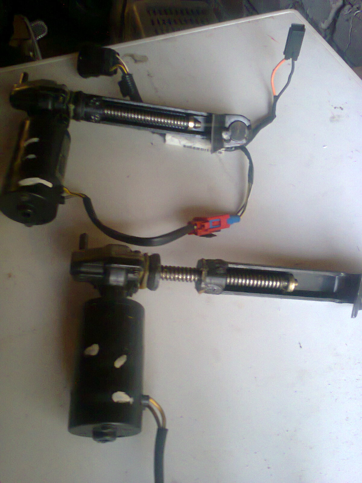

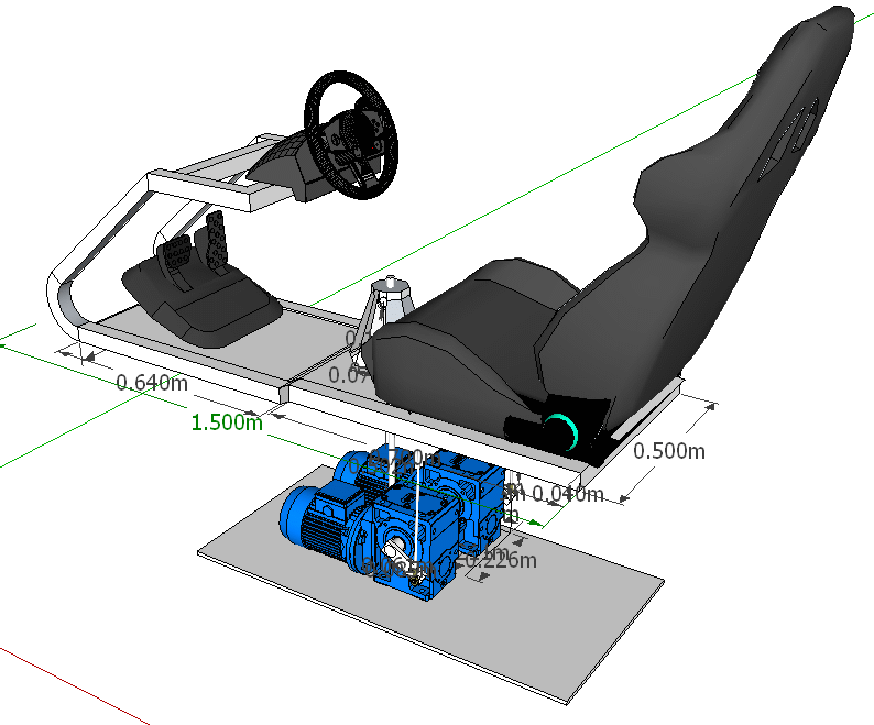

    У меня вот двигатели.[​IMG] [​IMG] Я хочу использовать ИХ С Платформы.[​IMG]

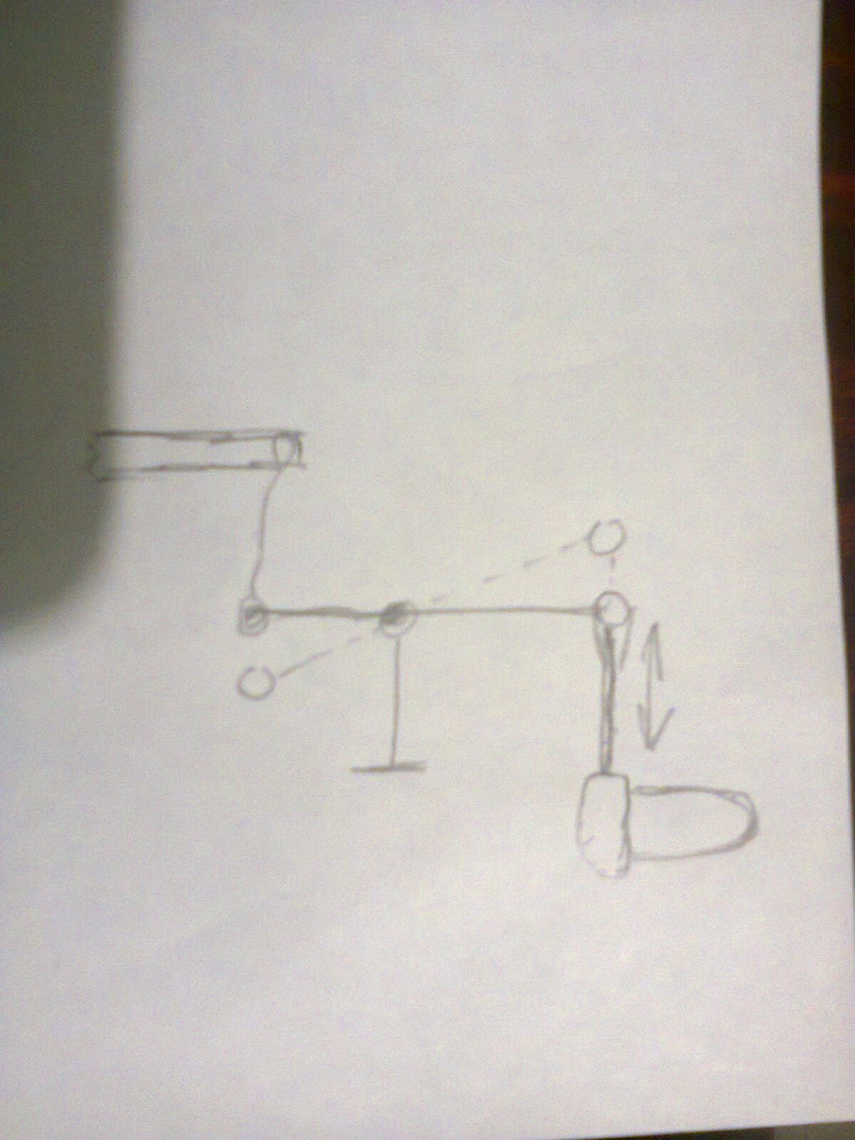

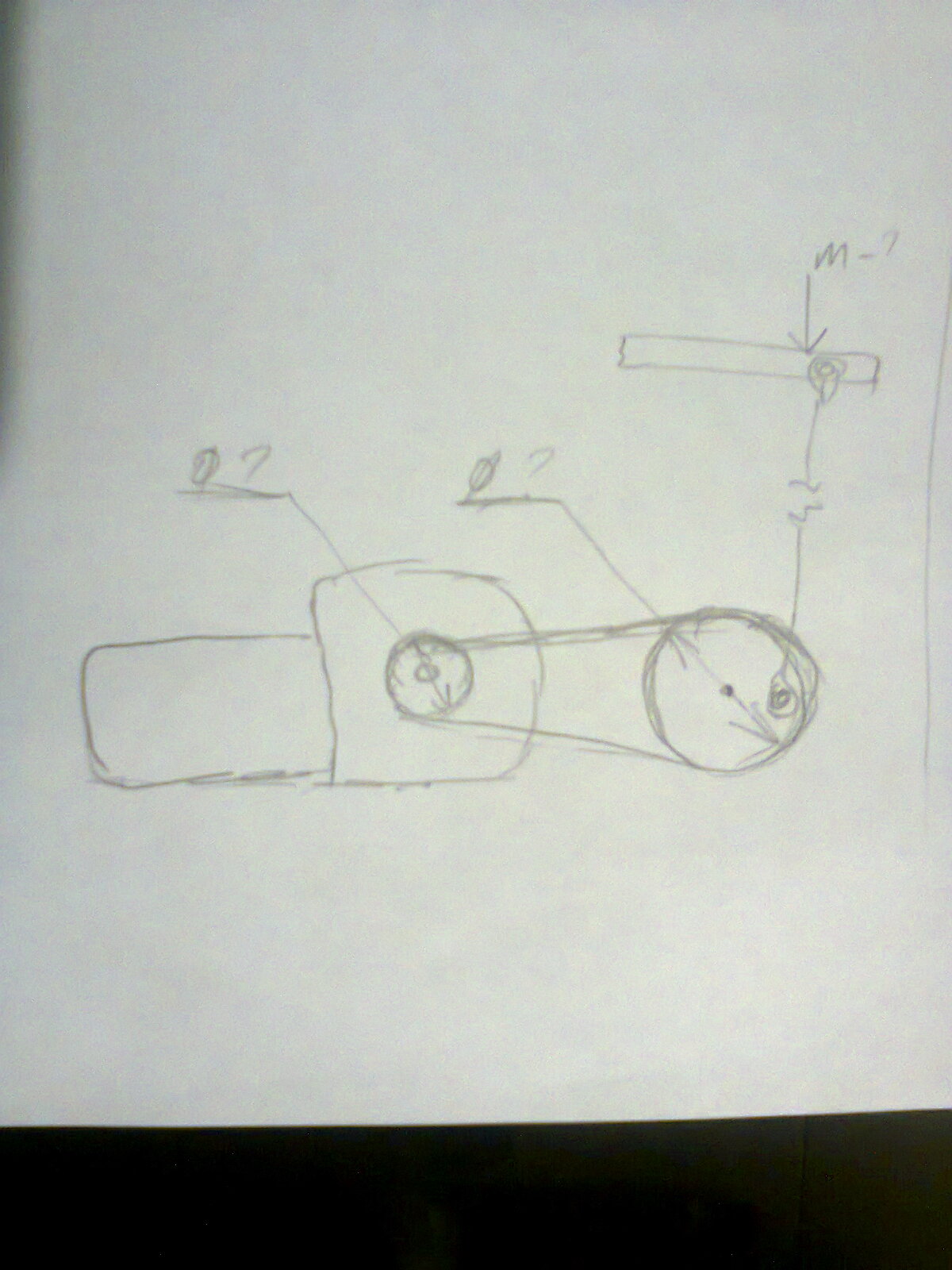

    Привод думаю сделать вот такой. [​IMG] или [​IMG] что бы достичь комфорт тренажере платформы.

    Hmm, maybe you want to make a more balanced frame for your motors, and a lower COG to get the max angles for flight sim.

    Wipers will struggle to lift that design, either mount the wipers so they connect to the shoulder up high to overcome weight issues, or look at bigger motors , like a 12v 200 watt 60:1 , 100:1 gearbox motors, or if your brave enough , as Thanos shows in his photo , 240v motors.

    I realized that even for a balanced 2 DOF, my motors are weak?

    Because its not balanced, then even if you balance it you will still need some power to move your cockpit and screens along.

    You can build an AMC if you like, however and arduino would do a similar job
    You design will work with 12v motors, but you would need to re-design the platform with better motor placement.
    Like the pvc build I pictured, move the motor connections a lot higher up like I suggested to overcome COG.
    Its not difficult, you could have motors connections higher up on the sides and use 12v 200 watt worm gear motors with 60:1 or 100:1 gearboxes or boat winch motors.
