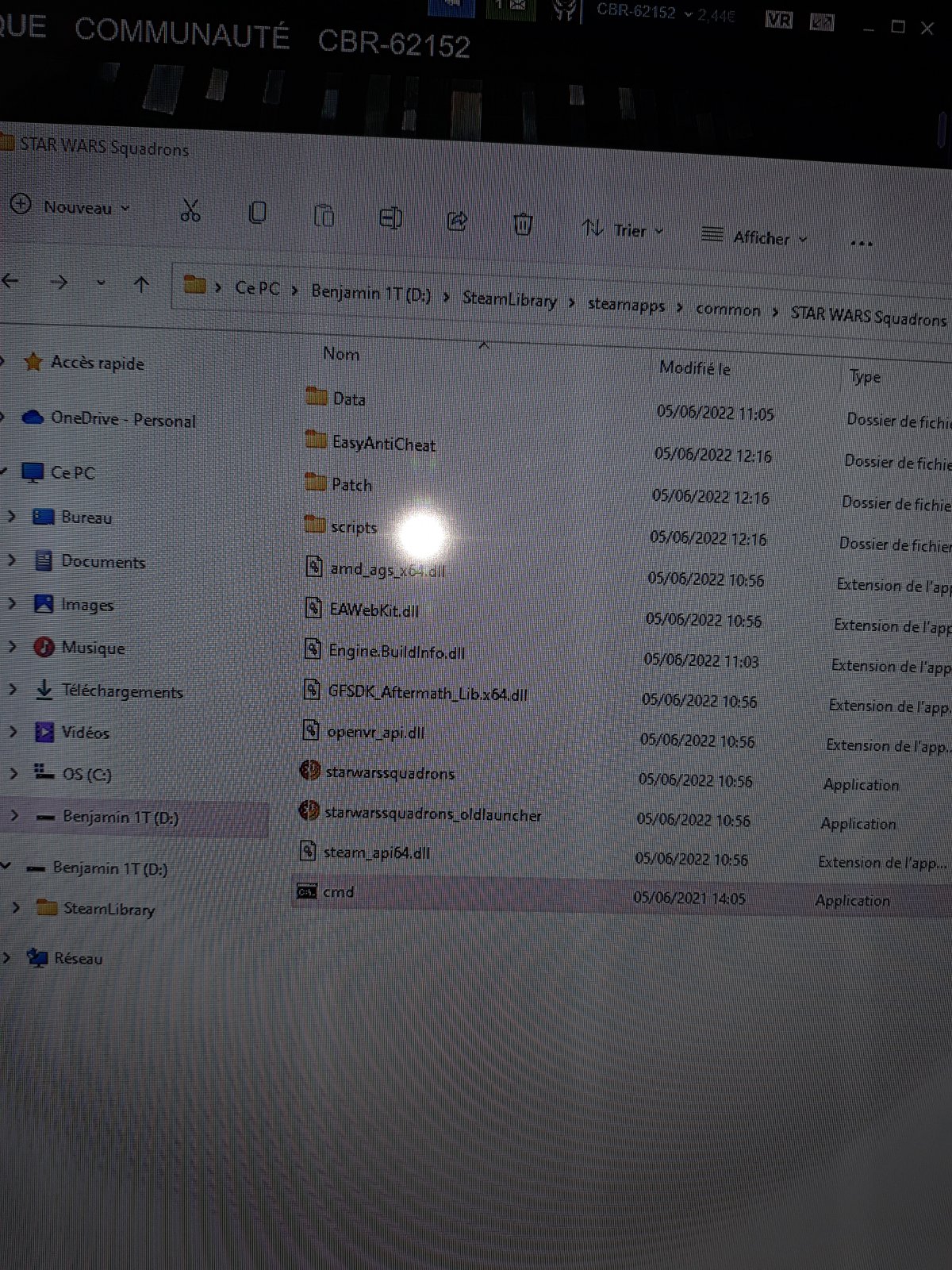

  5. margolle
    margolle New Member Gold Contributor
    Jun 27, 2019
    25
    50Coins
    +7 / 0 / -0
    hello.
    I do not speak English, it is very difficult to understand the details explained.
    moreover, the explanatory videos are in English, the words on the PCs are in English, there are also differences between windows (win7, win10, win11).
    I don't know how to solve the problem because there is too much detail badly translated by google translation.
    I would really like to not bother you with this anymore.
    I downloaded the paulopsx2 plugin.

  10. margolle
    Jun 27, 2019
    25
    50Coins
    +7 / 0 / -0
    video 2 impossible move

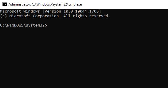

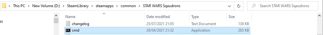

    Motion platform
    hi @margolle i think you need to go to C:\WINDOWS\system32 find cmd.exe and copy it to the folder that you made and run it from there
    i dont own the game etc but i have mocked it up for the pictures

  12. margolle
    Jun 27, 2019
    25
    50Coins
    +7 / 0 / -0

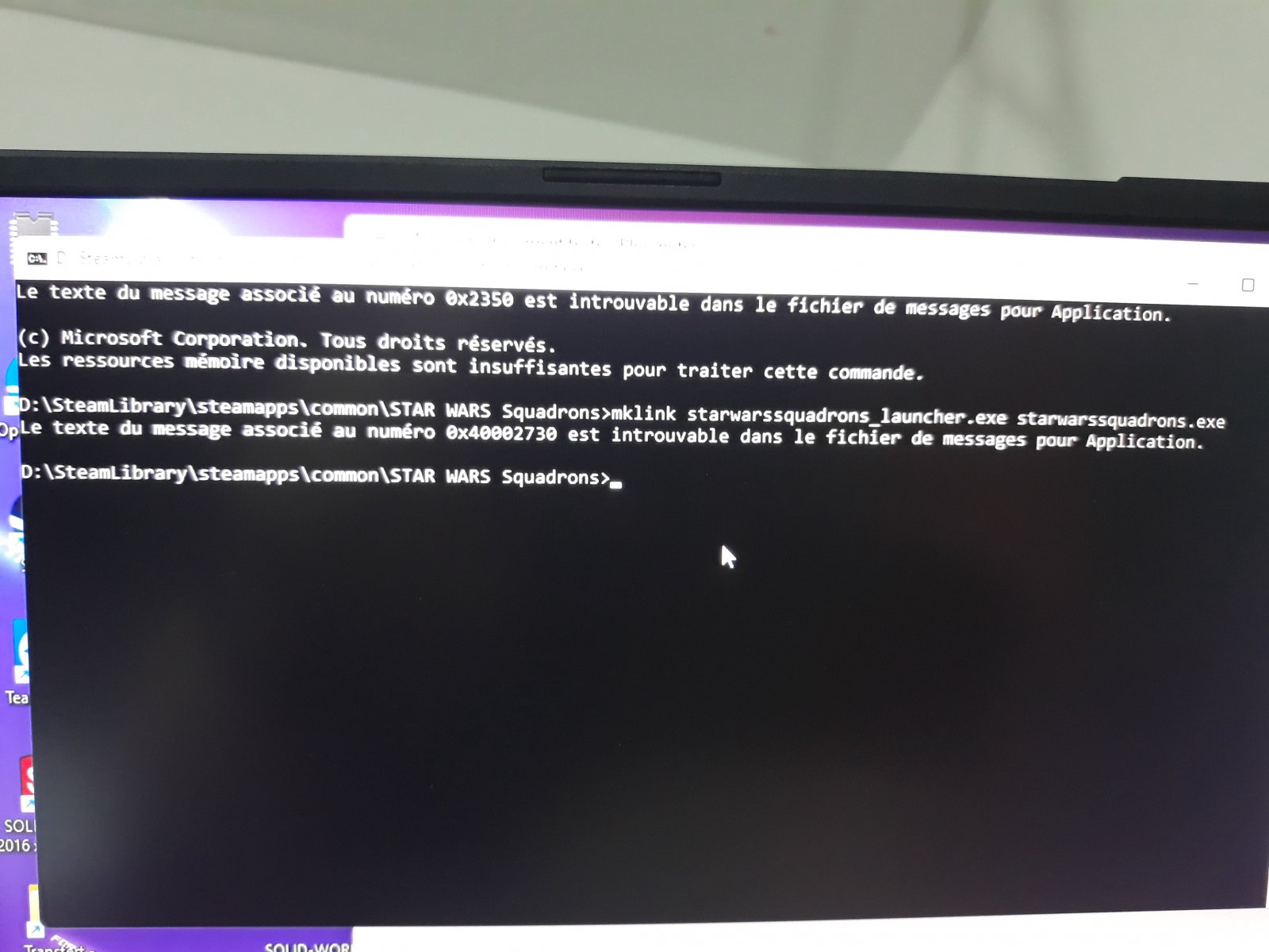

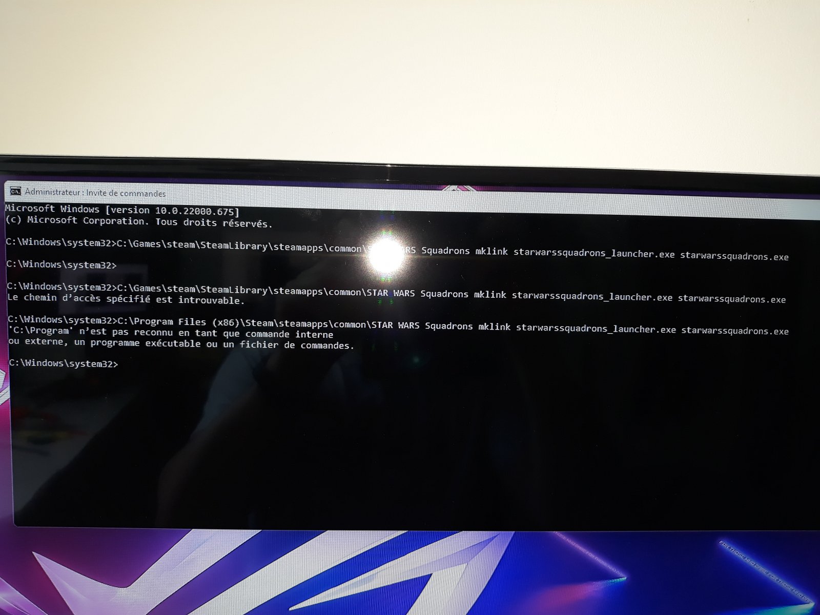

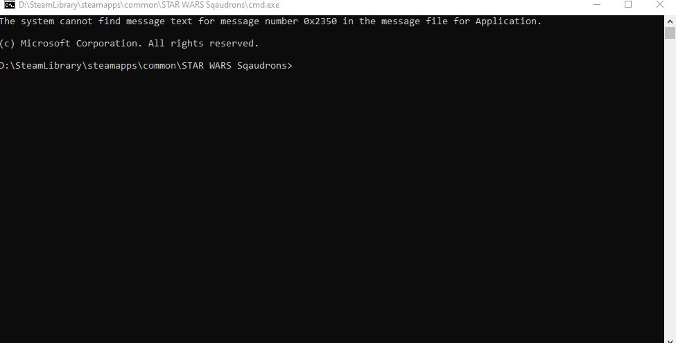

    hi
    I tested, it tells me: the symbolic and already created impossible to redo one.

  14. Daguru
    Sep 4, 2013
    719
    Kitchen installer
    Wales uk
    453Coins
    +632 / 1 / -0
    Motion platform

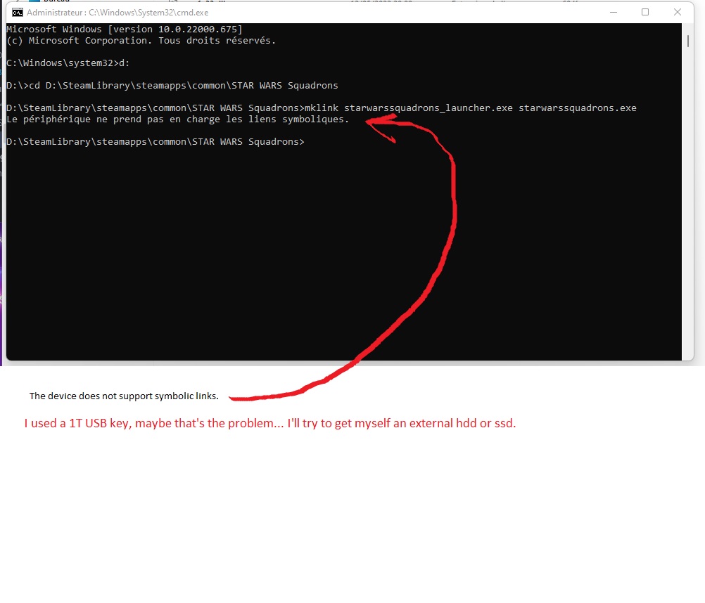

    are you running cmd as admin?

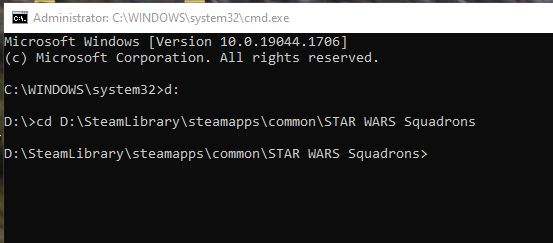

  15. Daguru
    Sep 4, 2013
    719
    Kitchen installer
    Wales uk
    453Coins
    +632 / 1 / -0
    Motion platform
    ok try this C:\WINDOWS\system32 and run cmd as administrator
    then type d: then press enter
    then cd D:\SteamLibrary\steamapps\common\STAR WARS Squadrons then enter
    then mklink starwarssquadrons_launcher.exe starwarssquadrons.exe
  16. margolle
    Jun 27, 2019
    25
    50Coins
    +7 / 0 / -0
    yes ; right click, run as administrator

  18. margolle
    Jun 27, 2019
    25
    50Coins
    +7 / 0 / -0
    Hello . If start starwars then game start, 1sec and crash .
