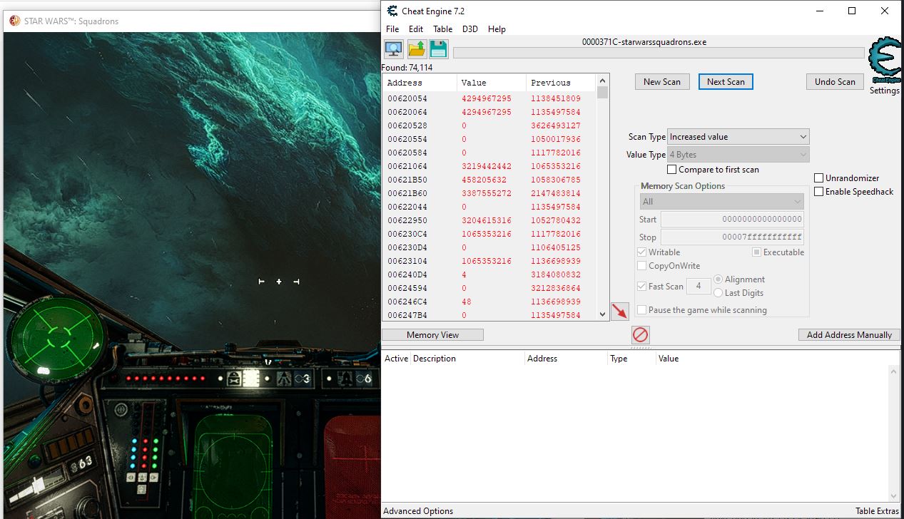

    Let's first see if we can hook to the game correctly. Download and install cheatengine.
    1-Launch the game
    2- When in-game , with cheatengine, File--> Open Process , Select Start Wars Squadron.
    3- post a screenshot of cheatengine.

    Hopefully 've done everything right. Here's a screenshot after pressing scan.

    Updated the pointer for game update 4.2
