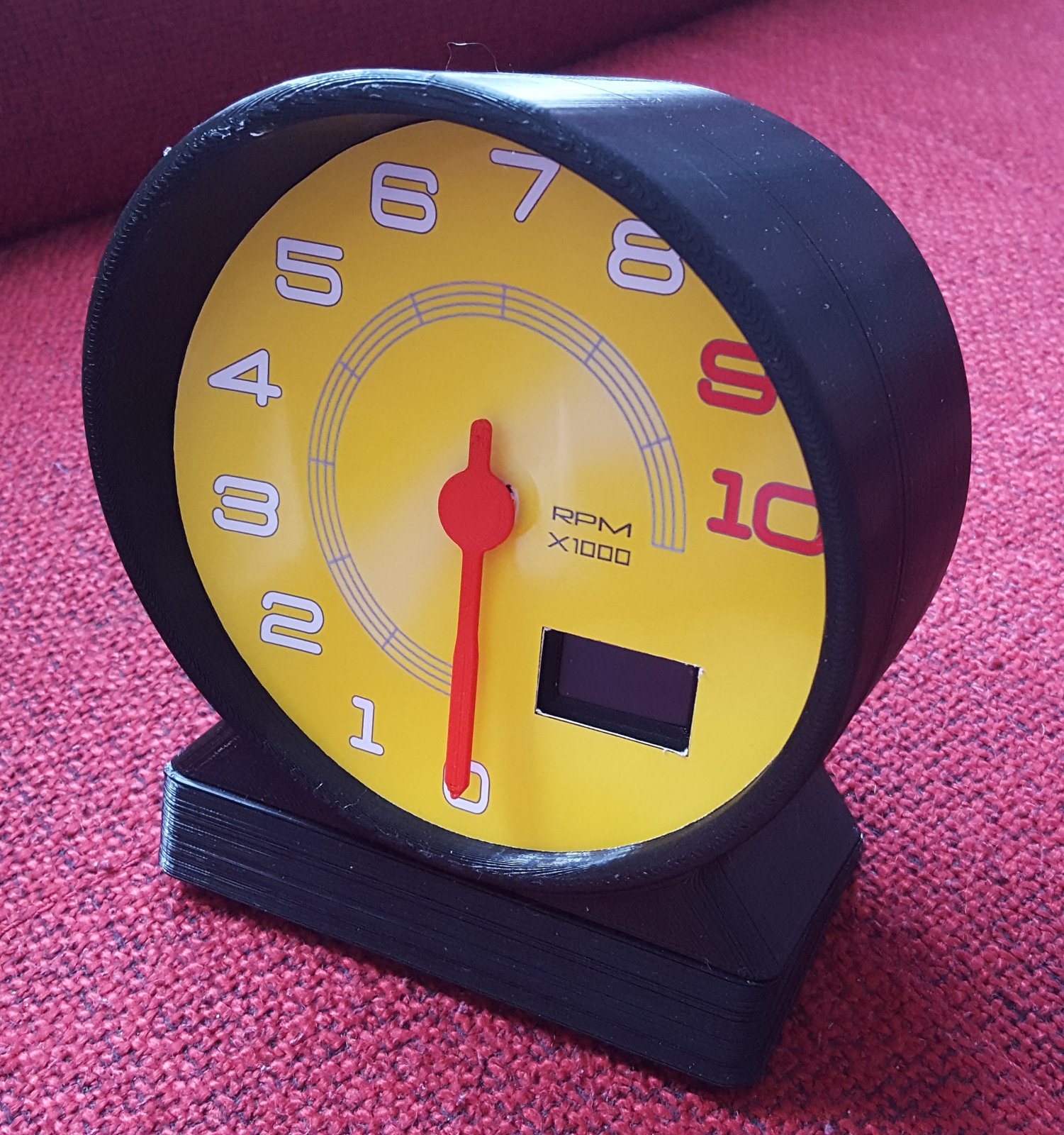

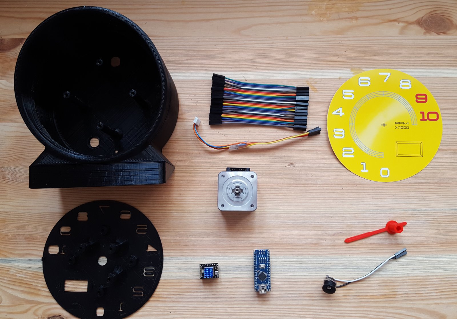

    finally I completed the project.
    The parts list:
    - Stepper motor NEMA 17
    - OLED 128X64
    - 2X Arduino Nano
    - Wires
    - 12V 1A power adapter
    - TMC 2208 ( motor driver)
    - 3D printed enclosure
    the result:
    I had to use 2 Arduino because when I use one Arduino for the motor and the OLED the motor will move very very slow because the functions of the OLED need a lot of time and then the whole program is very slow.
    Maybe when you use another processor for example with 96MHz or faster it could work.
    here is a test in forza horizon 4:
    I hope you like my project and I'm waiting for you feedback
