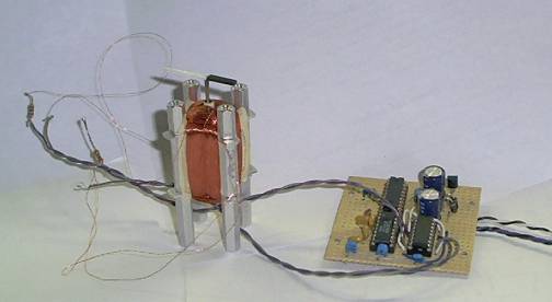

    hello I was just looking for a speedometer and tachometer for my almost finished race sim.
    but the prices for ready kits are very expensive, so i was surfing google for a diy solution.
    and yes i did see the servo controlled speedometer from tronicgr,
    but it seems that it jumps a little with deceleration and i already have a couple of aire core's from
    car dashboards.
    so this is what i found so far (in language i understand :blush: ).
    http://www.mikesflightdeck.com/diy_aircore_instruments.htm
    this is the part that intriged me
    so after a lot of typing my question is can i use a amc1.5 from tronicgr to drive air core's.
    because i have 2 amc1.5 and 2 dsmh1.2 left.(because of ordered from 2 different etching services).
    regards wim post.

    Hi wimpo,
    I've seen mikesflightdeck article about air-cores before, but not much information is given (except if you buy his books...!!@$#@^)
    The difficult is to drive the air-core gauges is the need AC PWM drivers. I have found some drivers that are used in cars for this purpose: CS4122 (Triple Air−Core Gauge Driver with Serial Input Bus)
    You can interface this driver easily with any microcontroller (and with my AMC1.5) but its very difficult to source them. If you, or anyone else, could find a nice source for this chip I could re-program the AMC's firmware to drive it!!!! And we could then be able to use ready made air-core instrument clusters from real cars!!!!
    Regards, Thanos

    but i understand from his page that you can also drive an air core with a micro controller,
    by controlling the 2 core's with pwm and a h-bridge.
    i don,t know if you can do something with this, but it is the HEX file from the aircore.
    http://www.mikesflightdeck.com/hexDL/AIRCORE1.HEX
    this guy has done it like this to i guess.
    http://www.youtube.com/watch?v=kt58x0zJ5gg

    ok i found a pdf regarding about driving air core's with a microprocessor.
    here's the file
