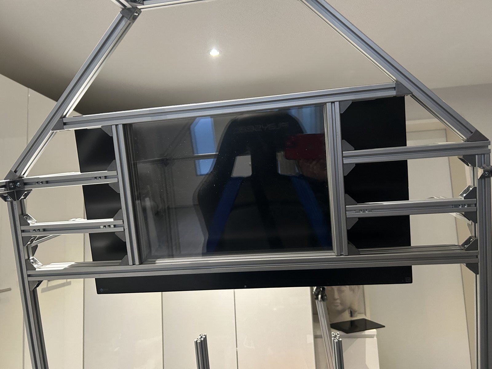

    • A 23" Screen is used as a "front window"

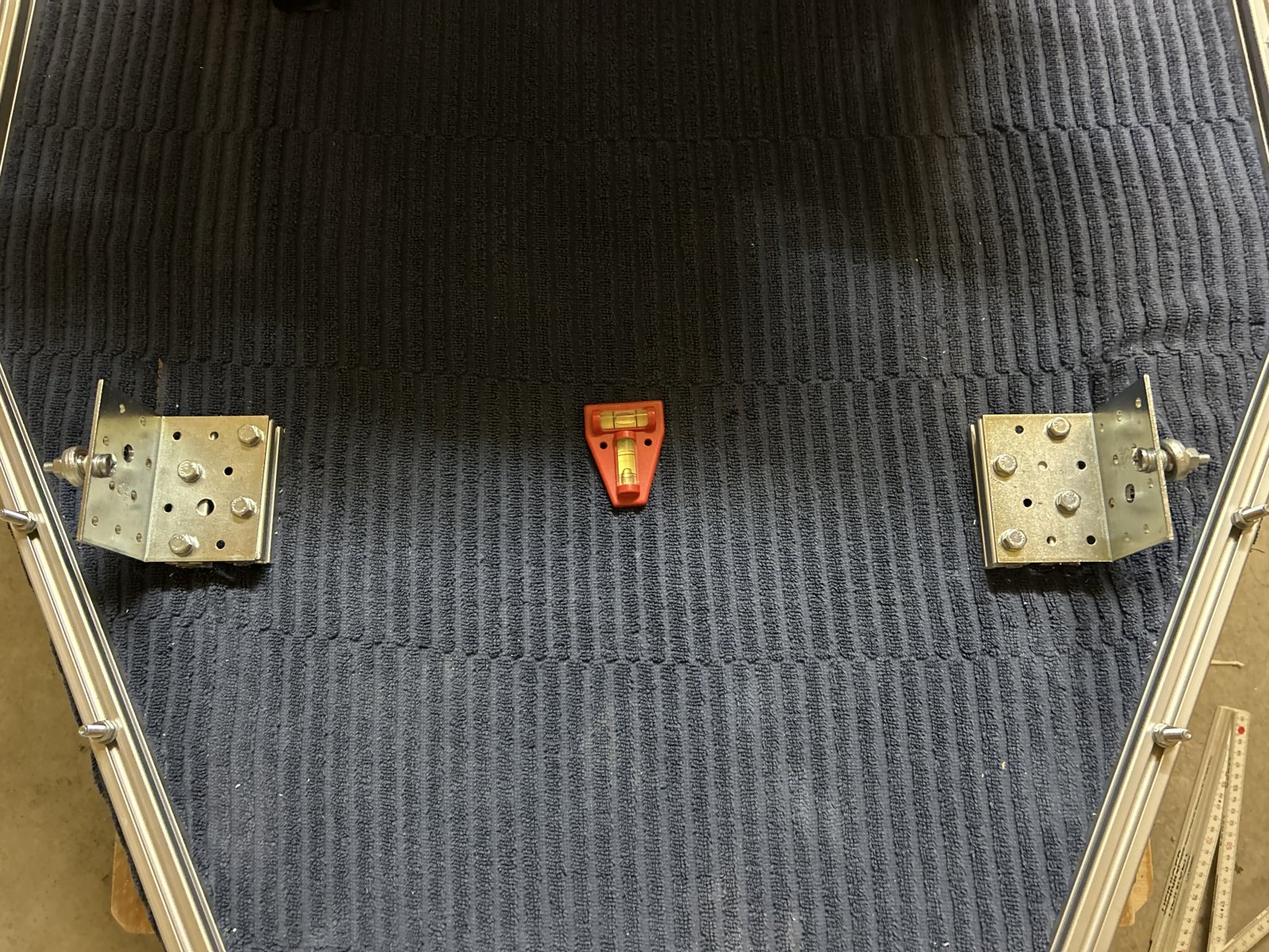

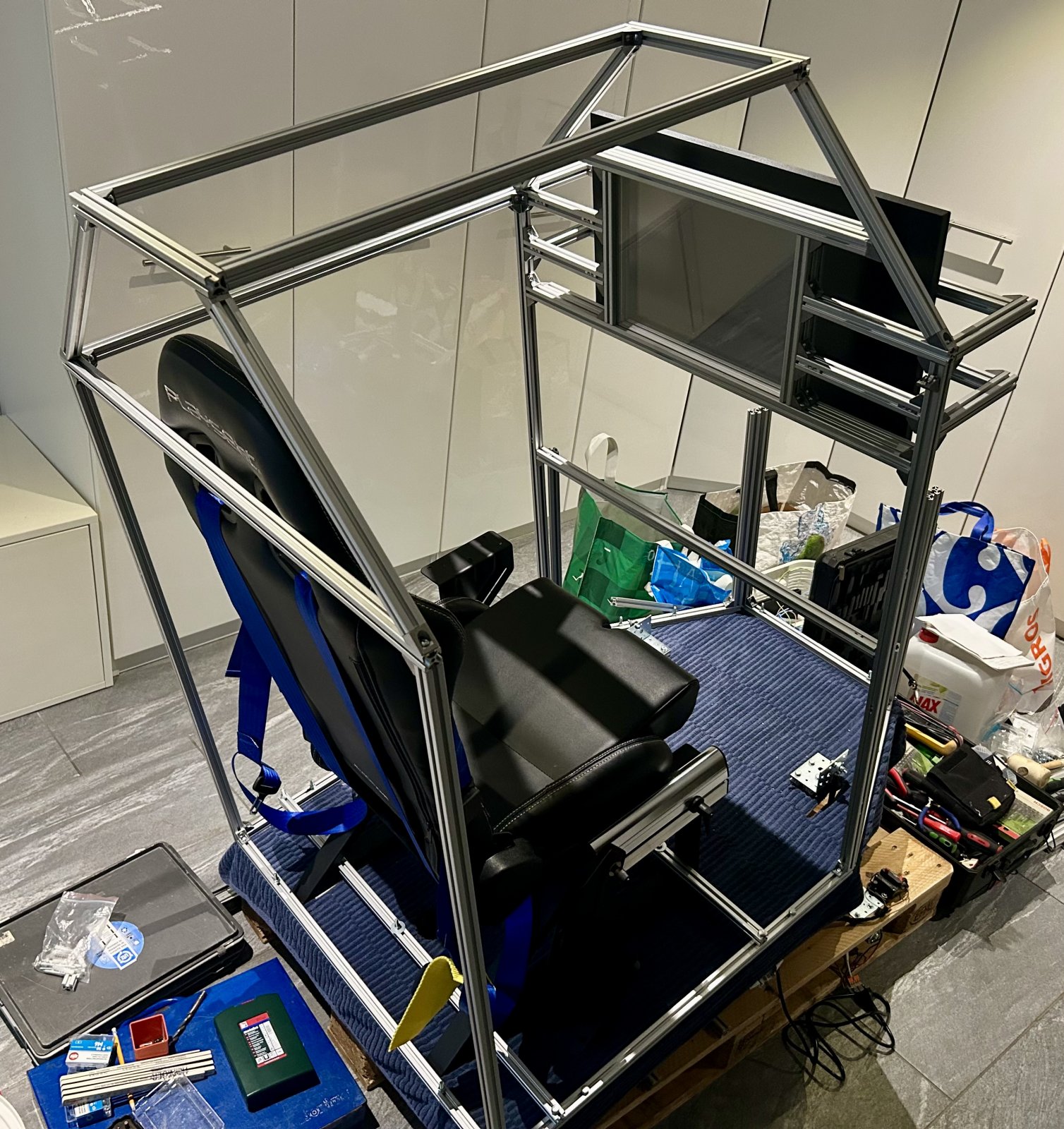

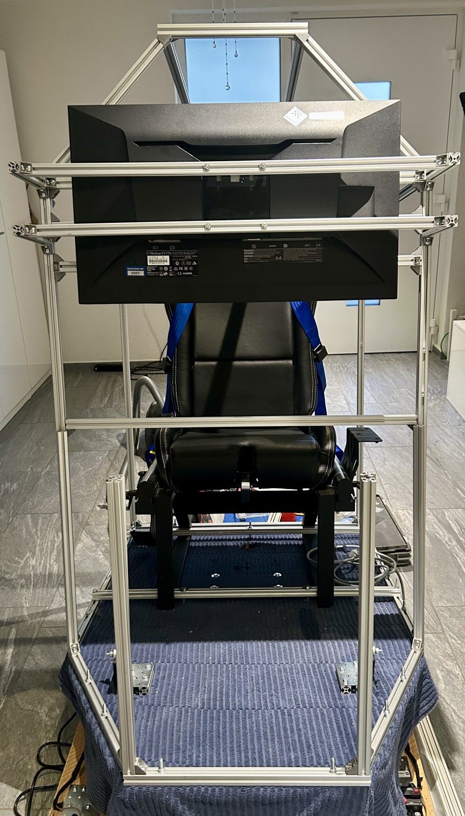

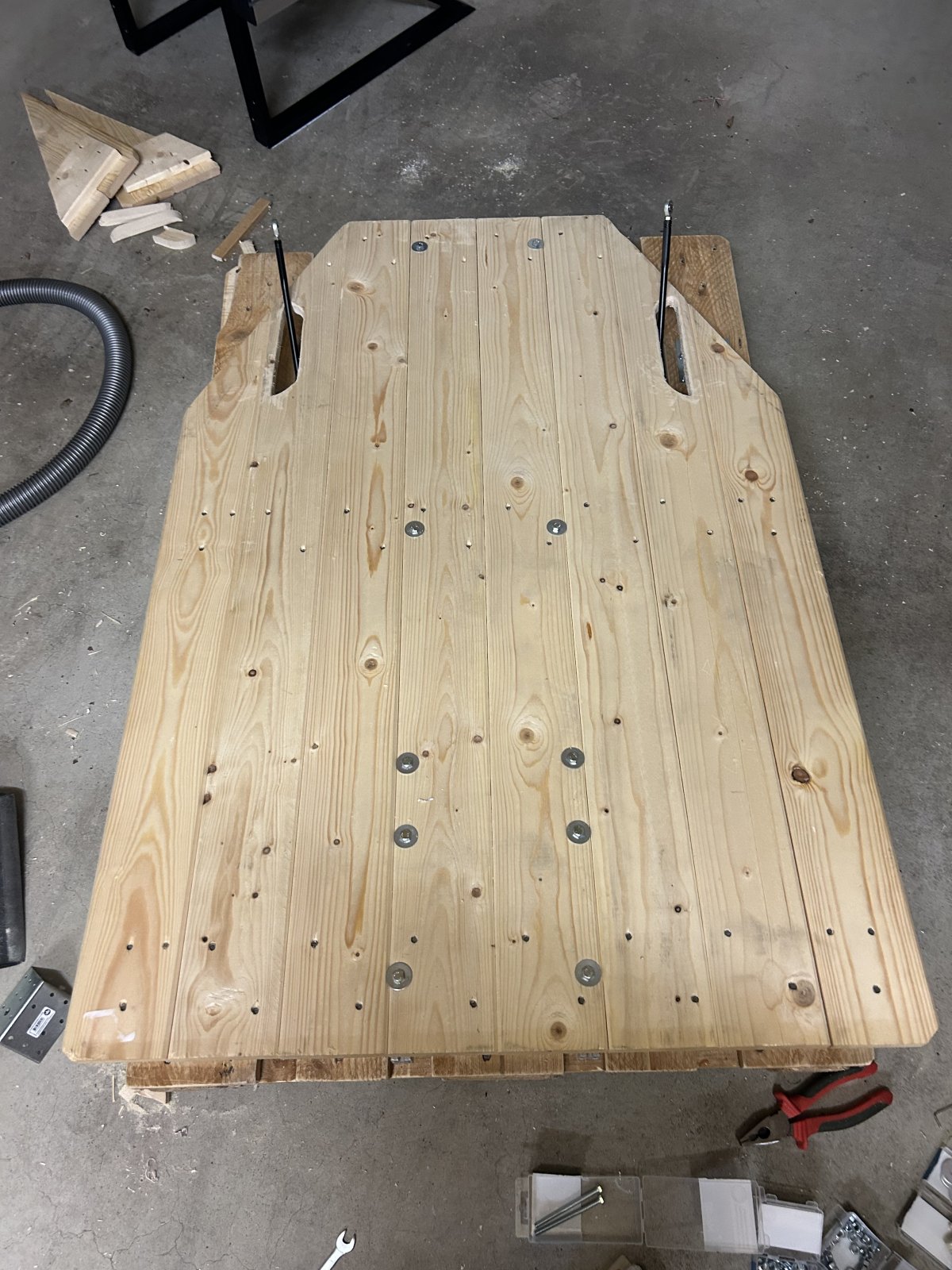

    Basic platform:

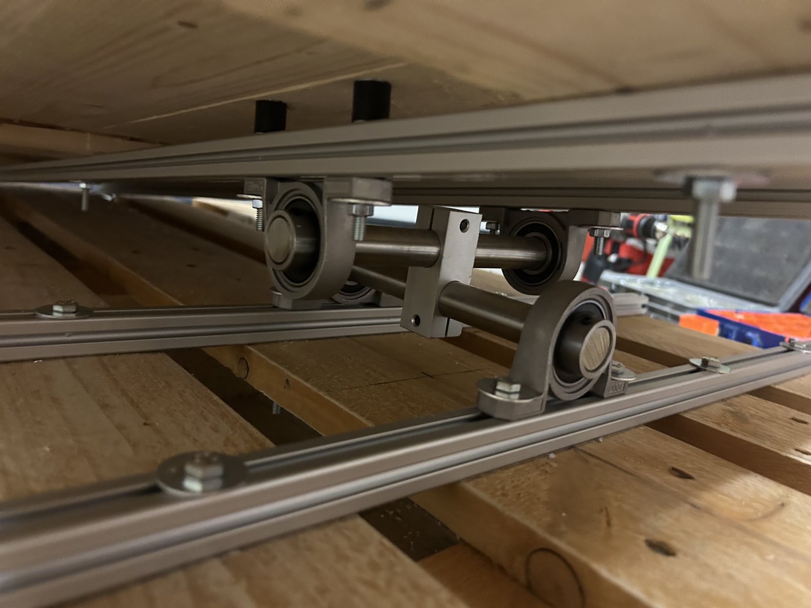

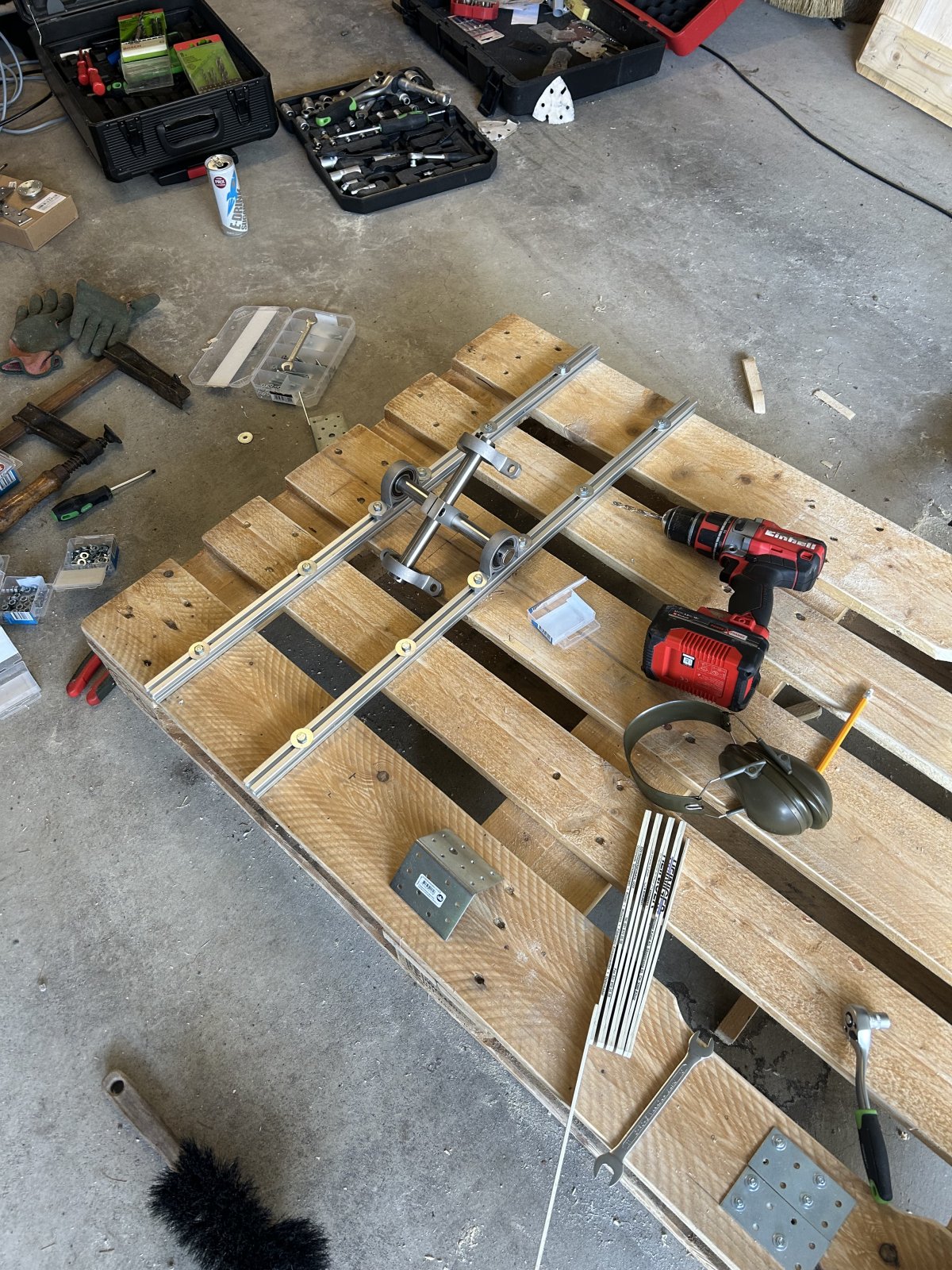

    I started with a standard Euro Pallet and a Pallet lid. Trimmed the "nose" of the pallet lid to make it a bit more interesting than just a box from outside view. Also every gram that can be saved shall be saved.
    First step: installing the main joint.

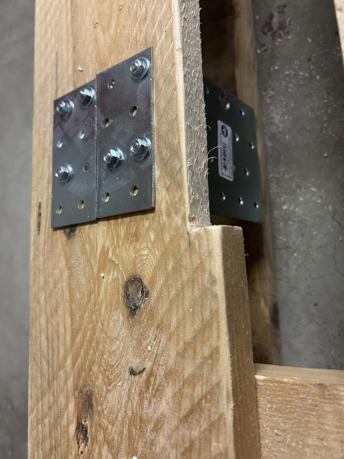

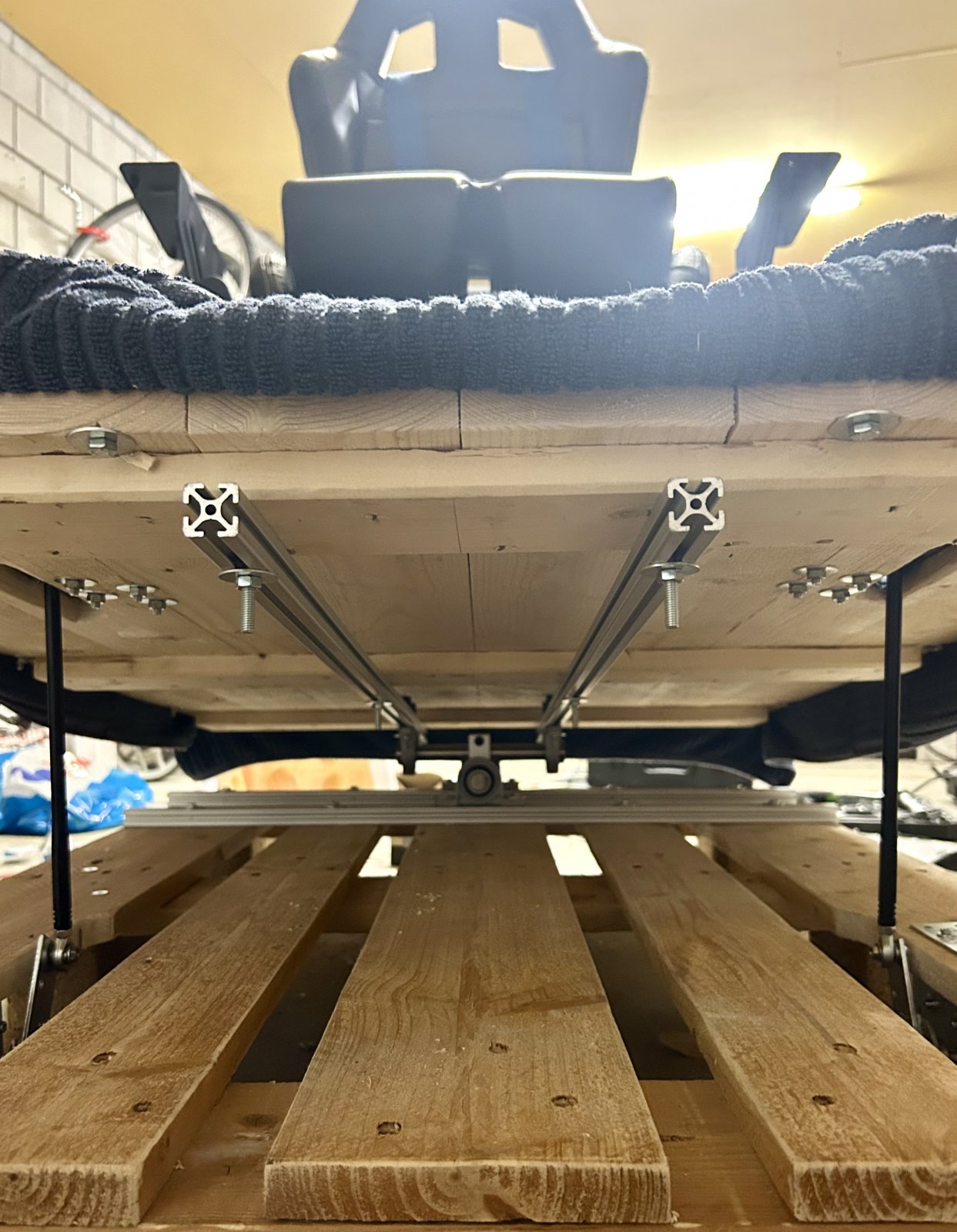

    To spread the weight to the whole pallet, i mounted it on two 20x20mm aluminium rails. The motors are mounted with a metal angle, spared out a bit of the wood of the pallet, so that it still will be possible to move the simulator with a pallet truck.
    The pallet lid gets the same treatment, aluminium rails for stability, main joint positioned directly under the seat position.
    Sawing two notches for the 2-DOF steering rods.

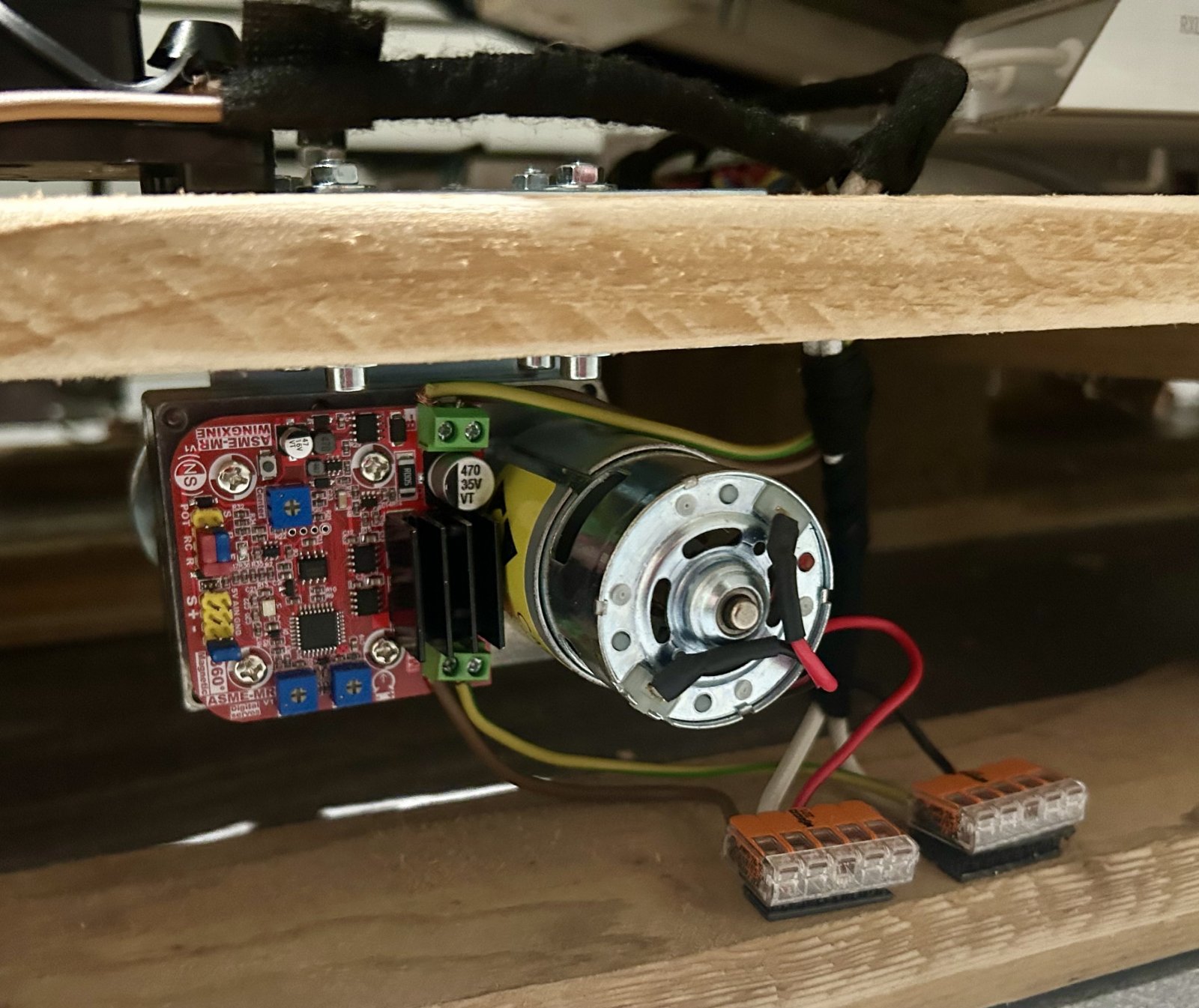

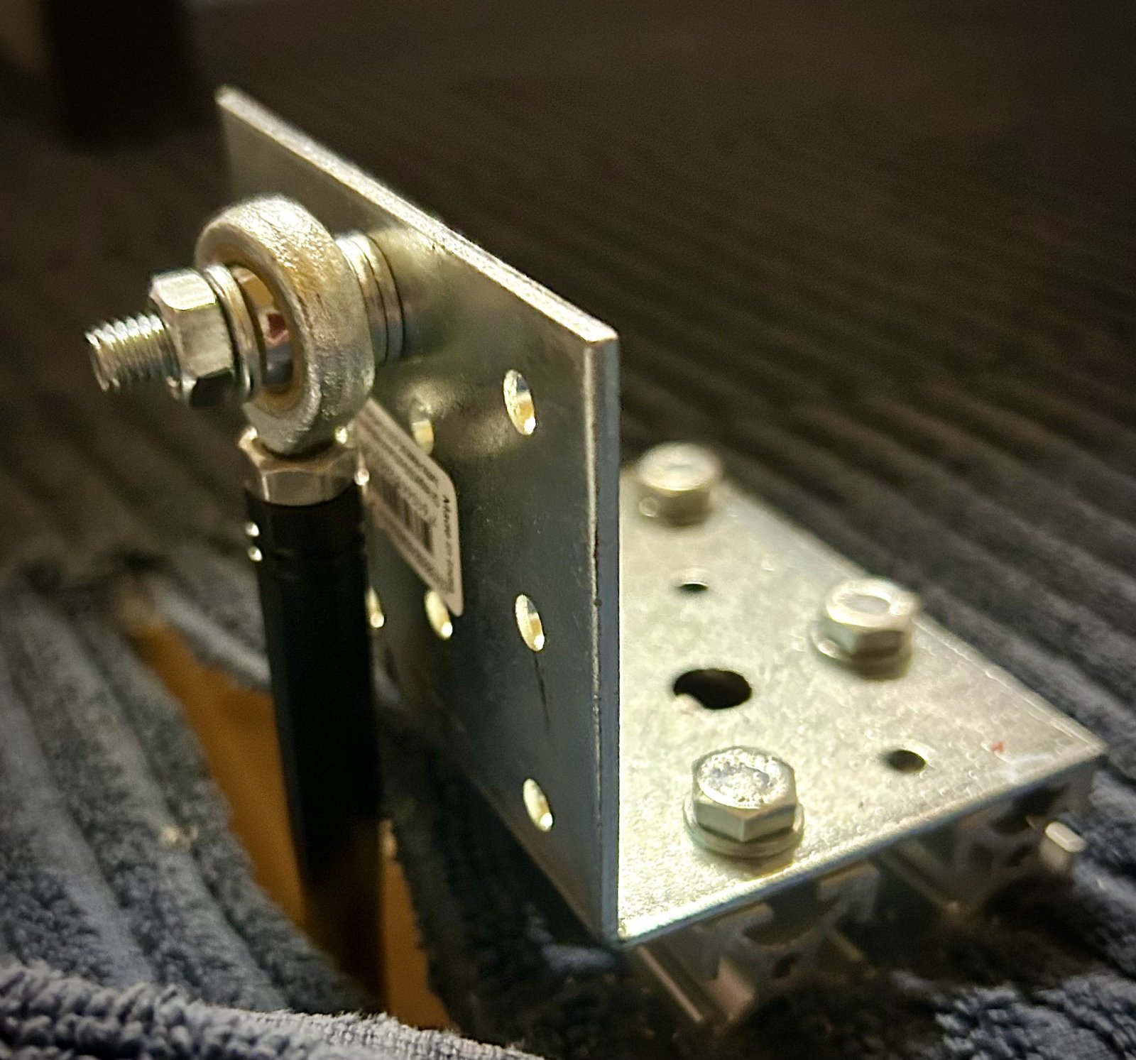

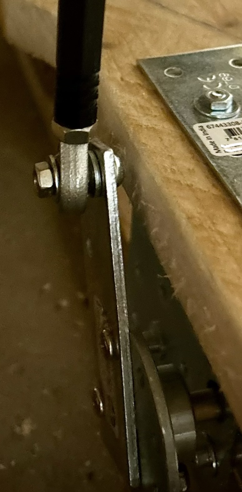

    Looks nice so far. Here some details of the motor positions and of the lever:

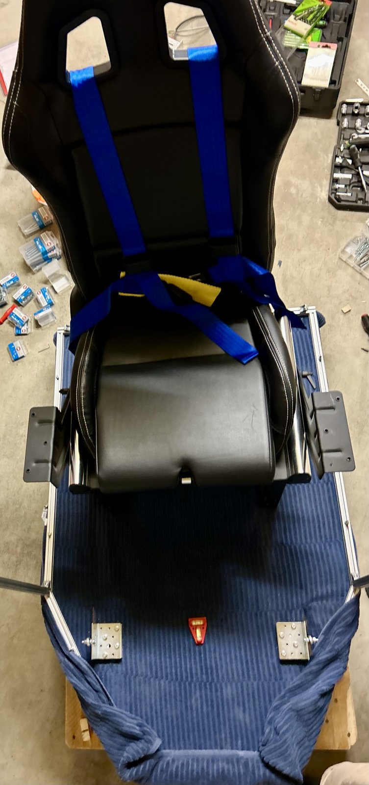

    Testing the seat position:

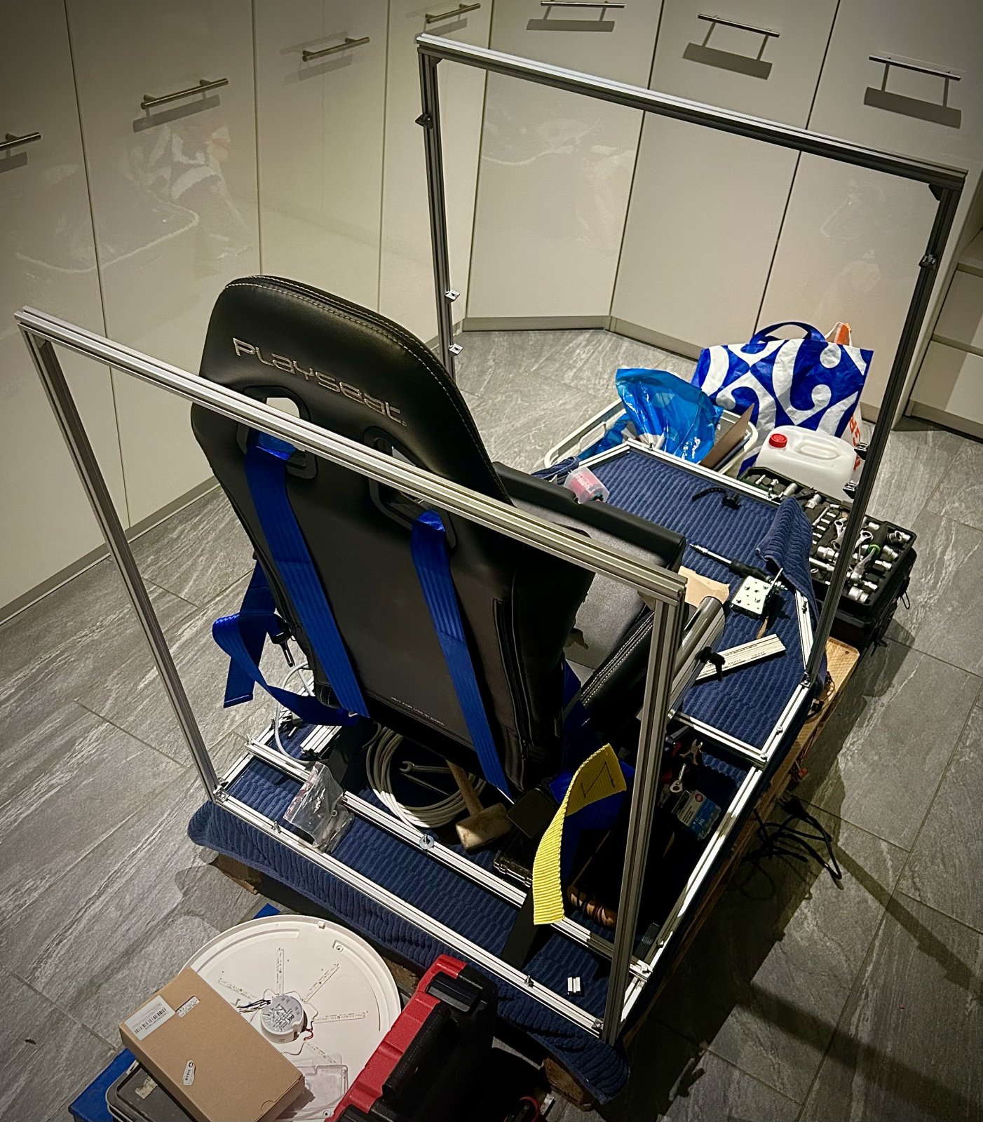

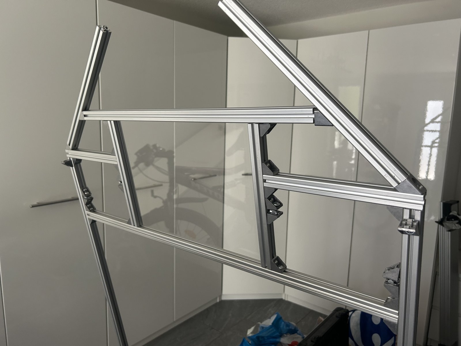

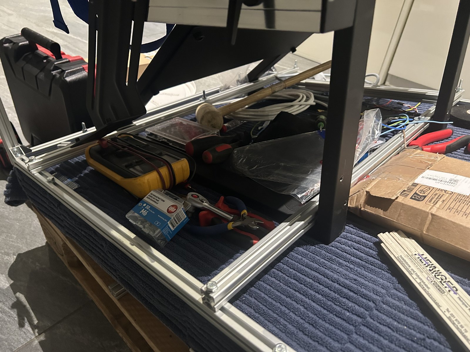

    Then I added a floor "rug" and the basic aluminium framing:
    That's the effort of 3-Days work so far (about 22h)
    next step: installing the seat and adding the fixtures for the 2-DOF rods.
    *to be continued*

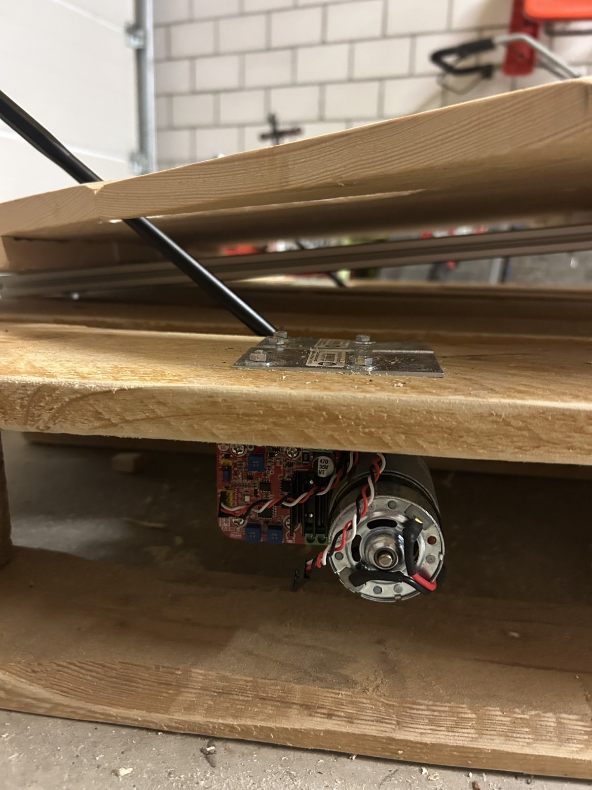

  3. Dude
    Dude New Member
    Jun 22, 2025
    6
    51Coins
    I'm also a bit curious about that, but at the same time i'm relatively positive. They're specified as 400kg/cm @ 28V. My lever is 6cm, therefore i get about 60kg force per motor. The main weight stays on the main joint, so i stay positive about that. Still have the option to add couter weights and/or adding a supportive gas spring
  4. Dude
    Dude New Member
    Jun 22, 2025
    6
    51Coins

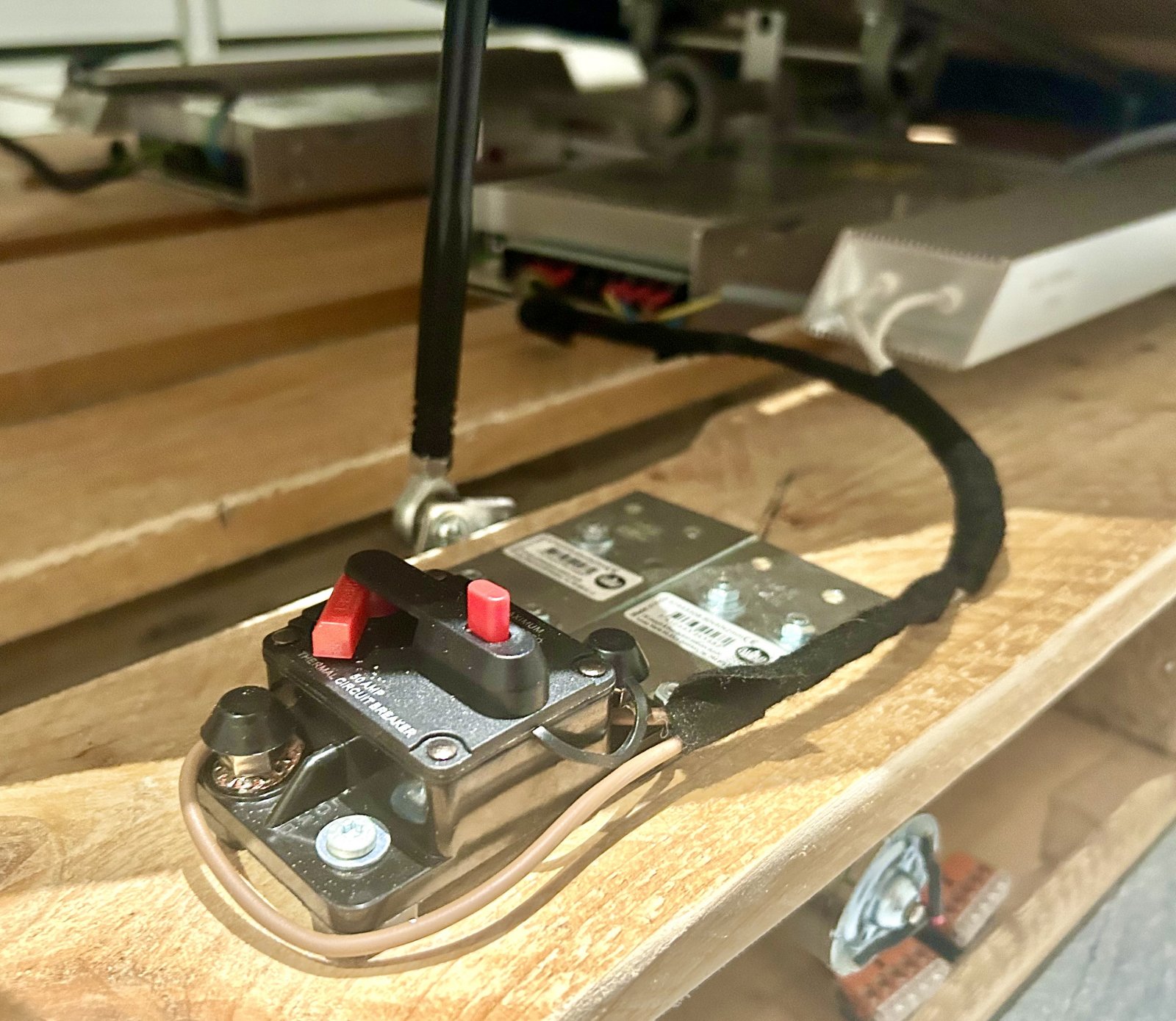

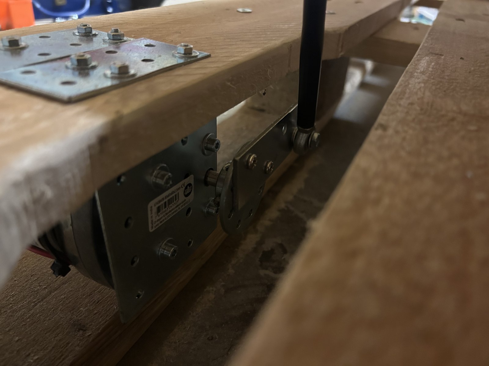

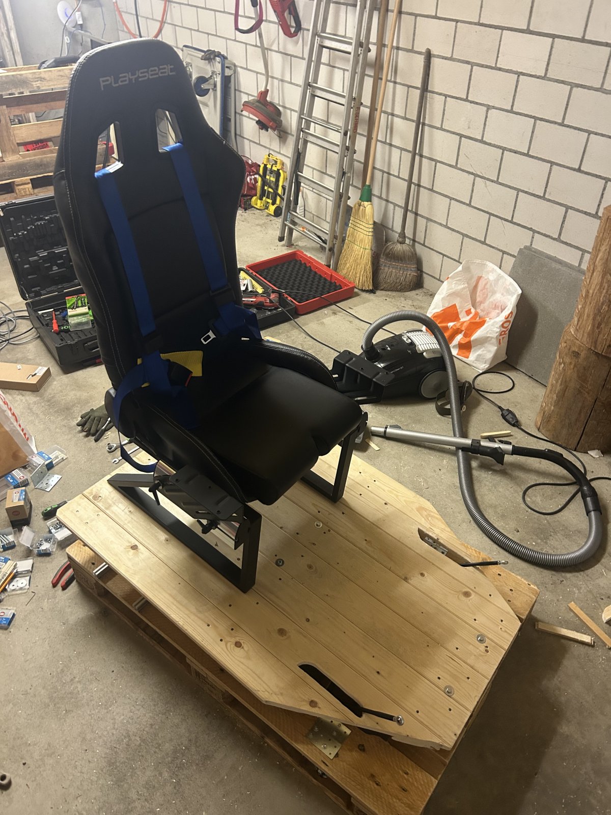

    Placed the suspensions and mounted the actuator rods:

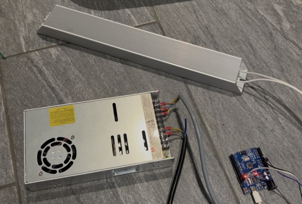

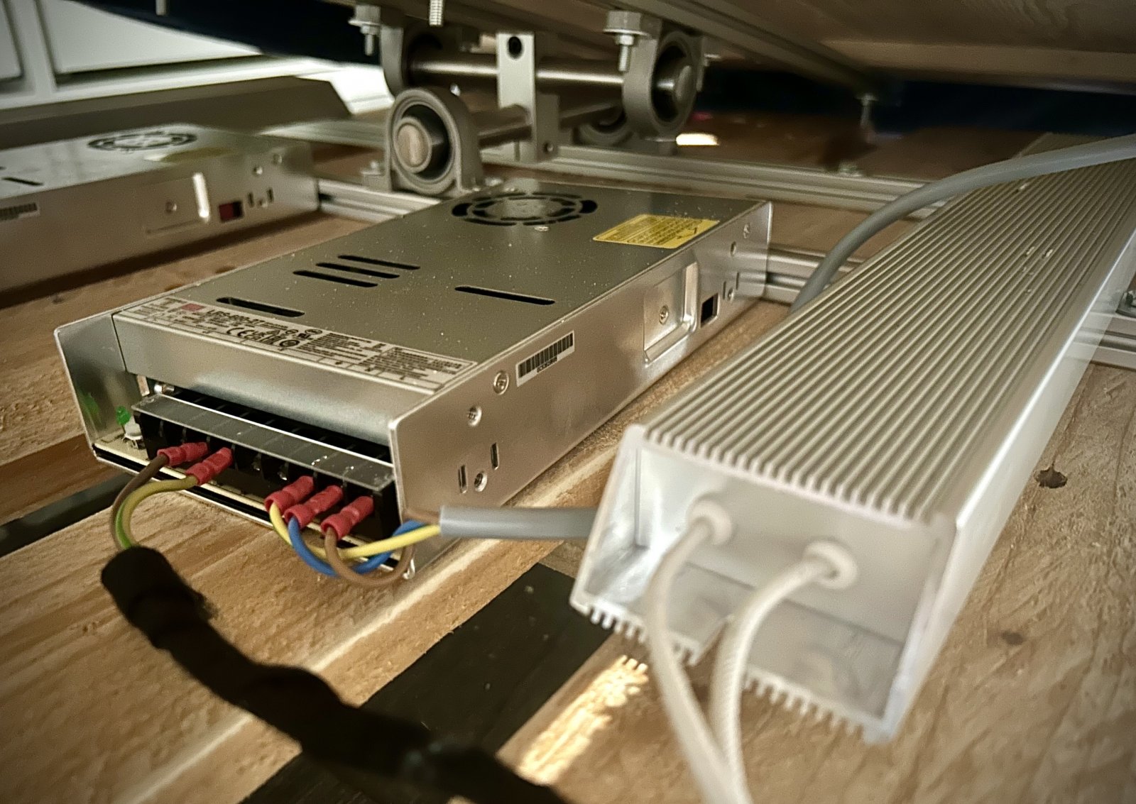

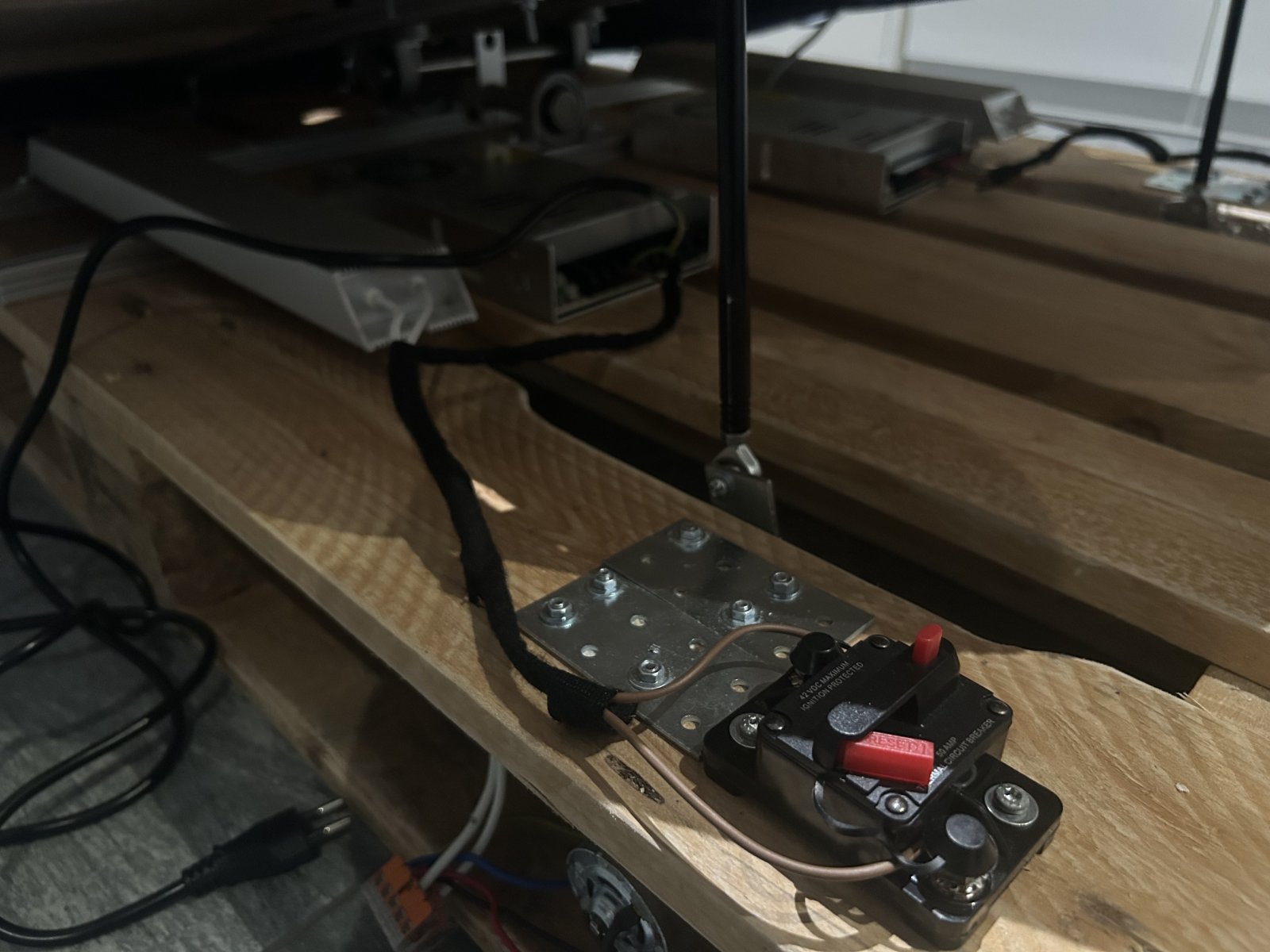

    Seems to be stable so far, waiting for the brake resistors to arrive so i can test the motion.
    In the meantime, i'll continue to mount the seat, power supplies, wireing and also start building the cabin.
