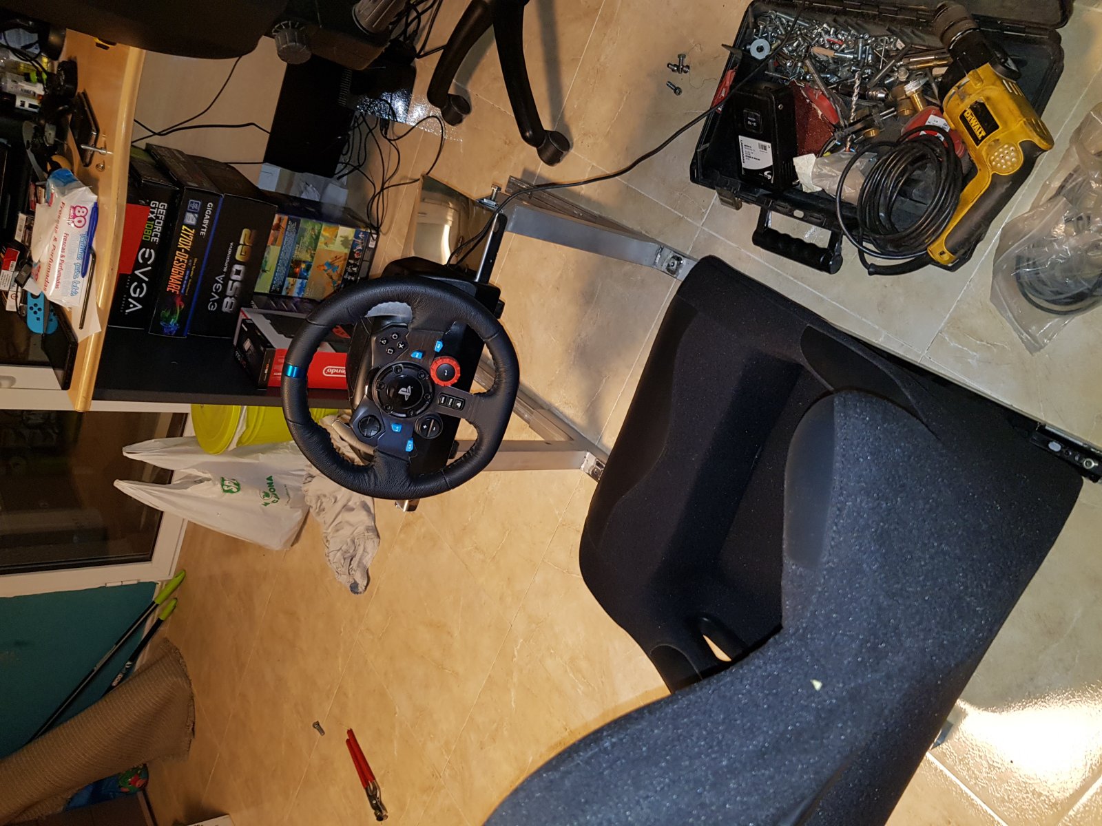

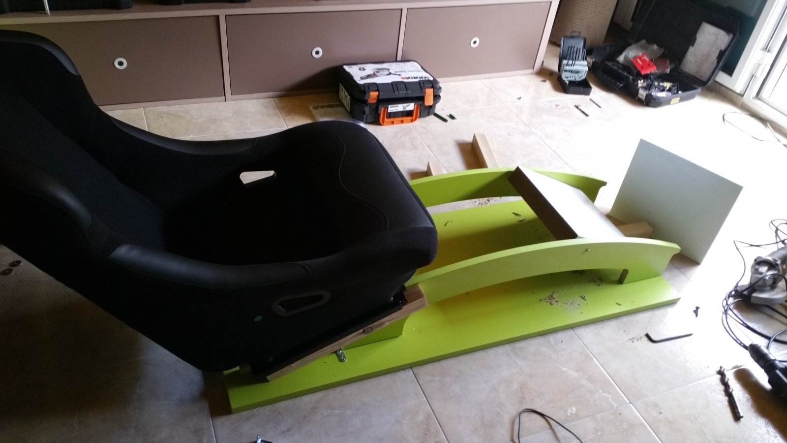

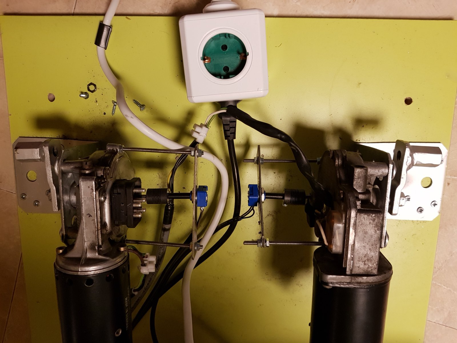

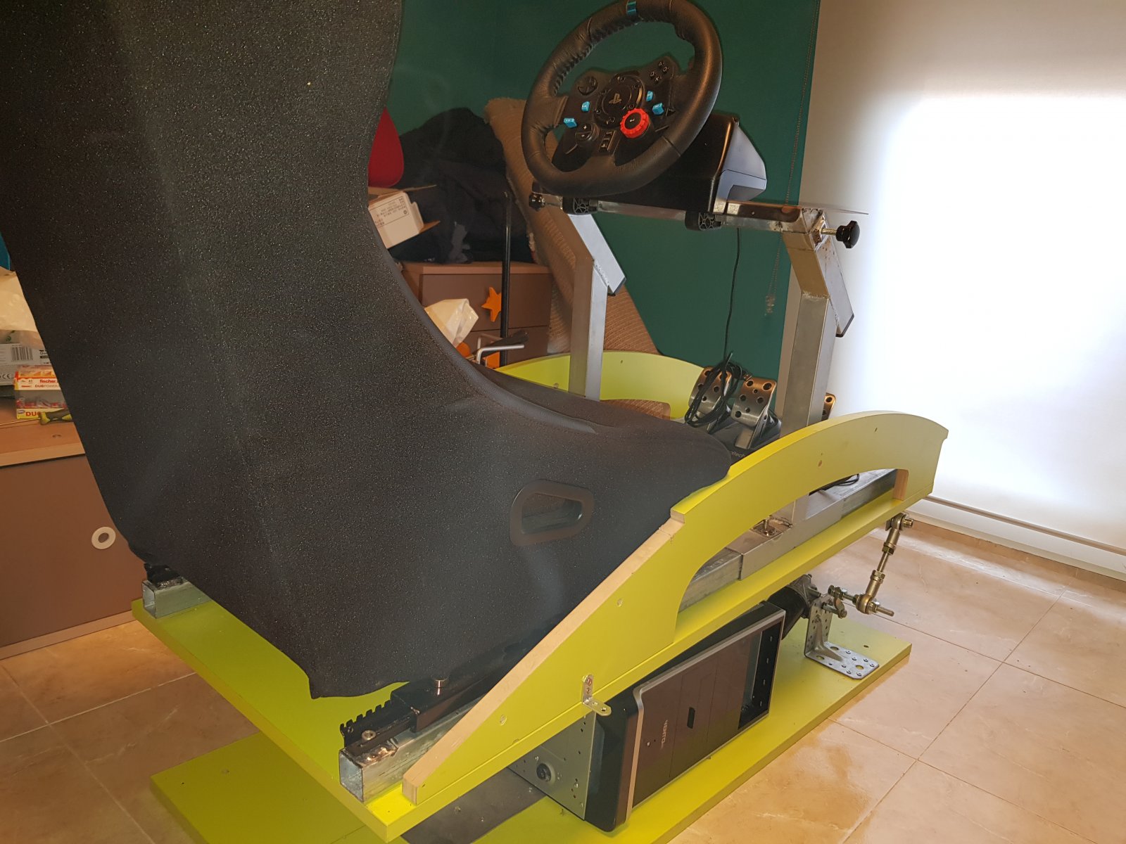

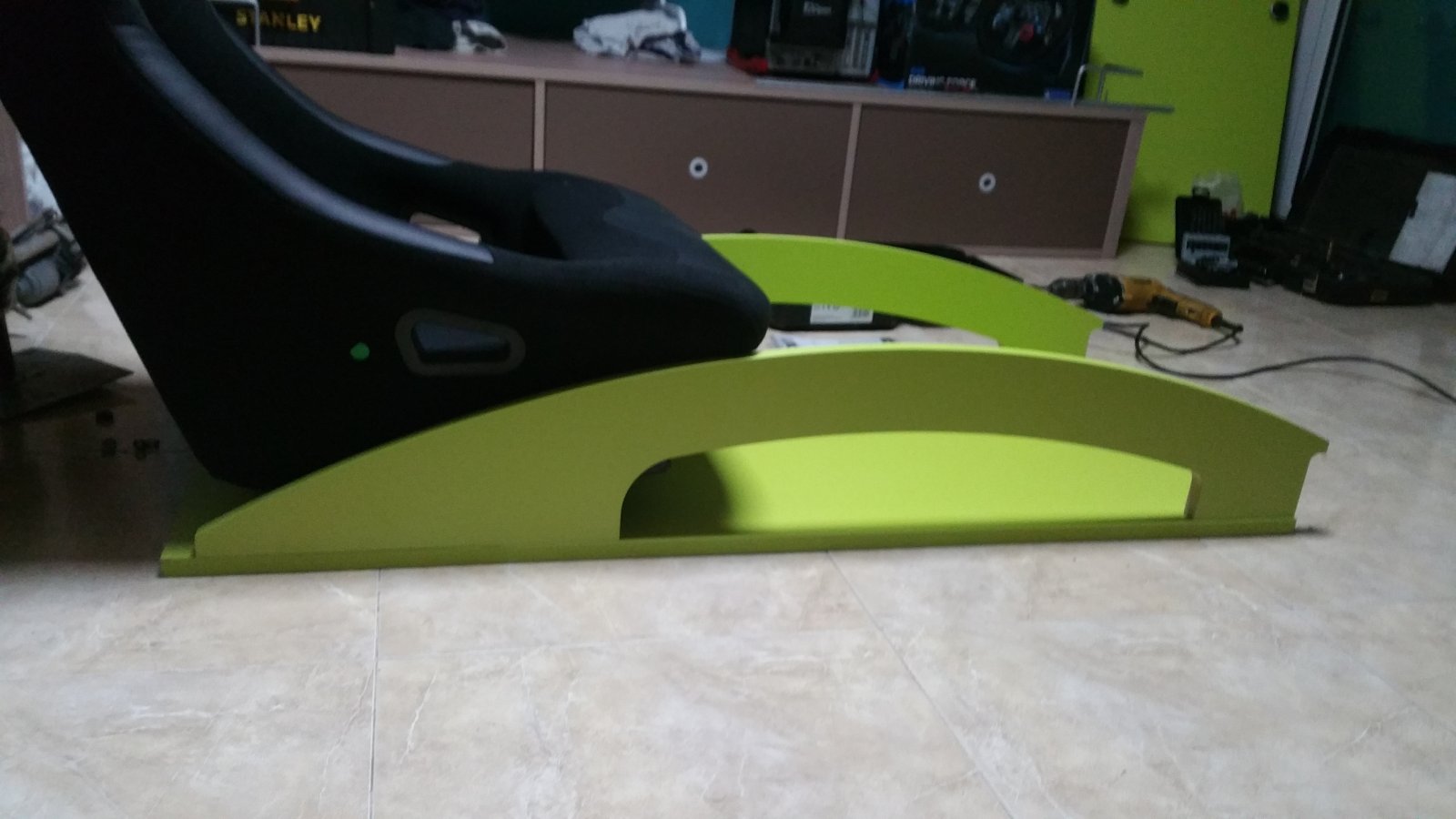

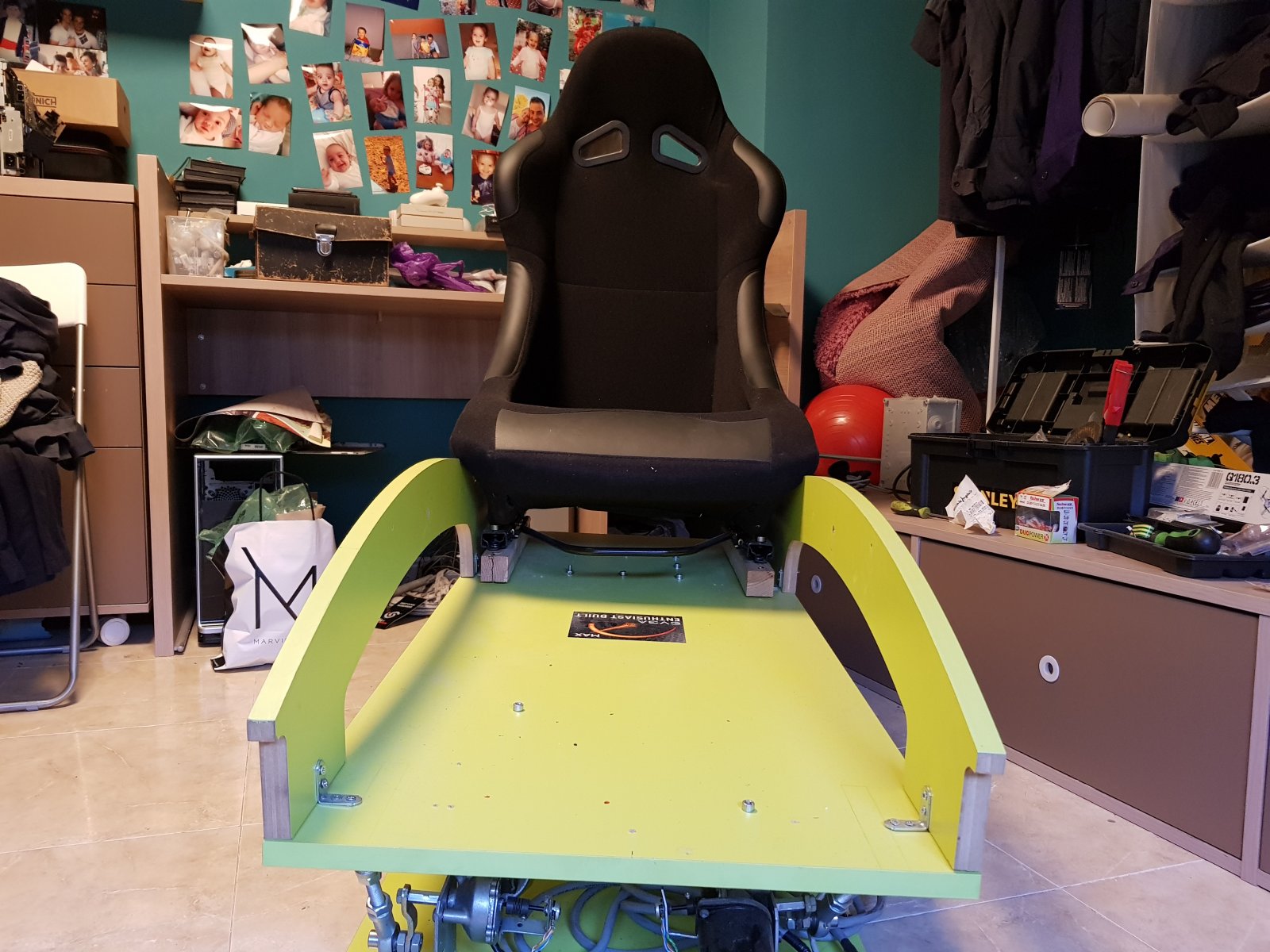

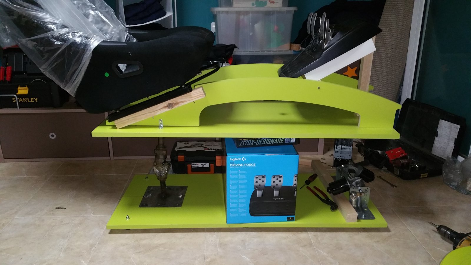

    Good friends I want to share with you my project of my simulator 2dof I have been working in the long time I will upload photos to share with you

    Thanks for sharing your rig.
    Can you please give a bit more information about the hardware you are running.

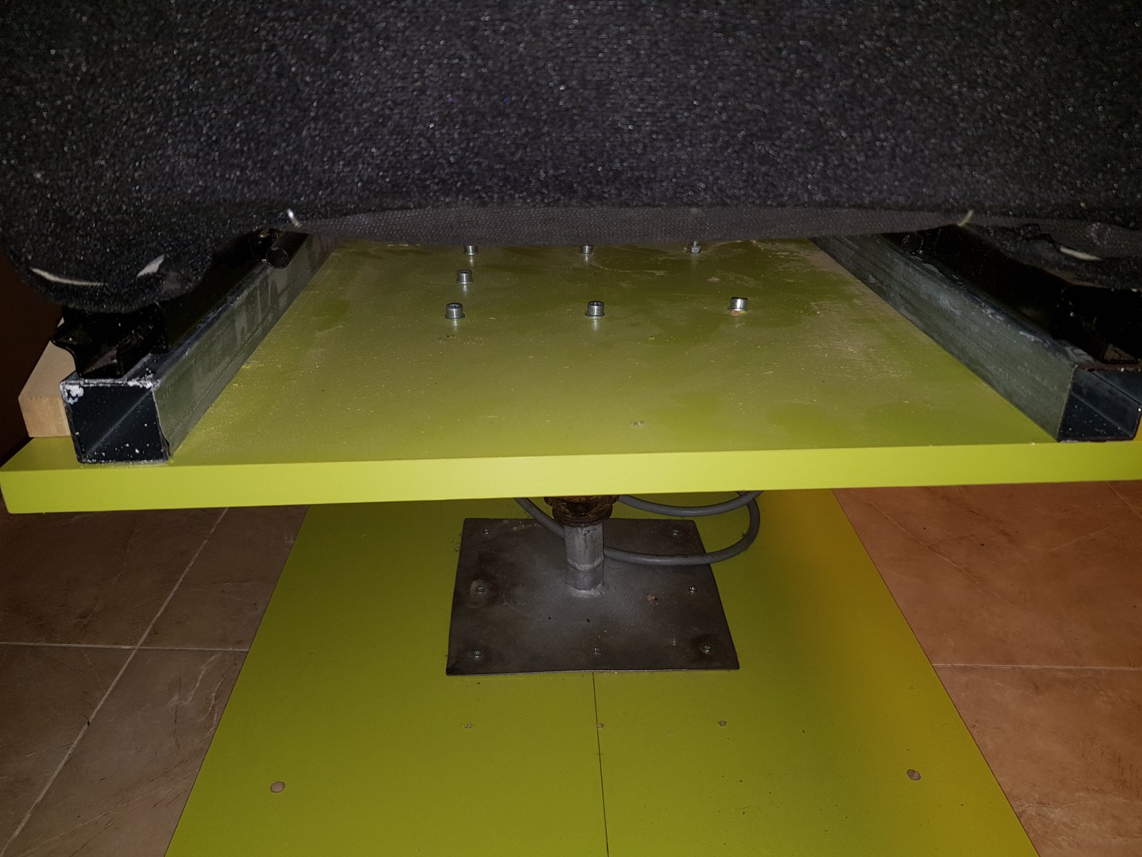

    Soto, would be quite nice to see the bottom of the rig, mechanics and mounting points etc. Very neat rig

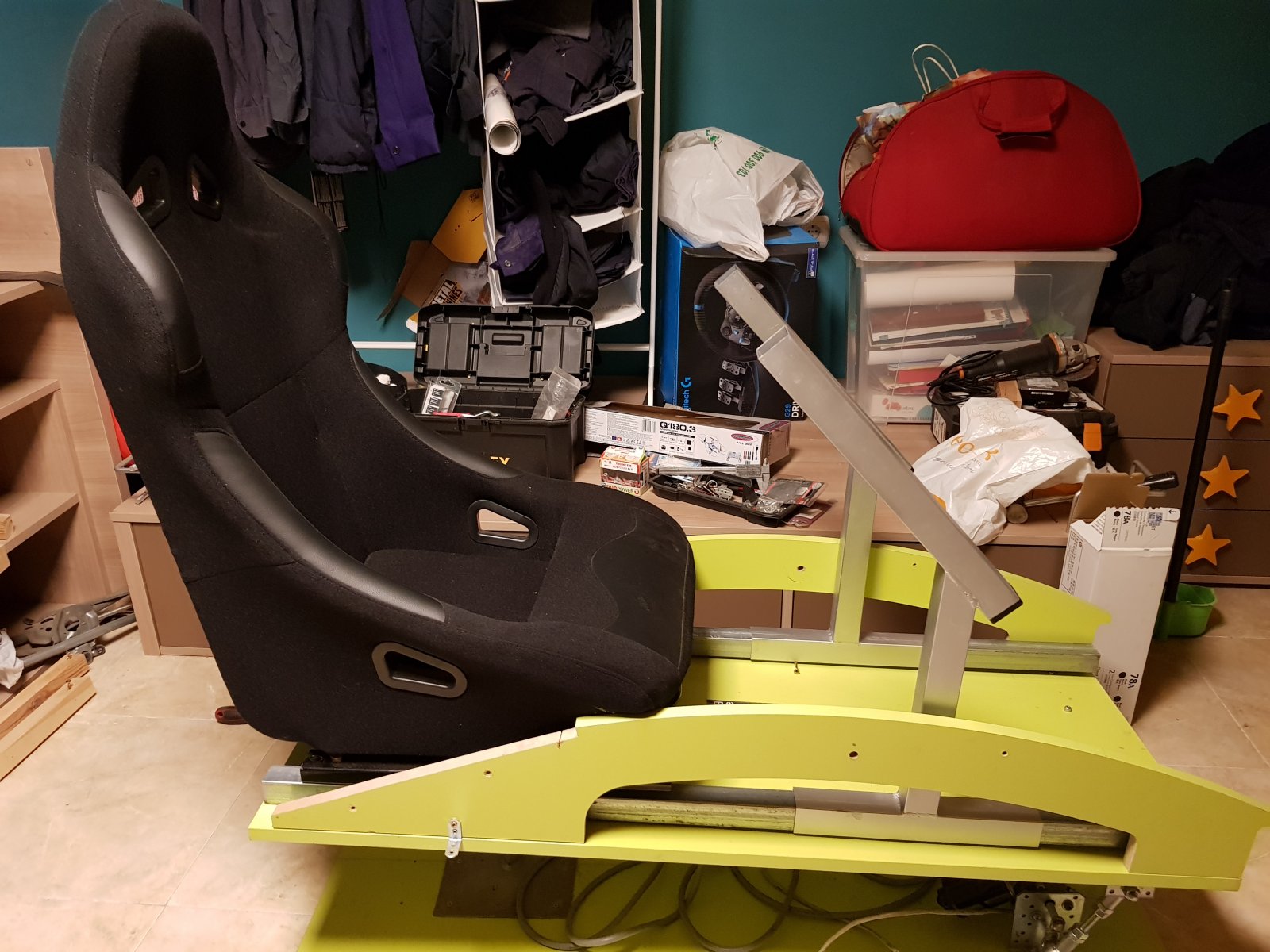

    so I started doing this simulator wanting to put the chair with the inclination but then I was forced to change it because the engraving center could not get it out

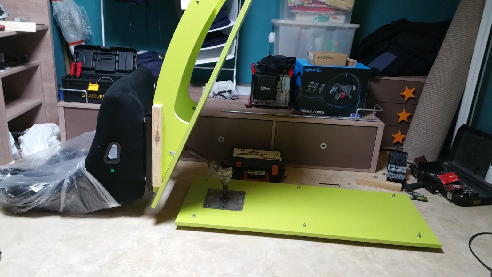

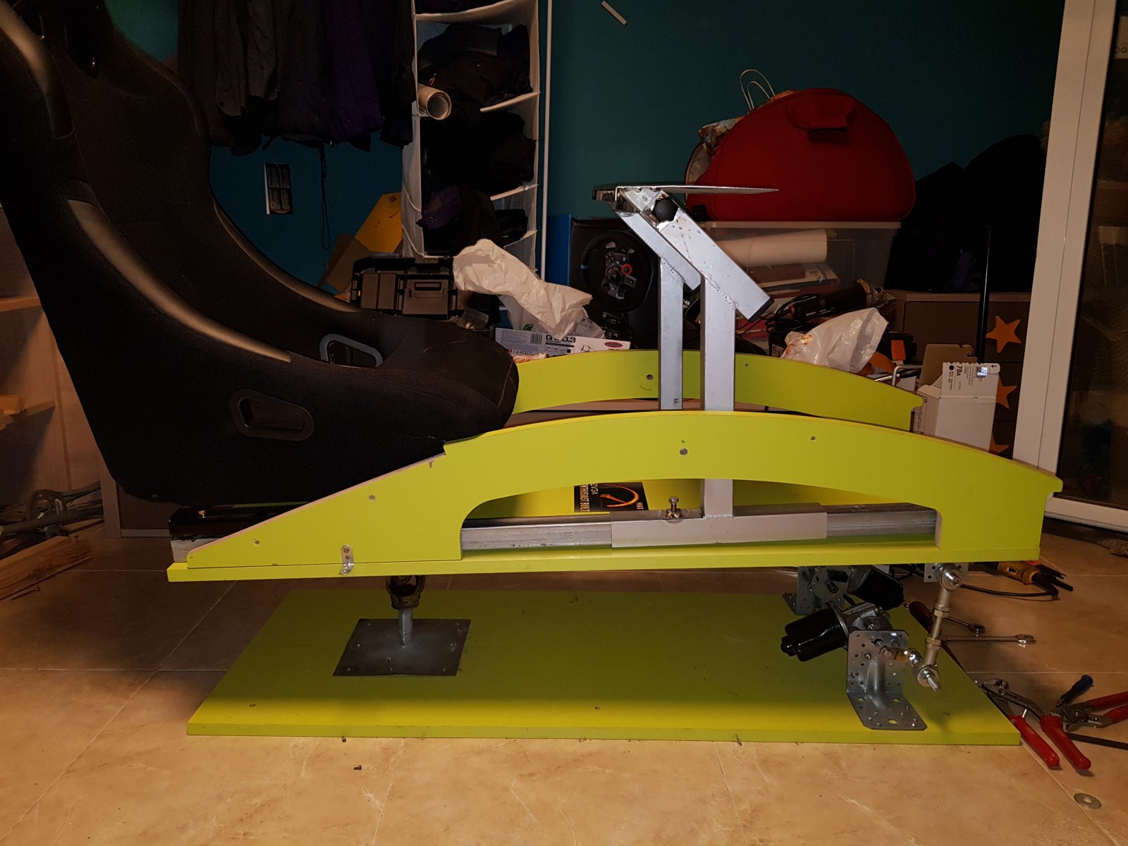

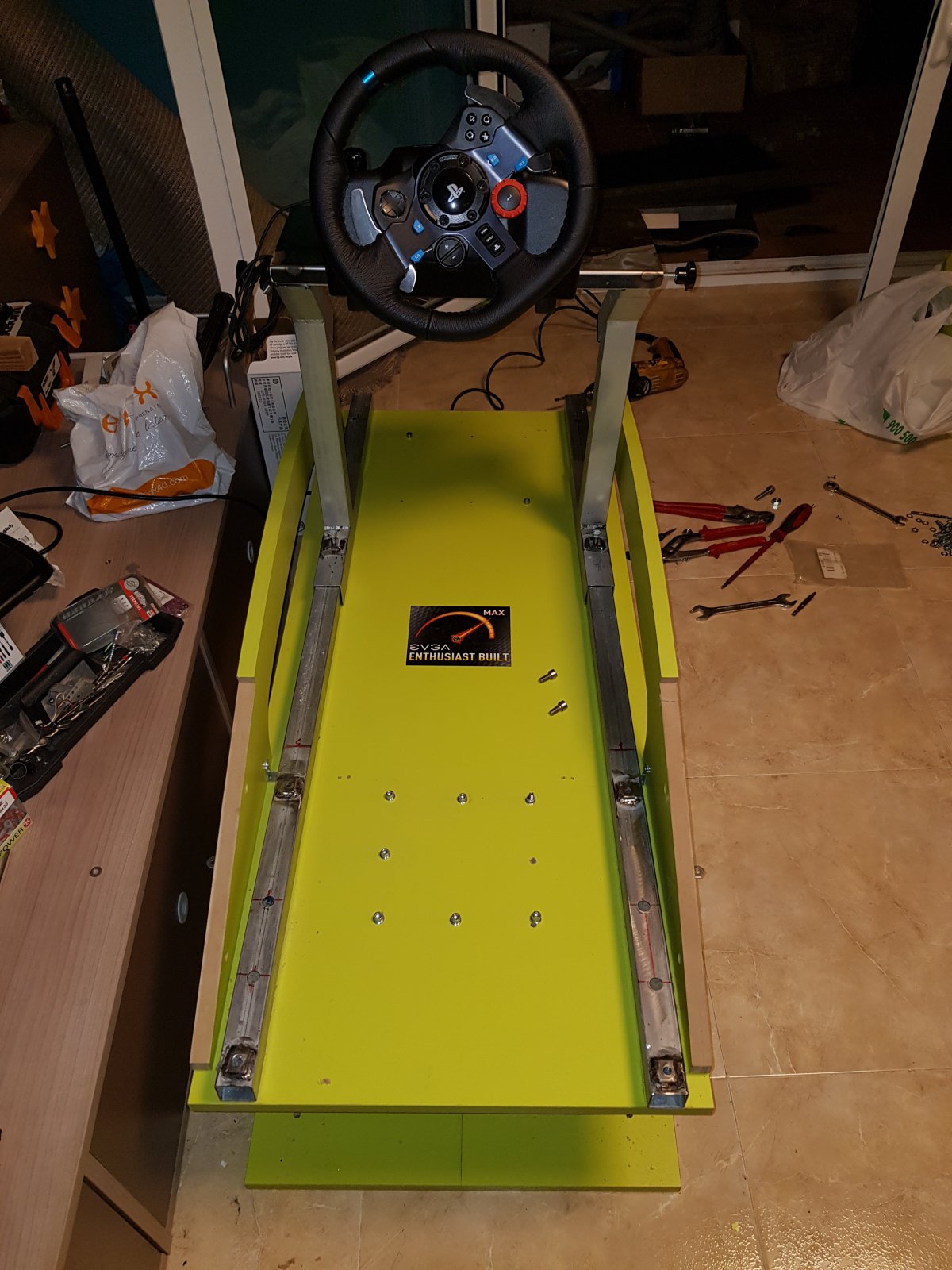

    So was my first attempts

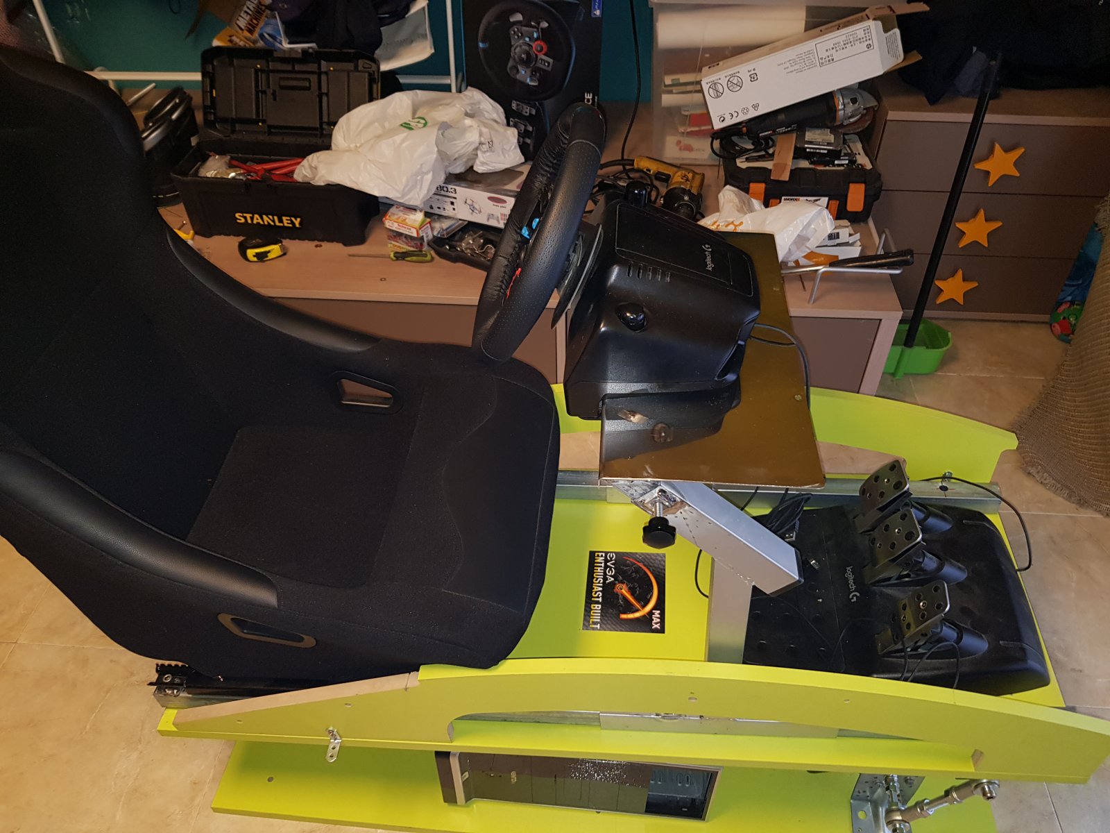

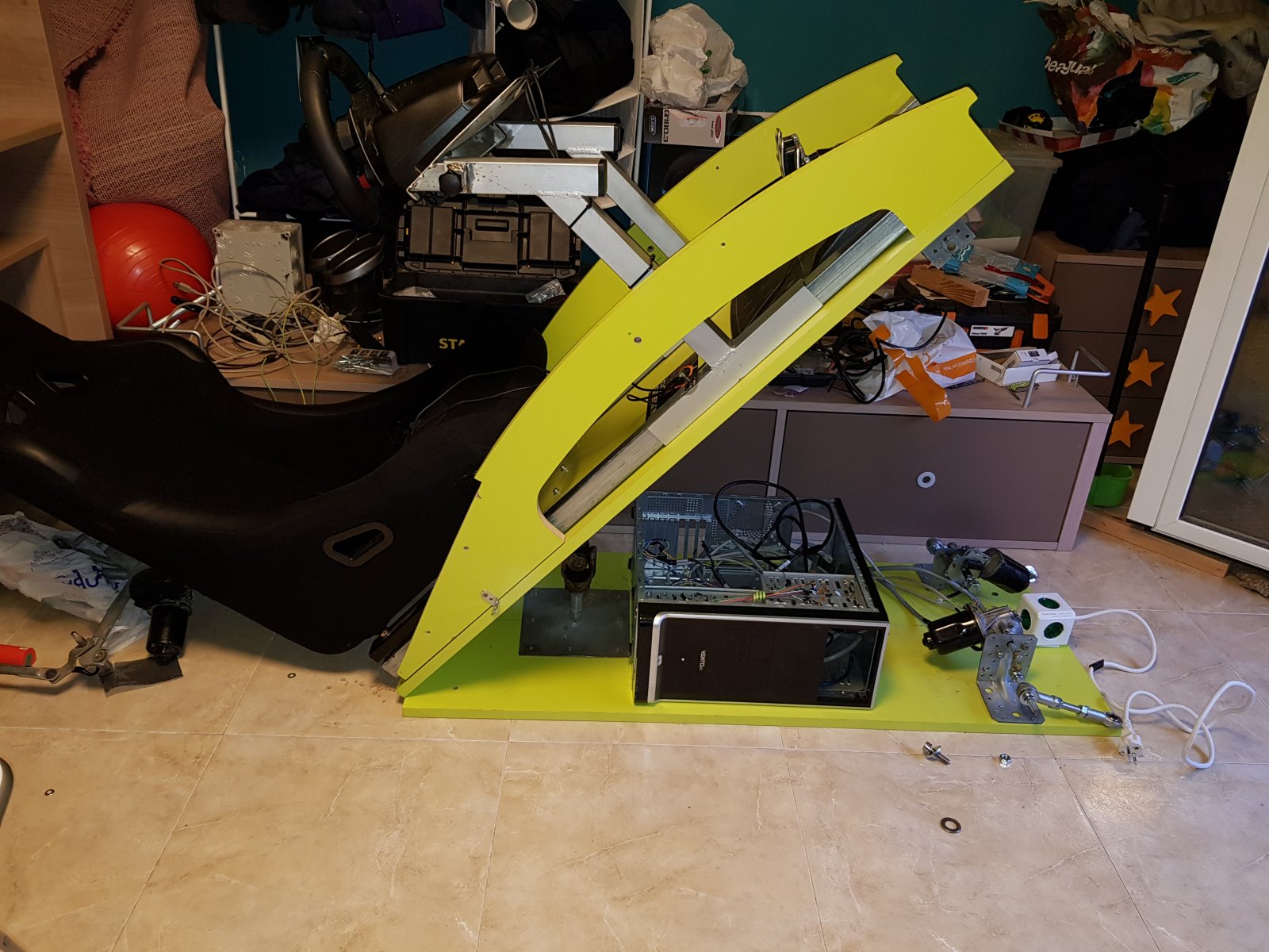

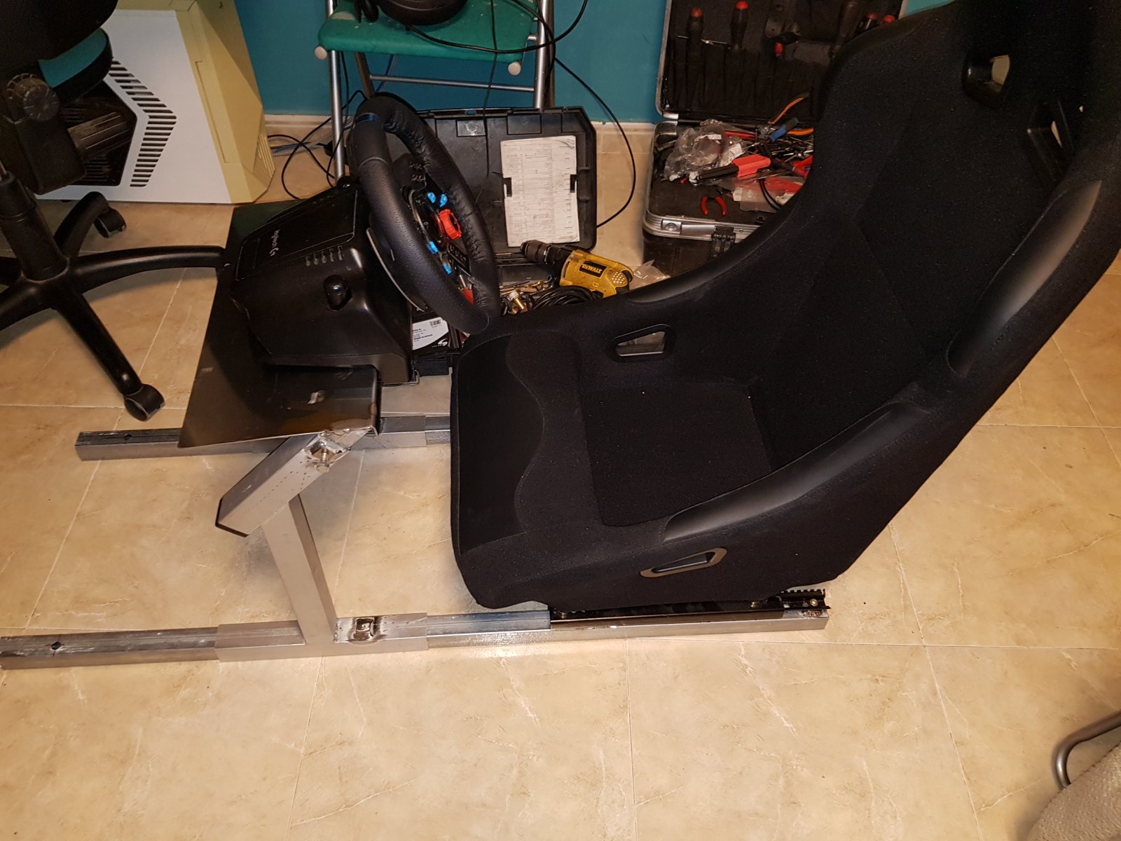

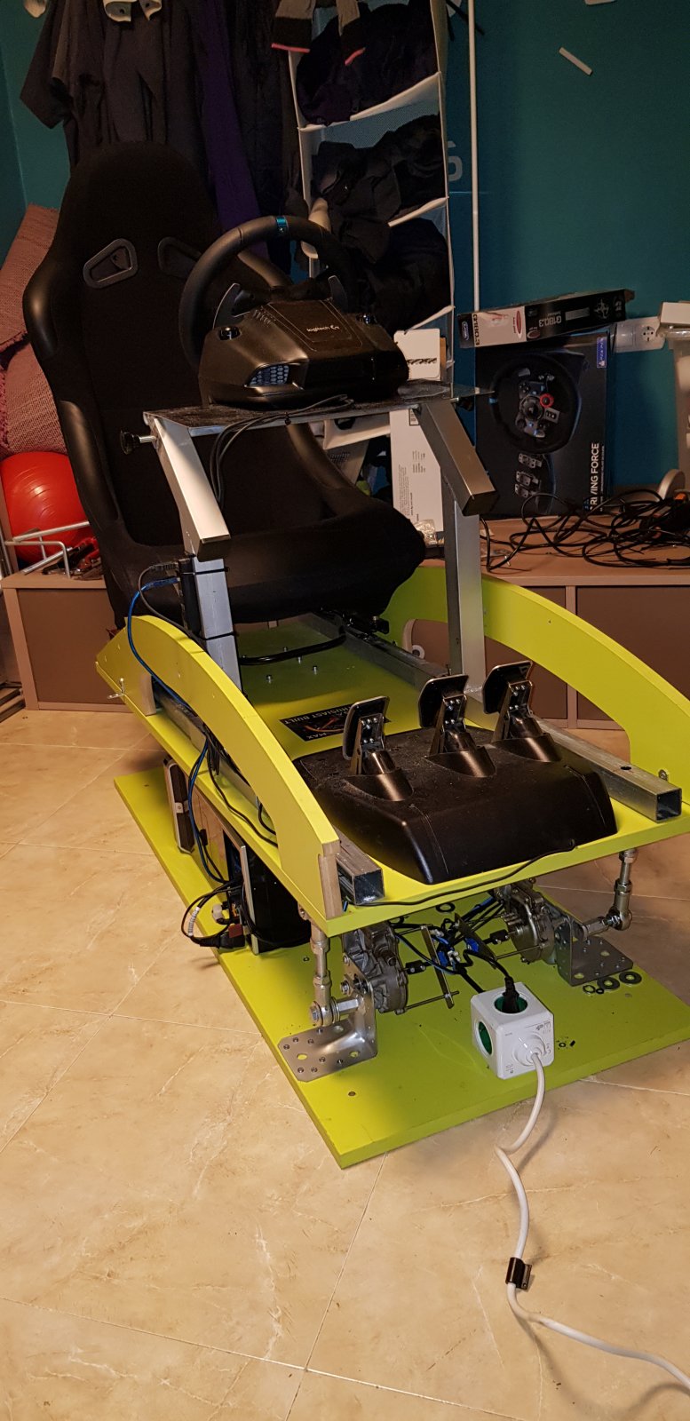

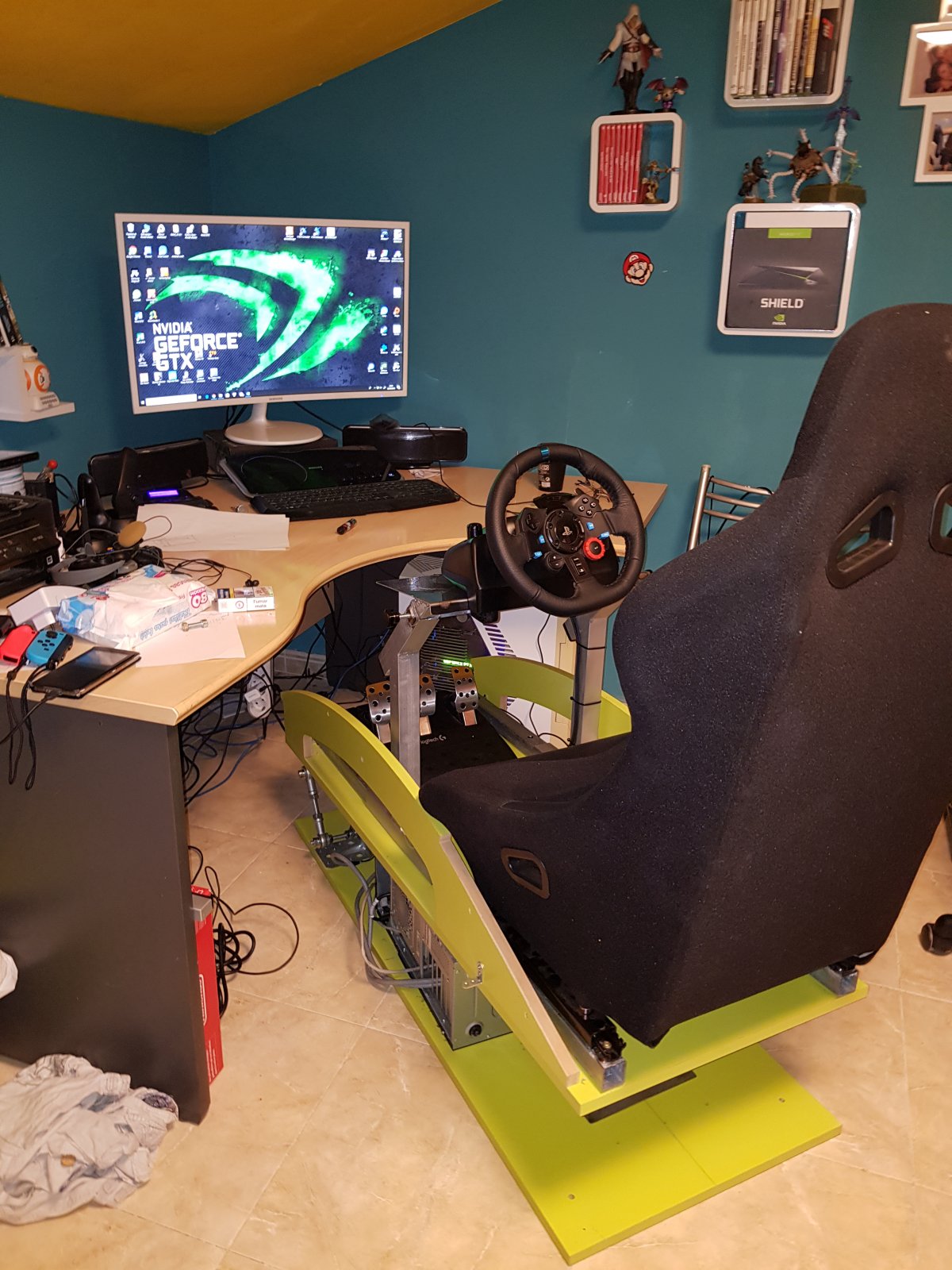

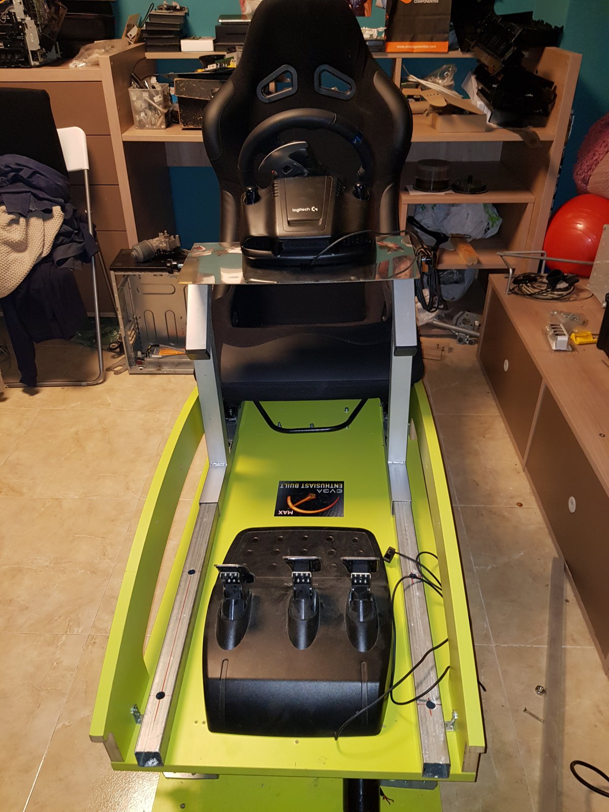

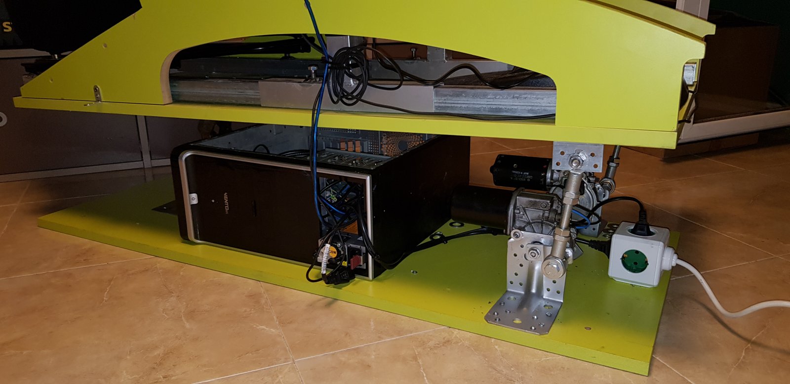

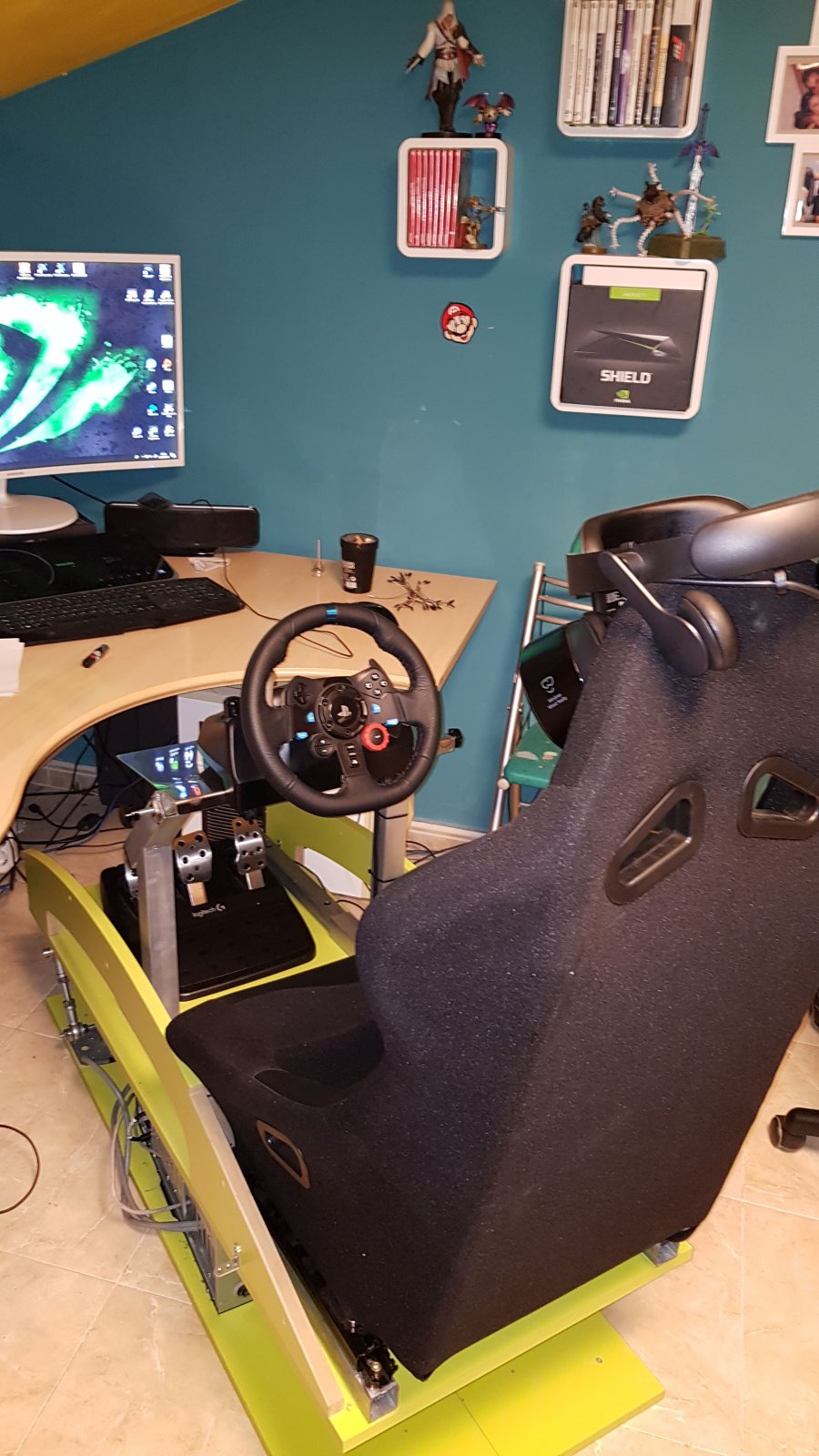

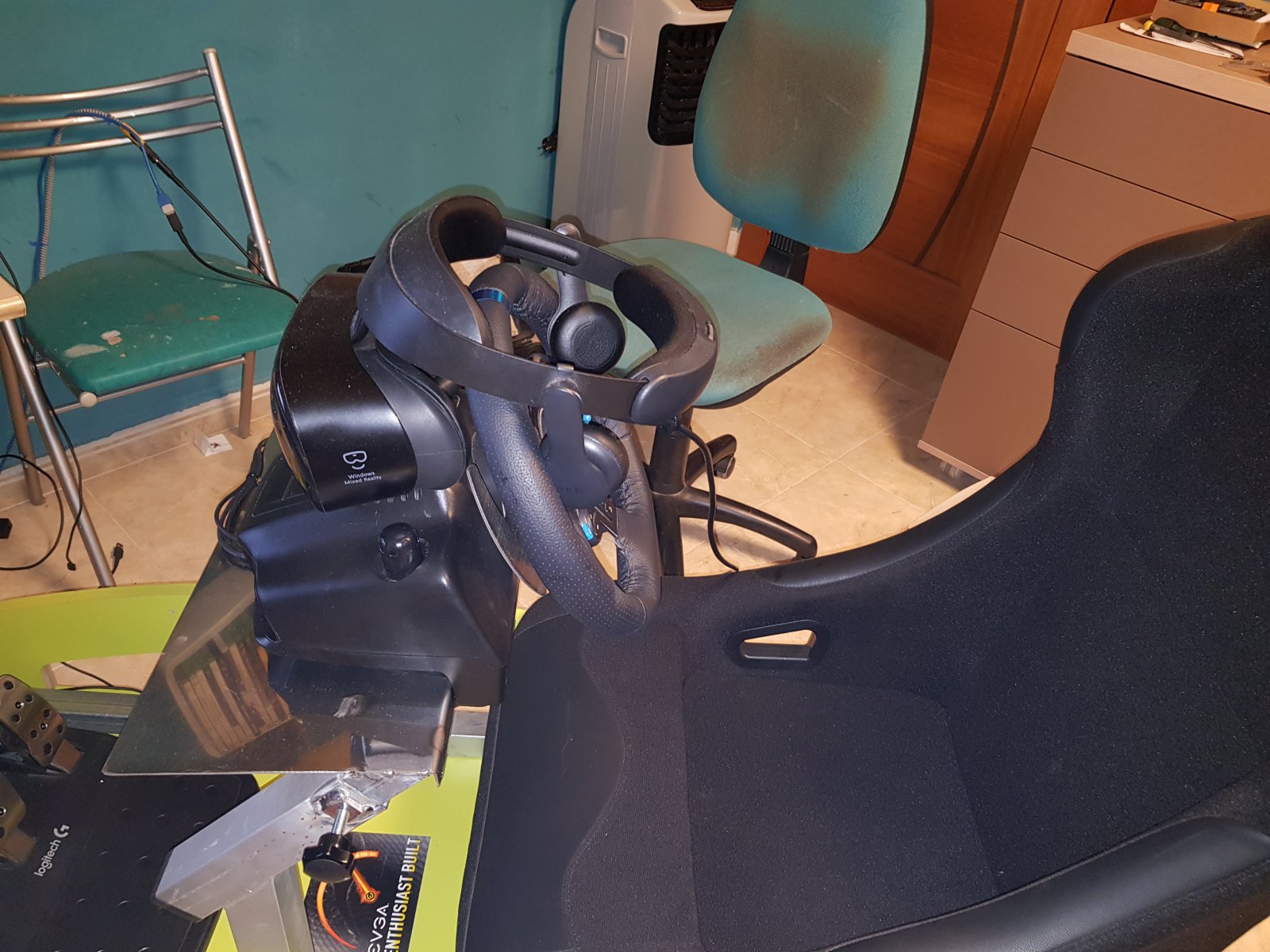

    This is how I have evolved my project and I just need to try it and make adjustments and I would love you to grant me a license to do it and continue contributing things to the forum, if you have any suggestions to improve my simulator I am open to new ideas a greeting

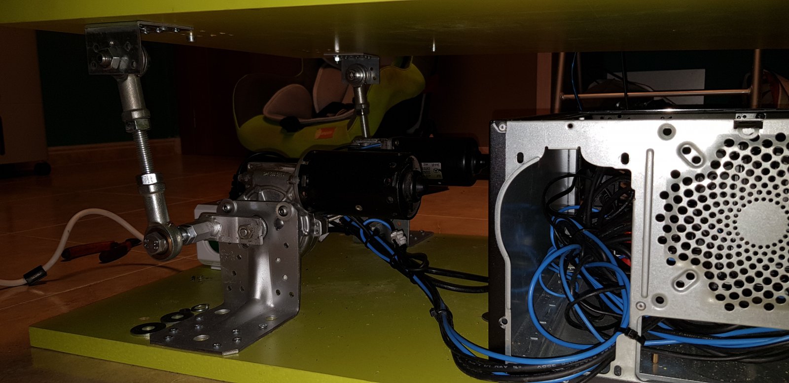

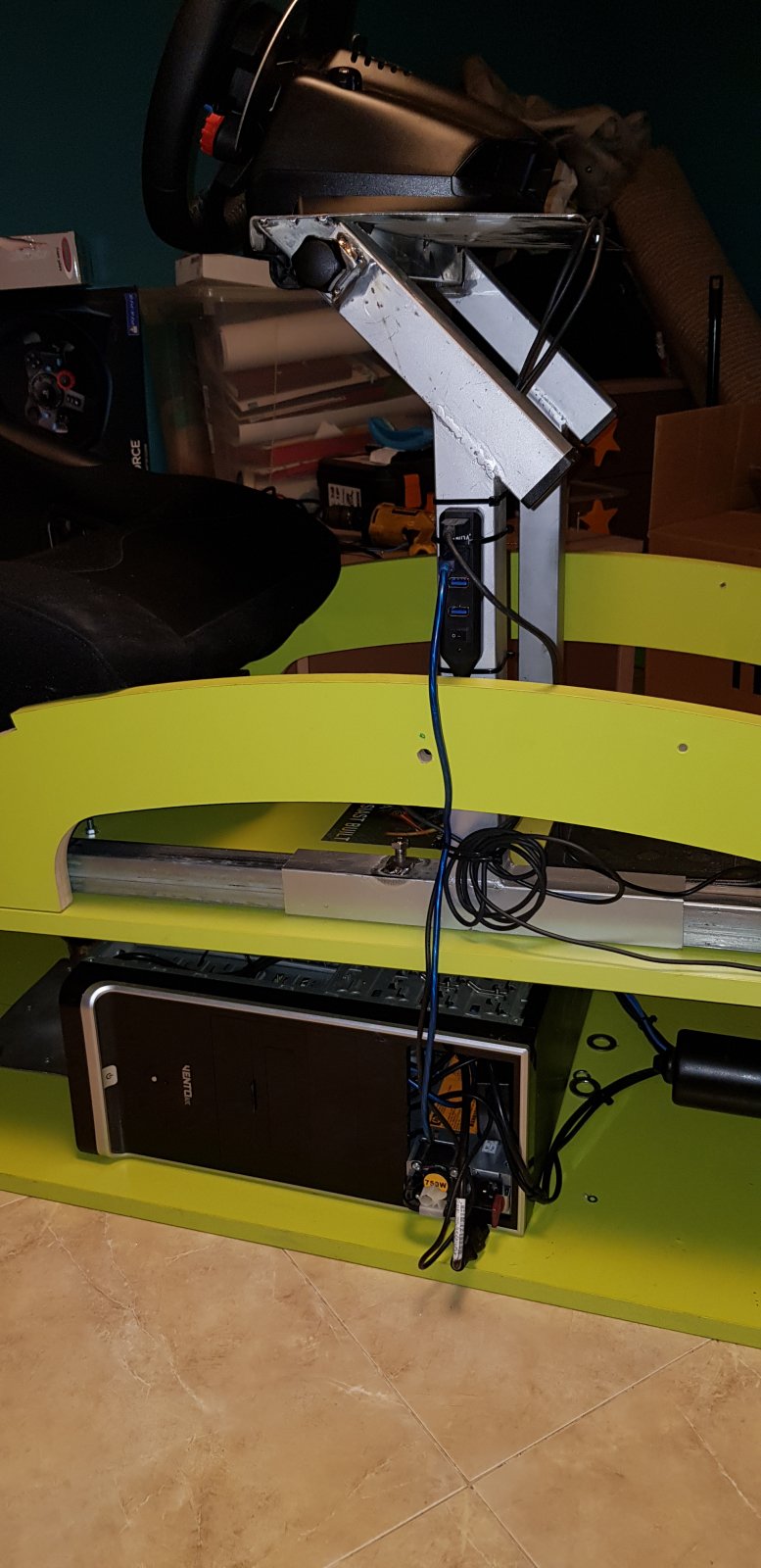

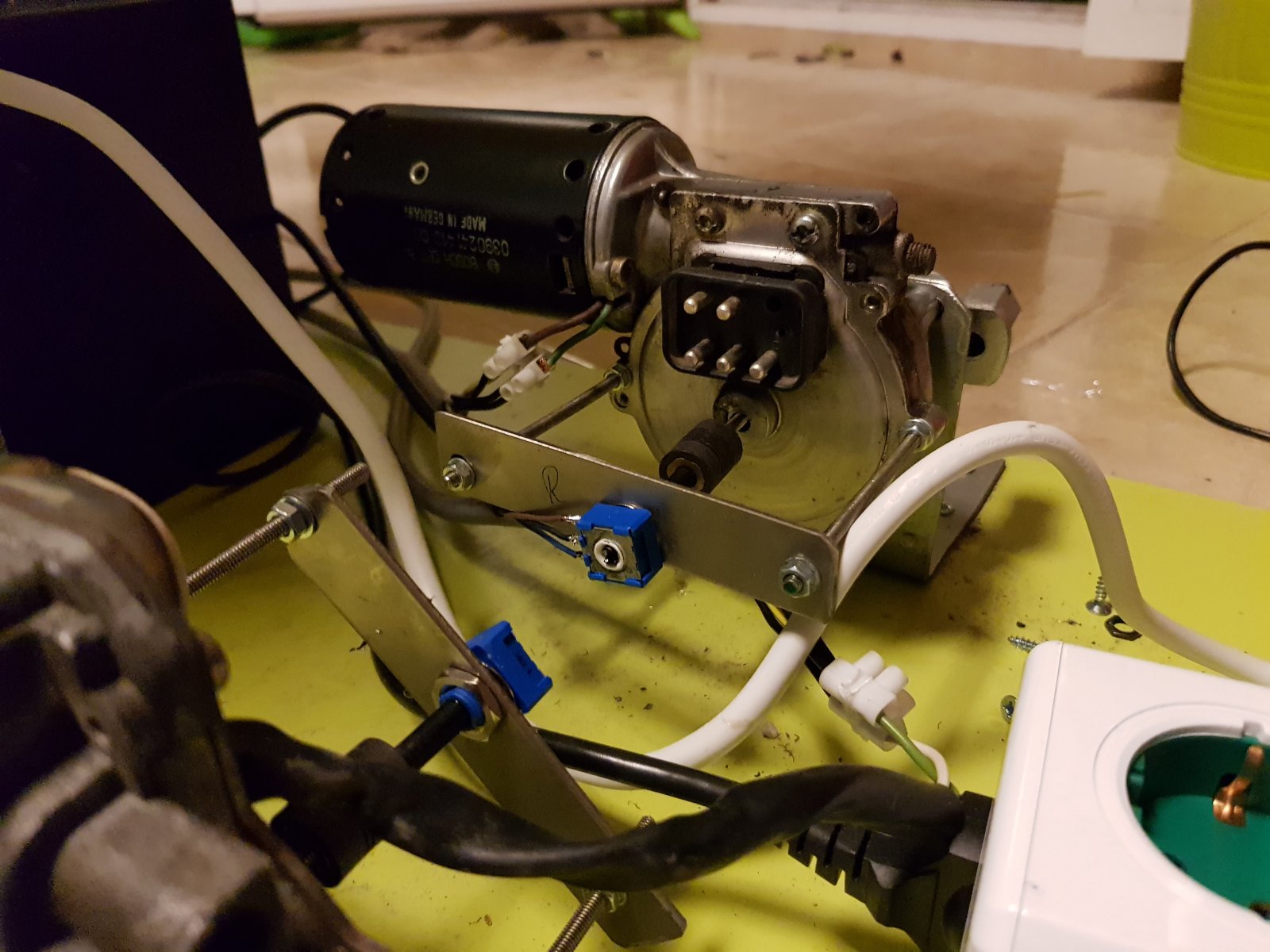

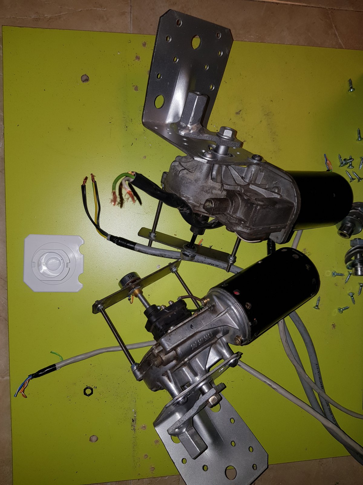

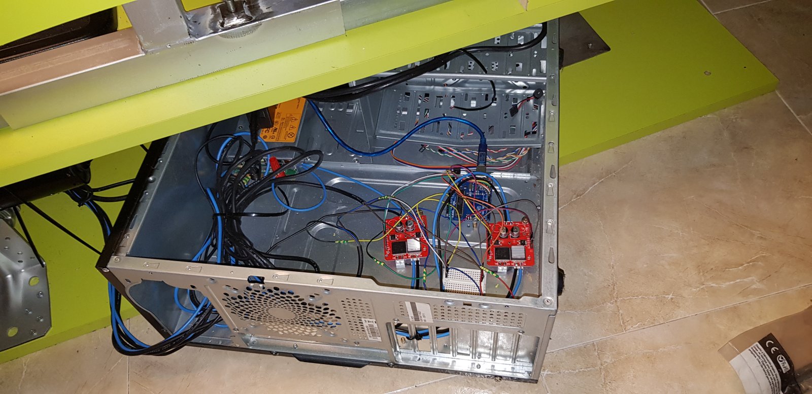

    the hardware of this simulator has been done with an arduino rev-1 and a motomosters shield and a power supply for the two windscreen wiper motors

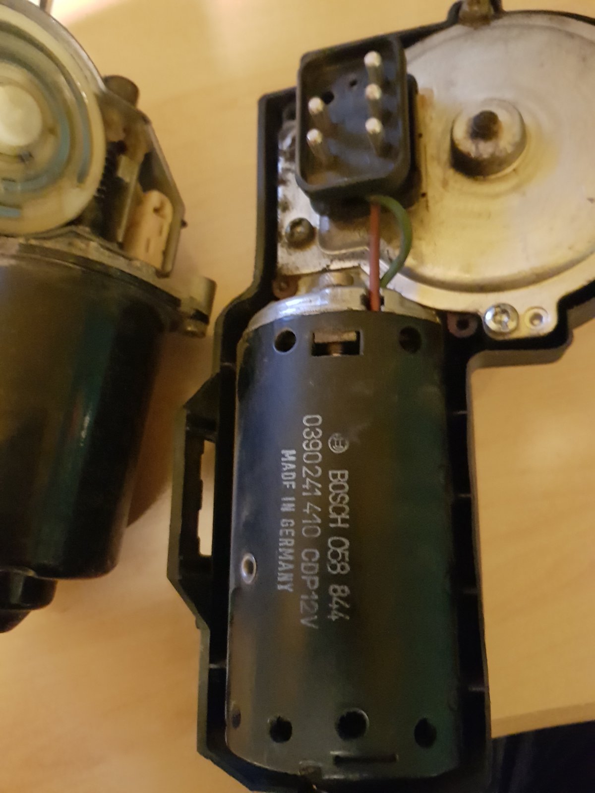

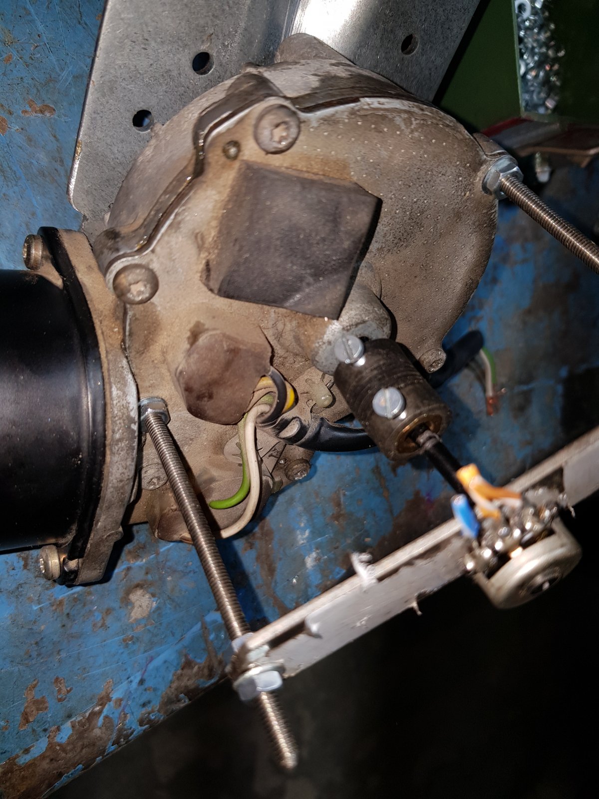

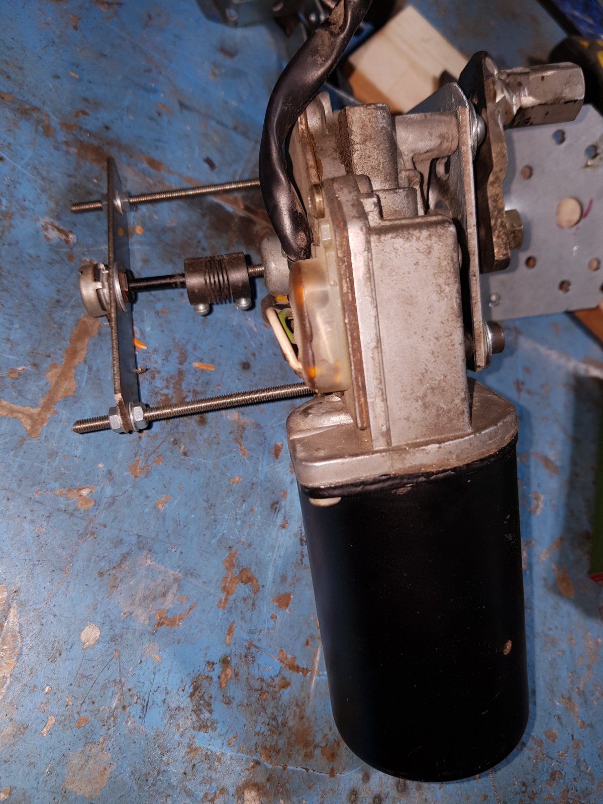

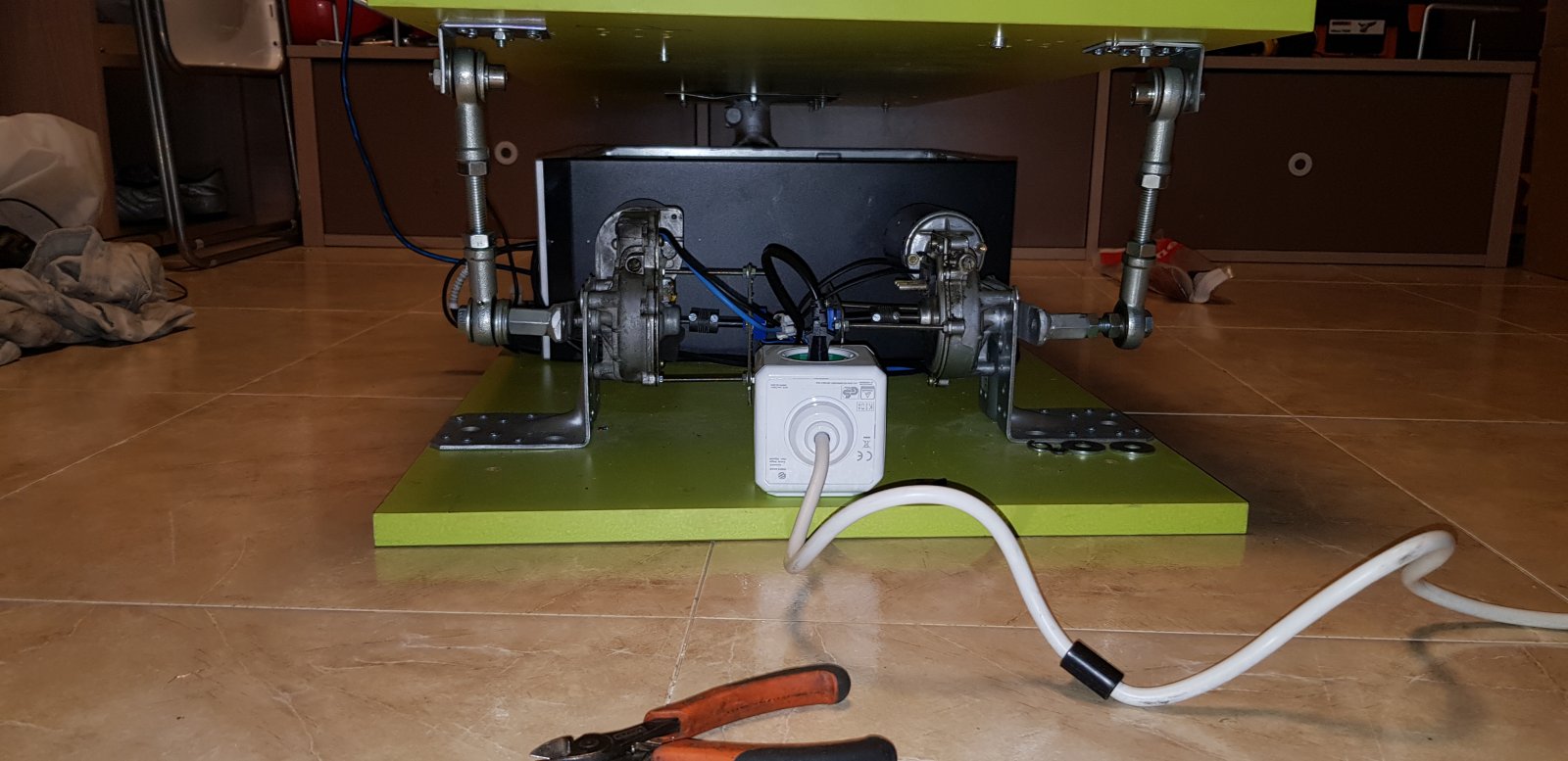

    I have changed the engines for failure in one of them and I have machined some new ones

    if anyone has any suggestions to improve my platform I am open to proposals
  20. noorbeast
    20,549
    145,112Coins
    +10,778 / 52 / -2

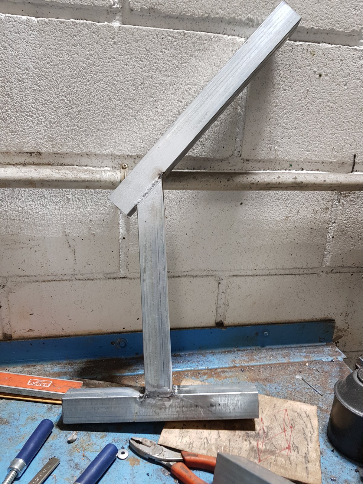

    A couple of suggestions:
    I have not seen your rig in action but I expect the engine mounts may flex, as they are pretty flimsy, personally I use 6mm thick angle iron for my engine mounts.
    A bar bar between the motors will add structural rigidity, I use a solid aluminum rod:
