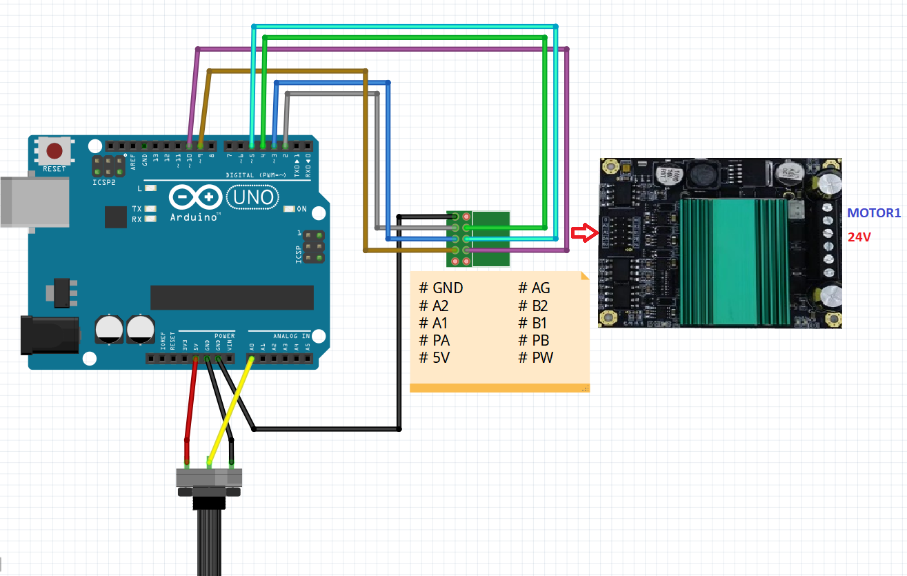

    Hello!
    I'm trying to make platform drives, but I'm having problems with the smooth operation of the motor.
    components I used:
    - DC 24V 250W motor (wheelchair)
    - Hall potentiometer 6127V1A360L.5
    - DC 12V ~ 48V 100A controller (Aliexpress)
    - Arduino Uno + Shield
    Software:
    - Arduino SMC code
    https://drive.google.com/file/d/1y0vorE4k5fFaJBjK8lhGiyDnpI0ndUL9/view?usp=sharing
    - My connection diagram:
    https://drive.google.com/file/d/15zbrHMCDrDrVQ3_POF3GRqYH5Xr2kX3G/view
    - SMC3Utils v1.01 program
    - Connection according to this thread:
    https://www.xsimulator.net/community/threads/reasonably-priced-100a-motor-controllers.17638/
    Below is a link to videos showing the motor movement:
    https://drive.google.com/file/d/1uD8XQB_LmRU0l8eaWVO9nYhBhwOgGx0p/view?usp=sharing
    https://drive.google.com/file/d/1pqdcBGjP7ihNawg2KfaXwbGOLgylTLpx/view?usp=sharing
    Please help me what I am doing wrong, where to look for the error? I tried different settings in SMC3Utils v1.01, I noticed that the potentiometer reading is also detected on the second motor, despite the signal being only connected to pin A1, for example.

    Start by setting kp to 200-500 and ki to zero.

    I don’t see a 5v connection from the adruino to the motor controller. Your potentiometer is connected to 5v but not your motor controller
    Your motor controller will need read the pwm signal until it has a 5v power source.
    Connect the 5v from the h bridge to the adruino
    You will need to use a breakout board or splice the 5v connection with the 5v wire on the potentiometer
    If you don’t want to splice wiring together you can obtain a breakout cookie or breakout board that will give you more 5v connections
    If you spice wiring I recommend soldering the wires and using heat shrink tube to shield the connection

    Thank you for your valid attention. I missed it, but for some strange reason I started entering commands to move the engine via the serial port: [en2], [mo2] and [A512] etc. and although the engine did not respond after entering the commands, suddenly the engine started working properly, the graph calmed down and runs smoothly "as if something had been unlocked" - even with no 5V connected to the controller...
