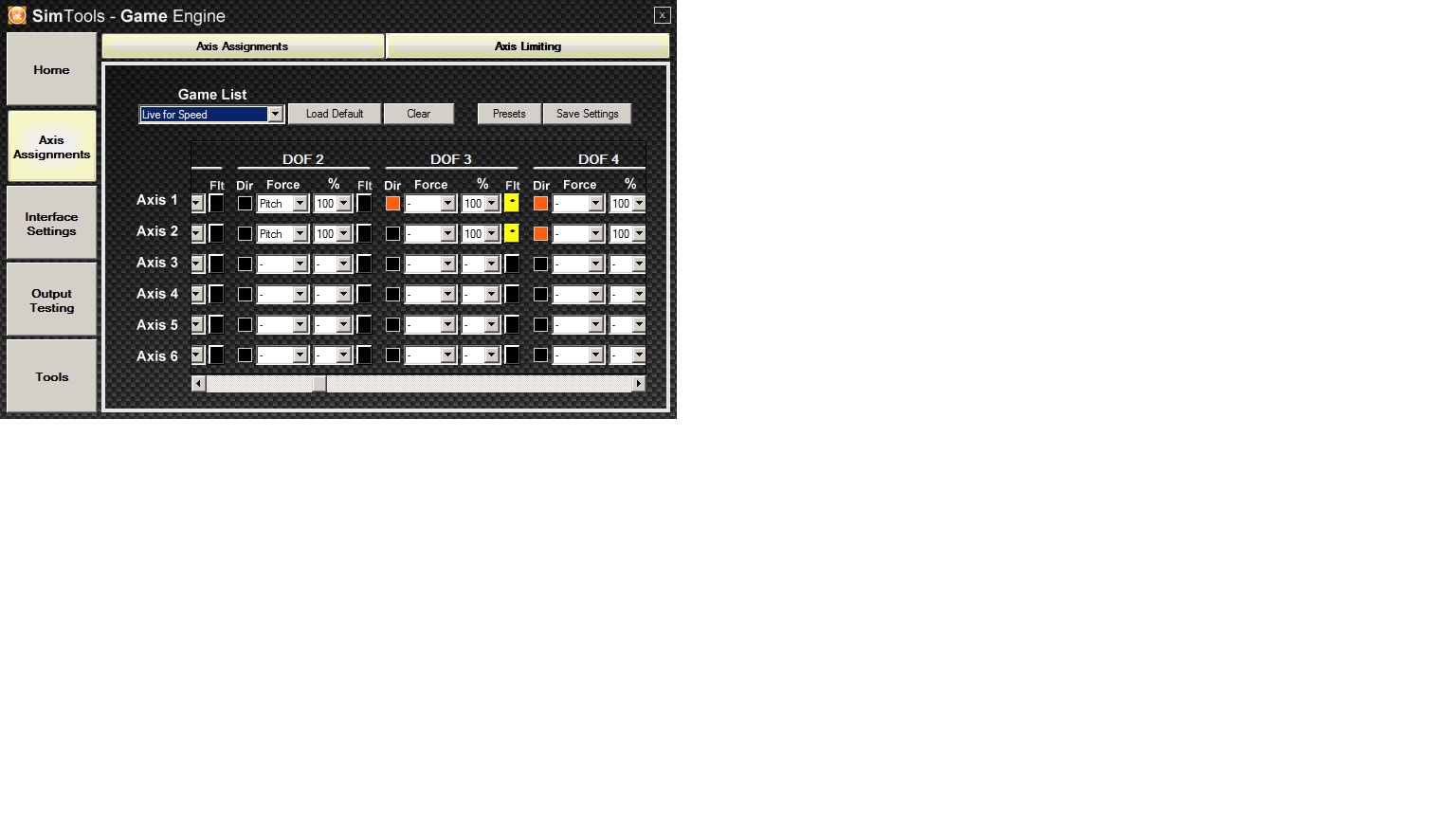

    I now get problem,
    where I setup and save Axis setting in SimEngine, play game fine
    Come out, go back in, all fine, but reboot and Simtools, looses some Axis settings,
    still shows 100%, but roll or Pitch is missing...

    Yes definitely, I save and sim works fine, I reboot & have to re-setup, some entries.
    I should say it only happens when I put in more the 2DOF
    I'm testing, combining Roll & Sway + Pitch & Surge, to give me all the game effects on 2 motors.

    Are you keeping the settings for each game in the same DOF columns as the default profile?
  8. Kass55
    Kass55 Member
    Aug 19, 2015
    70
    PC support
    UK
    315Coins
    +16 / 0 / -0
    No, I didn't realise I needed to.
    Thanks.
