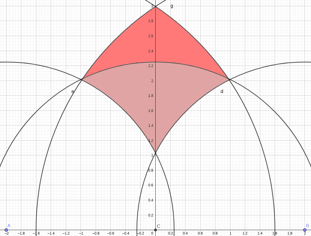

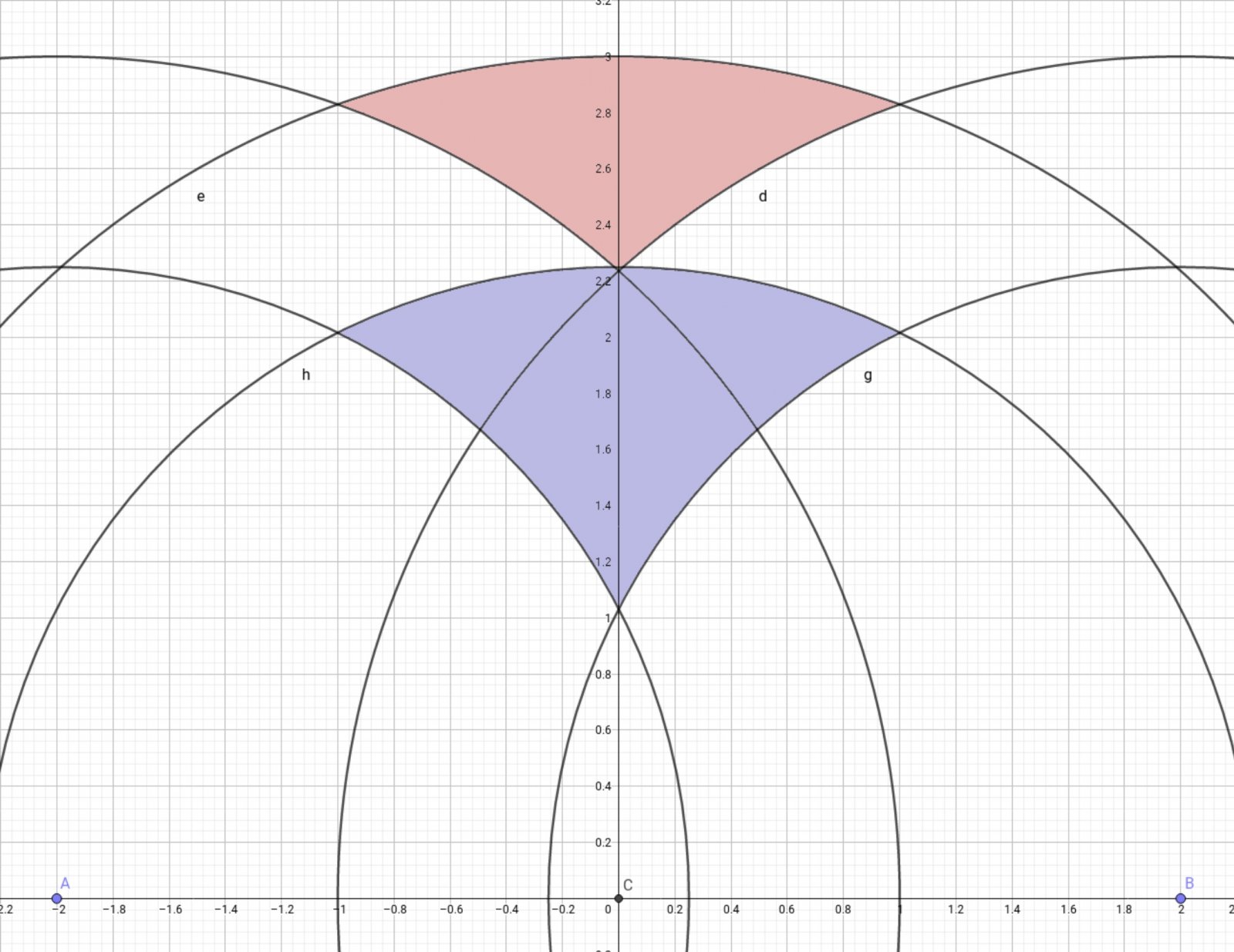

    I was trying to sort out range of motion yesterday and made a graph. In the method here, the strut length is fixed and the lower attachment points move along a track. In the graph I used 2 units of track length for each lower attachment point (2 feet) and struts of 2.25 units/feet (blue) and 3 units (red). The ranges of possible motions of the upper attachment point are then the areas that are colored in if I am thinking about this correctly. It should be easy to derive a similar graph for linear actuators and I’ll need to think how to do this for gearmotors with fixed strut length and lower attachment points that move in an arc.
    But anyway, what I think this also gives is the range of forces and how that changes with strut length. With the 2.25' struts (blue), when the attachment point is at that lowest apex right in the middle (~0,1), each strut would form a 30, 60, 90 right triangle with its ball screw and track, and the force the actuators would need to resist would be twice the weight of that attachment point. Two actuators so each is resisting the full weight of that attachment point. I need to think about that some more, though. Might be thinking about that wrong. I may also be leaving out a term.
    I’ll draw curves for regular linear actuators too but guess the range of motion of the upper attachment point will look like a curved diamond. I need to think about the forces there but think since linear actuators have all force applied along their axis, they would see the same forces at the low end of travel but the force just wouldn’t go to zero at the high end. This is why I think I’m not considering something in the other method. I think the full linear actuators should always see a higher force to act against compared to the other way.
    Or I am thinking about this all wrong. It’s confusing and the geometry word problems in school were literally decades ago. :confused:

    I’ll know more when I do the curve for linear actuators but this method probably has a lower overall range of motion than a comparably-sized rig with linear actuators. That may be fine for flight but maybe not as fine for more violent things like rally driving and such. I still think this method will be very simple to build, though, and possibly more compact.

  17. Zed
    Apr 4, 2017
    1,040
    USA
    5,842Coins
    +1,043 / 4 / -0
    Well, here is an interesting result. I put both curves on the same graph and used 2.25 units as the strut length for the sliding base hexapod as well as the collapsed strut length on a linear actuator. I used 3.6 units as the length of the fully extended strut to give a little room for the extended length not being the same as twice the collapsed and to make a nice diagram. The fully-extended length is just a guess and to be honest, I picked a value that made for a nice figure. Try your own lengths at https://www.math10.com/en/geometry/geogebra/fullscreen.html
    The darker red area is how much movement is lost using this method. Not a factor of 2 but not that far off. So I guess first order of business is to think about the implications of this. The sideways motion looks like a wash. Even with an extended length of 4 units on a linear actuator, it's not a big difference in lateral motion. But heave is affected and so would the high side of pitch and roll.
