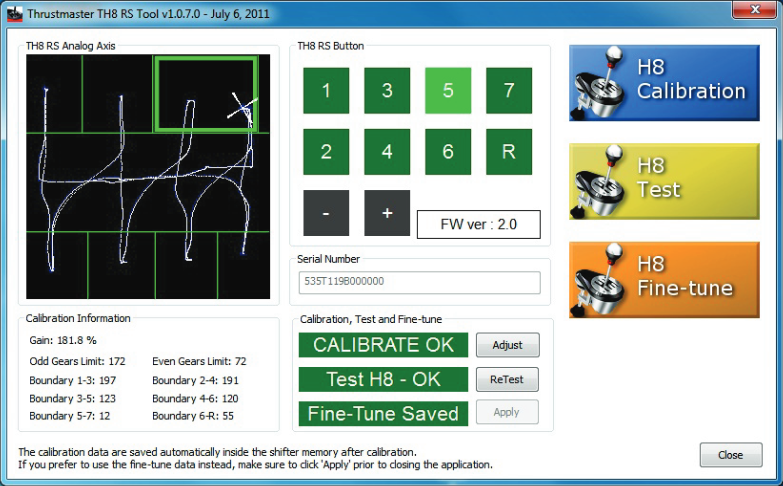

    ► get some inspiration from existing hardware : TH8RS shifter has a Calibration Software enabling you to adjust electronic gear stroke settings and recalibrate the shifter as required.
    http://ts.thrustmaster.com/download/accessories/pc/wheels/exe/th8rs/th8_rs_calibration.pdf

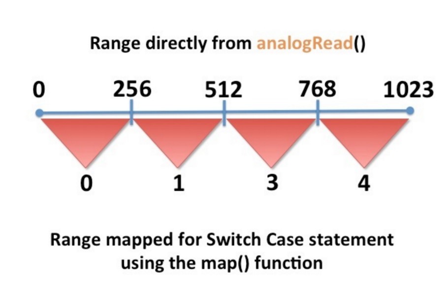

    ► so, with your hardware (2 potentiometers) you'll get 2 values. You need to "map" them.
    if 0<pot1 <50 and 100< pot2<150 then shifter=1
    this example could be useful https://programmingelectronics.com/tutorial-14-5-switch-case-statement-old-version/

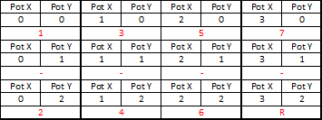

    Here is the shifter pattern:
    The corresponding PotX and PotY values
    Shift PotX PotY
    1 0 0
    2 0 2
    3 1 0
    4 1 2
    5 2 0
    6 2 2
    7 3 0
    R 3 2
    Pseudo code
