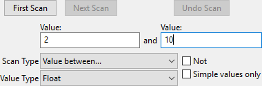

    In CheatEngine set the search values between 2 and 10:
    (2 m/s is 7.2 km/h, 10 m/s is 36 km/h)
    Check upload_2018-7-21_15-27-44.png .
    Slowly (between 8 and 35 km/h) drive up this straight and do the first scan.
    The result will be >1'000'000 addresses with values between 2 and 10

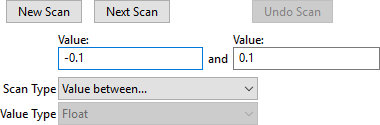

    Stop the car and set the values in CheatEngine to -0.1 and 0.1.
    Do the next scan (actually do it several times) and the number of found addresses will go down to something like 10'000 addresses.

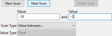

    Set the values in CheatEngine to between -10 and -2.
    Engage reverse gear and drive backwards at 8 - 35 km/h and do the next scan.
    The number of addresses will go down to < 100.
    Stop the car again, set the values to -0.1 and 0.1, do the scan again.
    You'll now should remain with about a dozen addresses.
