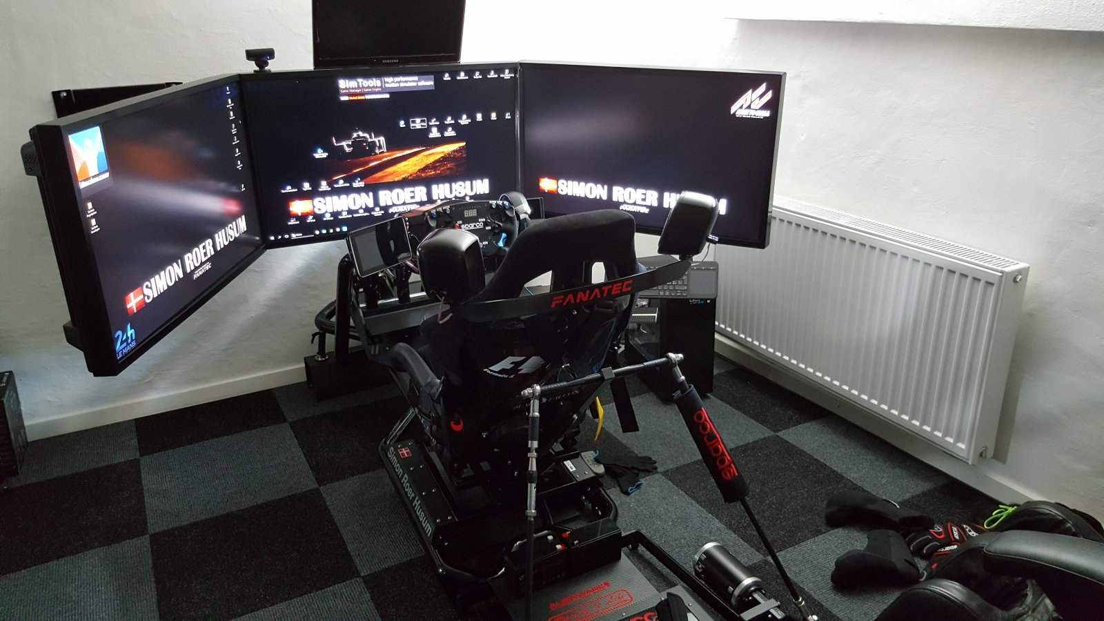

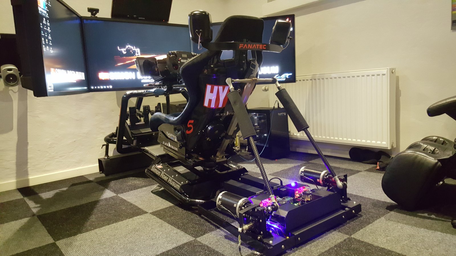

    Hi everybody
    Well..

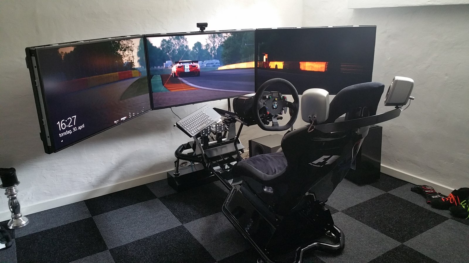

    I started building my rig in 2009..
    Added motion a year ago..
    Perhaps it is time to make a build thread in here :)
    It started as a static replica of a visionracer VR3.
    Later on modified it with no parts of the chassis in front of the pedals.
    In 2014 I dropped my ps3 and went for PC gaming.

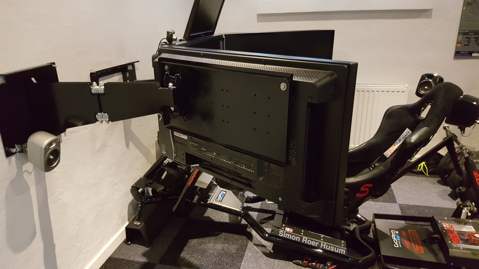

    In 2015 I upgraded to triple 40" monitors and and got 2 dof motion mounted driven by wiper motors.
    Got it updated here in June 2016 with bigger motors driven by 2 Moto monsters per motor.
    My setup as it is now:
    - Modified replica Visionracer VR3 chassis.
    - Modified Fanatec CSW V1 base with Bühler motors.
    - Modified Fanatec clubsport V2 pedals.
    - 3x40" Samsung monitors
    - 2 dof motion with 90zyt 12v motors with MCP4 50:1 gearboxes powered by the SMC3 code made by @RufusDufus.
    - DIY sequential carbon shifter inspired by SSH14.
    - DIY carbon buttonbox.
    32780 32781 32782 32783

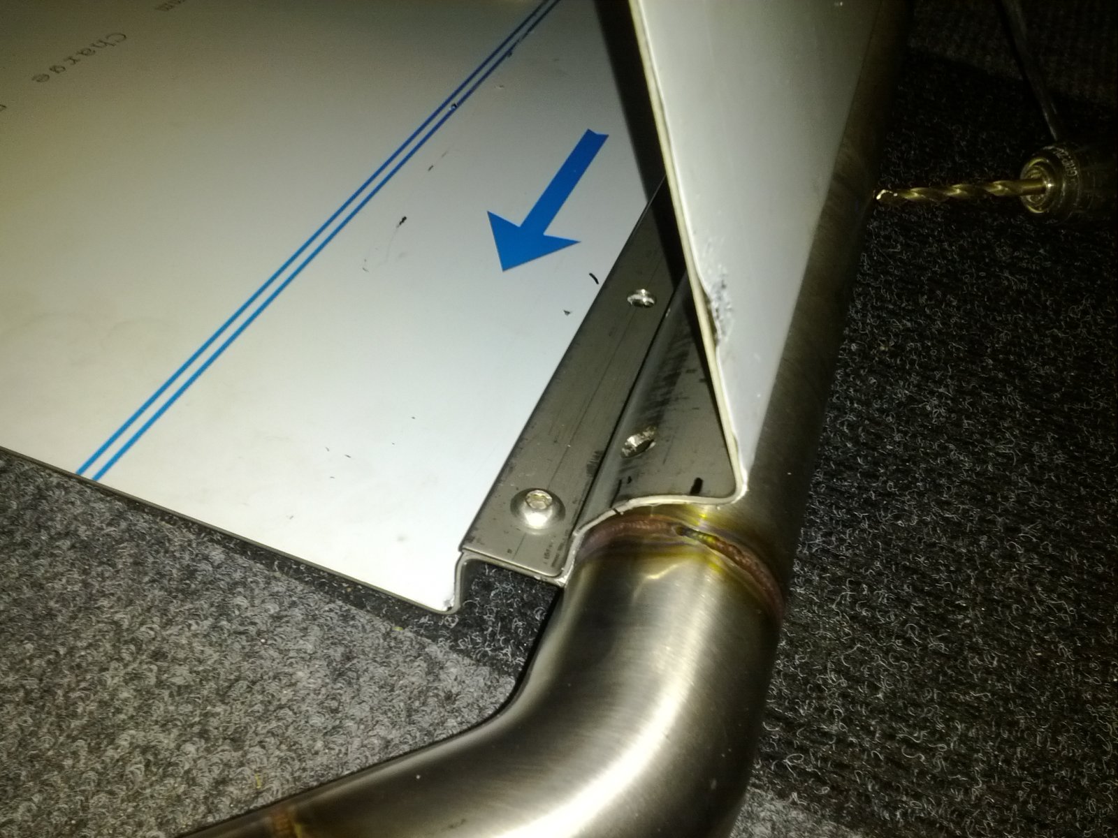

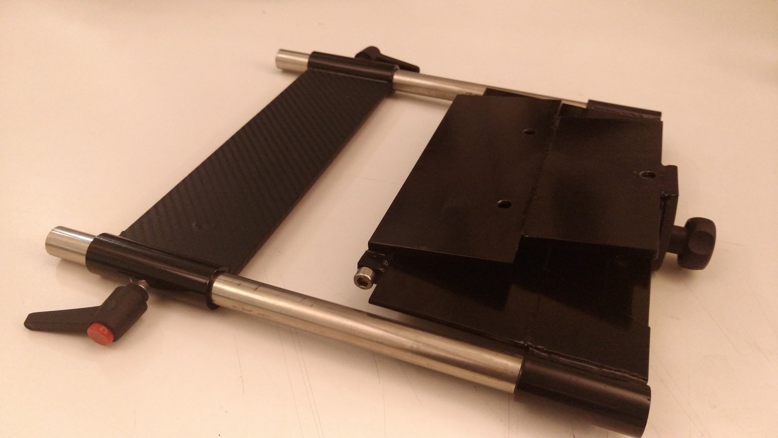

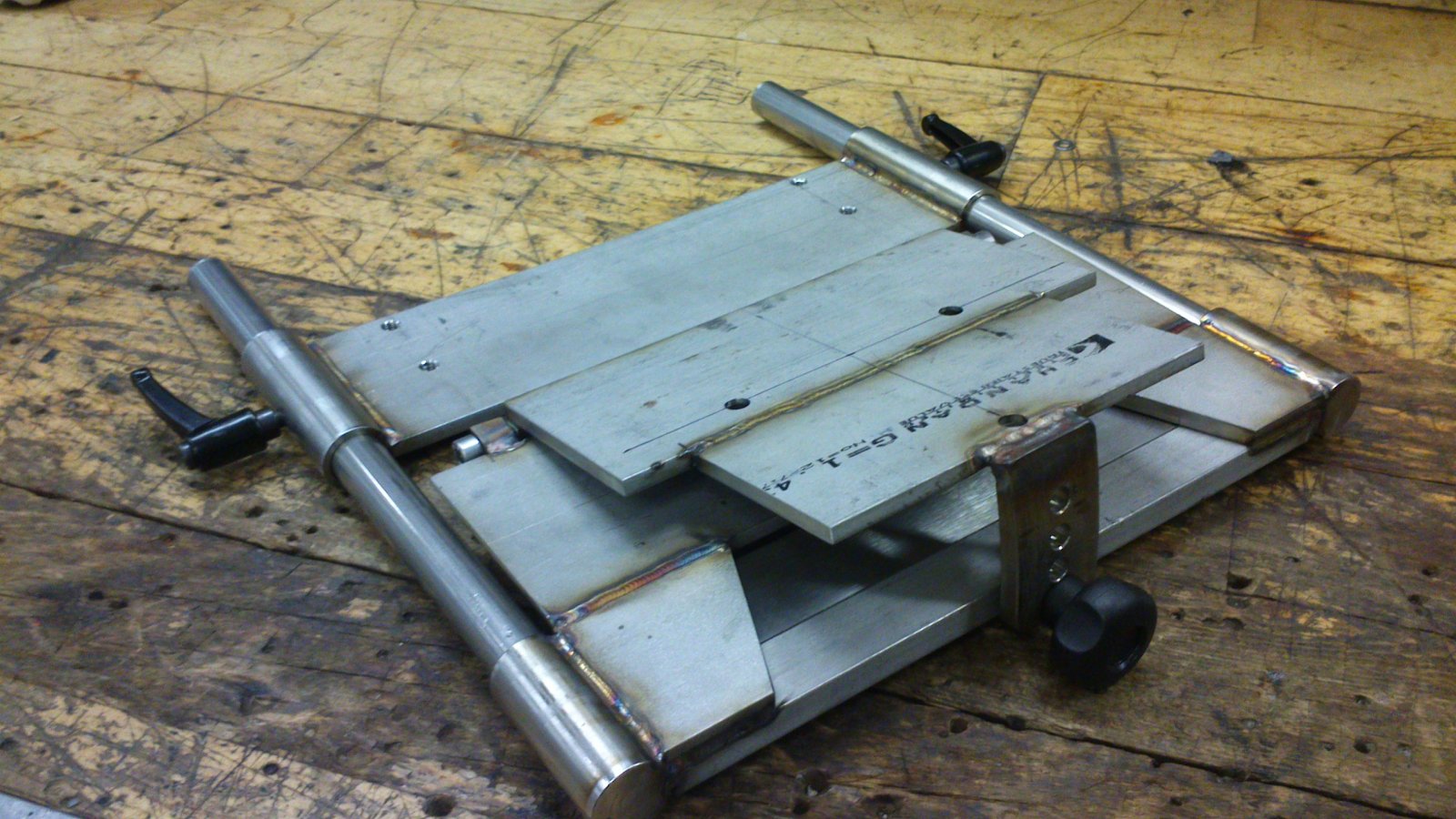

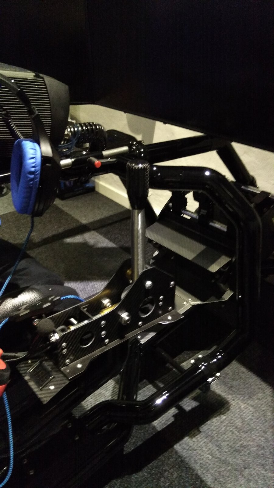

    Bracket for adjusting the steering wheel front/back + tilt..
    DSC_0021.jpg IMG_20151107_170836.jpg IMG_20151107_170823.jpg IMG_20151107_170851.jpg

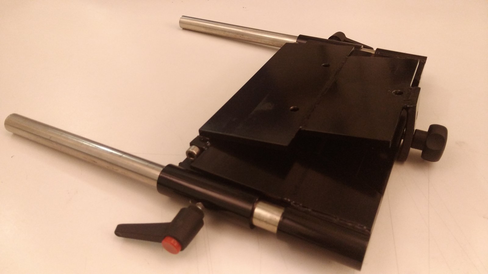

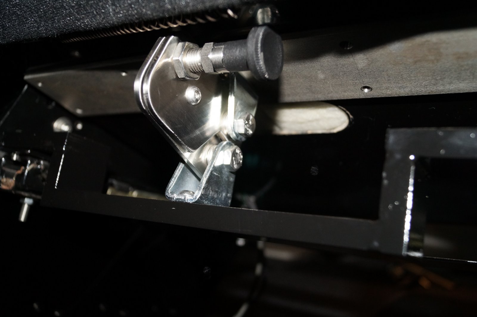

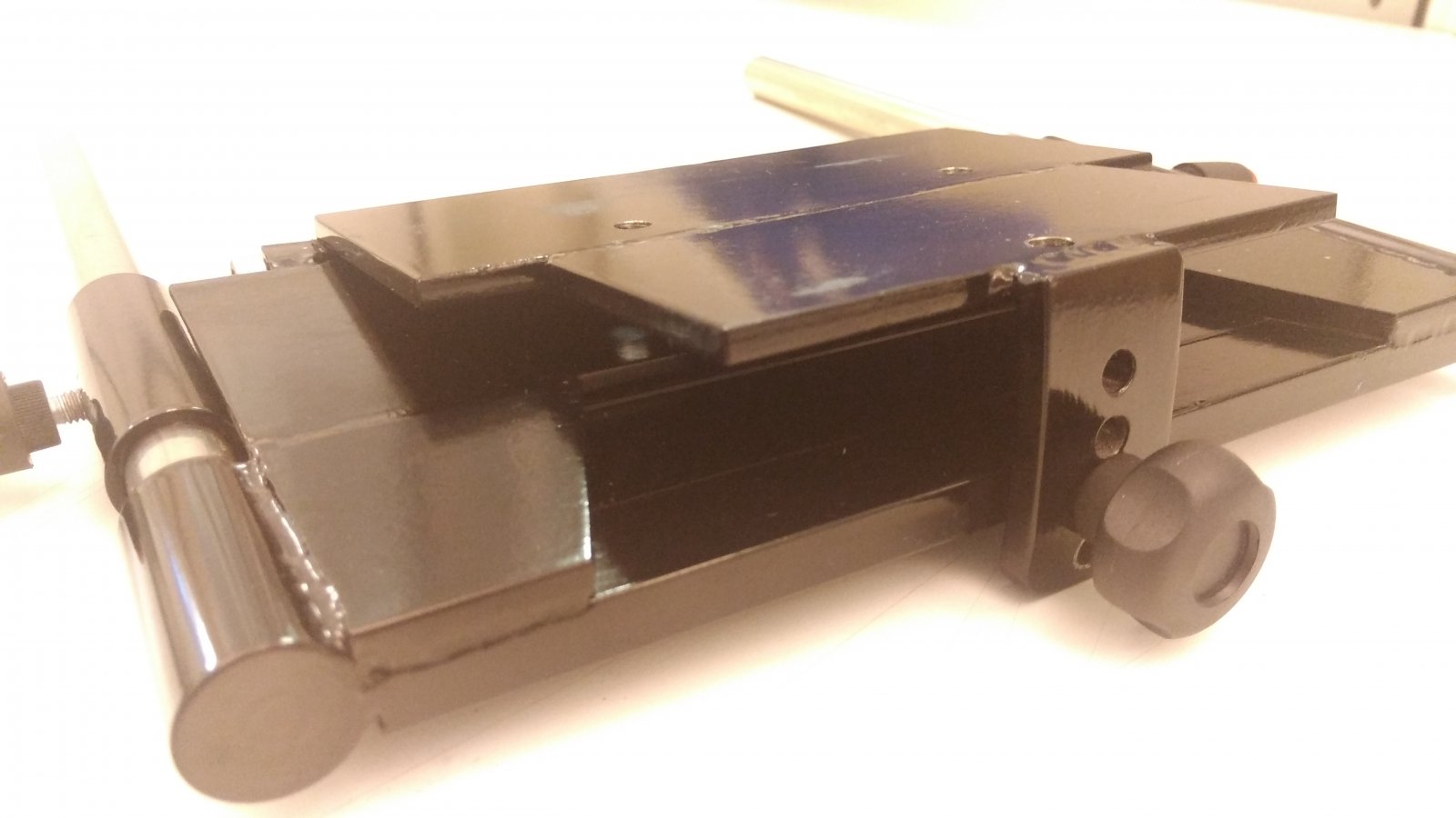

    Bracket for adjusting the seat to either F1 or GT style..

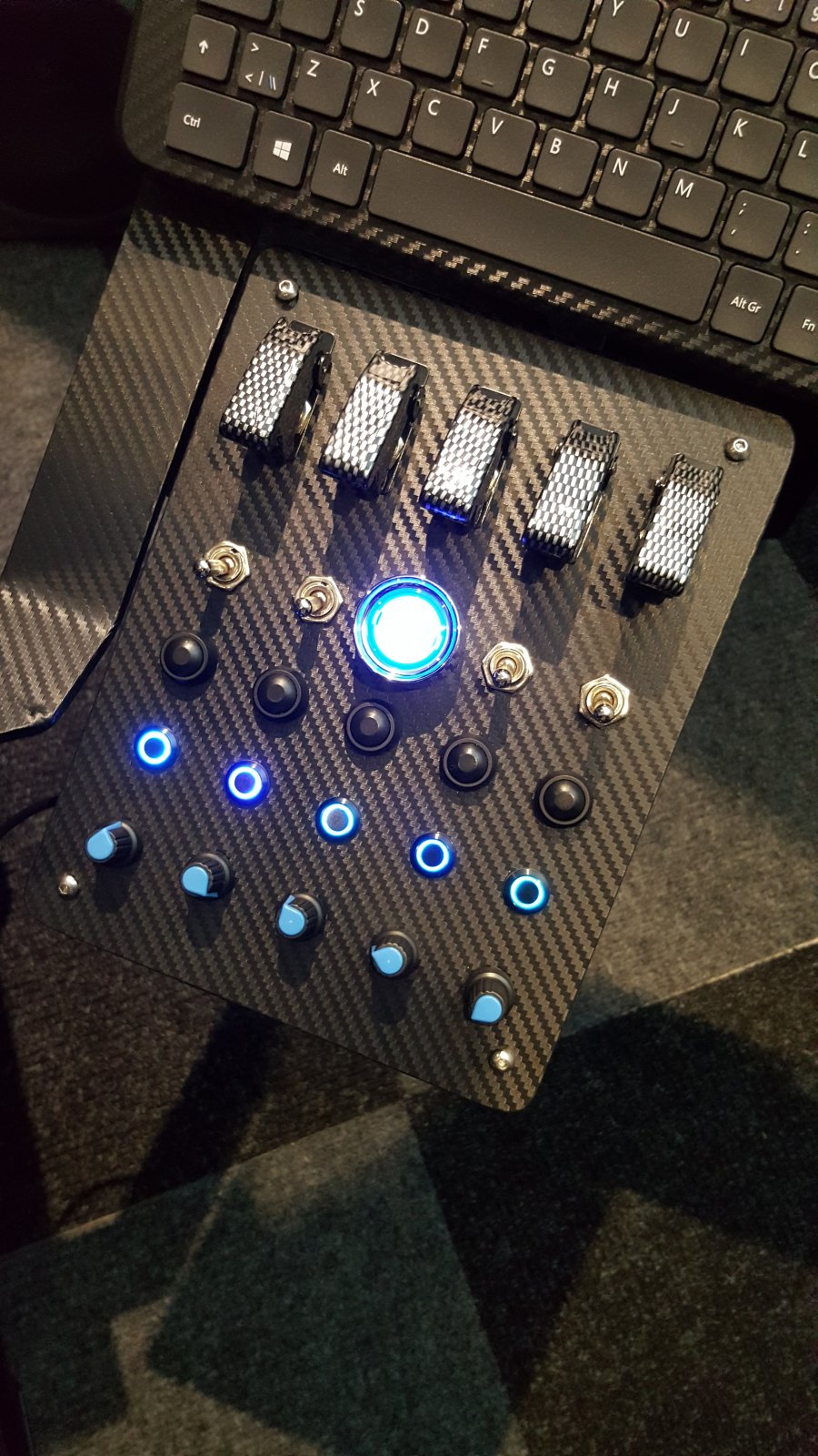

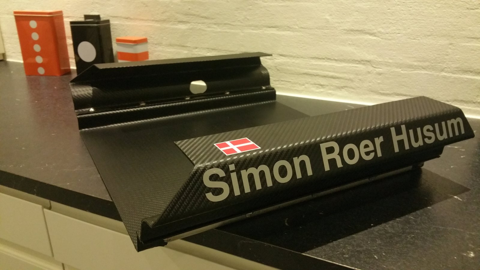

    DIY Buttonbox

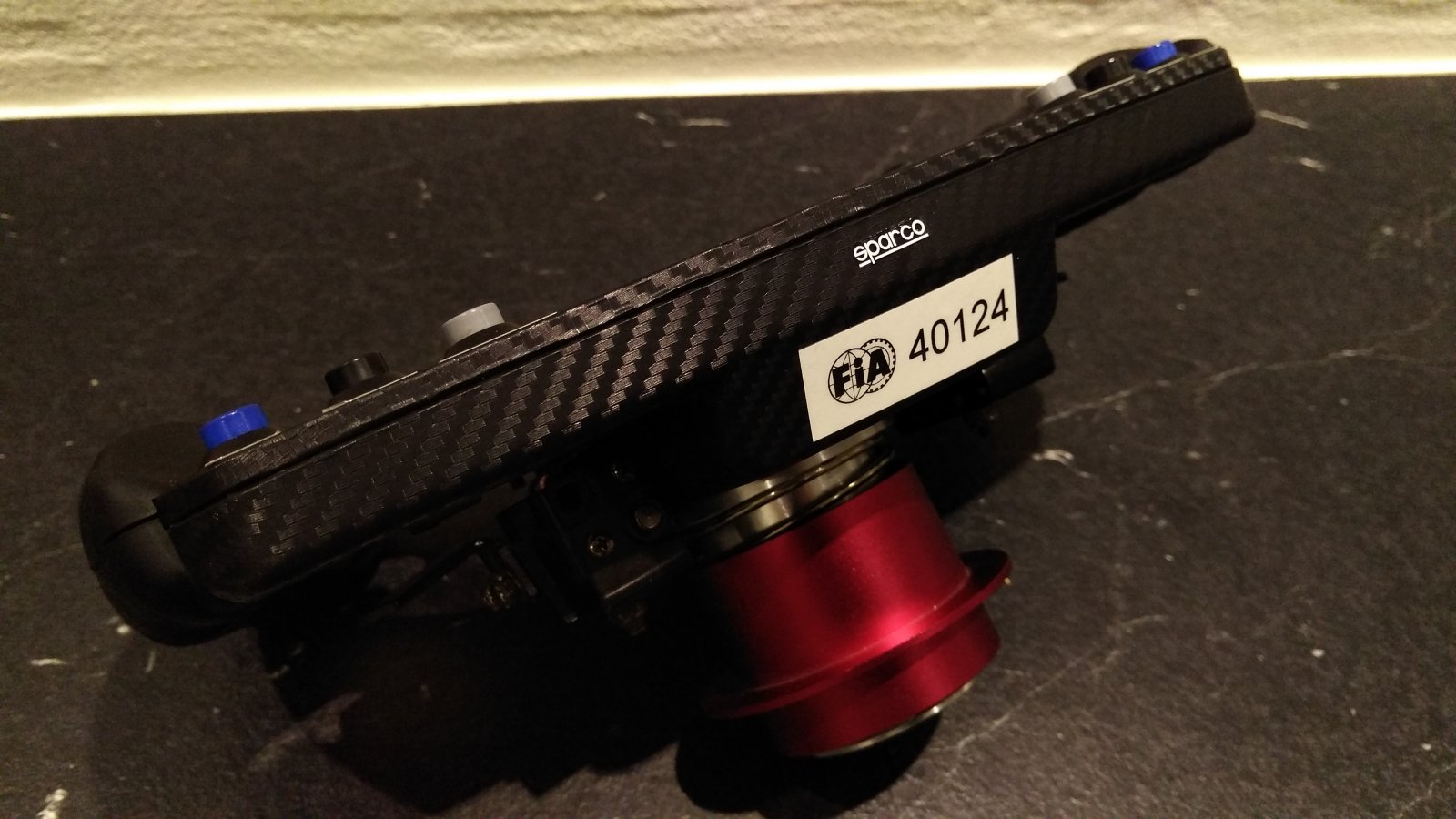

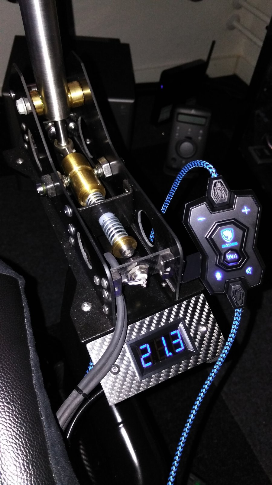

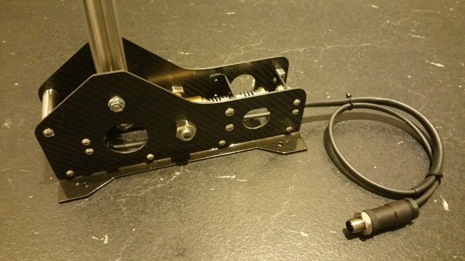

    DIY Carbon shifter with burst function..

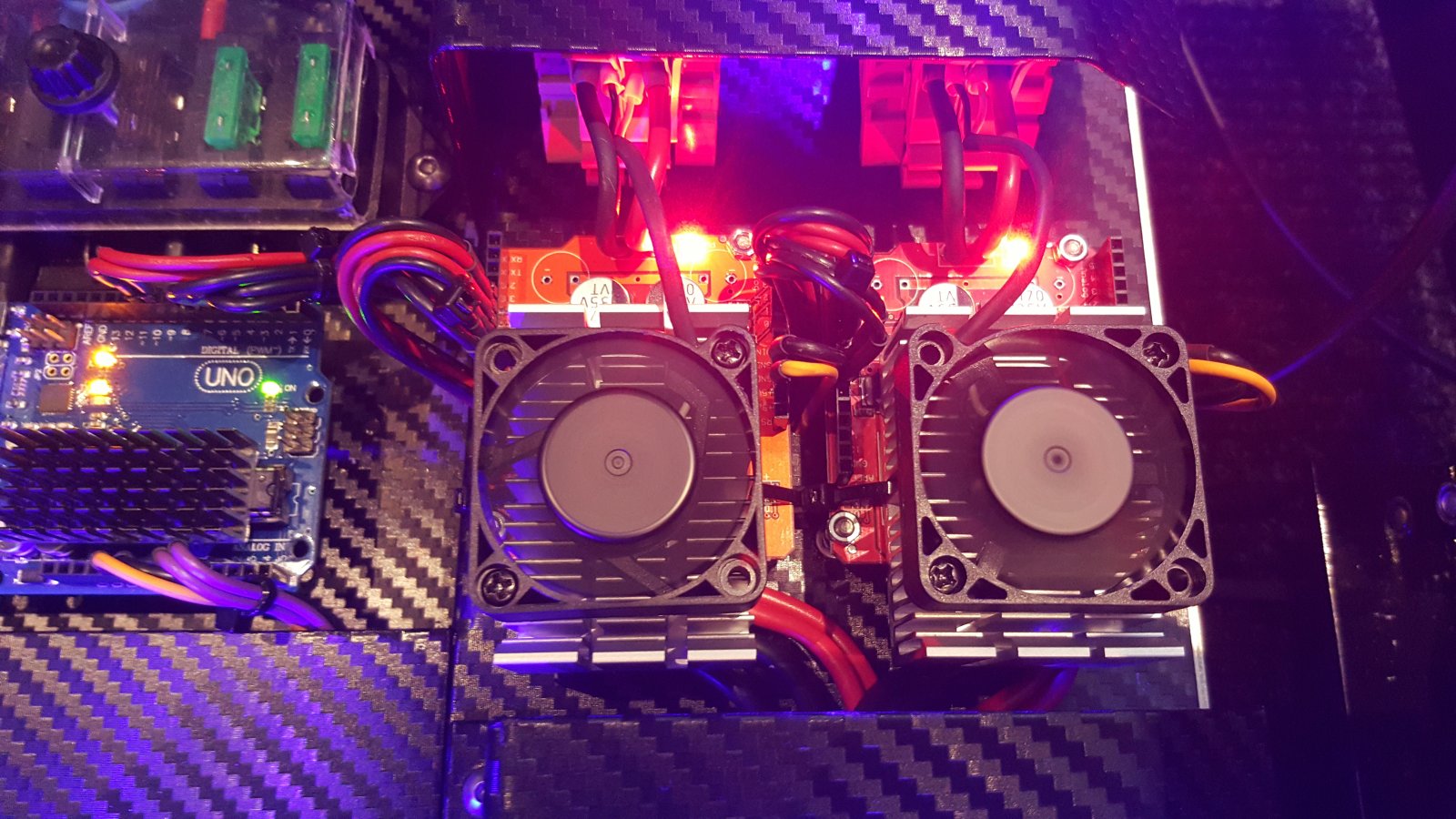

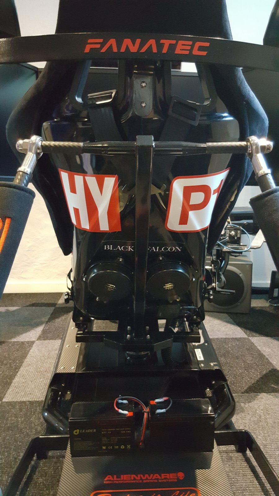

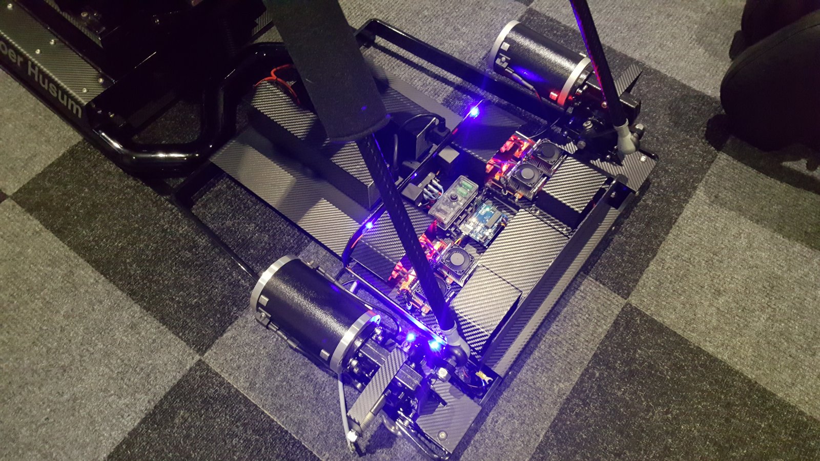

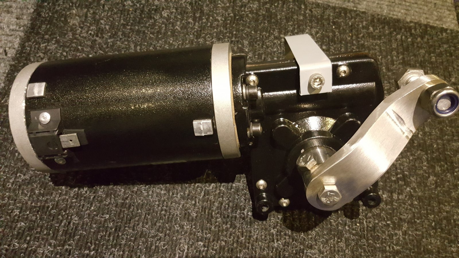

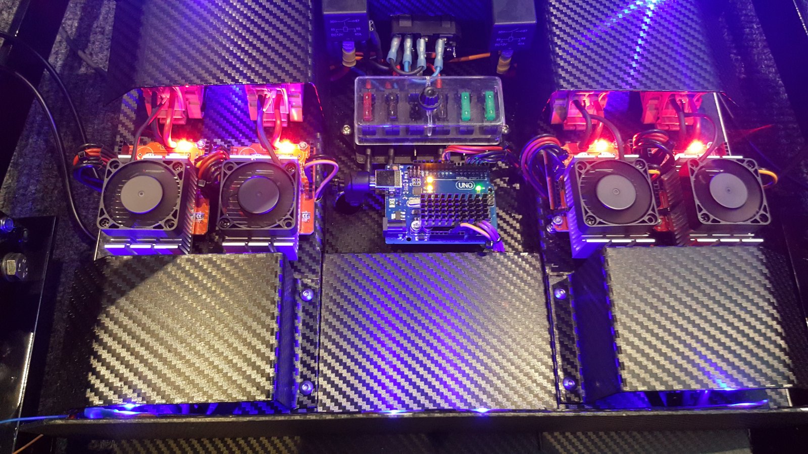

    Motion with SMC3 code :)
    20160819_000141.jpg 20160819_000135.jpg 20160819_000128.jpg 20160715_151128.jpg 20160715_151143.jpg 20160611_210807.jpg 20160621_150837.jpg
