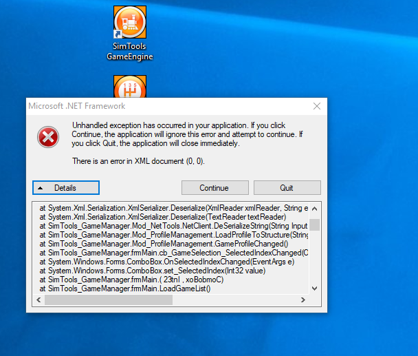

    Hi recently i had to reinstall simtools (after geforce drivers upgrade game manager gave up work - .net framework problem??), but after clean reinstall i still have big troubles setting my SCN6 rig:( the biggest trouble is with smoothing - when i set smoothing to more then 20% (i used to have it 100%!) the movement is very slow and jerky - as on the vid:(
    Any ideas, please?

    And now again the same problem with net framework..:(
    WTF it worked ca 5 months perfectly..,

    Looks like .NET was broken, there is a repair tool you could try.
