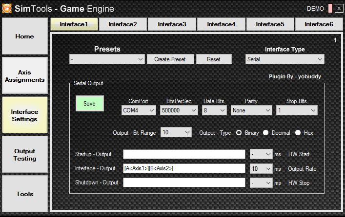

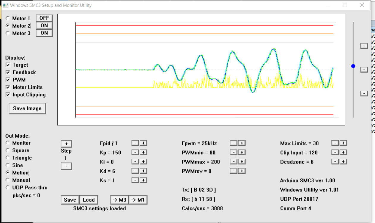

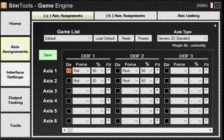

    Hello!,
    I have a problem with simtools settings.
    With SMC3Utils both engines work, but not from Simtools.
    I'm using arduino uno, SMC3 v1.0 firmware
    Can you help me please ?.
    SMC3Utils setting:
    Simtools 2.1 setting:
    I test from here:

    Resolved!!
    Simtools Setup
    Setup for Simtools 2 is very straight forward:
    [A<Axis1a>][B<Axis2a>][C<Axis3a>]
