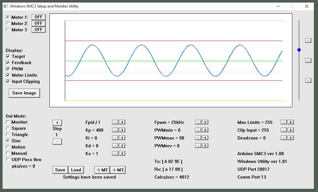

    HELLO, VERY GOOD, IT WORKS FOR ME IN SMC3 UTILS V1.01 THE ENGINES, BUT WHEN I OPEN SIMTOOLS IT DOES NOT WORK when trying to do the test, knows someone who can pass !!

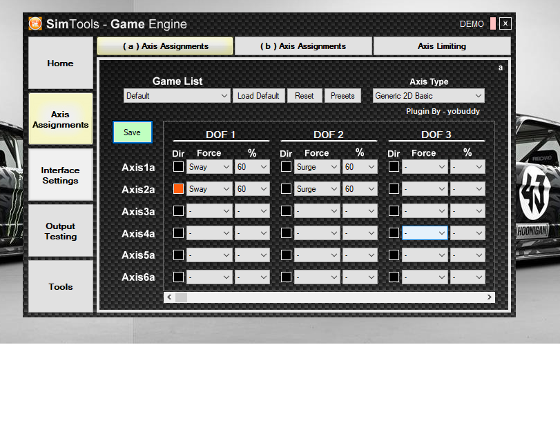

    Please post pictures of all of your setting, as there is likely a configuration error.

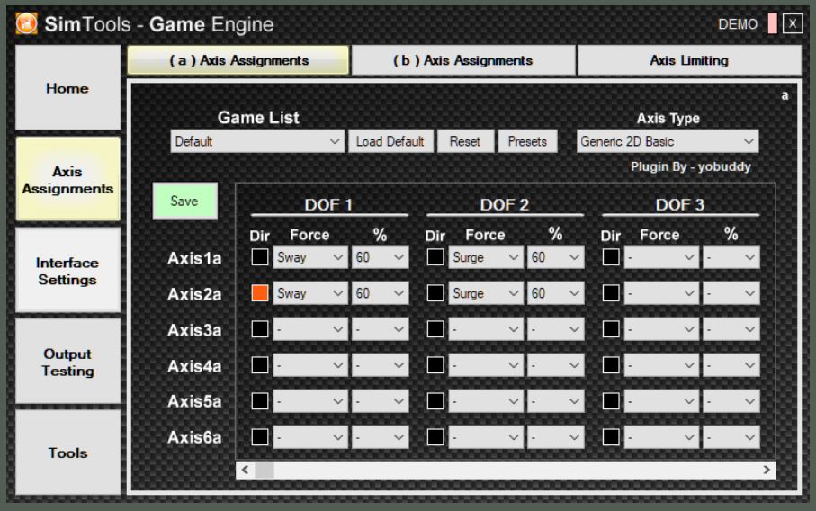

  3. robert guasch
    robert guasch New Member
    Dec 9, 2020
    - 3Coins
    Here you go
    21,494
    150,584Coins
    +11,017 / 55 / -2

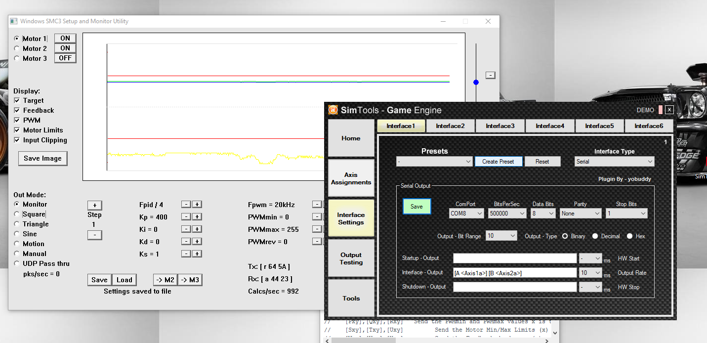

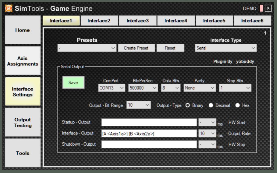

    Your interface settings are incorrect, as they have an additional space, they should be like this, without any additional spaces:
    [A<Axis1a>][B<Axis2a>]
    You also can't run SimTools and the SMCD3 utility at the same time, as that will create a port conflict:

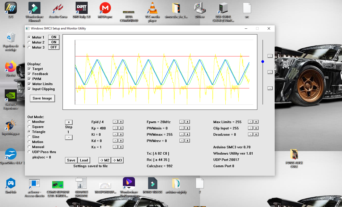

    I have the same problem. In SMC3 UTILS V1.01 the motor works, in SIMTOOLS the motor does not work.
    I do not understand

    Your Interface Settings should be like this, with no spaces: [A<Axis1a>][B<Axis2a>]

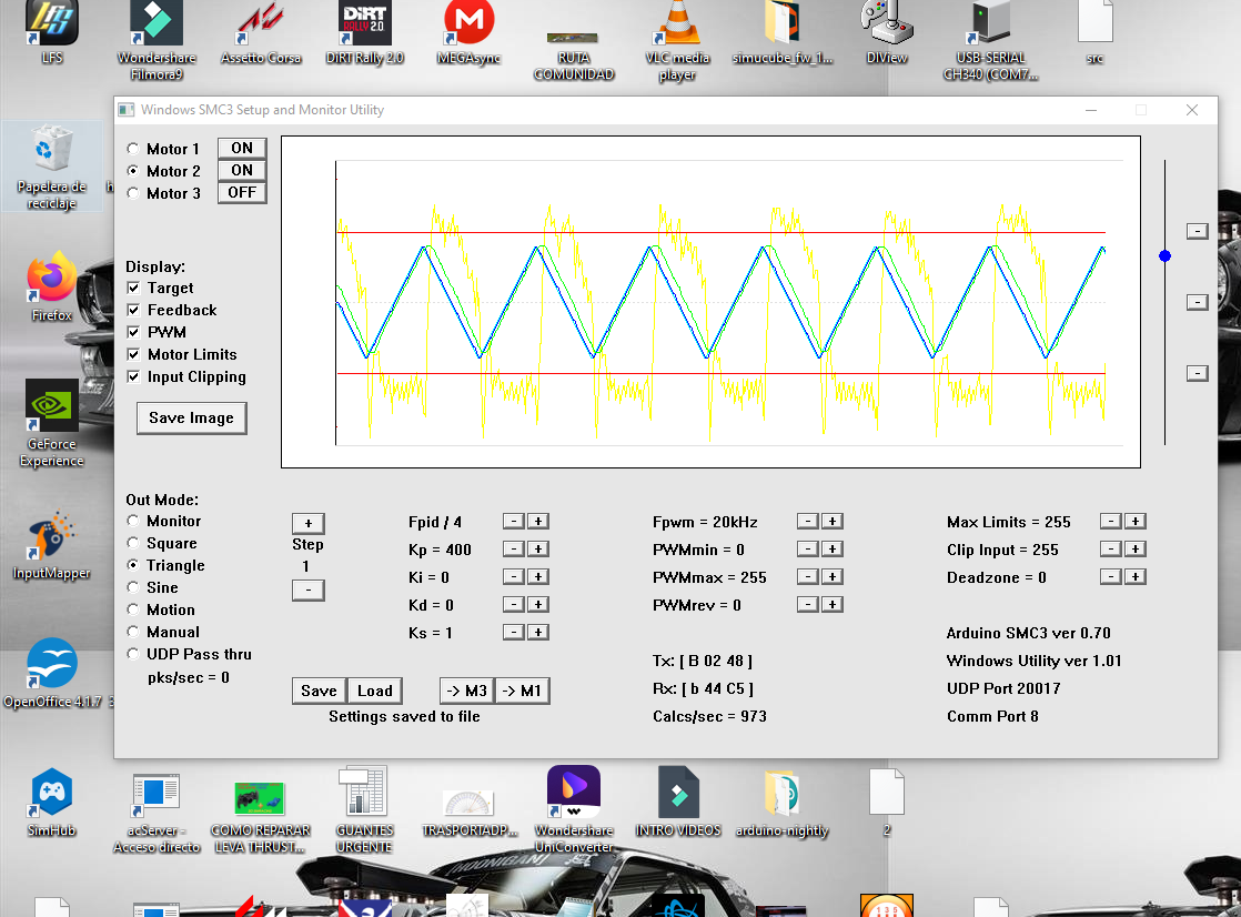

    Engines switched off with potentiometers. The green line must accompany the blue line. By varying the potentiometer, the line continues (straight)
    Send image for evaluation

    Try new settings:PWMmax=100 PWMrev=200 Max Limits=0 Clip Input=50

    I had the same problem, it turned out that Pot1 was badly connected to the A1 pin of the arduino. I checked all the connections, fixed the break and green line pot1 began to show the position of the motor. The motor will move until the pot shows the limit
