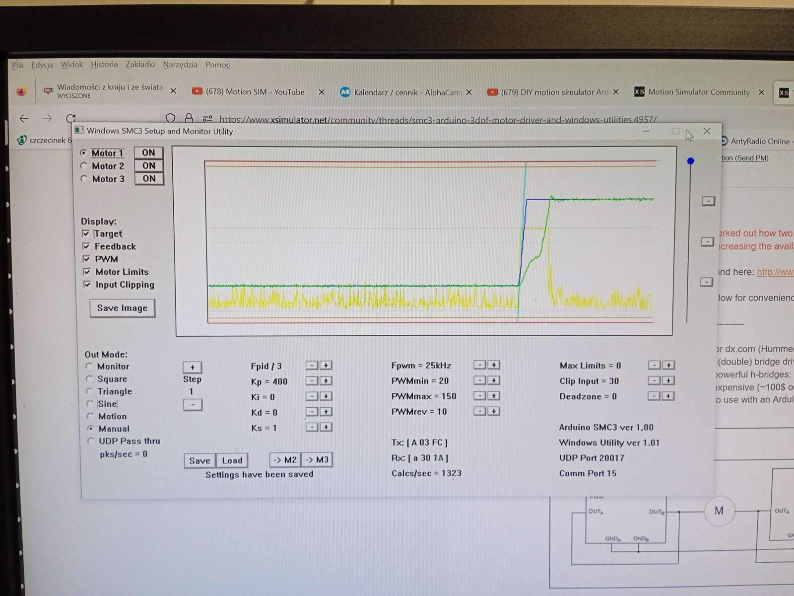

    I am assembling parts to build my first 2DOF motion sim.
    Could he please give an example of SMC3 parameters for GEBY 75r/Min 24V 250W motors , I would not like to overload and burn them on first startup :).

    just set your pwm to 55 and you will not be able to overwork them - imo it is best to set P I D to zero and slowly inccrease P till the motors start to work - do this with no load on them to start with

    IMG_20231018_191022_1.jpg Why do the blue and dark blue lines diverge so much when I move the slider manually in SMC3 ? with motion setting it is similar
