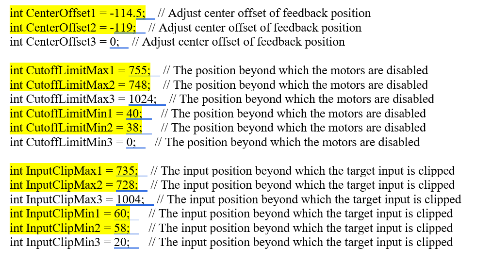

    my pot reading is not centered relative to the physical movement range, I tried to compensate for that by changing the center offset and the max and min limits in the smc sketch, but seems that smc-win-utility is messing things up and it also enforces symetric min and max limits.
    Any ideas what to do?

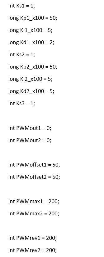

    I'll try to explain the full story, I am actually using a standard (10Kohm X 10 turns) potentiometers, the mechanical setup I have (i.e. belt and pulley gear ratio) yields 7.5 pot revolutions per full stroke of the linear actuator (end-to-end), these pots are my second batch, the first one was a set of cheap stuff which literally broke in half under slight belt tension even before using them and they had bad signal quality too, I moved to a higher quality ones (which are my current pots) and they are way more sturdy and have better quality, and to avoid loading the shaft of the pot with belt force I switched the mechanism to be gears with no belt, the results are very good in terms of signal quality and responsiveness. When I installed them I didn’t stress myself about getting their range perfectly centered since I knew the Arduino sketch allows for range center offset, and min/max limits and clipping, see the screenshots below for sections from the sketch:
    My hope was to be able to use the parameters highlighted in yellow to precisely put the range where it is supposed to be and get the correct position reading.
    So first thing I do is running an Arduino sketch that resets EEPROM and zeros all the bits to get rid of any values in there (these are values from previous tuning session), then I upload the new sketch with new tuned values as shown above, then I try to test the system and get some movement but the motors stay dead, I can only get them to become alive if I open SMC3-Win-Utility and put the tuning values in there then close the SMC3 utility software then start the rig. The problem with this procedure is it uses the pot range information from the SMC3 utility not from the sketch, I can tell because I can never get more than 70% of the stroke and can never move the actuators towards the lower 30% , basically the actuators can move from 30% open to 100% open back and forth, it appears that the SMC3 utility overwrites the sketch, the down side is SMC3 utility does not differentiate min from max limits like in the sketch and it uses one limit and clipping value for both ends of the pot range, I can live with that if it allows me to move the centre from the default 1024/2=512 (in SMC3 utility this will be 512/4=128) but SMC3 win utility does not have a center offset parameter so it is always assuming 128 (I guess based on what the behavior I’m getting).
    After all, I think right now I have the following options:
    1- Go and center the pots physically, but that will be approximate and will never be precise nor consistent among all 6 pots
    2- Dig into the Arduino sketch and see why I can’t get it to power up the motors without going through SMC3-win utility first, SMC3 utility must be changing something that missed to set in the sketch, I believe it is one of the power tuning parameters that I might be using incorrectly (please see screenshot for used parameters summary and tell me if you see anything wrong)

    Oh I just noticed one more thing in the sketch, the first three parameters in the image in my previous post are never called by the code at any step, which means they are defined but never get used, if this is right then that explains why I'm unable to move the center of the range to where I need it to be.
    This now limits my options more and more.
    At some point I was actually considering switching to encoders instead of pots, they are cheaper and more precise, I actually bought them and will be looking in modifying the sketch to adapt encoders instead of pots, I just don't see this happening in the near future due to practical reasons, at the moment I will stick to what have to get the project moving forward.

    The perimeters are variables not constants and get overwritten by the EEPROM value's when you run the sketch.
    Some of the variables may be leftovers from when it's author was developing the sketch and trying different things.
