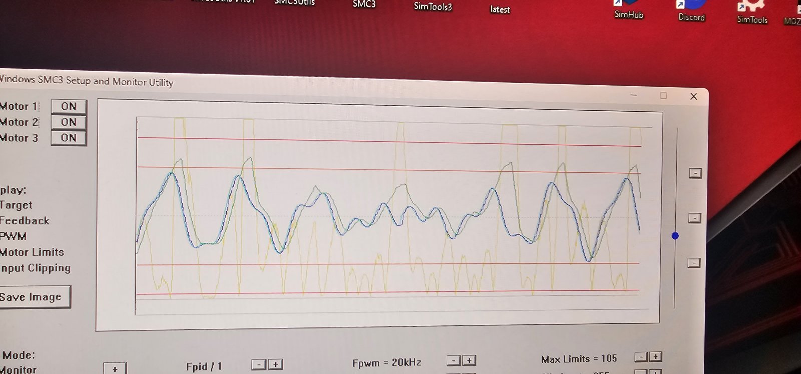

    Mi rig was working fine, but started to do some dips in one side, like loosing power for one second.
    This only occurs when going down, in gravity direction, i know my rig is a bit heavy in that side.
    It only happens in large movments.
    Allready changed ibt2, power supply, and even motor.
    In thinking of psu not delivering all power, I measured voltaje when this occurs and volts on positive of ibt2 going to psu rise at 34v on that moment, fast spinning of the motor acts like a generator. So I put a 50v 30a Schottky diode, but nothing changed. Tested a lot of combinations in PID, but still happens.
    Heres a pic.

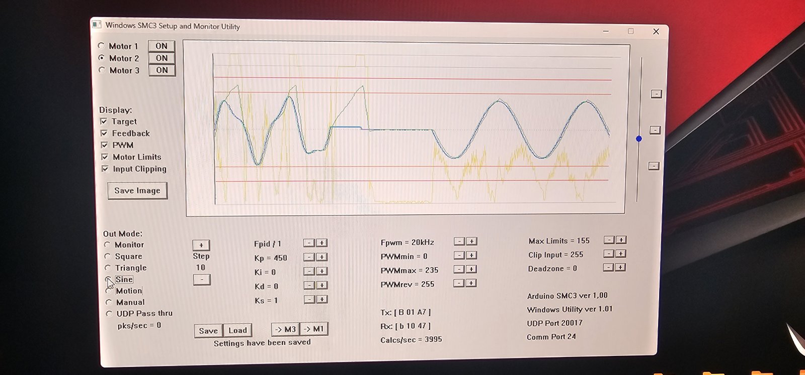

    There is massive overshoot, so the SMC3 settings need refining.
    Please post a picture running the Sine test that shows all the SMC3 settings.

    335Coins
    Pic 1
  5. Mariano Tarnogol
    Mariano Tarnogol New Member
    Oct 26, 2013
    20
    335Coins
    Sine and motion

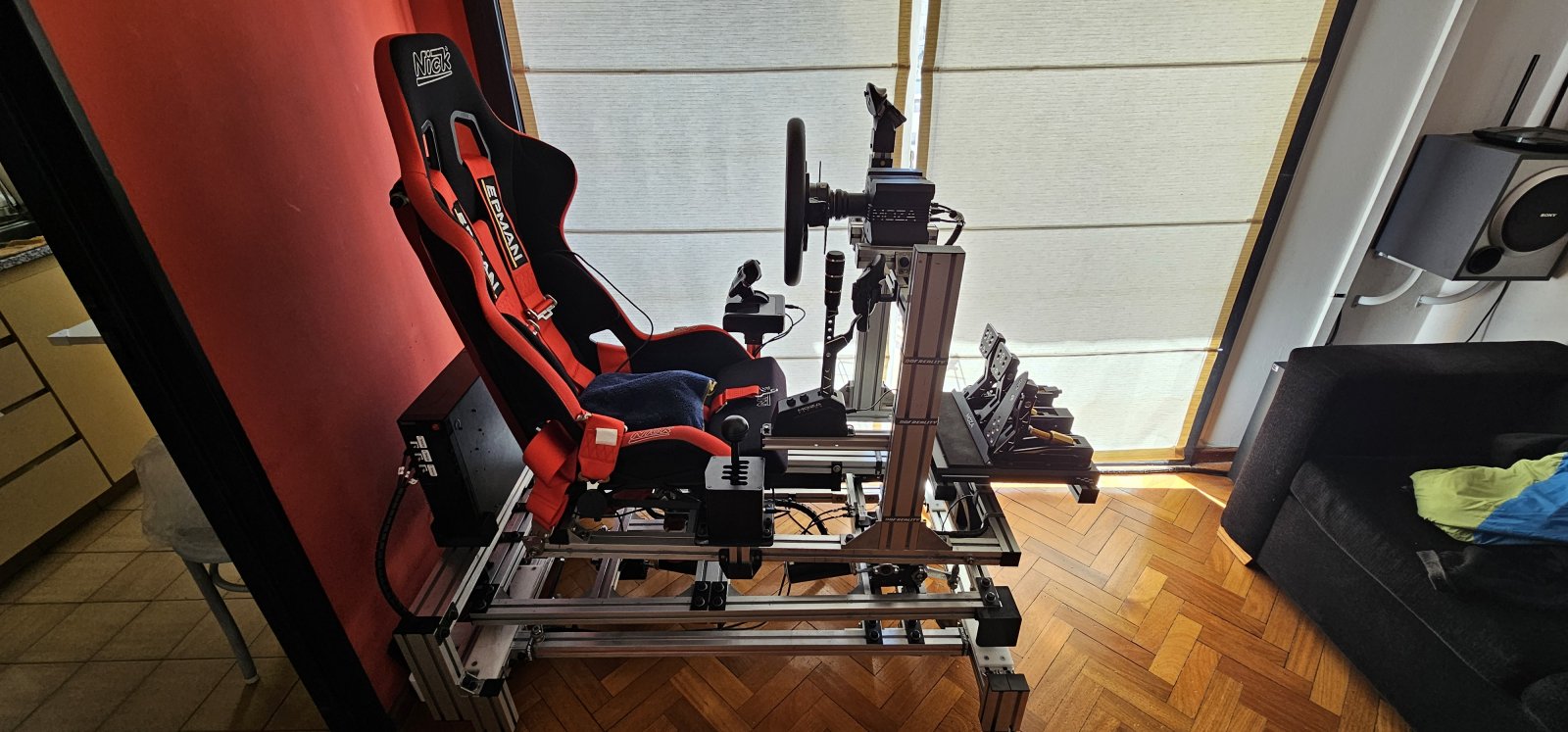

    335Coins
    My rig

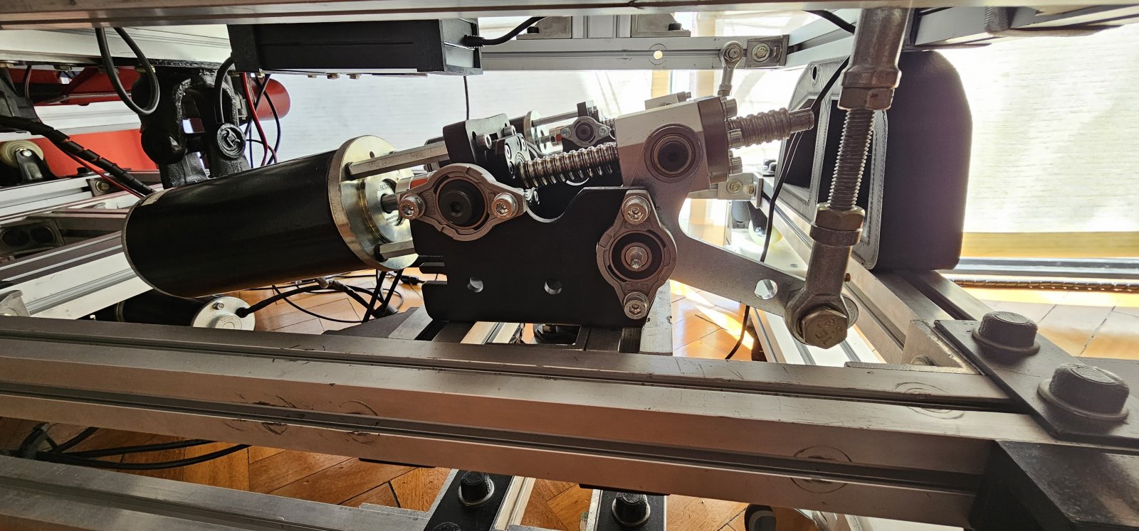

    335Coins
    Sfus

    +11,017 / 55 / -2
    What voltage are you running with the IBT2s, as members have reported issues with 24v, dropping it a couple of volts helps prevent damage?
    Set Fpwm to 25 and rerun tests.

    And aditional info.
    Looking a SMC3 pwm , there is a flat line, not an spike on the top of the chart, in that moment ibts where shut down, and matchs hi peak volts, both lasts same time.
