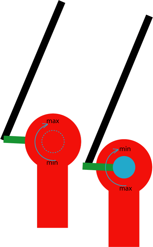

    Currently I am switching to bigger motors for my 2DOF and while doing so I noticed that one POT delivers quite noisy results so I want to switch to hall sensors and got two of these 6127V1A180L.5 from Farnell.
    Ordered yesterday, got them today :)
    Anyway, I just tried one and connected it to the Arduino. Works almost perfect with very exact output and it can turn 360° and doesn´t get killed. However how do I place it on the opposite side?
    I have two ideas in mind and I don´t like one of them but since many of you already use hall sensors maybe I think too complicated.
    My pots/now sensors are directly mounted to the motor shaft so I could either disassemble one of the sensors and turn the sensor in it around or change the code of SMC3 to recalc the values for the second sensor.
    A different approach would be to directly put a
    SS495A
    on the motor mount and a magnet on the lever. That way is nice since there wouldn´t be any mechanical connection between shaft and sensor and the motor could turn 360° but it also means more work and alignment and I already got the rotary sensors ;-)

    I guess I just found out myself...
    //#define REVERSE_MOTOR1
    :D

    Yes that will work but only for one Motor - you will need to update code to do the other. This was really only testing code and isn't necessary.
    If the POT is turning in the opposite direction to the Motor (ie the PID can't position motor - get runnaway) you are better off just reversing the wires to the motor.
    If the POT AND Motor can be positioned OK with PID but move opposite to what you want then you can reverse them in Simtools with a checkbox in the Axis settings.

    Switching the wires. Looks like my brain had the handbrake on yesterday.
    I was so fixed on the sensors that the simplest thing didn´t came to my mind. motors.gif

    It doesn´t matter, though I reversed the wires on the pot when I used pots because the graph in SMC3 remains visually logical. I guess that is where you get easily confused because the graph turns around when you reverse the wires on the motor. And since you cannot reverse the wires on a Hall sensor the reversed graph isn´t avoidable. It is silly but it was a trap for _my_ brain ;-)
