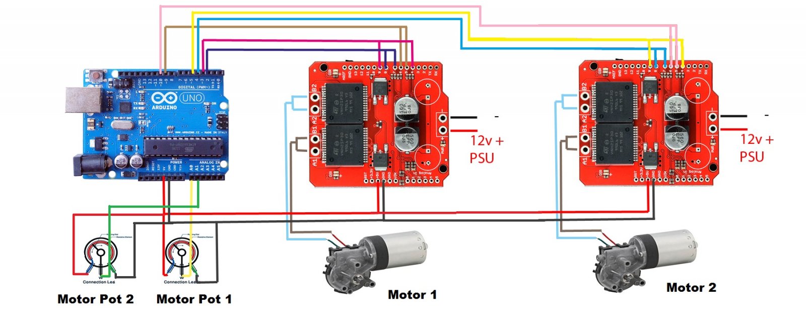

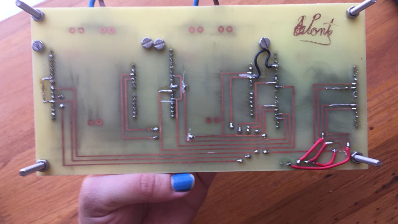

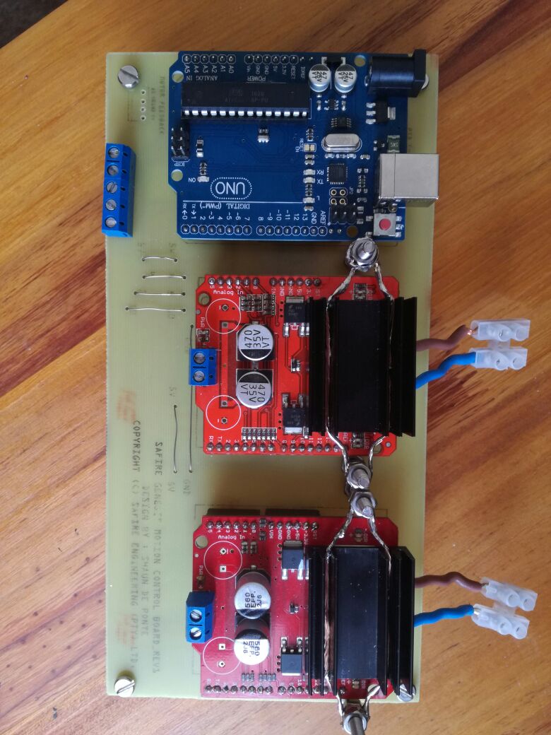

    I am sitting with a bit of an issue: Below you see the circuit board I designed
    based on the following diagram (Two MotoMonster for two motors.jpg)
    I am running SMC3 firmware in MODE1.
    As soon as I connect power to the Arduino USB port and apply 12V power to the MotoMonster, the Arduino 328-P chip itself burns out, or the FTDI controller on the board burns out almost instantly. The strange thing is, I built this on a vari-board previously, and it worked no issues. One of GND tracks also burnt out in the process, hence why there is a new soldiered GND wire on the board.
    Could someone on the forum pls have a look through with a fresh set of eyes and see if I made a mistake somewhere? I just can't find it (Pls excuse my signature on the copper side, was my first ever pcb etch).
    Thanks,
    Shaun

    the diagram is correct in post 1
    I suggest trying to get them to work 1 at a time hardwired to eliminate wiring faults as a cause.. its hard to follow your board from a pic.

    Connect all data common ground for all the boards ... don't just use this one Arduino ground connection and let the current pass through the Ard. layers [use both grounds on both sides of the Ard. ] ...
    Just connect another wire here for the new UNO ...

    what happened with these tracks ? are they burnet with the Arduino too ?
    Or you have a shorted pot ? bad etching copper layer ?

    @speedy and Bruce, thank you very much. I will give this a try tonight. To answer your question Speedy, it's a bad copper etch

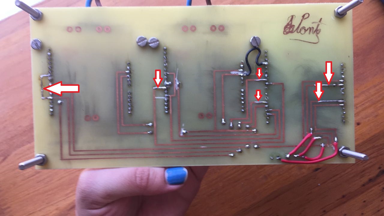

    Actually I use Sprint-Layout 6.0 and it cannot import the .fzz file ...
    And I can see your board clearly following the correct connection :thumbs and I verify that to you by the next photo except for that mentioned extra ground connection to be used ...
    I just need you to have a close look to the gap [Yellow arrow ] between each 8 pins of the MMs and verify that they are taken in consideration correctly ...
    Plus verify that those connections marked in [Red circle ] are shorted together ... gap is included in one of them .

    No way ... the SMC3 code shuts down the PWM when the pot reaches the max. limit ...
    I guess it is a shorted pot then .
    Have you checked that MM connections in the above picture ... I can't see a clear gap between the pins .

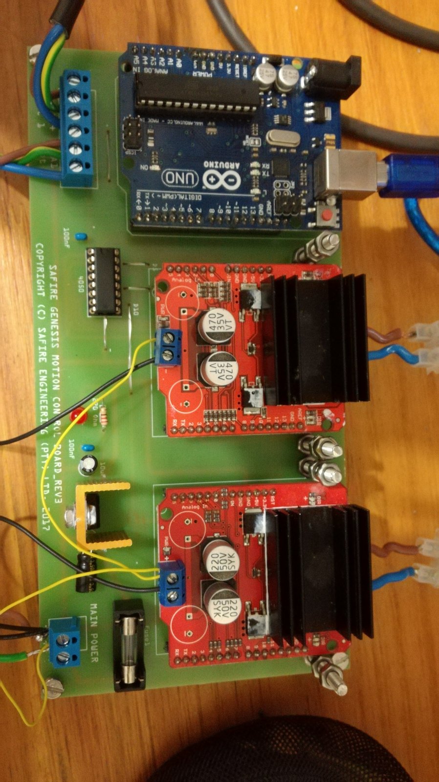

    Hello, it's been a while...
    So in this pic, you'll see we re-designed the board, with a voltage regulator and 4050 non-inverting hex chip for protection, new pots, and had it professionally printed to avoid errors. Basically there is a common ground from the PSU (in this case a bench PSU for testing), going to the Arduino, the pots and two moto monster boards.
    Then 12V power to the moto monster boards, and a seperate 5v through the regulator going to the +5v of the Moto monster and pots. So far plugging SMC is working well, and nothing blown. hope to test this weekend on the rig.
