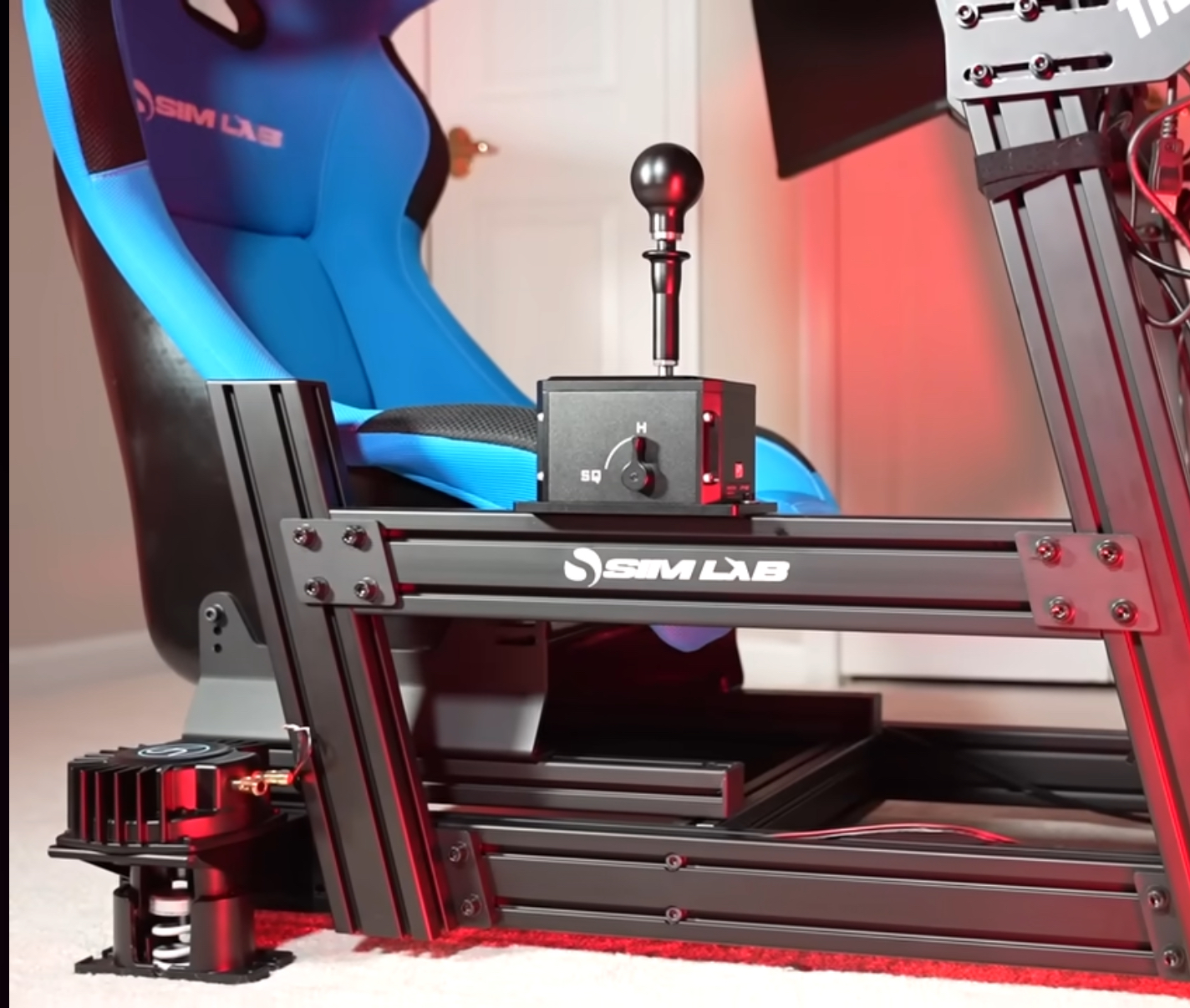

    I've got a rig that sits on springs...feels like a suspension, not much movement, but with the weight shift of body weight and the direct drive wheel, it does move....BUT..
    I dont want full motion, but I do want to build a 2 DOF system, that allows me to have the actuator "nudge" the rig, no need to lift it, as its "floating" on the springs, Its like a mini-motion sim,
    As I turn right, the actuator is on the floor, but only extends an half of inch, to push the rig to the create the "roll" effect, same for pitch,
    Im thinking it would be the reverse of a motion rig; But I dont even know where to start, is there small motors? it doesnt need to pickup a lot of weight, just needs to nudge it. I"m guessing the controller is easy,
    I'm some what techy, but not sure to even know where to start to research this.
    Any Ideas?

    You can get 60kg or even more powerful RC servos.
    But do consider the design aspects, a 2dof normally rotates around a uni joint style pivot, which create and help control the roll and pitch axis.

    Well it’s really a 3Dof. I’ll need 4 motors or whatever device I can find

    There are plenty motor and controller options.
    What may help is that post some pictures of the rig.

    This isn’t my rig. But I’m about to add the same spring (lower left of pic). These will be on each corner of the rig. And they move from just body weight. That’s why I’m wanting a motor of some sort I can make push to move it the direction of the software.
