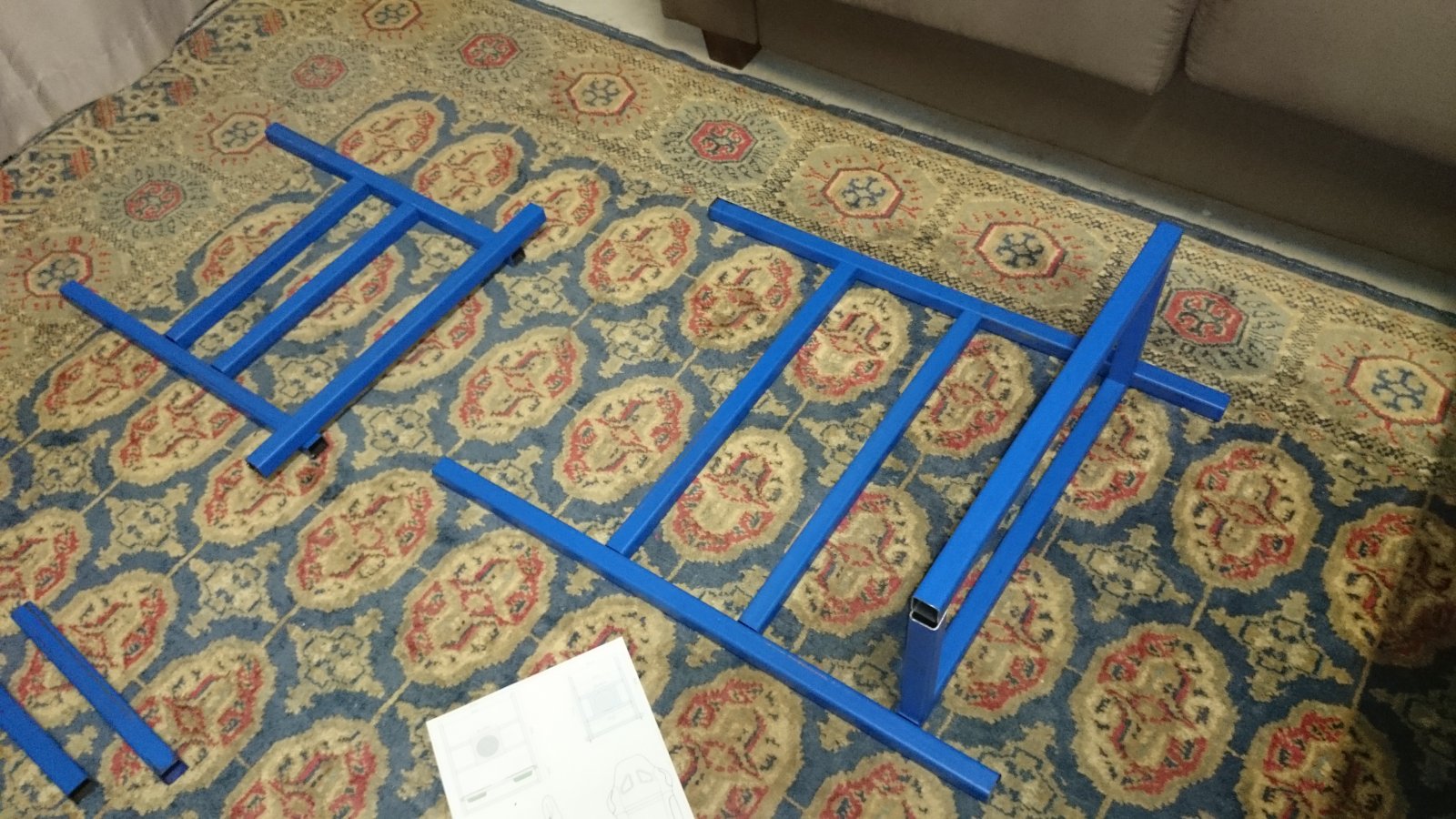

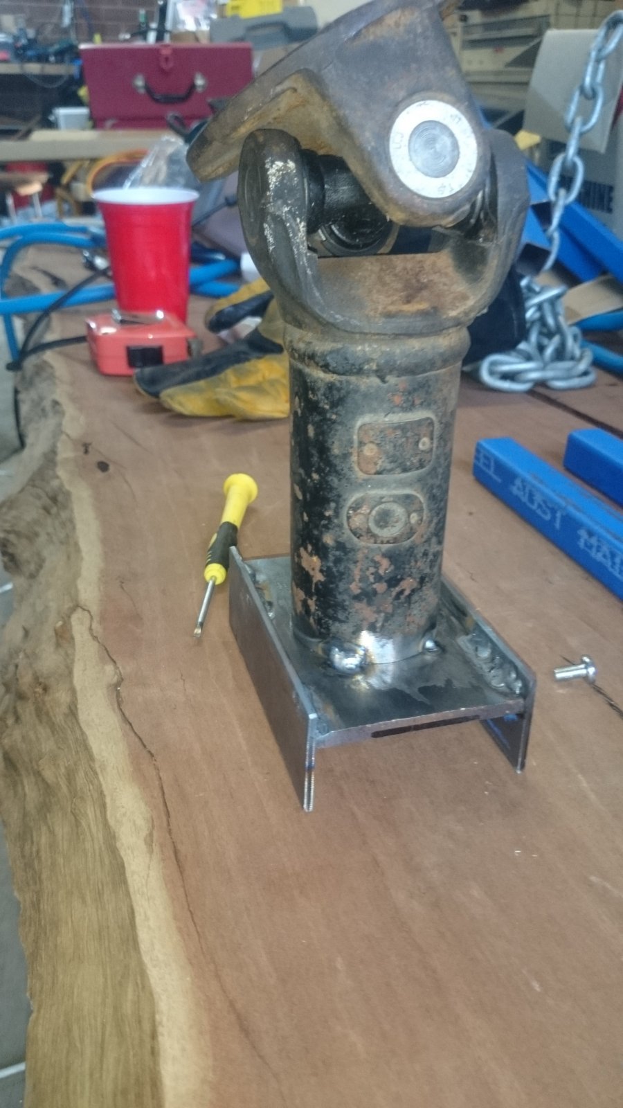

    And that's pretty much where that design and idea finished. Just before we went to weld it up, I told my mate and welding monkey (Ben) that I wanted to build a seat mover that was shoulder mount based. He sighed as I had no plans or designs, yet I had been reading this forum for long enough to understand the basic geometry I'd need to get it all going... ( well I hope so, as I write this we're yet to finish it off and fire it up )
    I'm guessing you all know what this is , as for why we didn't just put a flat piece on the bottom and instead made a C section ... plans change and also if you fail to write said plans down and return to the job 2 weeks later confused , then sometimes you end up with this, but it works.

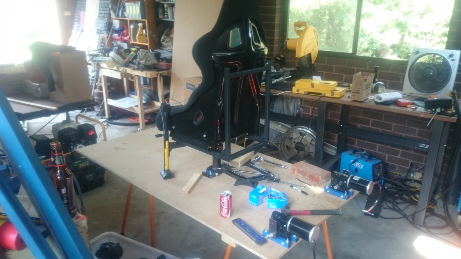

    So at this point we were testing to see if we could just reuse the RHS I had cut for the previous design, yeah I'm cheap. But it worked out pretty well, I would have liked to have made it bigger, but can always go back and make another later down the track. This was about the time that we decided that we'd try and make as much out of off-cuts and stuff we had laying around, this was to be a prototype we kept saying.

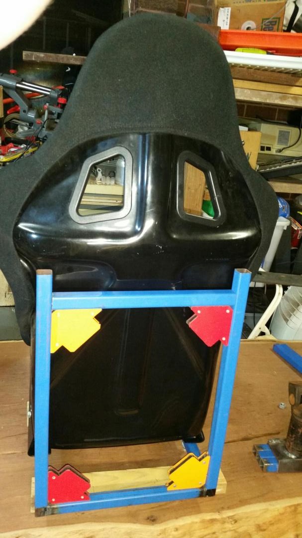

    So we had been working on this for a few months already, mostly my fault due to being lazy. We would work on it maybe once a week during the evening, if we needed supplies like nuts or bolts and we couldn't find anything laying around the garage, then the job would be put off for another week until I could be bothered to get supplies and get back around. Lucky Ben kept on my case otherwise the thing would still be an idea, so over the last few weeks it's started to come together pretty quickly. I'd drop round to remind myself of where the project was at and have a chat and out of nowhere we'd end up get multiple jobs crossed off the list.
    You can see in the photo above that we decided to mount the whole thing on MDF rather than build a lower platform out of RHS, the idea is to then replace the MDF with RHS ...but who knows.

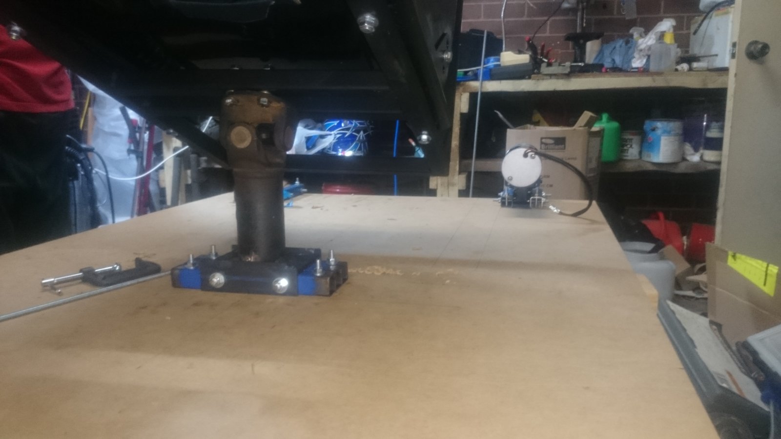

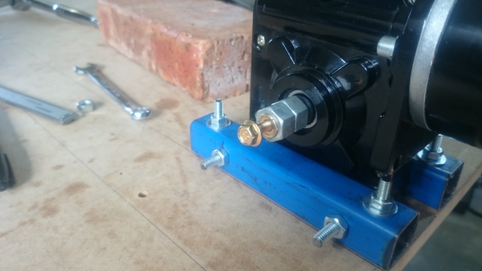

    This was a section I was really happy with, mostly cos it came together with little thought and we managed to use mostly off-cuts. The brass bolt will still need to have the head removed so a flexible coupler can be attached. But yeah, as cheap and shitty as it looks , it's solid and wasn't anywhere near as complex as my other ideas where for the motor and pot mountings.

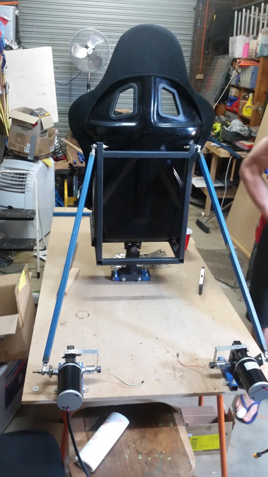

    So this is how I left it last, just needing some rods made up and the electronics wired in before we flick the switch and watch it burn down the garage ...good times. Will be adding more when I get around to it , currently waiting for heim joints and a few other random pieces to arrive in the mail.

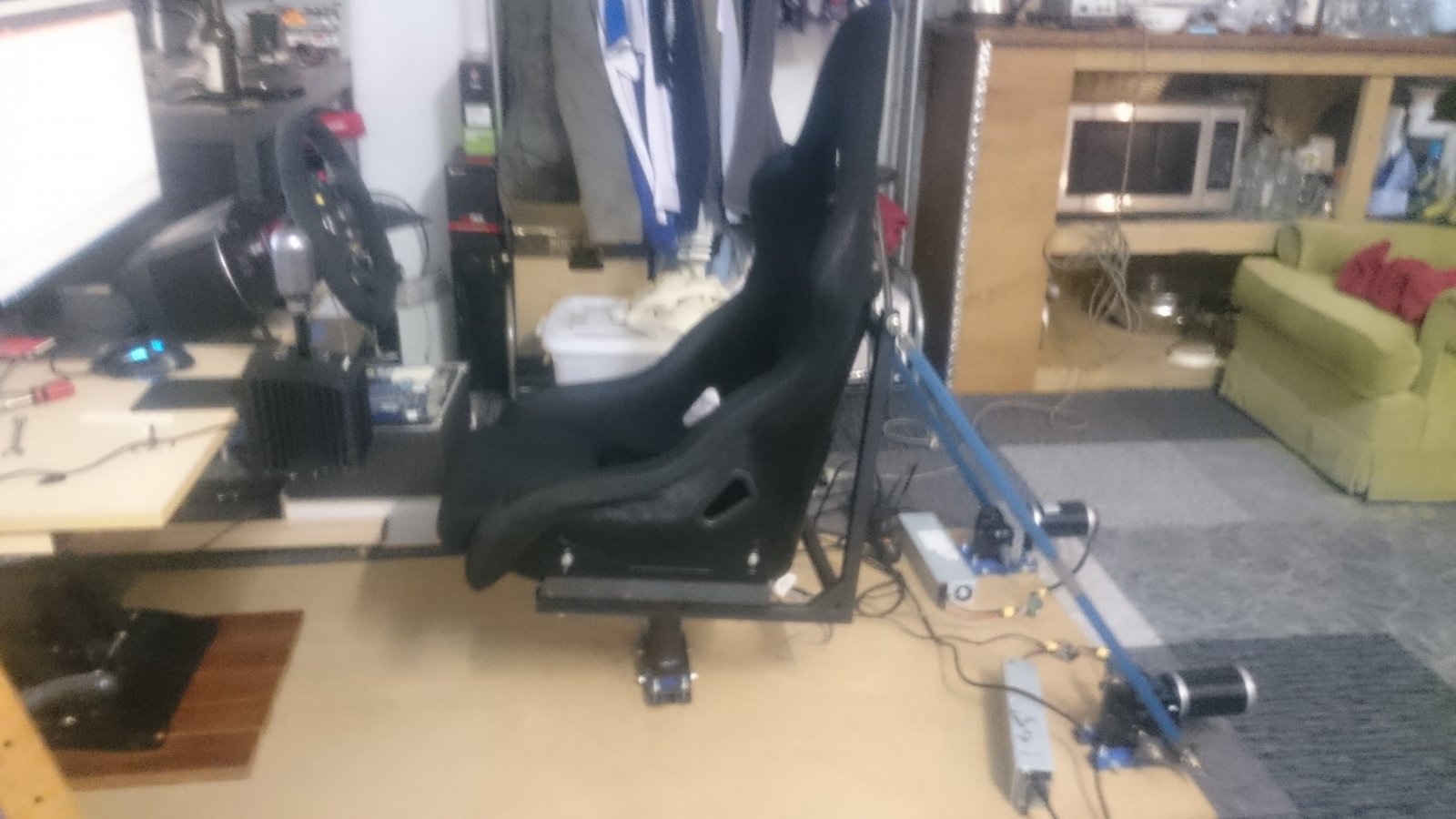

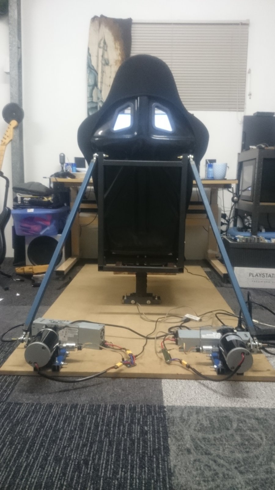

    And some photos of how it currently sits now we moved it from garage to inside the house for setup and testing. Wiring is only temp , I will install it all in a box with some fans and might go the full monty and put temp and volts/amps readouts, but that won't be done anytime soon.
    The MDF has a slight amount of flex under big movement, I'll either brace it or just build another platform from RHS.
