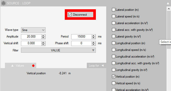

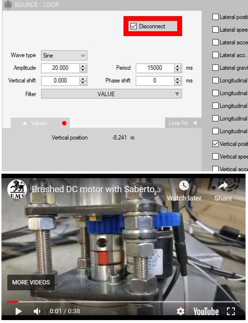

    I started looking at what the slow speed performance was like for my setup.
    I have ballscrew 1605 with brushed motors, Sabertooth, Kangaroo and encoders.
    I noticed it was getting a bit notchy at slow speeds and I could feel this quite easily in the rig in flying sims.
    When just cruising staight and level but just kinda floating around, I can feel this notchiness and its starting to bother me.
    So I got thinking if I ever have a second shot at re building a rig, a performance metric would be how smooth it can be on a slow and smooth test. I think its is an overlooked factor for flying sims.
    Below is my test and Im suggesting a standard of 20mm vertical heave, 15 sec period and no filtering(Im using Mover here).
    So I ask you guys if you could post a video of your system performing the same test to compare notes.
    Im particularly interested in Odrive's and AMC-AASD15A for my do over in future

    Here is on FlyPT mover with test parameters are requested:
    Just for comparison, I control the AASD-15A servos with 500 pulses per revolution resolution...
    500 pulses to advance 5mm on 1605 leadscrew (2 revolutions for 10mm)... so for 400mm stroke actuator, for example, it counts 40,000 positions!!! This is 0.01mm step size resolution accuracy.

    Hi Pedro,
    If you can, take a closeup on the motor link like @JAD did, to see visually any stepping present on the rotation of the motor itself along with the same loop settings:

    Im hesitant to fool around with the PID numbers. These were all automatically set in the tune. But I will have a shot at it this weekend.
    Its easy enough to restore to a previous tune if it all goes pear shaped.
    In my setup, I have 360 lines per rev encoder, a gear ratio 31(encoder):20(ballscrew) and 1605 ballscrew which results in 46 encoder lines per mm of travel.
    Im using 2^14 bit range (16384) to drive a travel of 355mm, which results in 46 bit range per mm (a fluke that this all aligned neatly)
    So I think the resolution of the feedback encoder and the resolution of the commanded postion is fine enough.
    Another thing I have been playing around with is the dead band on the positioning.
    In my first post video, I have it set to 1 line of position deadband. And this is usually OK but occasionly it would oscillate when sitting there on a contanst hold position.
    Its a very fine oscillation. Its only when Im just sitting in the rig and browsing the web for a while that it gets annoying.
    Sometimes I could just gently dampen the oscillation with my foot/hand, or just shuffle my weight in the rig to make it settle and be completly stationary.
    If I change it to 3 lines of position deadband, then it would be fine and hold completely still at any commanded position.
    But I dont think this small postion deadband is a factor in this slow speed notchy feeling.
    I'll have a play with PID, but I suspect the notchy feeling is a result of brushed permenant magnet motors.
