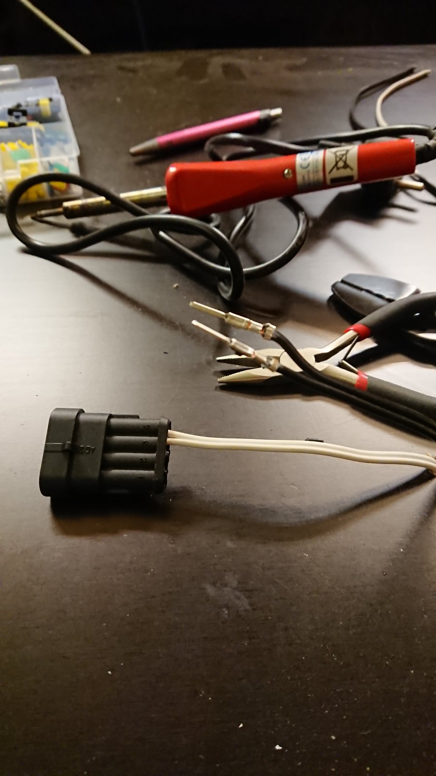

    for the potentiometers I needed two connectors
    Link: 282087-1
    and pins
    Link: 282110-1

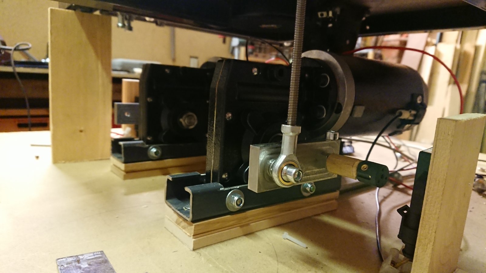

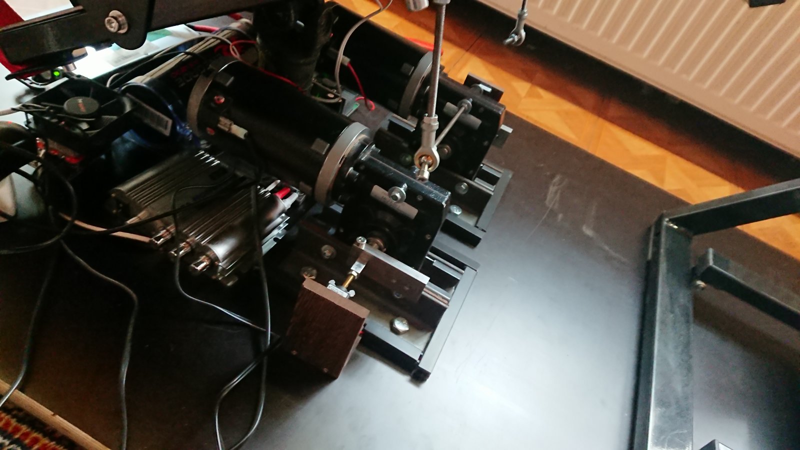

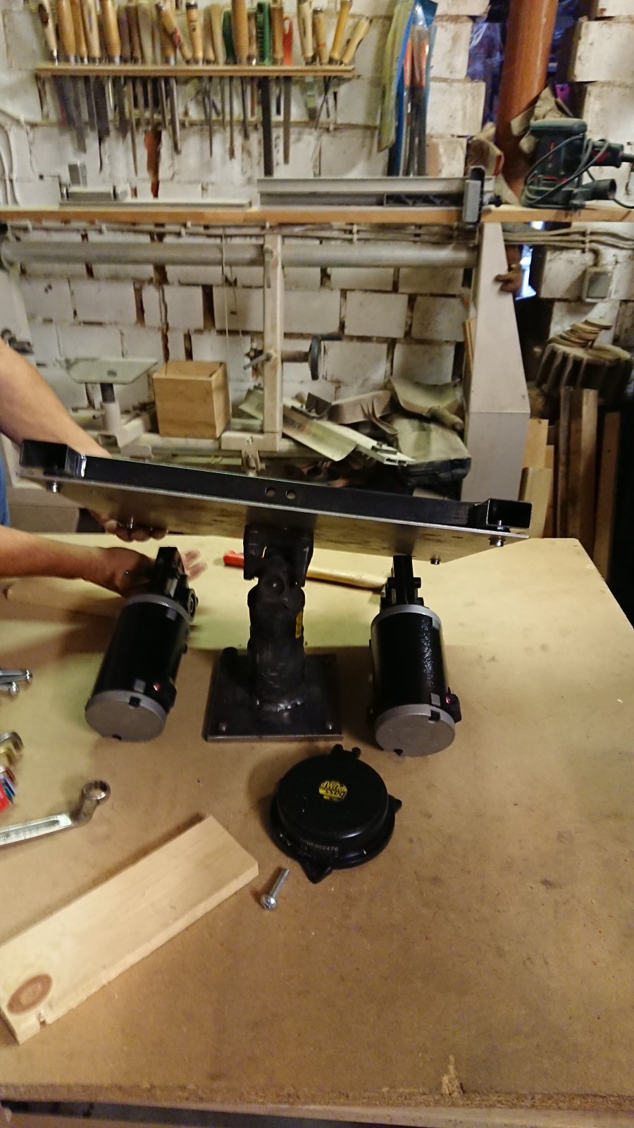

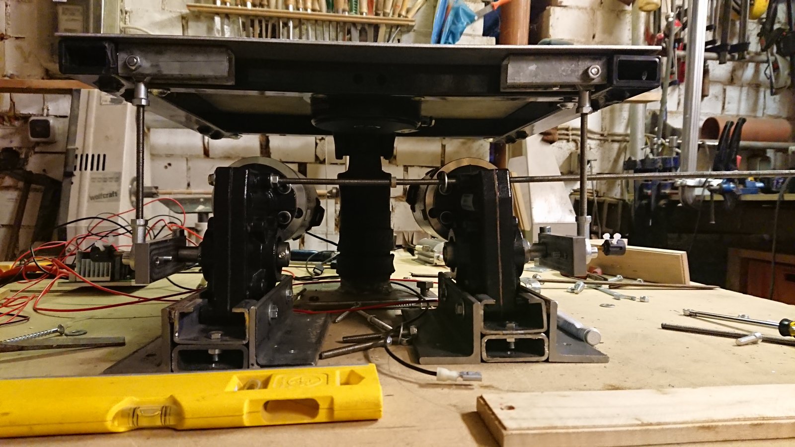

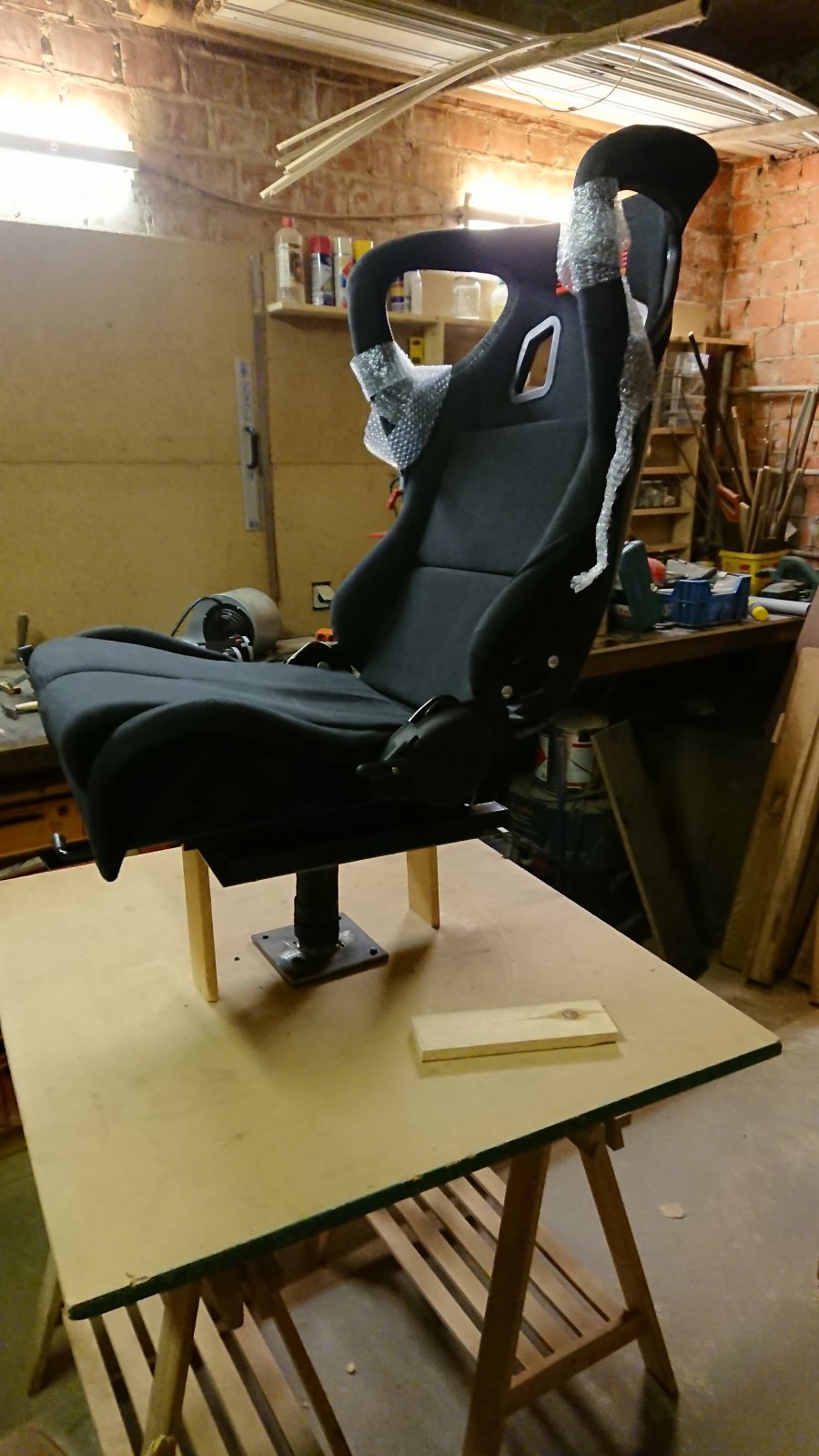

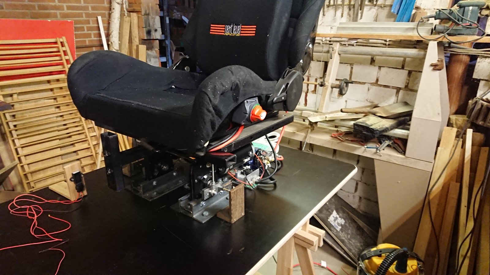

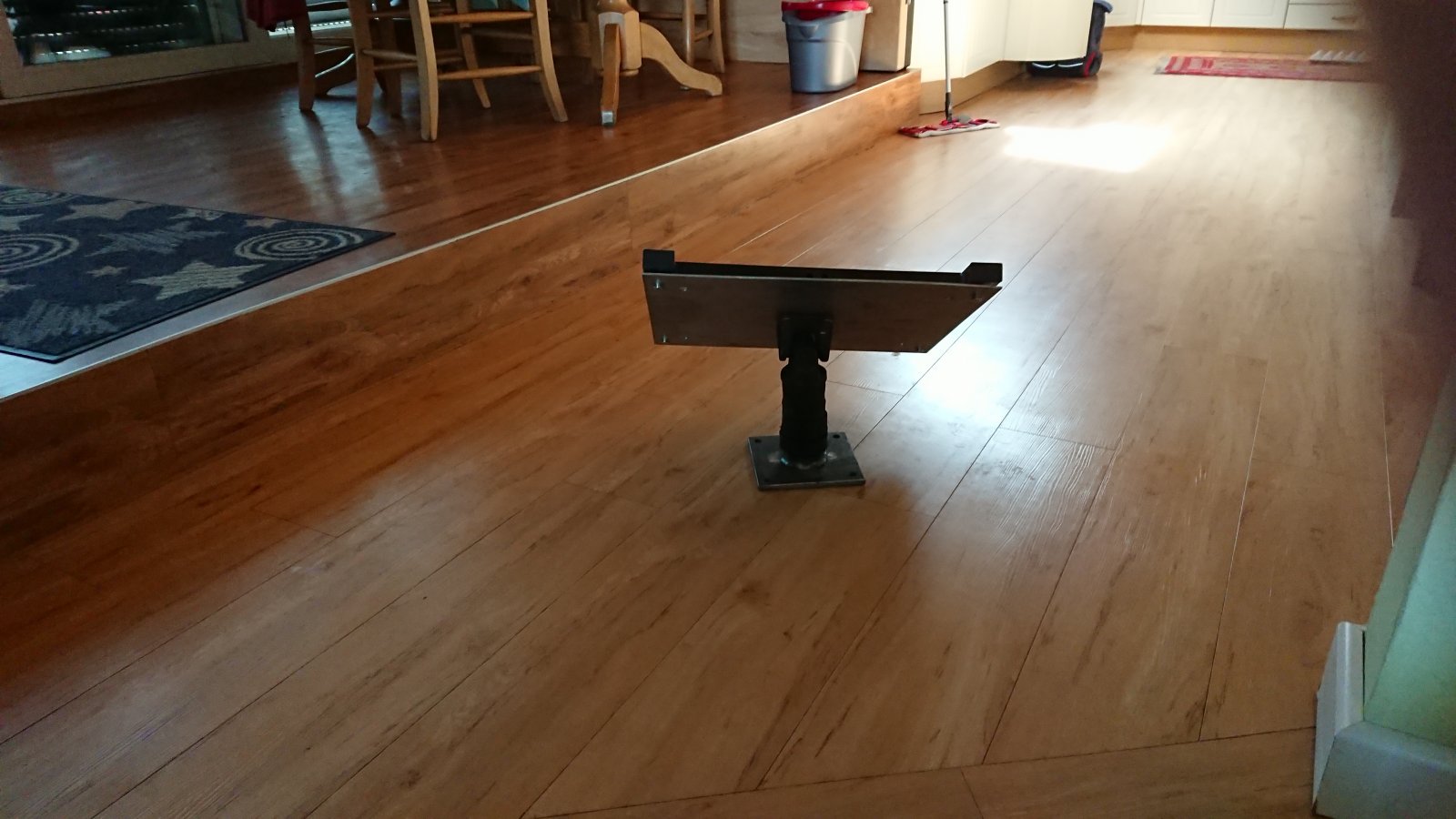

    For some first testing i bolted everything on a wooden plate.
    first the seat to find balance
    after that I added the bass shaker and the ball joints

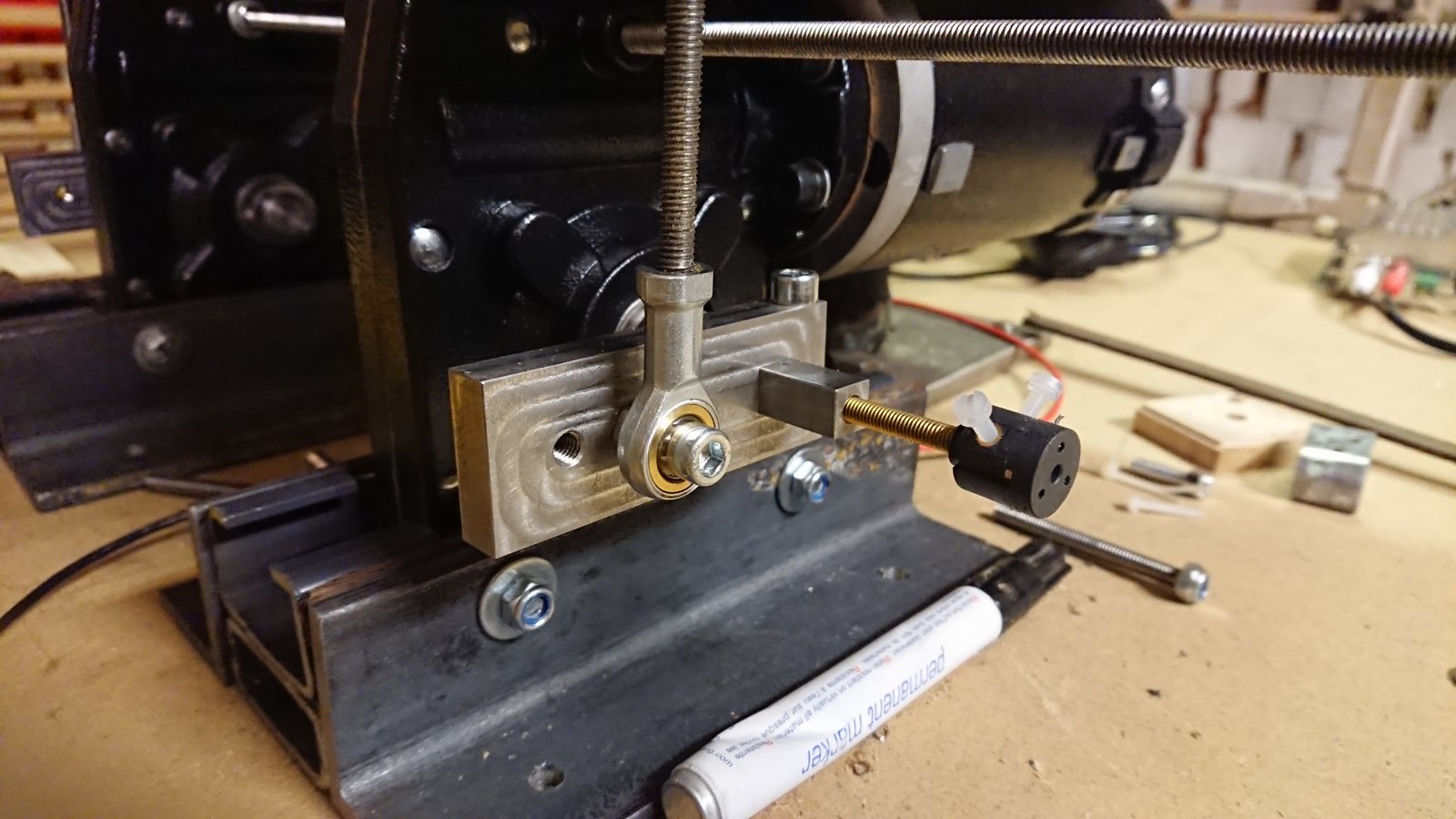

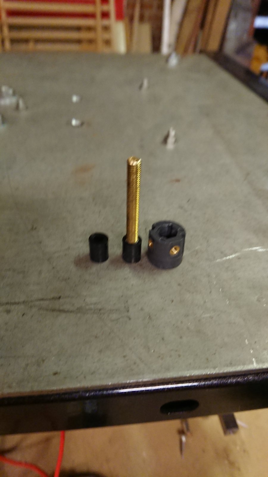

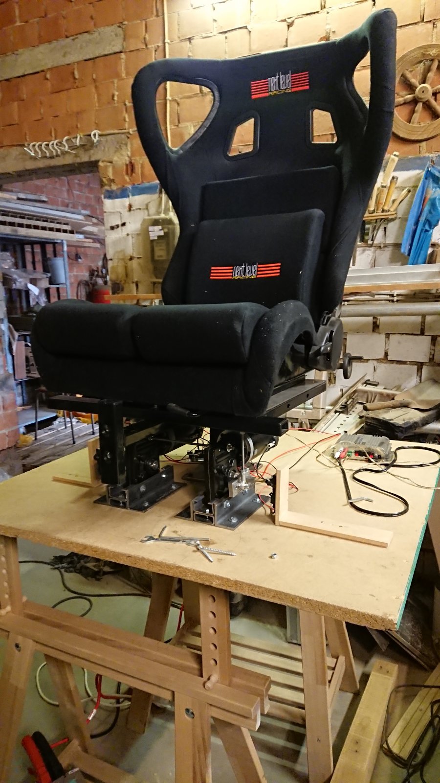

    I mounted the motors a little bit higher so the lever can spin freely. I tried to get the magnets on the shaft by using wood but that din´t work out well an will lead to my profile avatar later on.

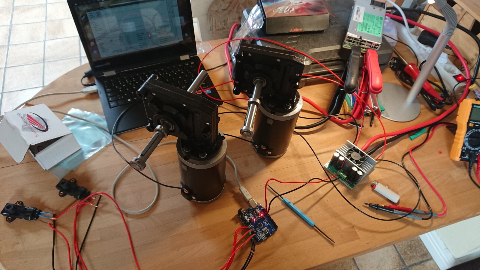

    Everything ready for smc utils! :D

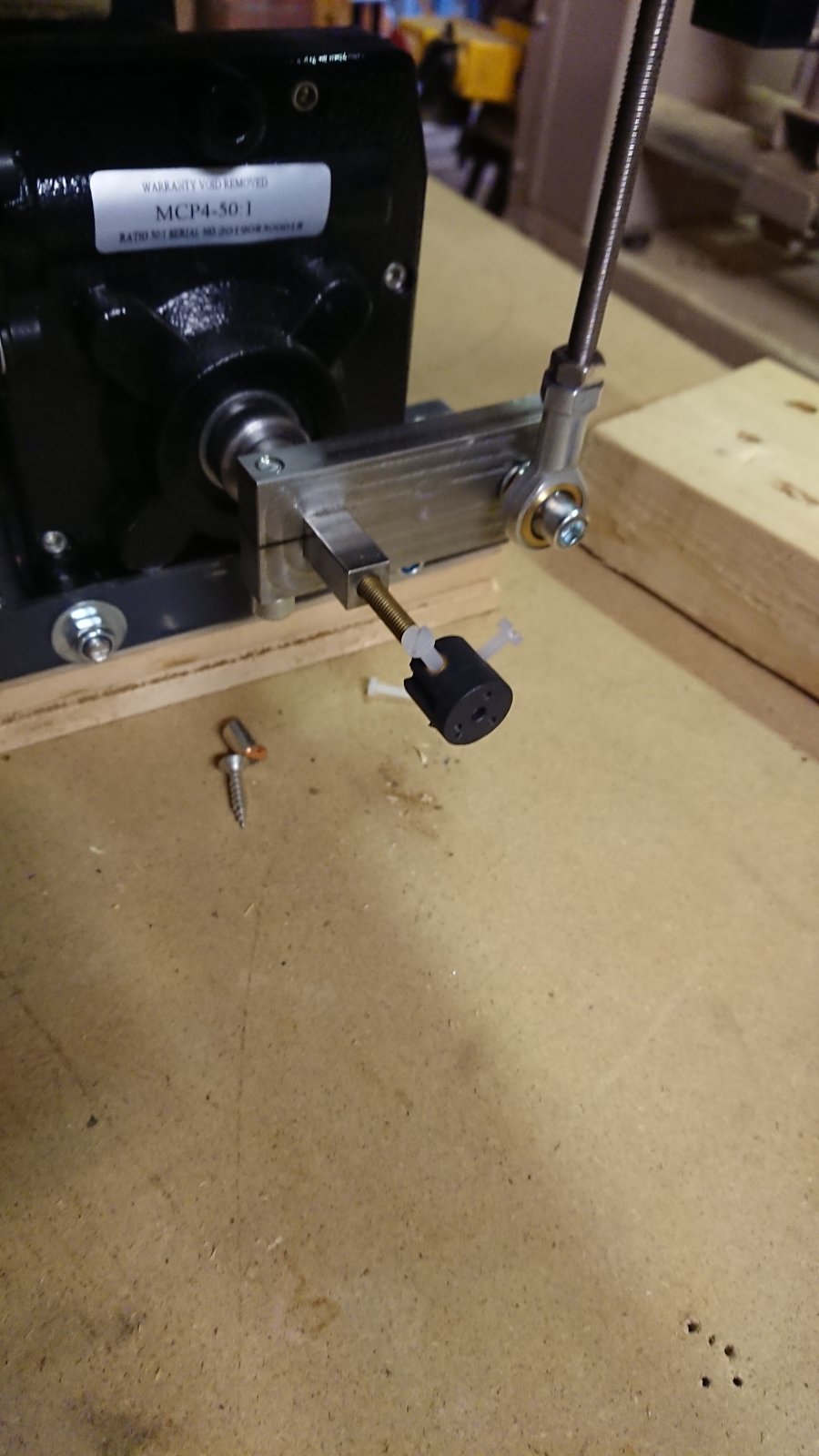

    After everything worked well in smc, i booted up Sim Tools 2.4.1 for the first time and set up the software with help from bastiuscha.
    Of course I clicked on output testing without thinking. Motor one immediately lost his shit and started moving at high speed. The movement was so hard that the magnet fell off and I had to cut power to stop the motor.
    I rolled back to simtools 2.4.0 and found a better solution for my magnets.
    Everything works now, time for life for speed!
    I crasht in a wall and this time, motor two started spinning.
    With my weight on the seat, the motors wiggled so much, that the sensor lost the magnet for a short moment which leaded to the motor spinning around.

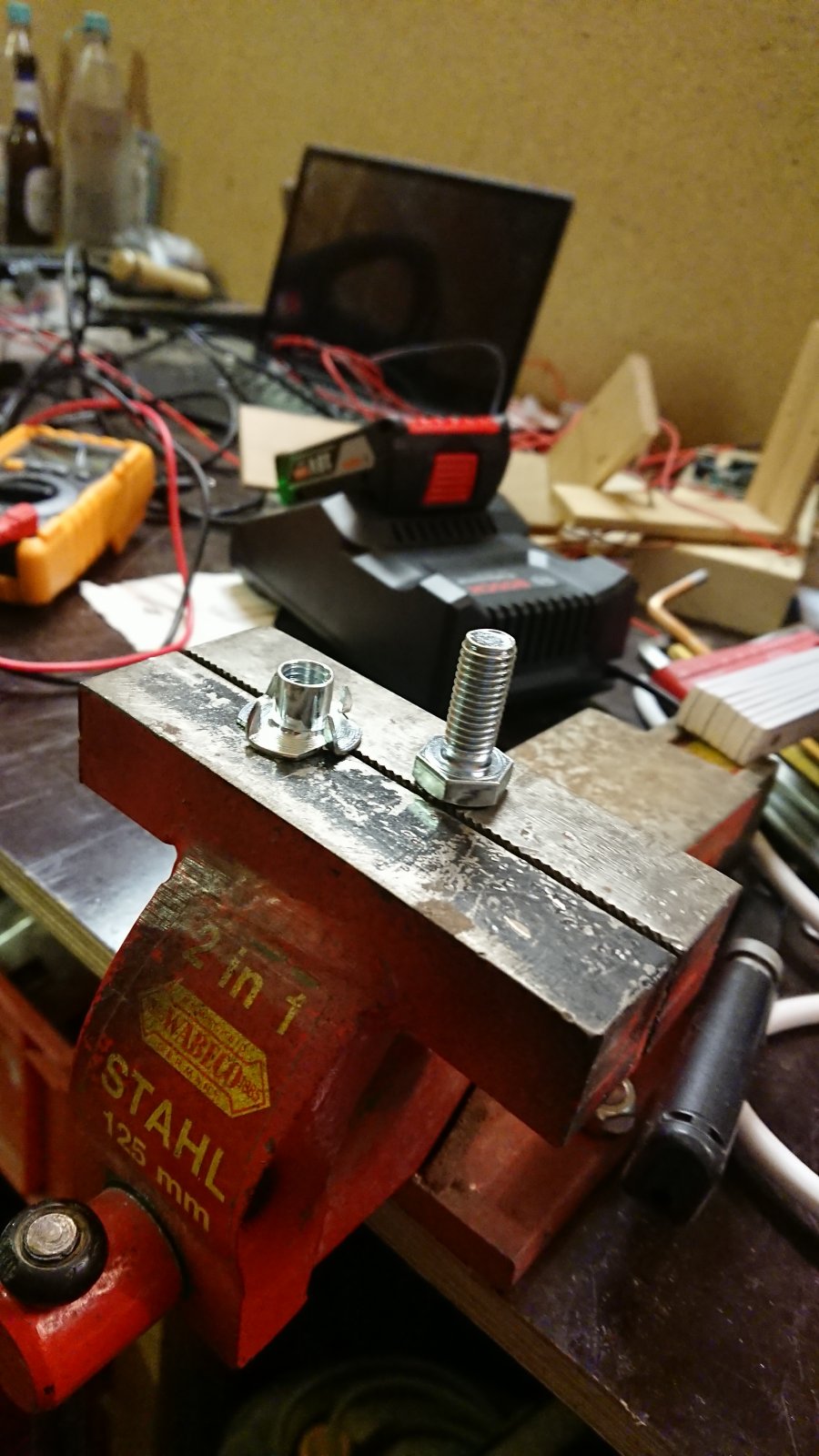

    Got some work done.

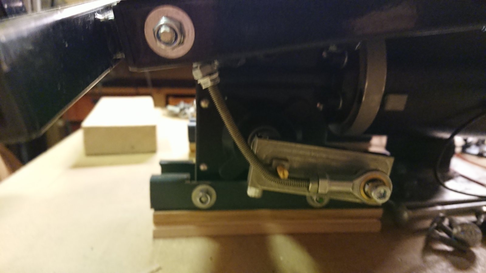

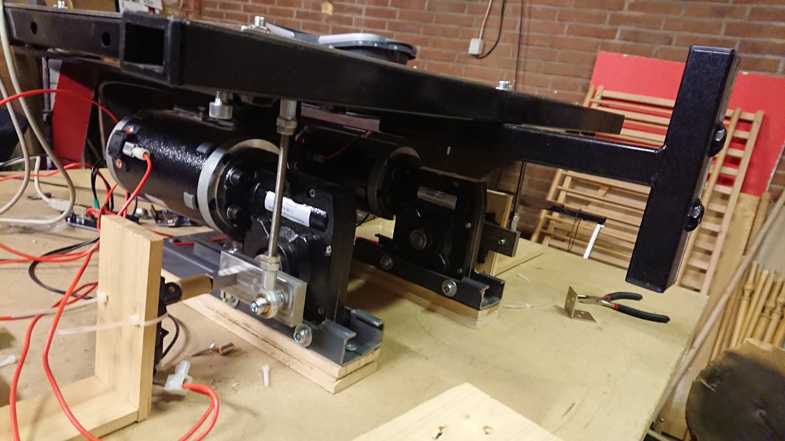

    first of all, this little guy who tried to escape last week:
    I´m relay glad that I noticed before he fell off!
    Build new mounts for my motors:
    Made my lever a little shorter:

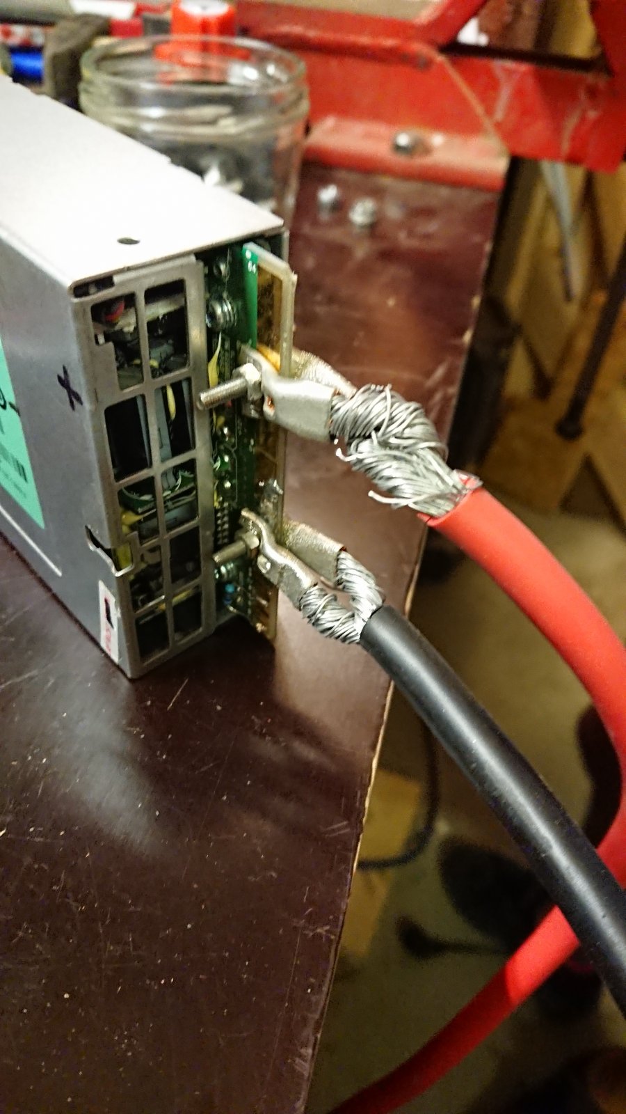

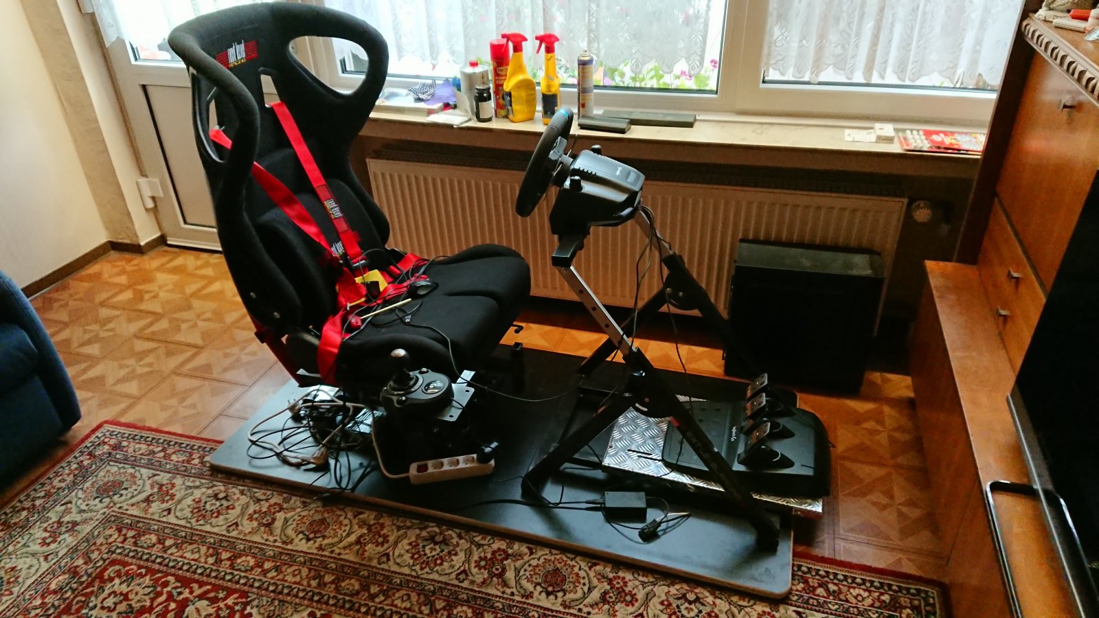

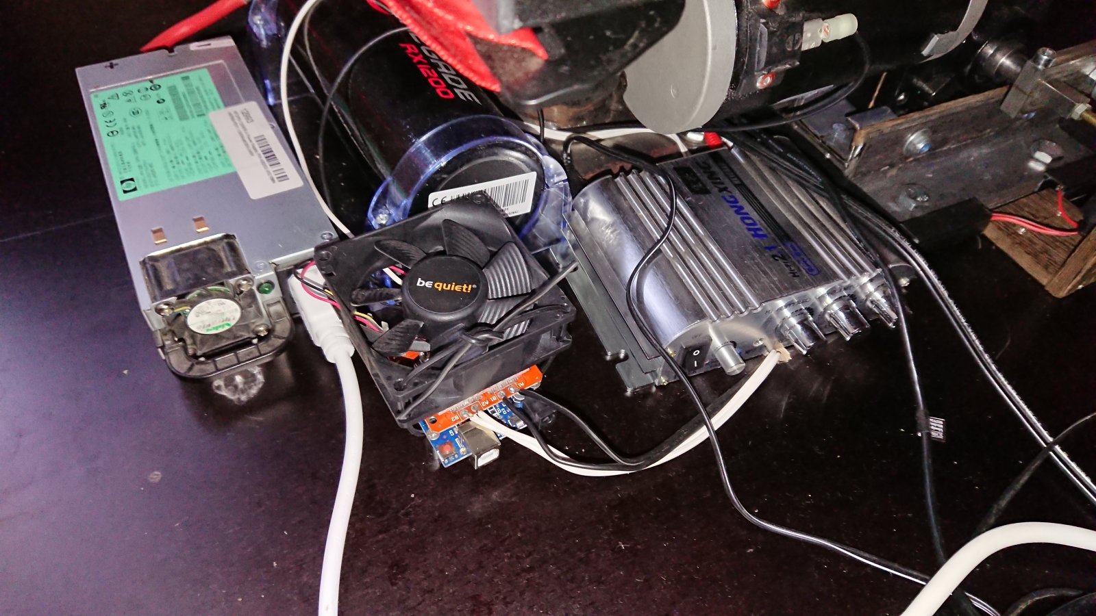

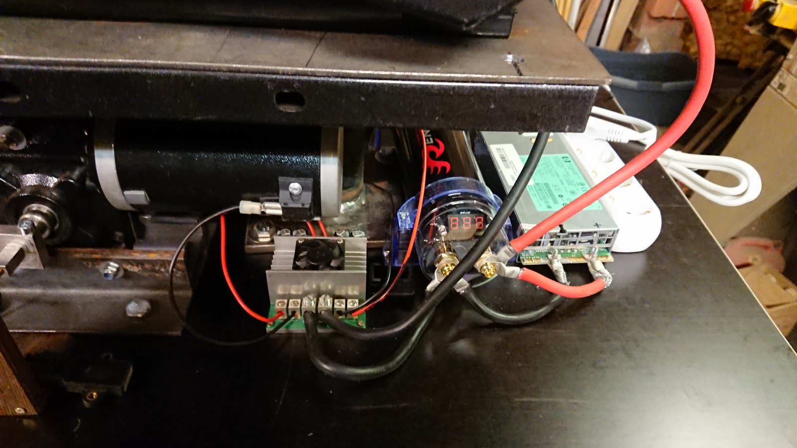

    My solution for the server power supply:
    i will add some electrical tape and hope for the best ^^
  8. Skuldi
    Skuldi Member Gold Contributor
    Aug 16, 2020
    53
    Germany NRW
    265Coins
    +37 / 0 / -0

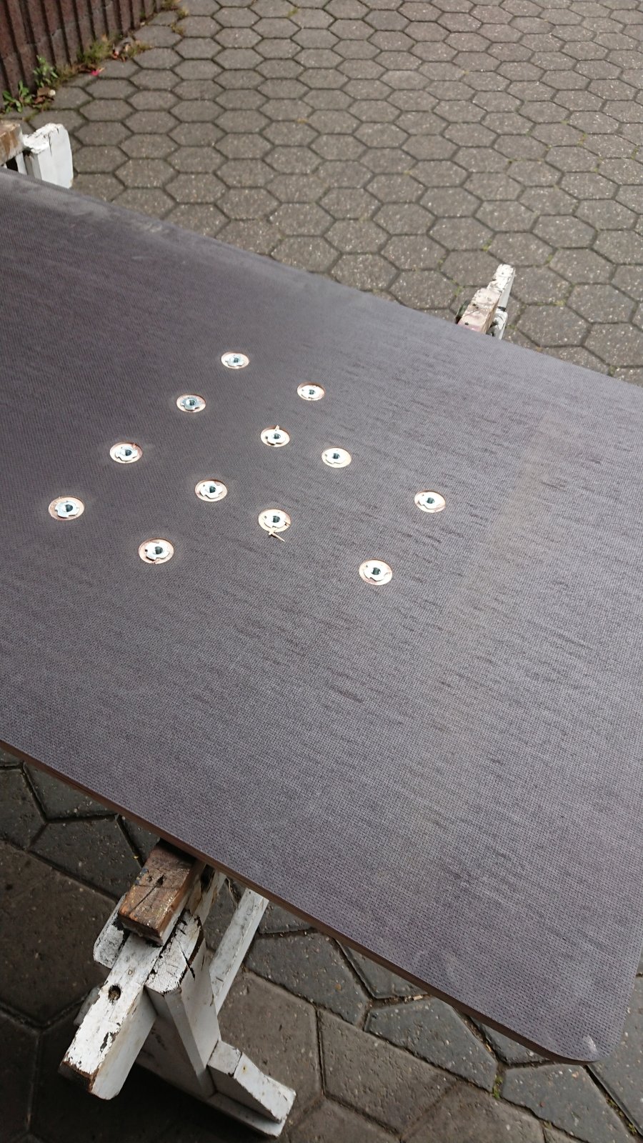

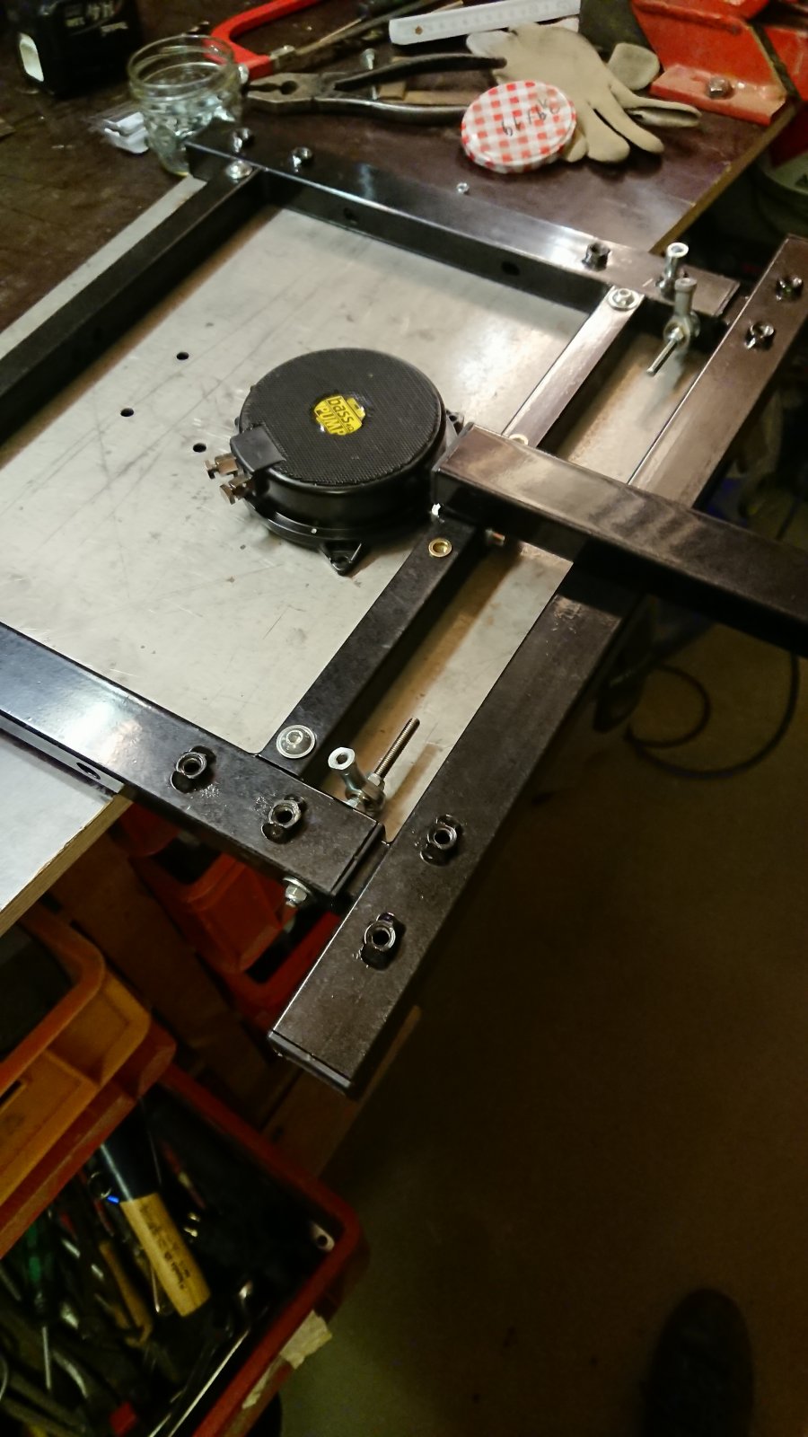

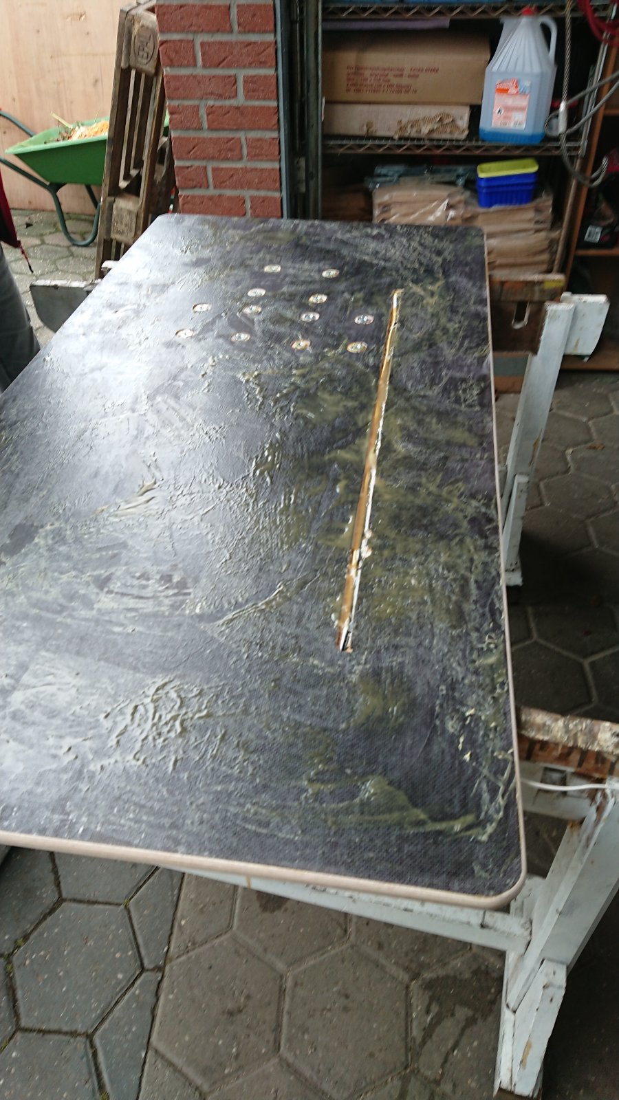

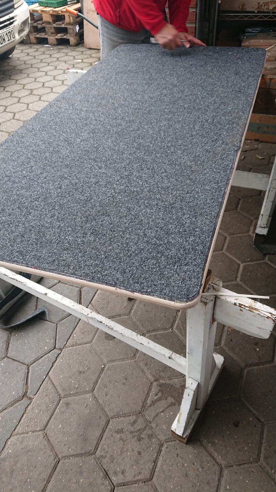

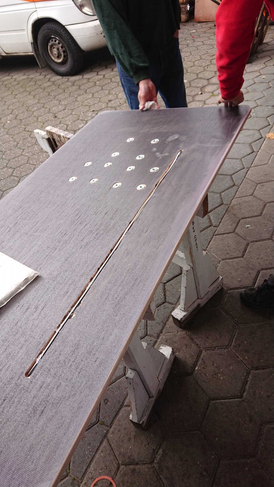

    New base plate!
    Its a 1.60m * 0.80m*0.02m screen printing plate.
    I used this little guys here to bolt the motors and the seat down
    cable management for wind sim
    some sweet neoprene
    and needle felt carpet for sound reduction.
    I hope i can drive with that without getting trouble with my neighbors.:D

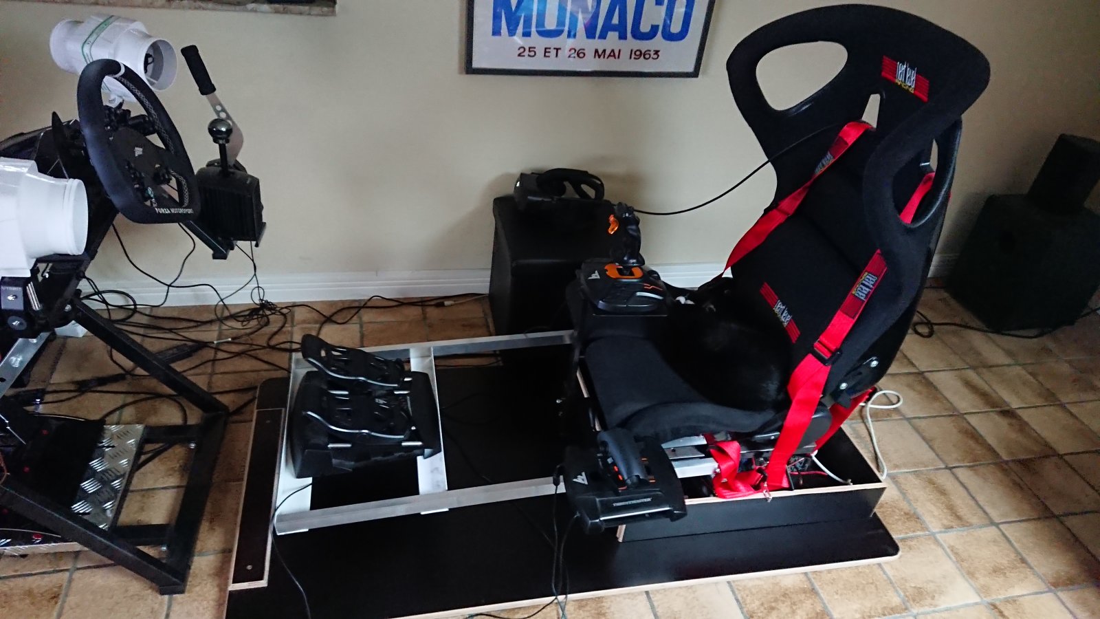

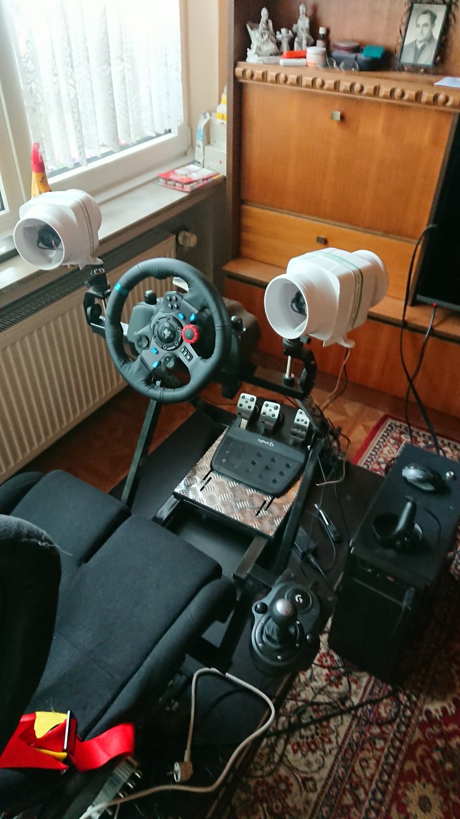

    another weekend full of work!
    I added a power cap to support the power supply
    and a battery switch, so i can turn the motors off, in case something go's wrong
    A plug and arduino+ motorshield for windsim
    final mounts for the sensors and cable management for the wires
    my rig finally out of the cave! :D
    Vid form the test on sunday:

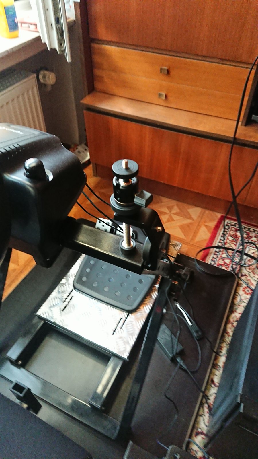

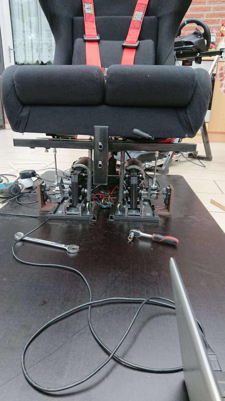

    last weekend i added springs and i cant believe how much smoother the movement is now!
    and found a way to mount windsim on my wheel stand.

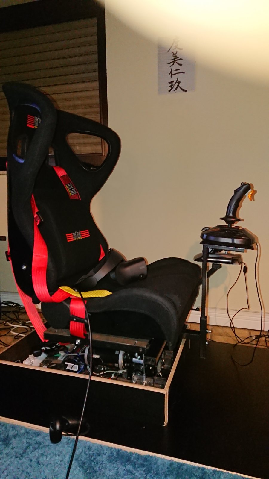

    Build a small removable box around the electroniks.
    well, guess i´m done for now :)

    Had some issues with the motors. They stand still after hart movements. Changing the psu and the power cap did not help. Turns out the cables were the problem. Changed the old ones with copper cable and everything works perfect now.
