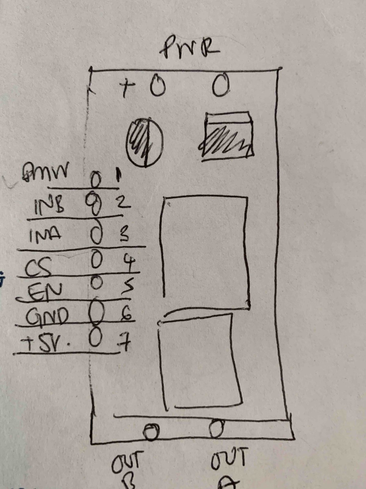

    Hi, how did you used the pins of this one ? i just bought one, but i don't find equivalent pins compared to the double model.

    Hi Quentin,
    Here are the pin-outs: With the Power Pins at the top and with the component side up, the pins will be on the left of the board:
    Pin 1 = PMW
    Pin 2 = InB
    Pin 3 = InA
    Pin 4 = CS
    Pin 5 = EN
    Pin 6 = GND
    Pin 7 = +5V
    See image.
