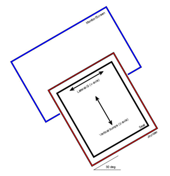

    I haven't finished my SimXperience II yet, but I'm already dreaming of my next project. :lol:
    I am considering combining a JoyRider cockpit with an SCN5 powered seat (maybe only 50mm or 100mm). I was thinking that the Joyrider could move as a car actually would (into the corners) and the SCN5's could move in the counter direction to simulate g-forces. I would add a buttkicker to touch it off with engine vibrations and the finer rumble effects.
    I have been looking at several commercially available motion controllers because I'm not interested in the time and headaches required to assemble my own. Can anyone give me an approximate idea of how many amps continuous / peak are required for a joyrider type design? Pololu has a motor driver that claims to handle 13 amps continuous / 30A peak for only $99 here: http://www.pololu.com/catalog/product/777 Maybe there are better options? I also found an interesting USB stepper controller but I'm not sure that it would be up to the task. http://www.phidgets.com/documentation/Phidgets/1062.pdf
    Any opinions on the best commercially available motors? Has anyone considered using SCN6's for a joyrider style design?
    At first glance, this seems like it could be a really cool sim if they were combined properly. Any advice, links to information or threads on this forum, etc.. are greatly appreciated.

    I think you wont be able to combine a SFGT with a Joyrider. Just think about how the point of gravity displaces in relation to the rubber of the SFGT. The SCN5 are not strong enough to compensate that.

    @ Michael N
    Well, the Frex type of sim really depends on the movement of the seat in relation to the steering and pedal. It attempts to recreate the sensation of the body moving about, however little, to the relatively stationary control devices in a racing car.
    This design eliminates that function by moving everything in unison. I believe that moving the screen is okay, but the Frex sensation is destroyed. Ultimately, it attempts to be more like a Joyrider without adequate rotation to simulate the g-forces. IMHO it fails in both methods. About the only thing is can believably simulate are the bumps from the z-axis.
    R-eng

    @bvillersjr
    I too have had the opinion for quite some time that a combination of joyrider-frex would be the most realistic simulator for achieving an inexpensive 3-dof.
    The seat of the joyrider could be frexed to give a rapid z-axis motion, and the lateral rotation of the joyrider to give the sensation of g-forces. I think a limited range for the seat motion of + 25mm, with a pivot point more towards the front of the seat, might be the ticket. And if at all possible with X-sim2, move the seat with a soft start to the lateral motion, ending with a hard stop. This would then accentuate the correct forces acting on the body when initiating a turn-in manuever, with the capability to maintain lateral force through the turn.
    But I won't be able to do this until I get my 100A h-bridge designed (with Thanos' assistance) and built.

    If you keep in mind, that the SCN5 provide 10kgf each only, you'll have a problem, if you move the whole seat.
    As long as the Frex based sim is in default position (no rotational movement on X and Y) the body wheight rests totally on the pivot (rubber or crossjoint).
    If you move the sim 30°, the force vector of the body weight does not go through the pivot, and therefor the body weight (approx 60-100kg) is applied to the actuators, which actually just are able to take 10kgf max (increasing the speed even decreases the kgf, as the SCN5 are stepper driven). Even with the stronger SCN6 model I doubt that it would work well.
    For a combination of large movement range and massive rumble effects I'd suggest to use the some linear motors like te carmikaze simulator uses, in conjunction with a system das provides large movement range like joyrider or others.
    Regards
    Christian

    Hi
    Ego you are absolutly richt
    scn5 ore 6 are fare to weak fore it.
    frex use 100mm ones, only to avoid fore going to far off balance
    dont forget when your wicht is 100kg and you go 10 degrade offbalance you need around 15kg force :thbup: only to hold.
    gegards Ad

    Yes I agree also about using the Frex system including SCN5's like this. The loads are all wrong. I only meant that applying similar movement to the seat itself, would probably make for a more defined sense of heave. Even if the joyrider were at 30' laterally, a perpendicular movement to the seat bottom would appear to the mind as z-axis, because it would not be moving the body sideways within the seat. And most importantly, in relation to the screen, thereby maintaining correct visual cues.
    Then imagine lateral forces being applied to the upper torso, which even at 30', would appear to the mind as true lateral-G. The movement doesn't need to be excessiive; + 25mm either way I think would be more than adequate. We are only trying to introduce mind reinforcing cues. The Joyrider would provide the sustaining forces.
    I would think wiper motors would be very suitable for this purpose, one for each force direction with quick and short motions.

    IMHO, R-eng is right... I cannot add to the joyrider z-axis motion as it is, because the only way is to add it to the seat. But this will provide wrong motion cues in relation to the screen.
    The only solution could be to use a pyramid like method, that goes like that:
    Outer rotation frame: x axis
    Middle rotation frame: y axis
    Inner up-down frame: z-axis
    With this order will avoid possible balance issues, but the up-down frame should be supported with at least two high power motors (this is where the 100A h-bridges fit!), even if the motion they provide is just a few inches!
    The only other effective way is to use a 3DOF coupled motion cockpit like Force Dynamics! :brows:
    Regards, Thanos

    Actually, I think in theory a Joyrider could provide the heave motion with just the 2-DOF. Let's break down the anatomy of a bump (heave). It is the front wheels which make first contact, riding up and over the bump. Consider this a positive half sine wave. A few milliseconds later the rear wheels ride over the same bump, so consider this another half sine wave. But if we view the rear sine wave in relation to it's rotation around the front axis, it is a negative sine wave. Combined, this is a complete sine wave. To simulate this, the y-axis of the Joyrider would need to rise at the nose, return to neutral, then rise at the rear (or inversely, dip at the front) before finally returning to neutral again. This motion is a full sine wave. If it is a curb, then the x-axis is also invoked.
    The problem is, are the motors and drive system of the simulator up to the rapid forces needed? We need big balls to do this with virtually no hysteresis. Current Joyrider implimentations IMHO do not!
    But that does not make this theory invalid. And this is where we can have afrexed Joyrider to fool our minds into a 3-DOF with smaller/less expensive balls.
