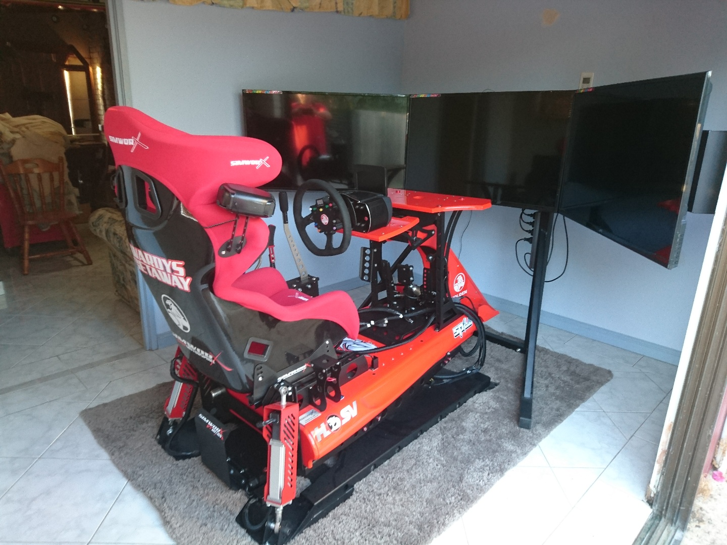

    Hi
    Not sure if anyone can assist me, I recently purchased a used Simworx SX02 motion sim and I have purchased Simtools 2.2.5. I am totally new to simtools and I am struggling how to setup Simtools to have the motion to work for iRacing, I installed the iRacing pluginfor simtools but I have no idea how, or what settings I need to enter into the Simtools interface. I have read all the documents but I am still confused. The motion sim has 2 actuators on the rear and a traction loss actuator on the front of the machine. I can find what usb ports they are but I do not know what setting I am required to enter.
    Any advise would be appreciated.
    Jamie

    They look like scn actuators? (probably scn6's?)
    Figure out what type of actuators you have first, and then we can go from there buddy.

    They are SCN6-60-100
    In device manager I have checked what ports each actuator is on
    The Left hand rear is Com5
    The right hand rear is Com4
    Front is Com3
    If you can assist with setup it would be appreciated
    Jamie

    First setup 3 interfaces in game engine, one for each axis using the scn interface.
    Then restart game engine and see if they center for you.
