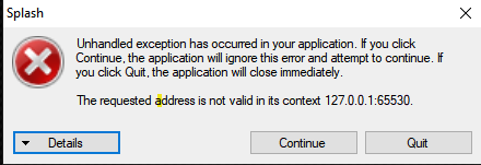

    simtools 2.5.1
    iracing plugin loaded 2.0.3.2

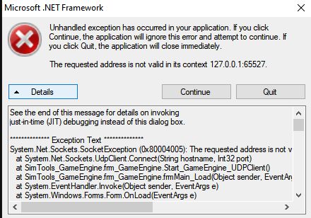

    Havent used the sim in a little while, on starting game manager and game engine I get .Net framework error.
    System.Net.Sockets.SocketException (0x80004005): The requested address is not valid in its context 127.0.0.1:65527
    at System.Net.Sockets.UdpClient.Connect(String hostname, Int32 port)
    at SimTools_GameEngine.frm_GameEngine.Start_GameEngine_UDPClient()
    at SimTools_GameEngine.frm_GameEngine.frmMain_Load(Object sender, EventArgs e)

    This is strange, perhaps someone can explain to me.
    I disabled VPN and it worked. Was it doing a license check?

    127.0.0.1 is a loop-back address, this means it sends the data locally to itself.
    So my guess is the VPN blocks the loop-back is all.
