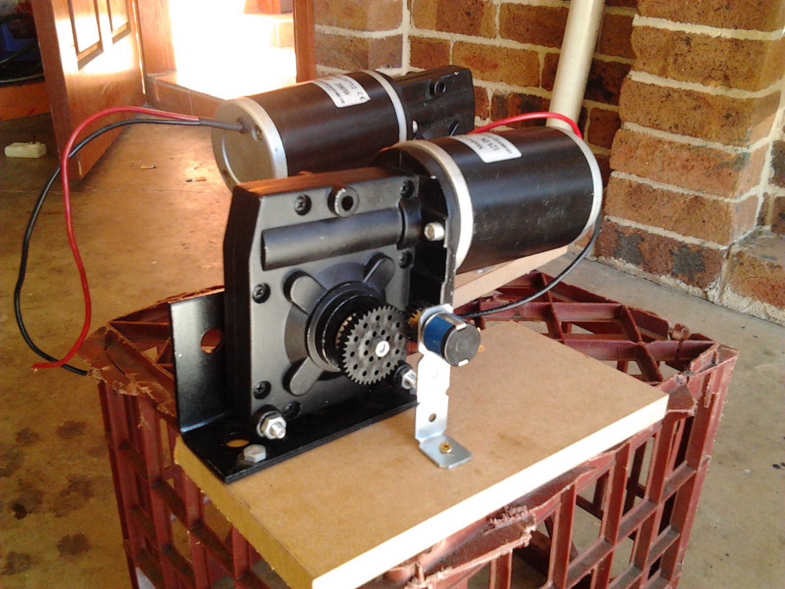

  12. bsft

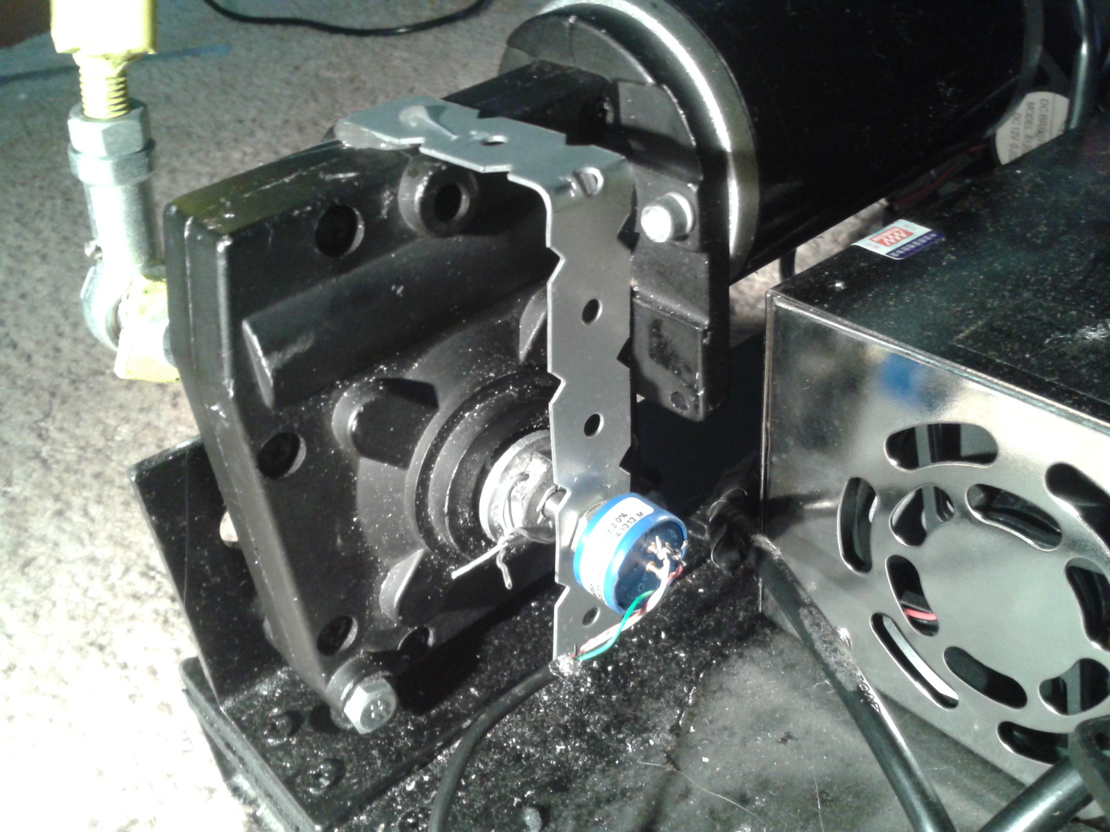

    yes thats the motor used, The supplier is 5 mins drive away from me.
    I will have a look later for photos.
    The gear set up was good, I was trying to take advantage of using as much resolution of a pot as possible, however. I recall I only used about 1.6 turns of a 3 turn pot.
    These days I just use a 360 deg single turn mounted directly on the back of the motor shaft. The difference of 160 deg of a 3 turn pot and 140 deg of a single turn 360 is ZERO. I can notice no difference. They both work just as well.

    Attaching Pots to a Motor isn't that hard, Use Flex Coupler's and its Easy Peezy. Match the 2 sizes up and make a rather simple "L bracket" or "C bracket" to hold the pot

    Thanks.. My problem has been finding motor with the two shafts..one for the lever and other for the pot.
  16. bsft
    @stroutmail , heres the photos
    2013-07-02 12.09.49.jpg 3 turn pot with gear setup
    2014-03-28 10.35.20.jpg single 360 deg single turn on back of motor shaft
