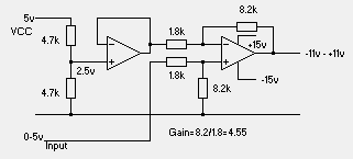

    As I'm going to the AC motor's way, I need a simple circuit that will translate the 0 - 5 volts signal from my AVR motion controller to a -11/+11 volts signal.
    To explain better, when I supply 0 volts from my AVR, the output should be -11volts, when I supply 2.5volts from my AVR the output should be 0 volts and when I supply 5volts from my AVR the output should be +11volts.
    The shifting of 0-5 volts from my AVR will be analog and will be indicating the direction and speed, with 2.5volts to be the center stop of the motor.
    I'm trying to make such opamp circuit that can do this voltage level translation into signals that can be read by AC drives for AC motors but I had no luck until now, as my knowledges in analog electronics isn't that good yet. If you can, help me by suggesting a circuit I could try to achieve this level translation...
    Best Regards, Thanos

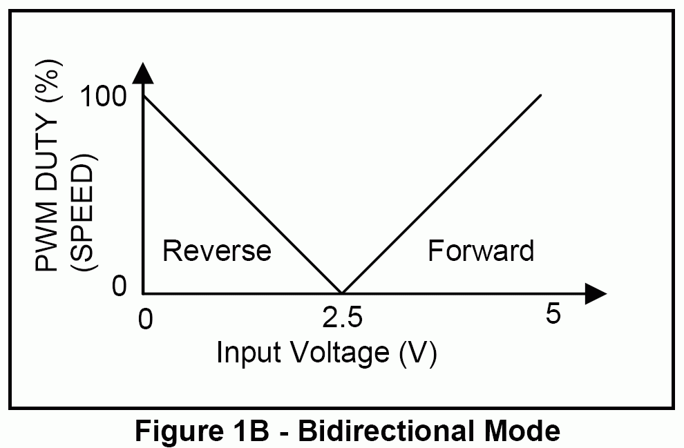

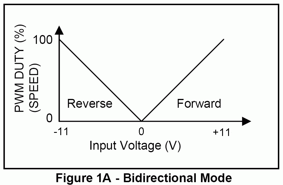

    Hi Brian,
    I want it to increment and decrement the voltage in analog mode, (not digital like switch)
    Currently the output of my AVR board is analog voltage like in the schematic below:
    And I want it to amplify it into a higher voltage level and shift it so the center will be 0 volts in the output:
    You can imagine it as an AC signal, but used in a different way to set the speed and direction of a motor!
    Any ideas?
    Regards, Thanos
  5. tronicgr
    tronicgr
    Someone suggested me this circuit. Will this work? :sos:
    Regards, Thanos
