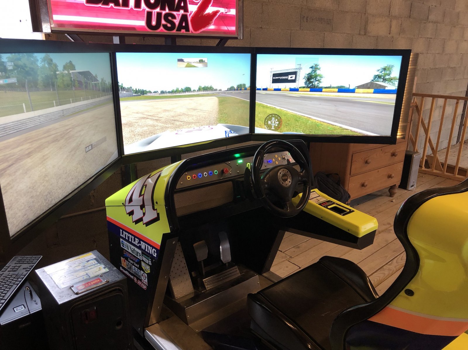

    Hi
    First it was a long time that I've not been in this forum and I've not enough message to post picture (I think ?) so it will be a bit hard to explain...but I will post picture as soon as possible.
    So I've got a Daytona 2 cabinet since long time.
    It looks very nice and the cabinet is fixed by mean of a long and huge shaft which allows rolling rotation. In the original game this effect is simply reproduced by the ffb wheel with a belt all around and below the cabinet. Simple but very restricted.

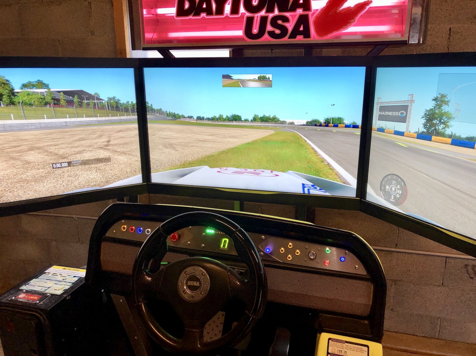

    So I decided to use it to realize an original simulator with specifications below:
    - 3 screens and not an only one away
    - rolling effect manage independently with game (it will be a 1 dof for the moment)
    - direct drive steering wheel with paddle and hand break (instead of the original 4 shifters)
    - dash board
    - sound performed by the 4 initiales speakers (2 in dashboard an 2 in the seat)
    I've progressed in all the structure by create a aluminium support for 3 screens with a fiberglass hood in order to have a finished set.
    Inside I've removed the belt and placed a classic DC motor to perform rolling mouvement.
    A lenze servo motor was used as the direct drive streering wheel (with Argon driver) from an old set up I've made previously.
    The dash board was all created in aluminum sheet with button and display for RPM and shift.

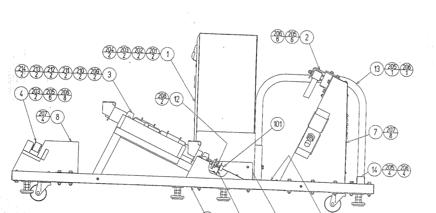

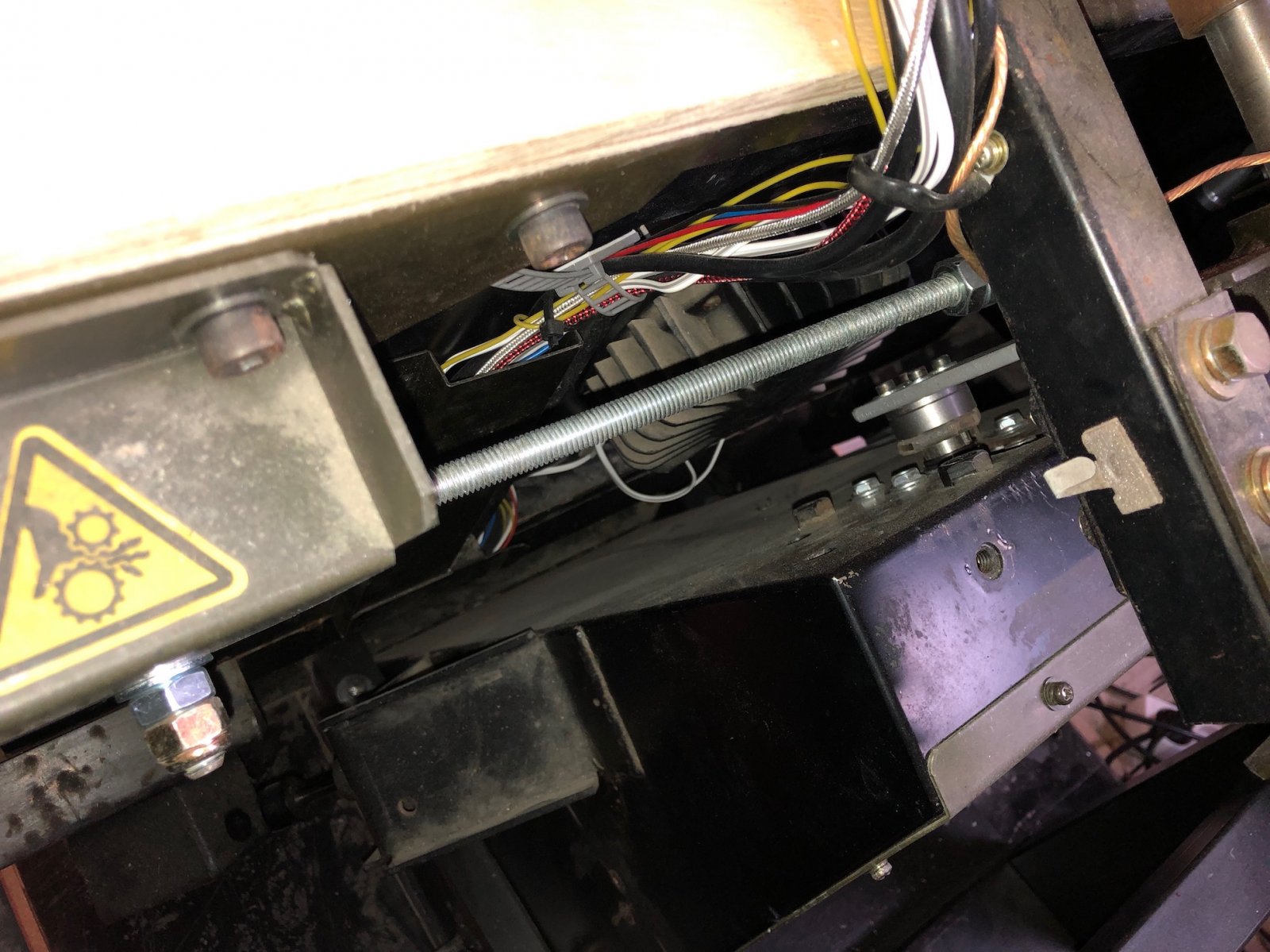

    As you can see below in this drawing from manual arcade game (note that the entire cabinet is removed in this sketch) :
    - there is a very strong shaft (#3) on which the cabinet is attached
    - it's interesting because on detail #12 there is a potentiometer which be able to locate the rotation of the shat so I use it in the electronic hardware to control motor
    - I replace the detail #2 (original belt controlled by the ffb wheel) by a DC motor with a shaft to move the cabinet
  5. deloum
    deloum New Member
    Nov 17, 2015
    15
    paris
    34Coins
    +8 / 0 / -0

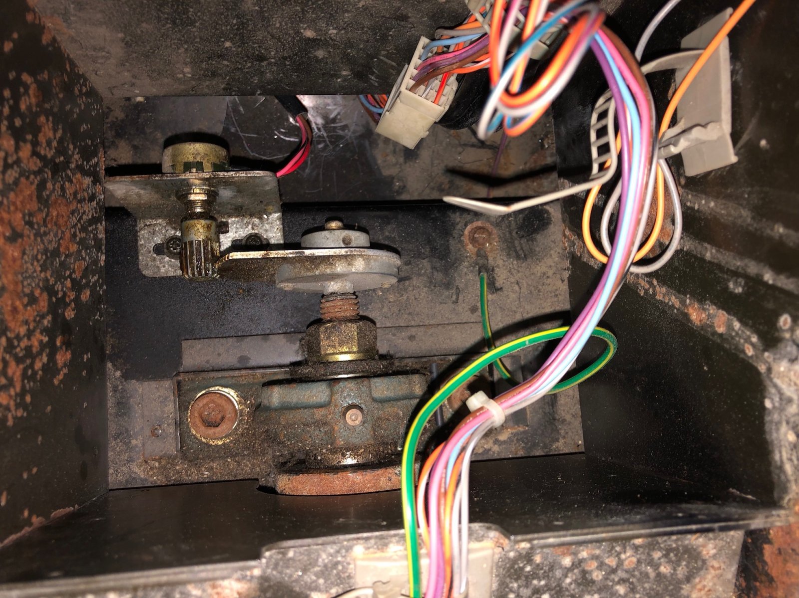

    So here pictures to show :
    - the rolling motion by mean of a DC motor (it's a bit difficult to see something but we see the shaft motor on the right and the threated shaft which os connected to the cab). The picture is front of the cab. As you can see there is a bass shaker which is just behind pedals.
    - the potentiometer connected to the the central shaft (picture inside the cab, front of pedals)

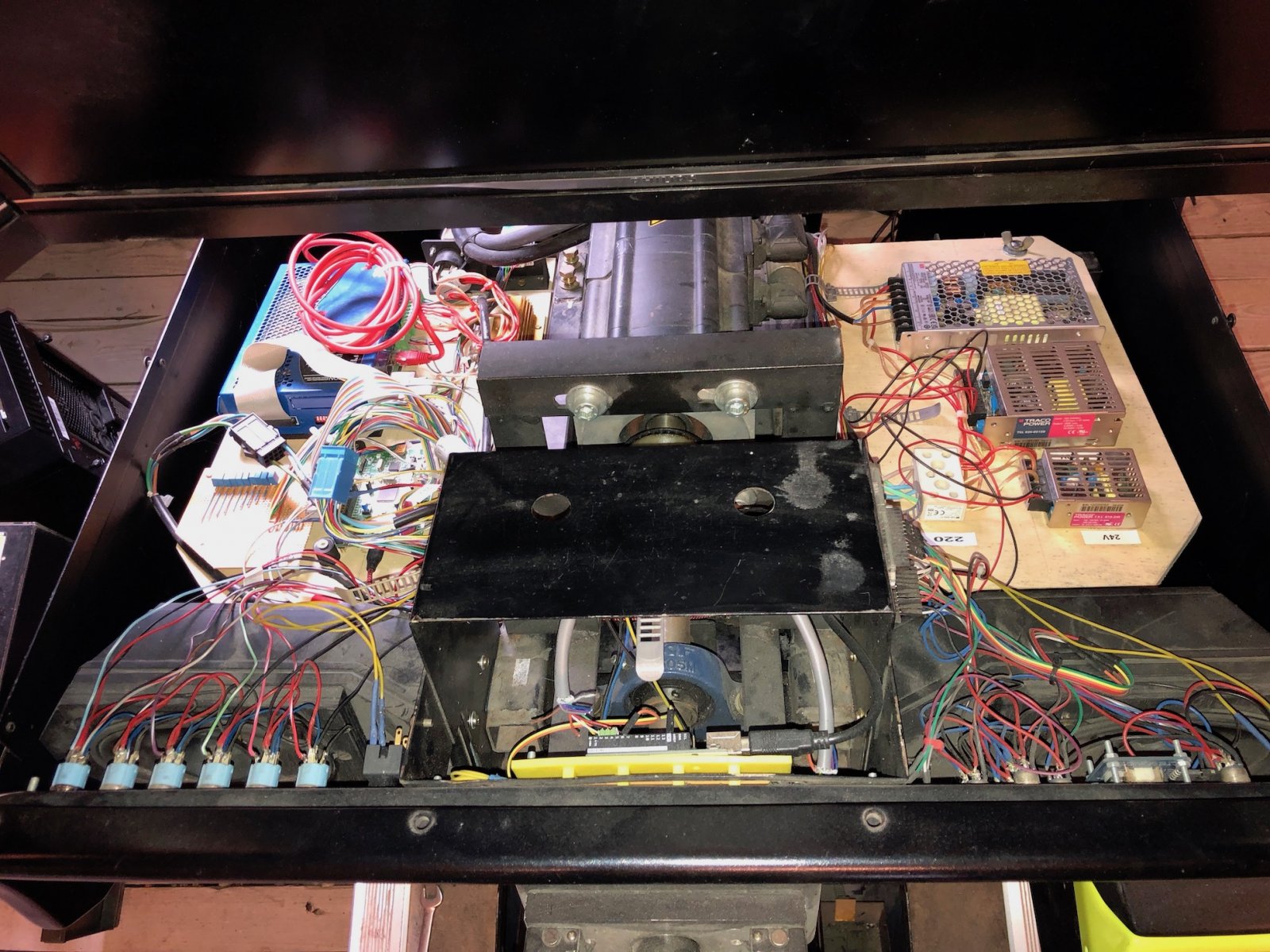

    As I previously noticed I will remove all the original wheel and build a structure to place a direct drive based of a Lenze sermotovor which is controlled by a Argon driver and a STM32 (under mmos software).
    Here is the electronic force feedback wheel (under the main hood) : servomotor on the center, Argon driver on the left and different PSU on the left.

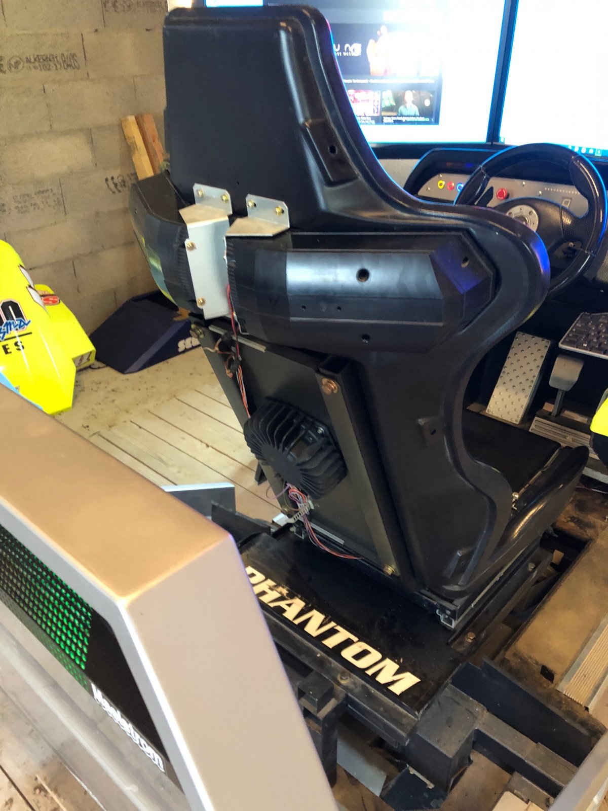

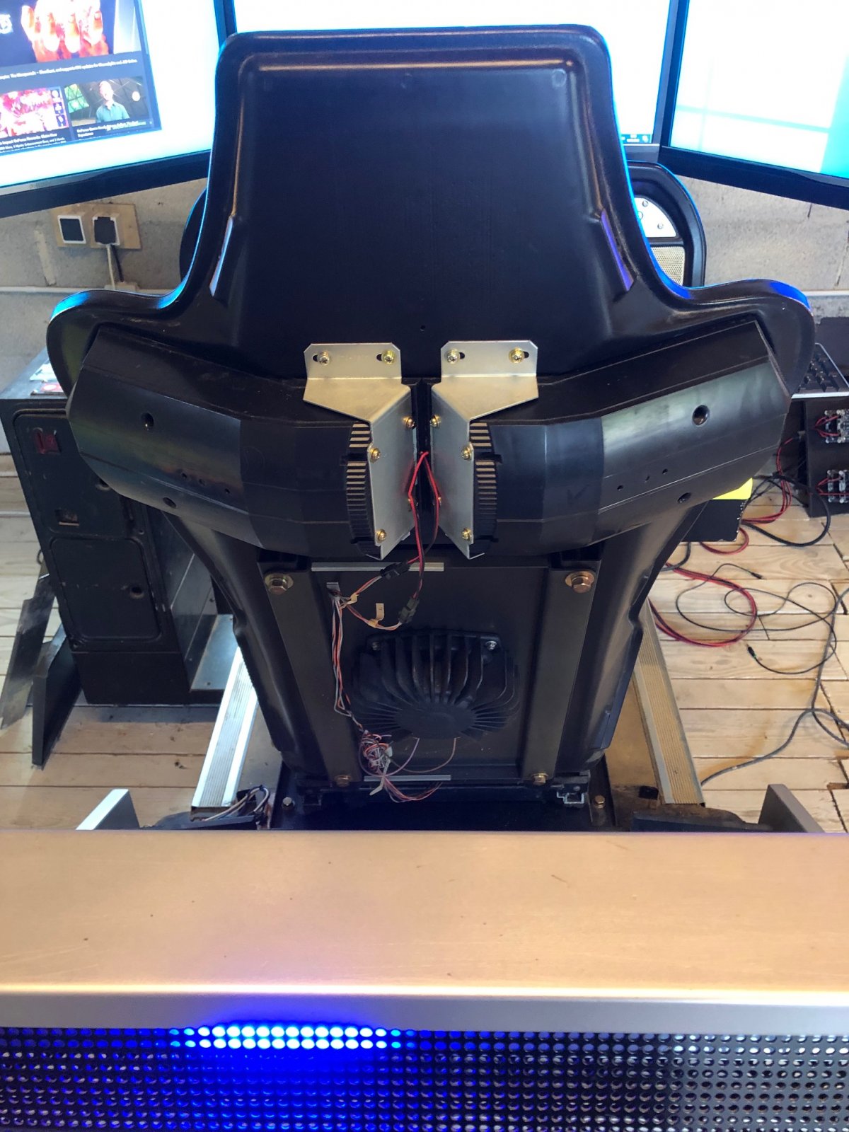

    The seat is designed with speakers and shakers. The sound didn't work....just due to a non worked speakers.
    With this model https://www.smallcab.net/haut-parleur-ovale-8ohms-p-451.html
    it works very well.
    When the back seat is removed you can see speakers and shakers :

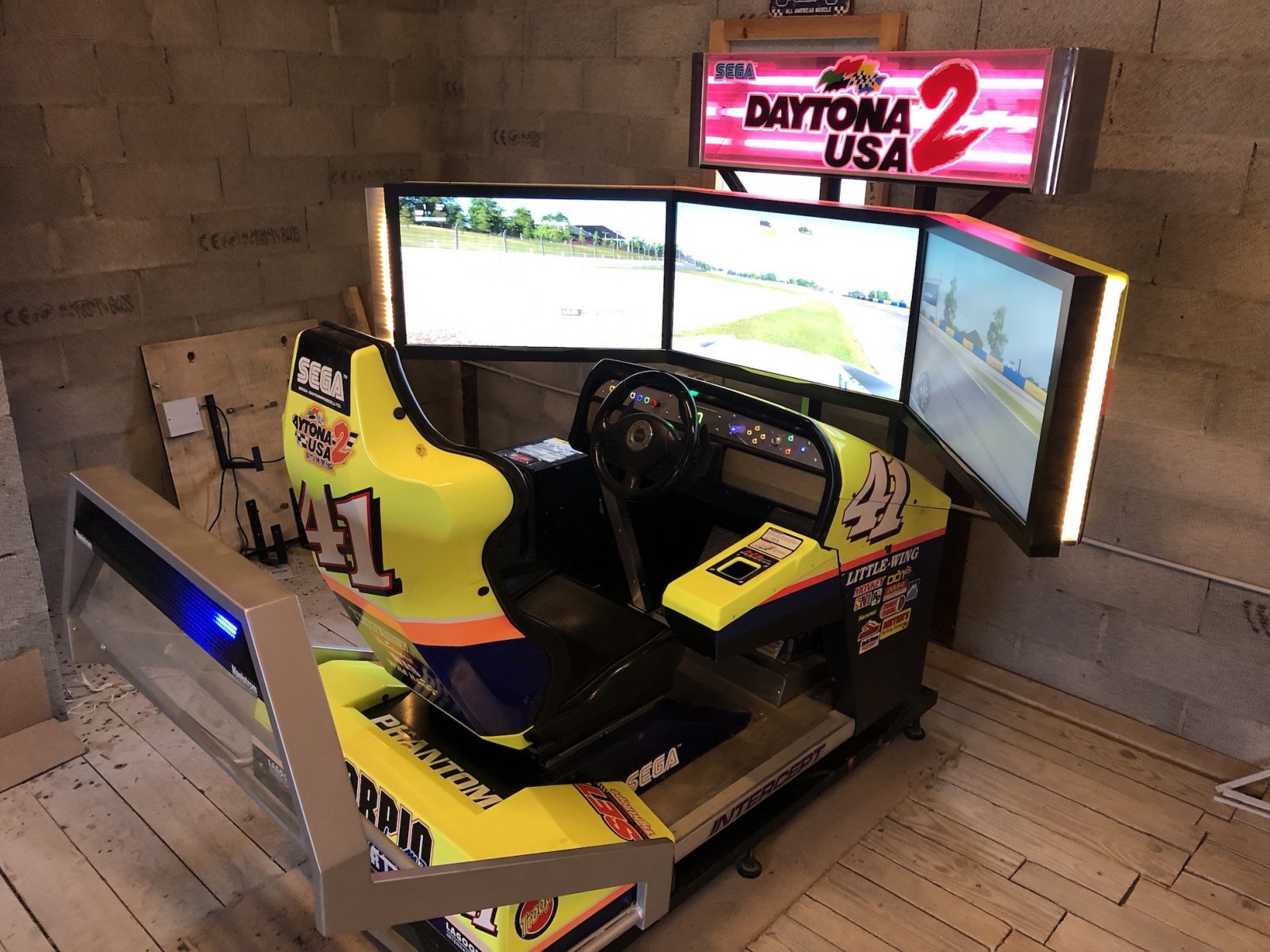

    Many times I've not posted news about this wip...
    So here a short video showing how it works with my daughter !
