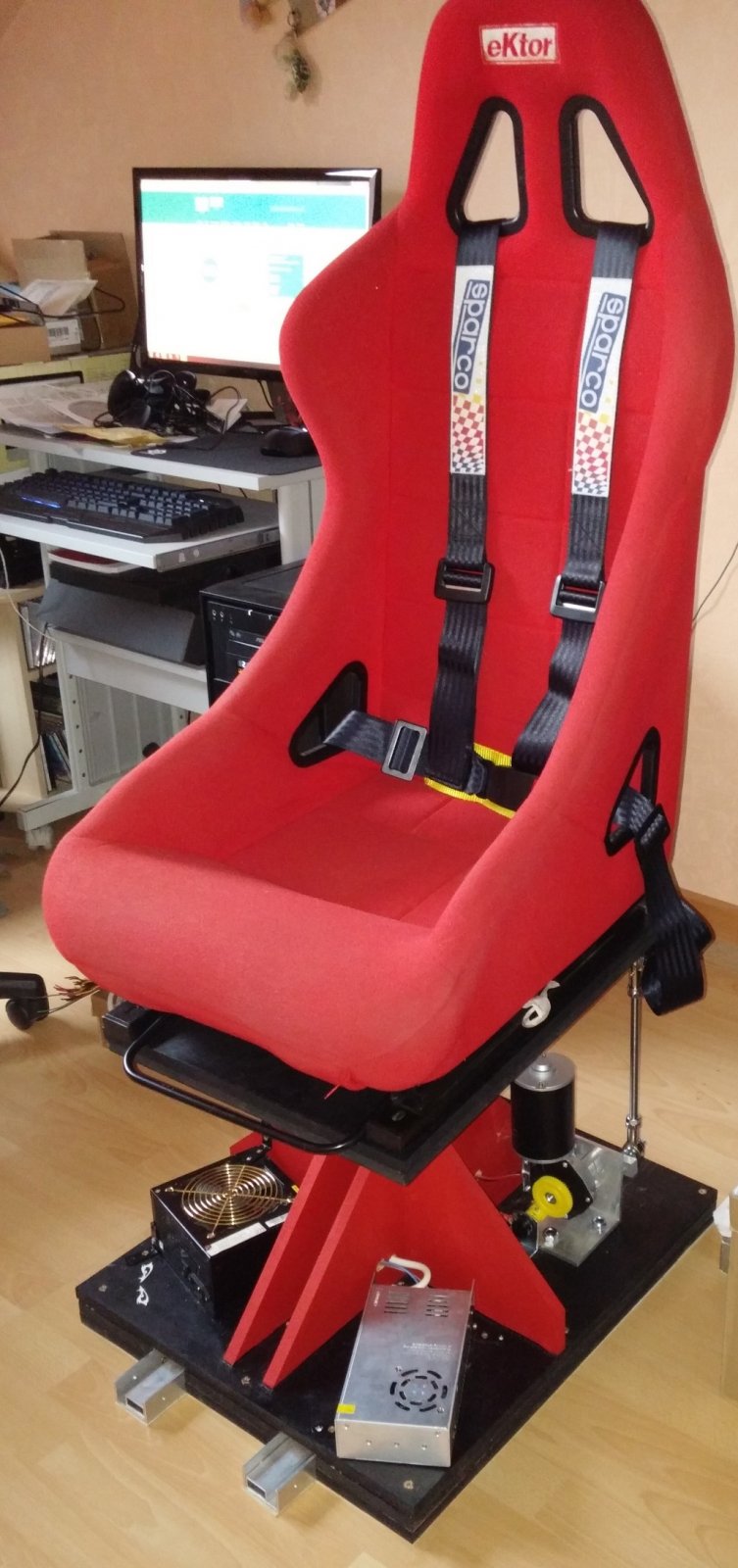

    Hello everyone,
    I just finished the assembly of my simulator , I will go to the software section .
    My support is currently wood but I count it again in aluminum profile but I'll have a little fun with before !

    Nice work , could you tell us + hardware and can some pictures.

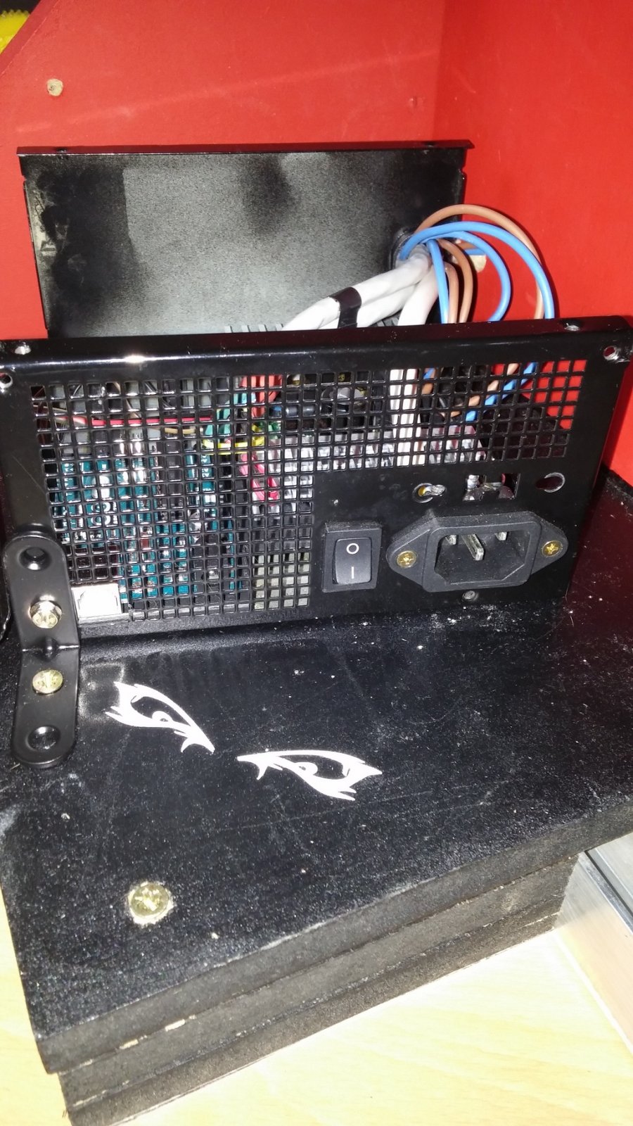

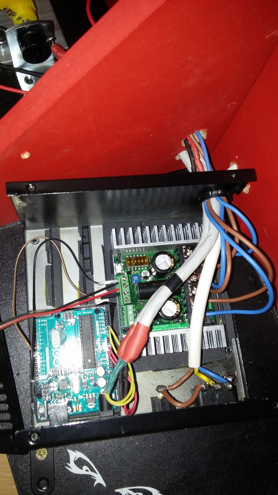

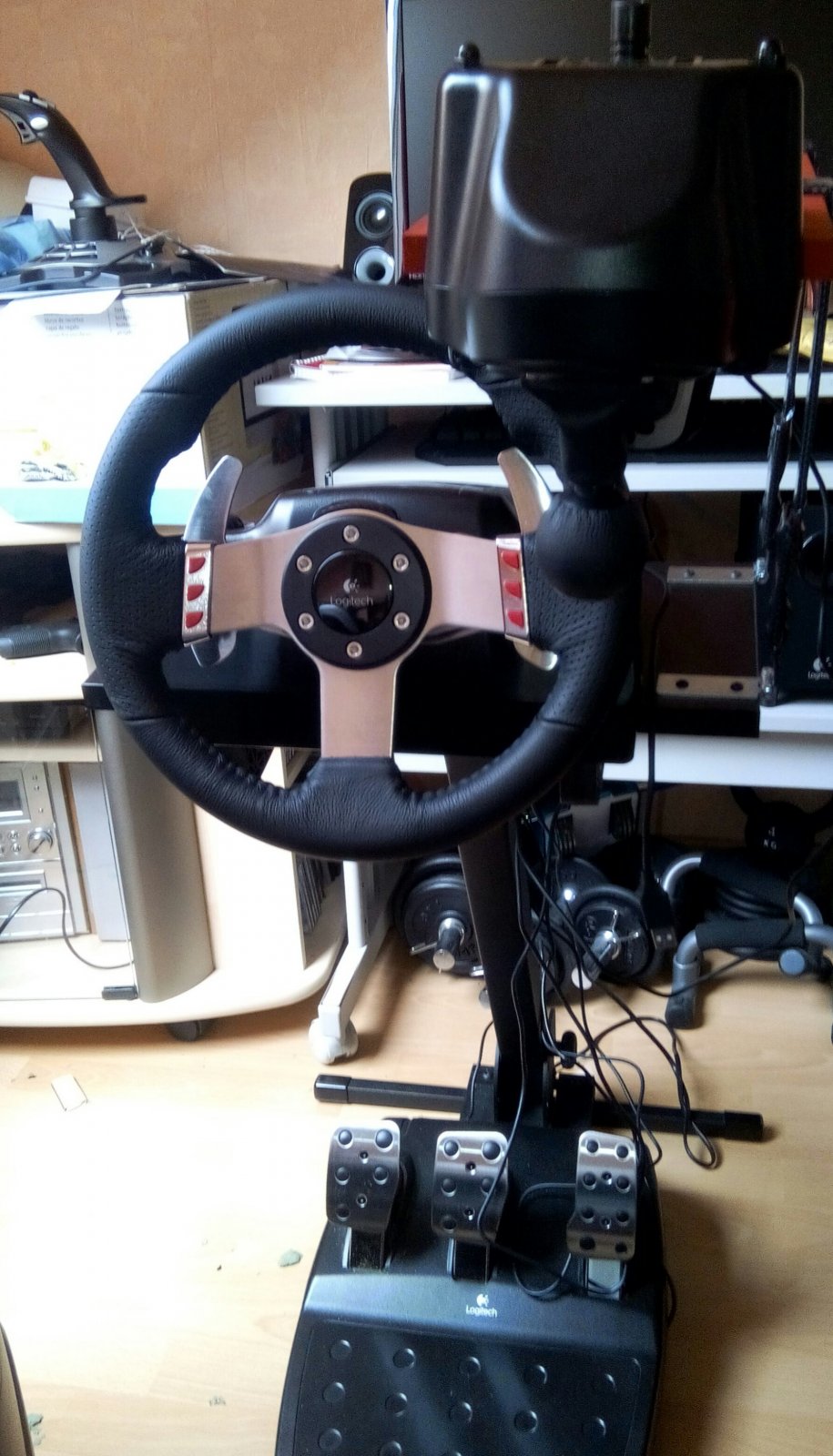

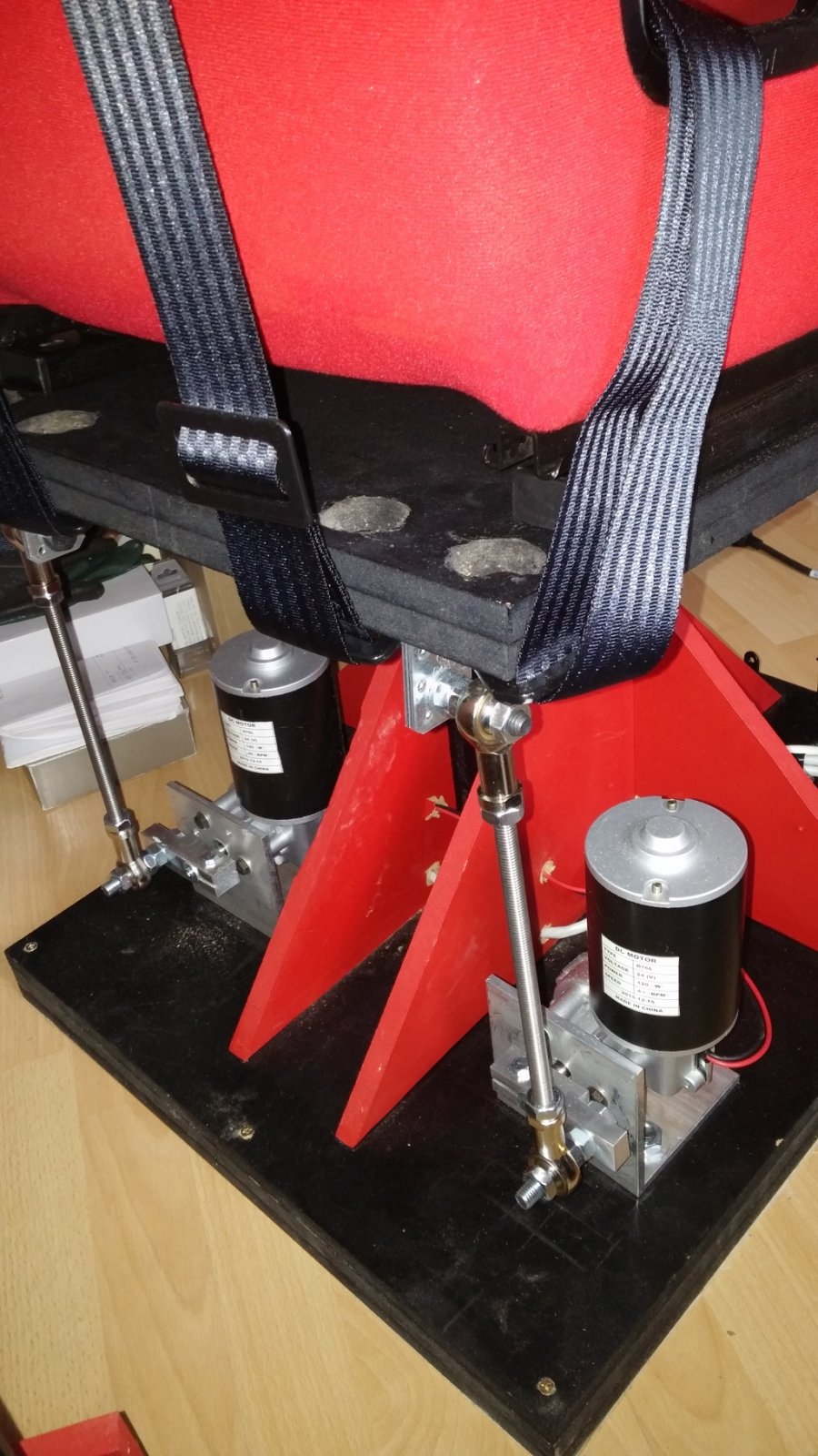

    All my simulator is based on a tutorial from the forum pcshm and consists of :
    - 2 moteurs 120W 24V (40rpm@25Nm)
    - 1 Sabertooth 2x32
    - 1 alimentation 24V 20A
    - 2 potentiomètres 10k FCP22E
    - 1 Arduino UNO R3
    - 2 roues dentées Module 1 50 dents
    - 2 roues dentées Module 1 20 dents
    I placed the cards Sabertooth and Arduino in an old pc power supply for own.
    On a support made nearly independent is a G27.
    I want to integrate it on my future aluminum support but while having only seat that moves.
    I'm learning to use SketchUp to model this support, I would come post pictures when I would have done.

  4. Leo Burton
    Leo Burton Active Member
    Jul 23, 2014
    167
    London, UK
    2,639Coins
    +131 / 1 / -2
    Is that @Wanegain's design? Another Simukit?
    It looks great! Love the colour coordination.
  5. feewel
    feewel
    Yes I left the tutorial of wanegain.
    And yes I hate red !!!
    But as I count all over again in aluminum, it'll be harder to coordinate colors.

  7. zigzag49
    zigzag49 Active Member
    May 27, 2014
    251
    725Coins
    +220 / 3 / -0
    Congratulations to you, for you forgot against the resistances that plugs has p1 and p2 of the sabertooth card she used to absorb the current returns.
  8. feewel
    feewel
    Thank you , I 'll do it tomorrow
