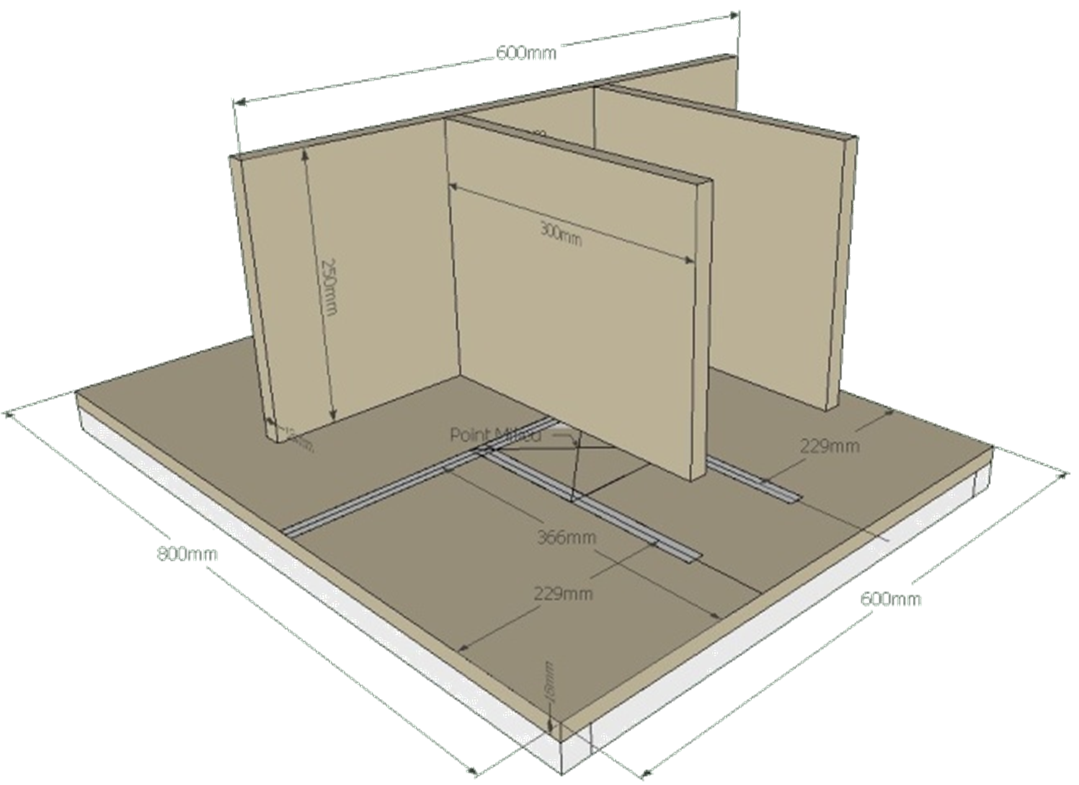

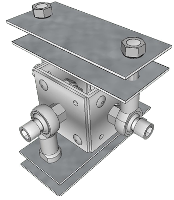

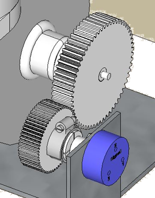

    I just would like to introduce our 2DOF simulator.
    First of all, it is not really mine but it is my cousin's simulator
    >> he made all mechanical parts and tried to connect it to his computer.
    >> as he got some problems, I tried to help him, and know we are very close to finish it.
    Here are some mechanical drawings :
    We use : 1 computer + 1 Arduino UNO + 1 Sabertooth 2x25 V2 + Simtools
    For the moment, after some problems (now resolved), our seat seems to be OK and is functionning with Simtools + Life for Speed (demo version).
    My cousin would like to use it with rFactor 2, so I need to download the apropriate plugin for Simtools.
    See you on this forum ....
    JTCC
