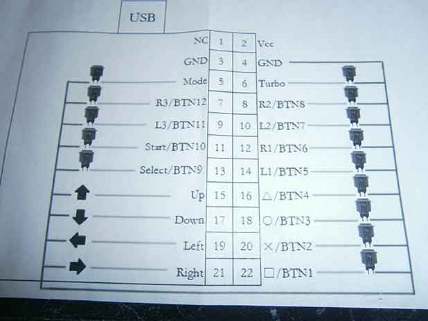

    Commandant De L'unité ONU carte encodeur J'ai deux Entre-boutons arcade joystick USB 1 joueure (cofles 48mm) versez la construction et de mon frein à main Analogique Numérique, Boite A Bouton de AINSI Qué des Nations United et Avec 10 Interrupteurs poussoir Quatre Interrupteurs marche / Arret sur l'option
    Vous Salut et merci pour l'aide mapportez Qué.
    réception J'ai ma carte usb de de frein à main et mon ma boite à bouton Verser et mais moteur.

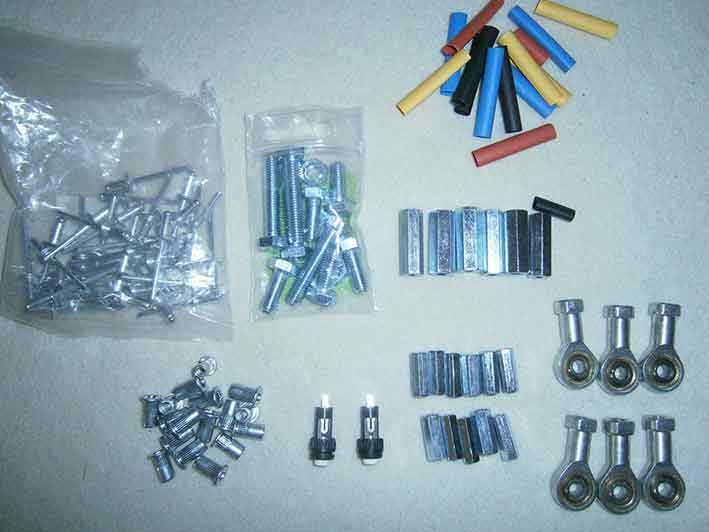

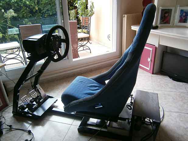

    thank you to all forum members for all their tips and knowledge sharing.
    It has been some days I walk through your forum and I must say that I loved looking at all the posts I have seen.
    So I'm motivated to make my first 2DOF dynamic simulator today.
    The materials:
    Flying FANATEC BMW M3 GT2 clubsport
    Flying F1 clubsport
    Crank-clubsport v2
    See sparco
    Brake-box and a homemade speed sequential.
    -Motor Wiper course 3
    Card-compatible Arduino UNO R3
    Card SparkFun - Monster Moto Shield - VNH2SP30
    -Two potentiometers
    LCD Keypad Shield-1602 For Arduino Duemilanove UNO Due R3 R3 Mega2560

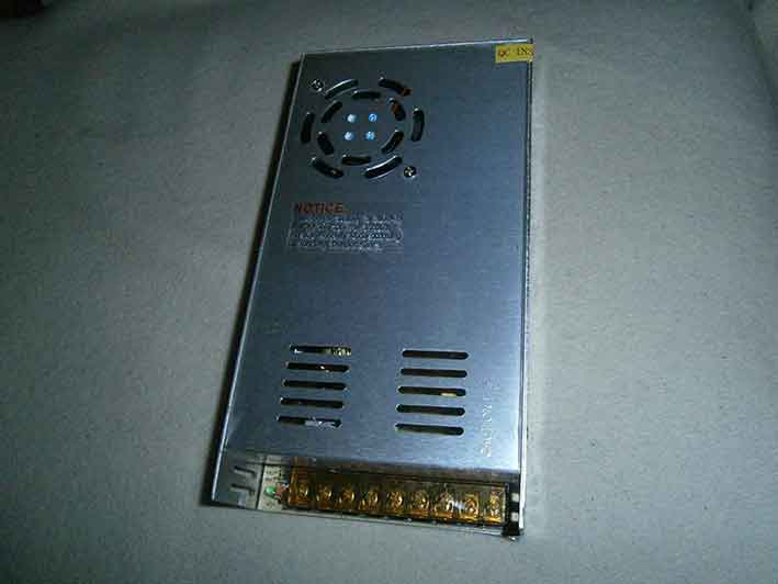

    Power Cut-AC 110-220V TO DC 12V 30A 360W

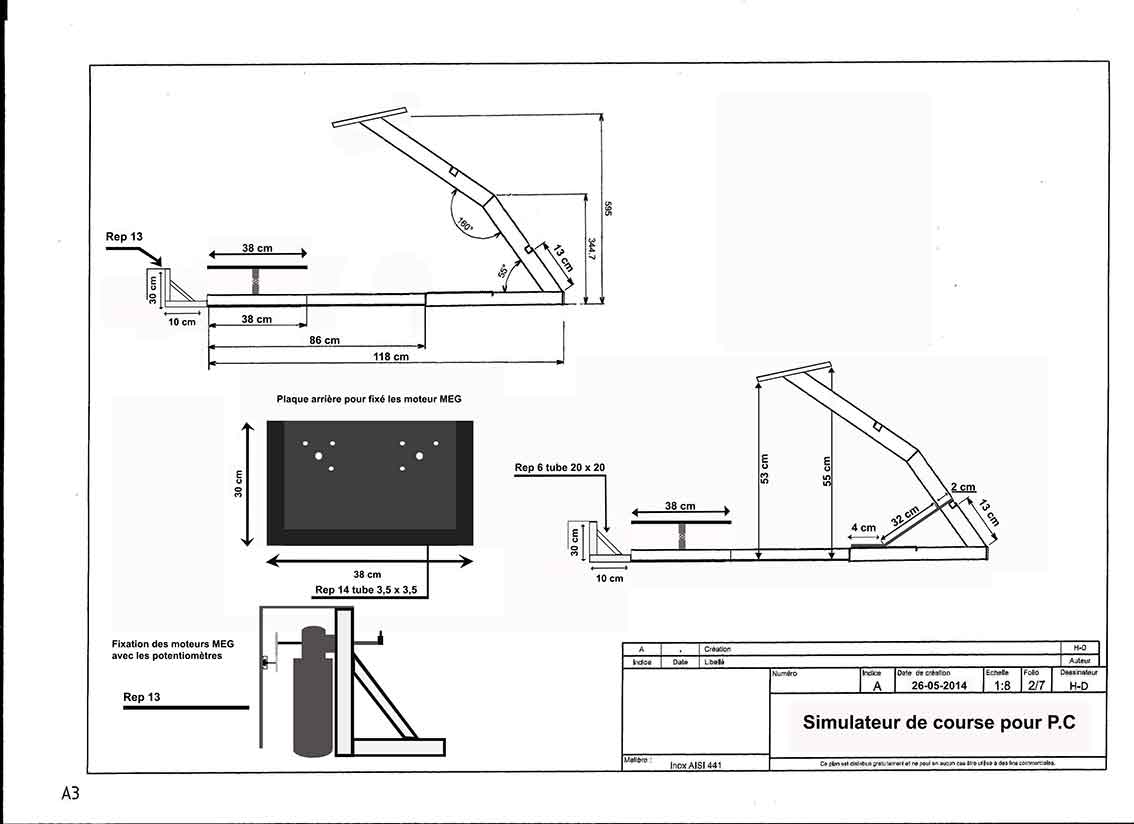

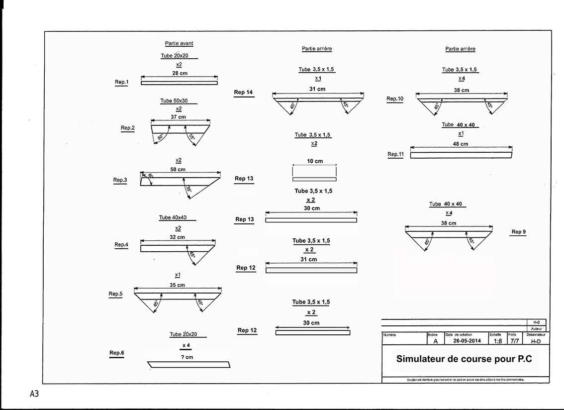

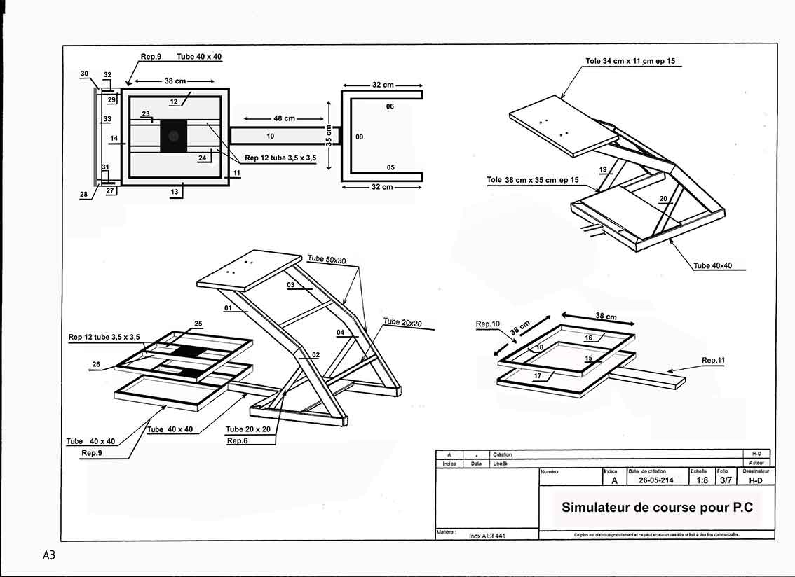

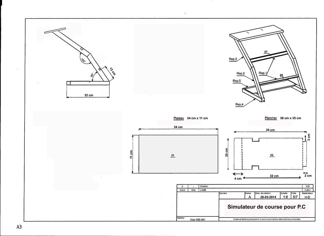

    Chassie-produced with rectangular metal tube (40x40, 40x30, 20x20, and 3,5 x1, 5.
    A carding-
    -Two wooden planks

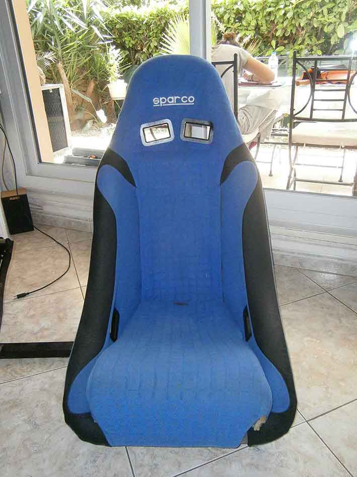

    Here is the plant which was given free by my Playseat herve who made a simulator stainless steel is beautiful thank you to luis.
    I did some mod.

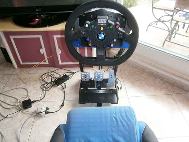

    Pictures of my gear
    I will receive my handbrake in the week http://www.leboncoin.fr/equipement_auto ...

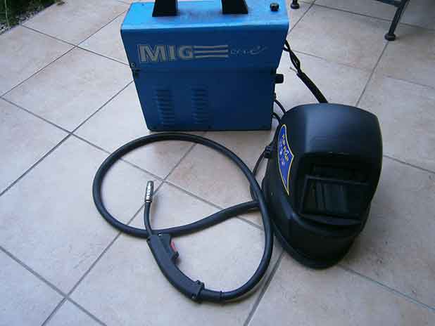

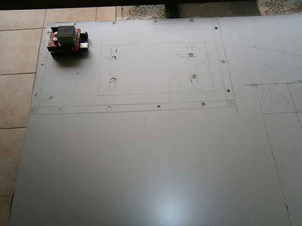

    Today: tube cutting, I Metral As the photos of the construction.

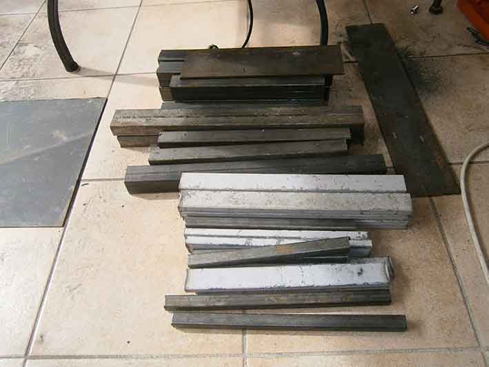

    A very early ......
    Fred

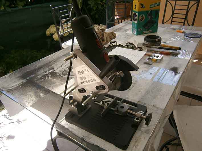

    I pass now veiled gear cutting tubes and small acquisition to secure the grinder
    I received the rest of the cool equipment

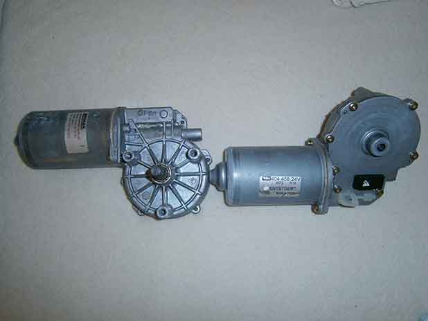

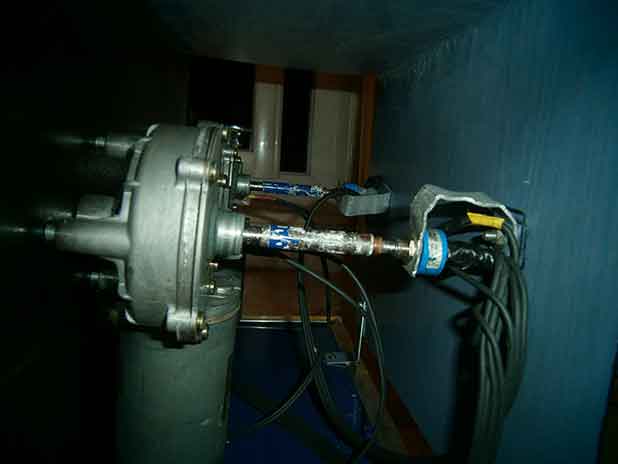

    I received my order there will me more than to order but MEG Smolka engines powered 24V 12v and I assemble the finished oufe all.
    I will after the addition

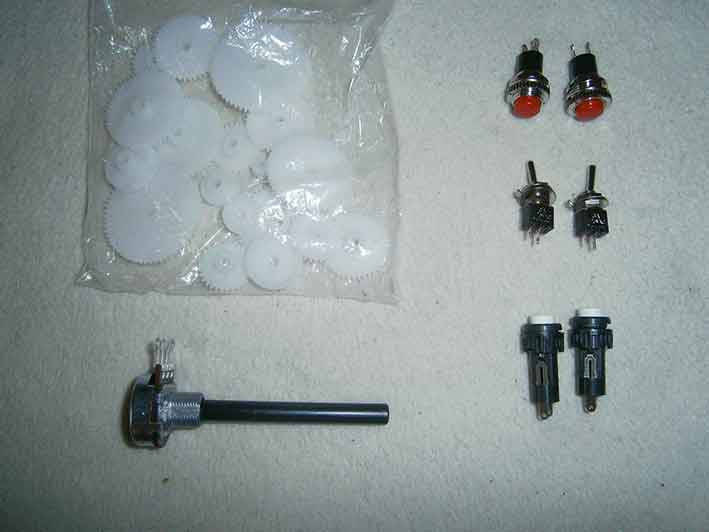

    I took these rotary potentiometer shaft Ø 6.34 mm 10 kW 1 W ± 15% linear curve Bourns 6639S-1-103

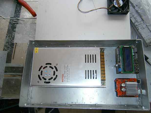

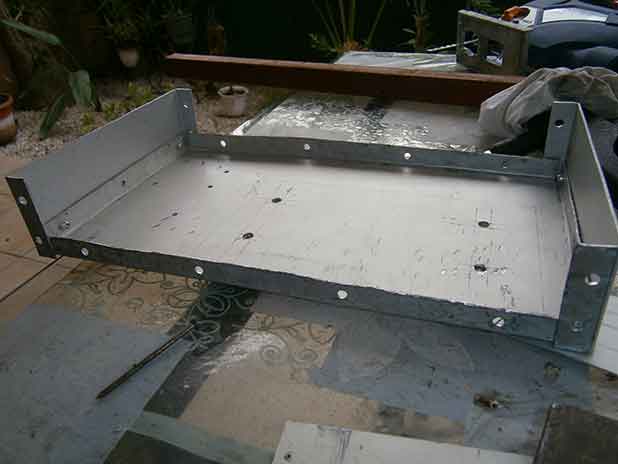

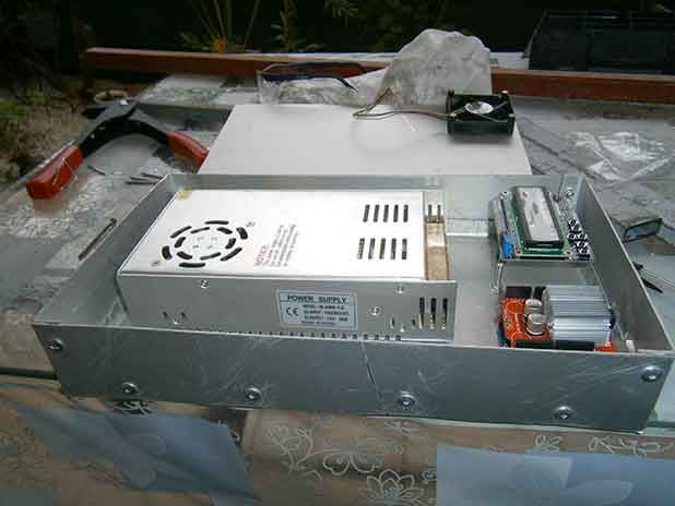

    I made a box to put the cards with food, I just elevated and protected so that nothing touches the plate

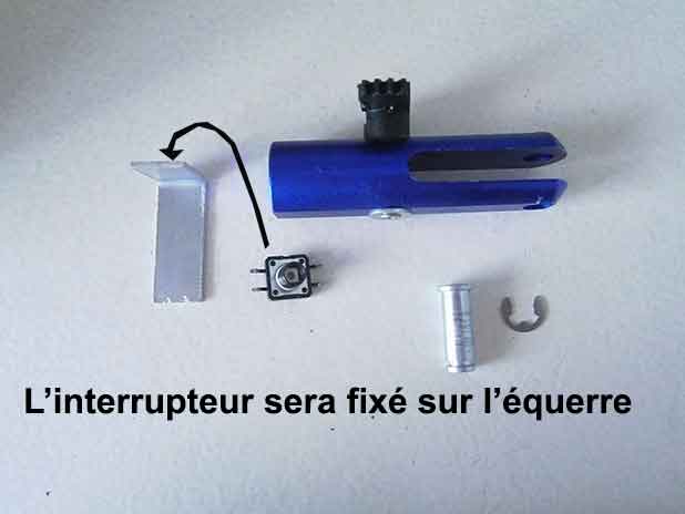

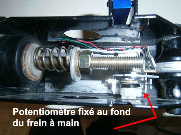

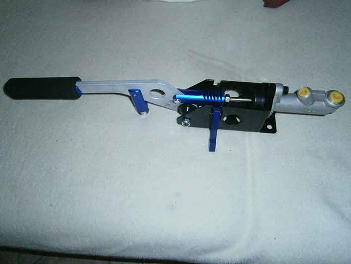

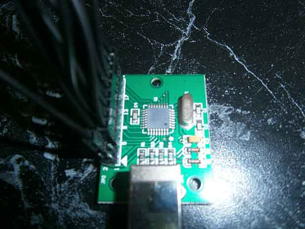

    between two I order a card encoder arcade joystick-buttons joueure USB 1 (terminals 4.8mm) for building my brake hand analog and digital, plus a box with 10 switches push button on / off and four switches on and off
    I received my card usb for my handbrake and my box and button but two engines smolka 24v.

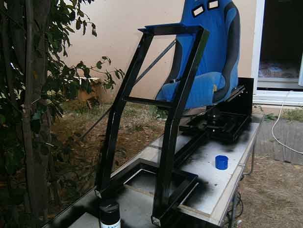

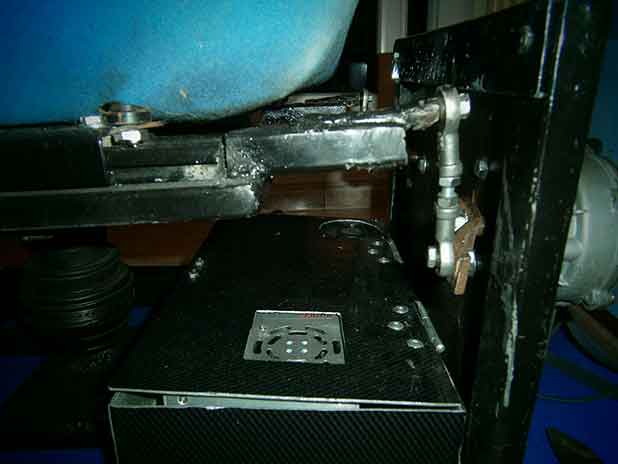

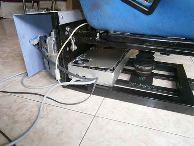

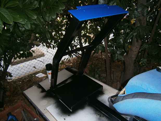

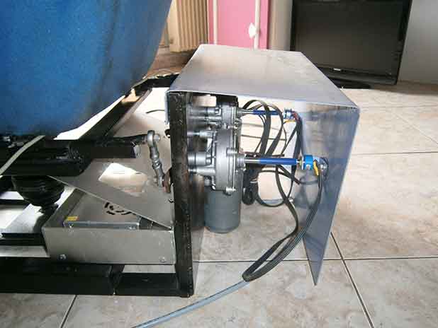

    Hi all, here I am back.
    I finished welding, painting, fixing the electronic box, potentiometers and engines.
    I still have to finish the button box, fixing the gear box, the brake and the board with four wheels in the simulator, I finally see the end of the tunnel.
    Here I come to the big headlock, I searched the forums without finding a complete tutorial on programming code already integrated in the arduino and program x-sim-sim x extractor and converter, if someone can help me with a tutorial for arduino, x-sim extractor and converter, as I wade but I completely panic if one can appres its all I can not I have programmed the balls. bad.gif
    But of course there'll be a kind soul as always on this forum who'll come to my aid thank you to you.

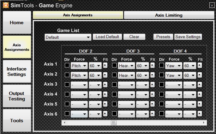

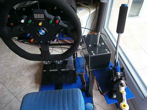

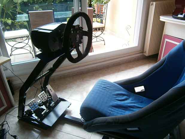

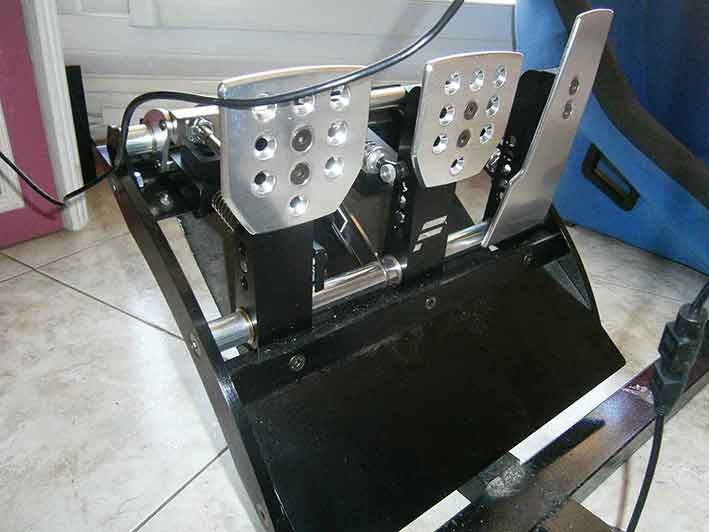

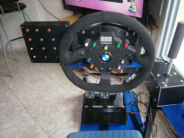

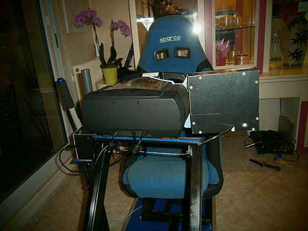

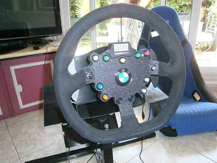

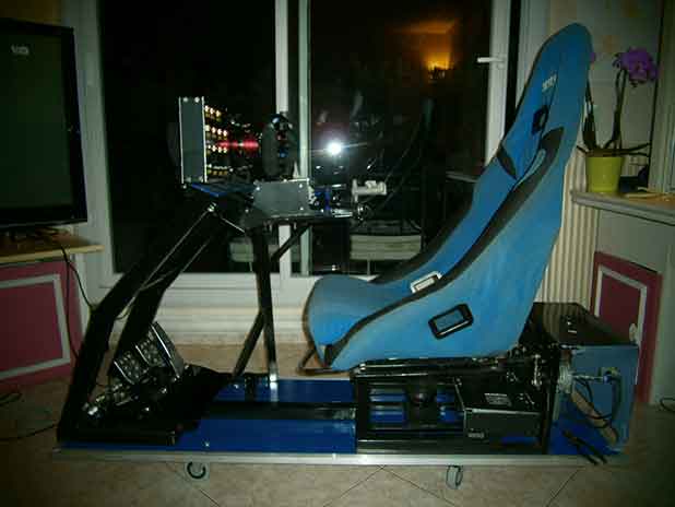

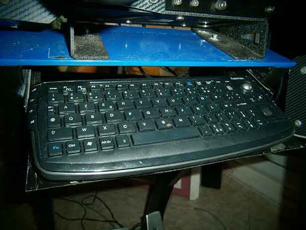

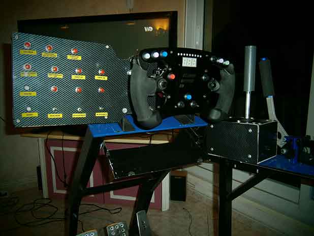

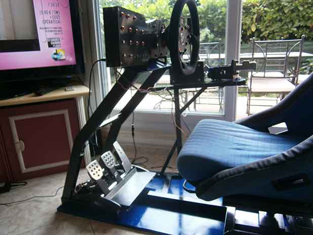

    Salut, je suis de retour, bientôt la Rentre sur va Pouvoir se remettre sur nos Simulateurs Frais et Bien le bonjour à tous.

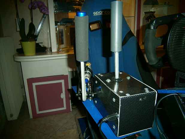

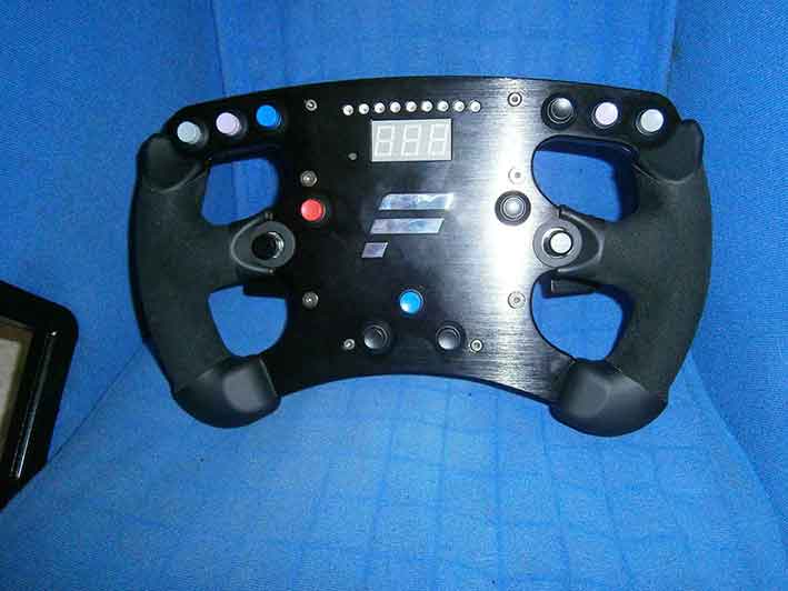

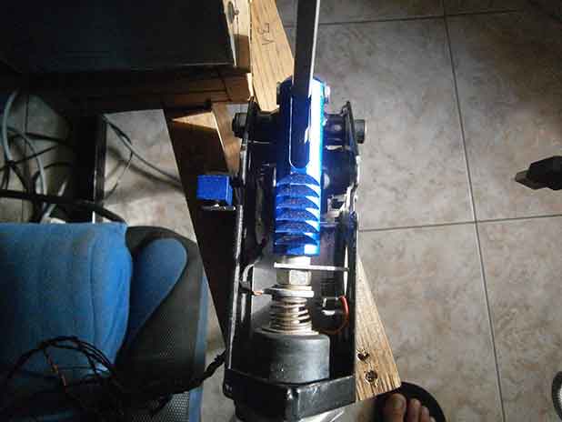

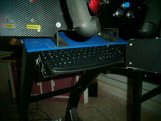

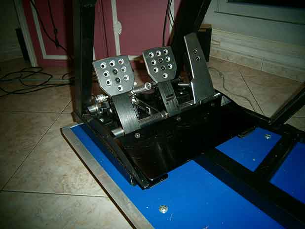

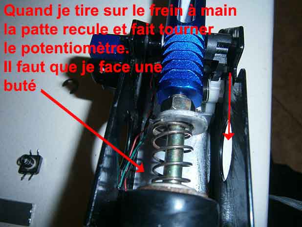

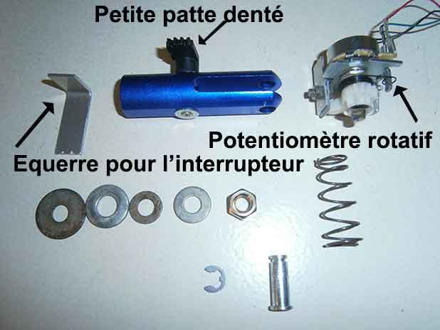

    ENFIN, voila le simulateur HNE pratiquement fini, les fils Électriques du volant et du simulateur SONT encastrés Dans Une goulotte petite, Le Temps des tubes en fer, le soutenir Verser le clavier souris est rabatable, les roulettes sous la
    planche SONT Maintenant installées, PUIS Le boitier électronique en carbone (adessif), la boite à bouton, la boite a vitesse séquentielle en carbone (annonce), le frein à main Analogique et numérique contrôlable Avec Deux INTERRUPTEURS; Soit Verser l'Analogique Soit le numérique Verser les différents jeux.

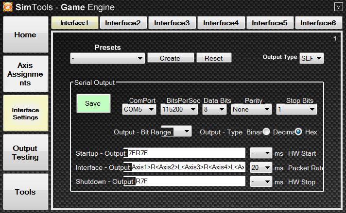

    J'AI pratiquement fini les reglages avec simtools.
    Maïs J'AI enormement du mal Ë Regler Moteur de jeu de Dans, Les Effets (soulèvement, lacet, domination, Poussée) ET lorsque je joue, je ressens La Droite, La Gauche, l'avant et l'arriere, Sens ne MAIS JE rien; Ni le Freinage, ni l'accélération, Ni Les patrons, Ni Les sauts. ENFIN Rien de CES Effets.
    Si vous Avez juin idée ous des tutos sur simtools en français, je suis preneur, je plafonne La voiture PEU non. Merci à Vous.
    Et of course à Vous Tous de bonne .........: ok:

    Il ya Quelqu'un qui-peut m'aidé verser les reglage de simtools verser le Freinage accélération les patrons les sauts et le ressenti de la voie merci
