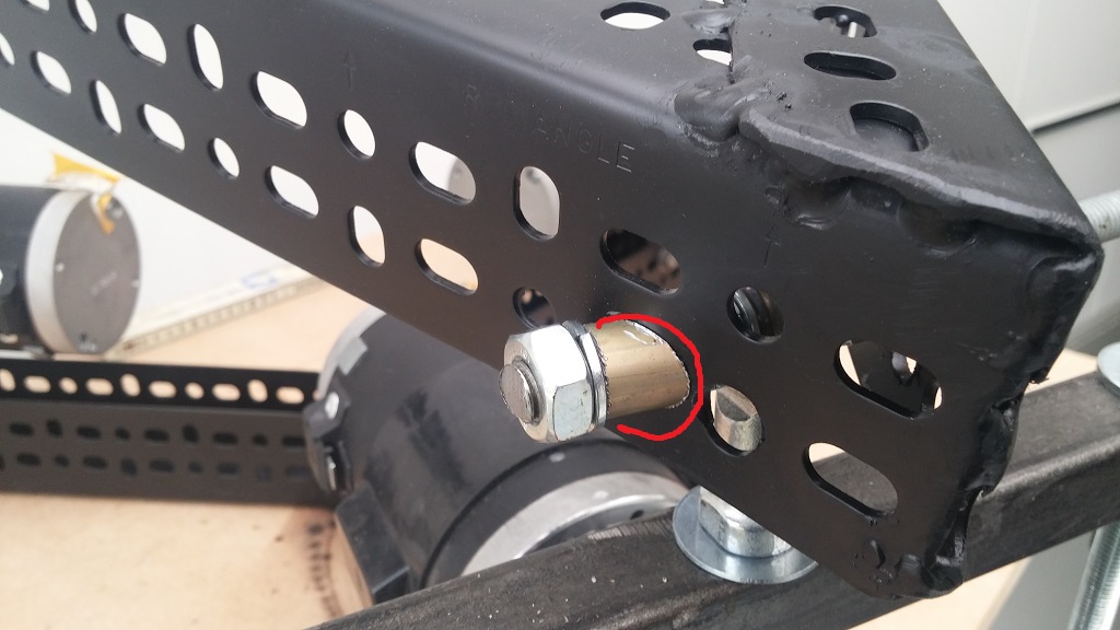

  12. Nick Moxley
    17,056Coins
    +2,506 / 30 / -2
    Interesting build but, I would very much be concerned about the attachment points to the Frame itself. Those Rails and how thin they really are will start to "oval" out the holes in the frame over time, I would either tack those in place, or rethink the way you've attached them. I foresee that being a failure point. Also whats preventing them from sliding left or right ? just the friction of the joint ?
    Picture is worth a 1000 words.
  13. willaupuis
    willaupuis Member
    Jan 27, 2015
    76
    1,864Coins
    +118 / 0 / -0
    3DOF, DC motor, Arduino, 4DOF
    les rotules sont emprisonnées par deux écrous et des rondelles
    donc c'est eux qui font l'articulation,,
    et les tube coupé en angle servent de rondelle et serrent de chaque coté pour empécher un mouvement gauche droite du plateau supérieur
    the balls are trapped by two nuts and washers
    So it is they who are the joint,,
    and the tube cut angle used washer and tighten each side to prevent a right left movement of the upper plate
  14. Nick Moxley
    17,056Coins
    +2,506 / 30 / -2
    Ah ok, i see it now. Those Bushings are actual washers that have been cut on the angle. Im following you now, That should be ok then. Sucks they have to be a little un even due to overlapping the Frame rails. but Either way, my concern's have been alleviated.
