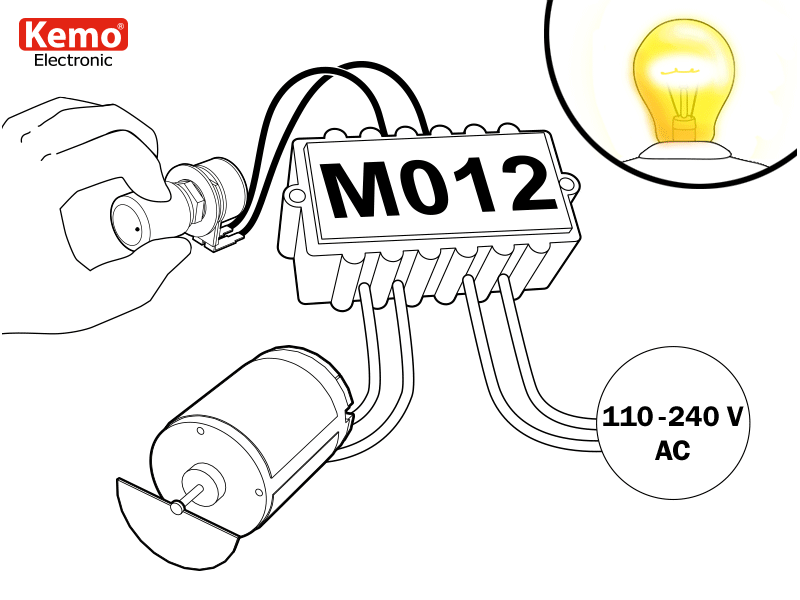

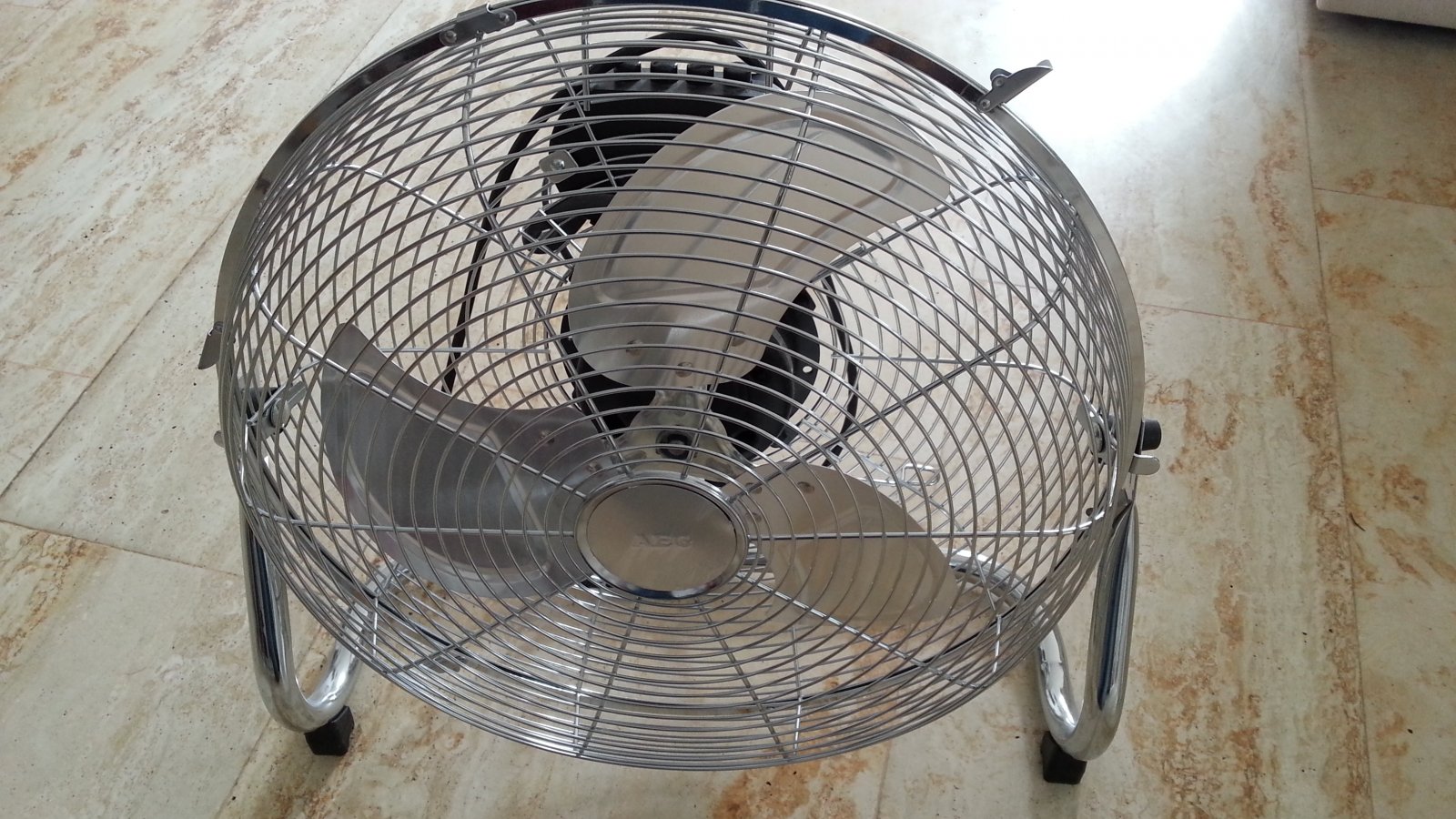

    I would like to use a 220V fan (100W AEG motor, detailed specs are not yet available) for simulating wind and as far as I know there is no such DIY project out here? If there is no solution I can replace the motor (to 24V) but I would like to stay with 220V if possible (because of too much work...).
    Any helpful links and other useful information are much appreciated.

    Hey guys, such a great help in such a short time, thank you all and there is more than only one solution, finally I have all what I need. IMO the solution of @RacingMat is the easiest one because it is also possible to control the dimmer module M012 using control voltages between 1 - 5 V which makes it compatible to the Ard. PERFECT!

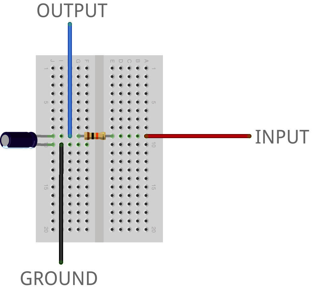

    An arduino with a low-pass filter on the PMW output should control it.

    Like this one? Low-pass RC filter using a 10kΩ resistor and 2.2uF capacitor.

    Those component values should work fine for fan control. If you were going to use a low-pass filter to drive a rig though you would want to use a much smaller capacitor.

    Agree mate, that's how it will be :)
