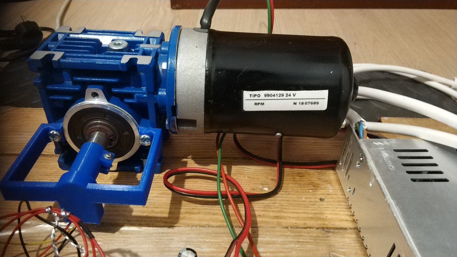

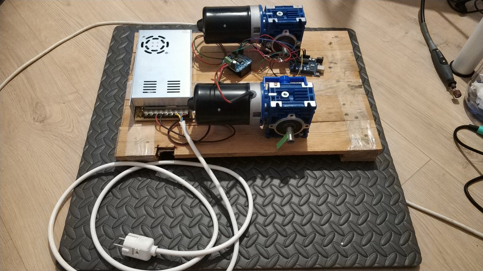

    Good evening, after a long time wishing for it, I have decided to build my own driving simulator.
    I could settle for a 2 DOF, but the truth is I want it to have loss of traction. and I'm going to get it !!!
    At the moment I have placed two motors on a homemade bench to check that the electronics work. I have connected 1 and it works !!!.
    Then I put some pictures of what I have as a project.
    The Motors (those in the photo, missing 1) are 24 V and have a reducer attached, I hope they can move with agility.
    I'm going to put some IBT-2 H bridges and all of this will be moved by an Arduino UNO.

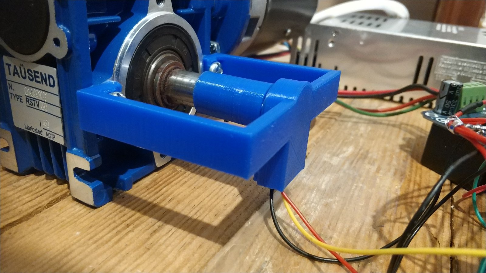

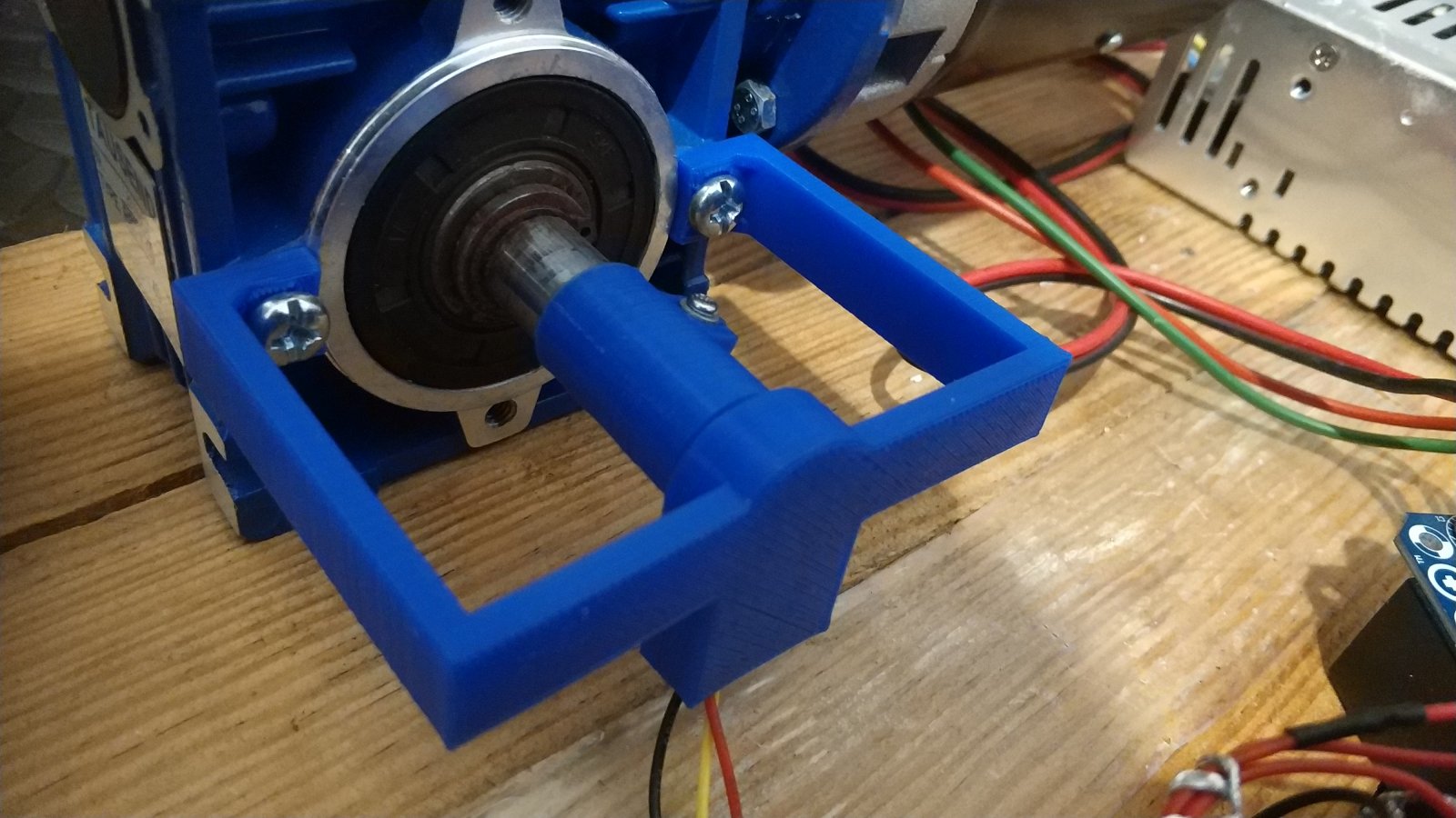

    The potentiometers of the motors are 100K and I have made them with the 3d printer some supports so that they are firmly attached to the reducer and do not move.
    As I progress I will comment on it and upload photos.
    Thanks for this wonderful forum.

    In the previous post I was wrong, I was referring to the 10K potentiometer.
    Next week I will design part of the structure in aluminum profiles.
    I have also noticed that the motors I have are small for the purpose I need (60W each motor).
    on the other hand, I have decided to use good materials for the simulator.
    Do you know if I can use industrial 10k potentiometers?
    I am afraid that the ones I use, which are cheap, will break with little use.
    PS I have arduino UNO and IBT-2 mounted.
    Thank you
    20,551
    145,124Coins
    +10,778 / 52 / -2
    If you plan on changing the pots I would suggest going for Hall Sensors, as they are a drop in replacement, have great resolution and life span, plus won't break if over rotated.
  4. Capitanbrown
    Capitanbrown New Member
    Jun 22, 2018
    España
    88Coins
    I have been reading about it and there are those that act on different degrees of rotation, right?
    I had thought of a 180º
    for a driving simulator it seems enough right?
    THANK YOU SO MUCH
    20,551
    145,124Coins
    +10,778 / 52 / -2
    Technically you could get away with 90 degree Hall Sensors, but it is cutting it a bit fine, so I consider 180 degrees is the way to go, as it gives a bit of headroom, something with these sort of specifications: https://au.element14.com/bi-technol...fs/sensor-hall-0-2v-20v-to-10v-pin/dp/2319662
