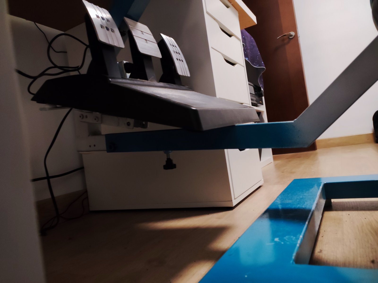

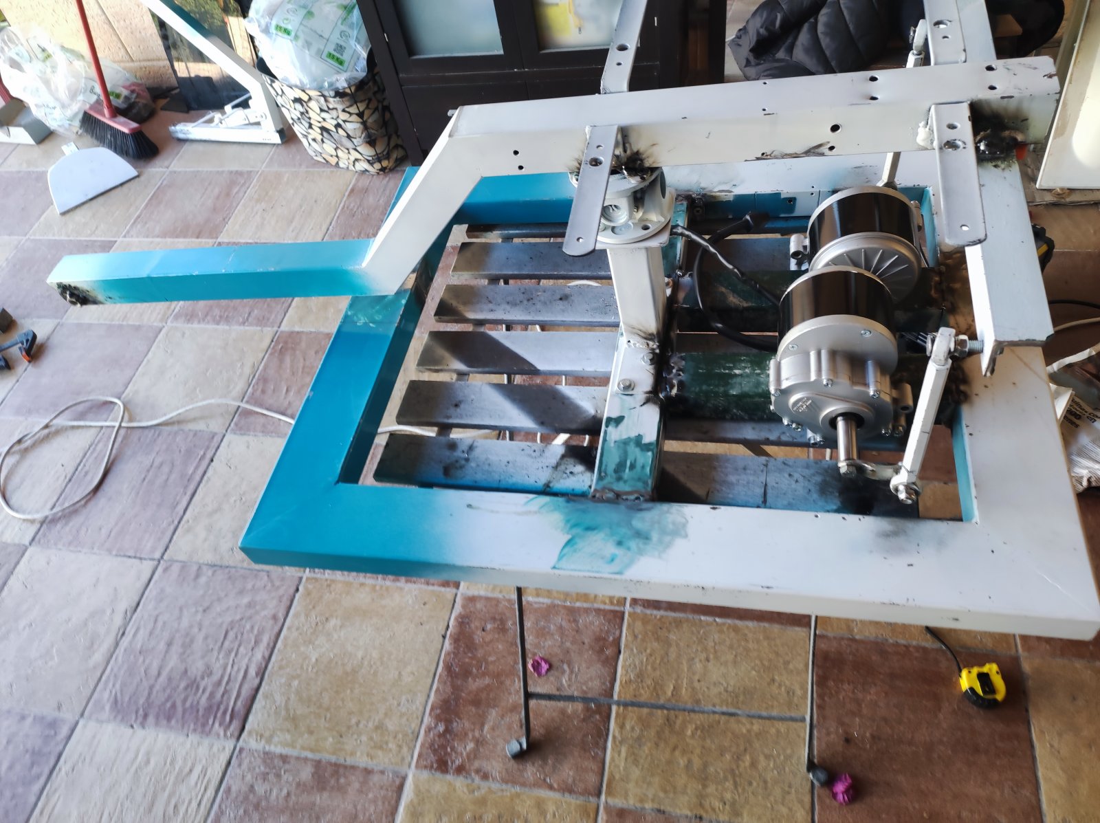

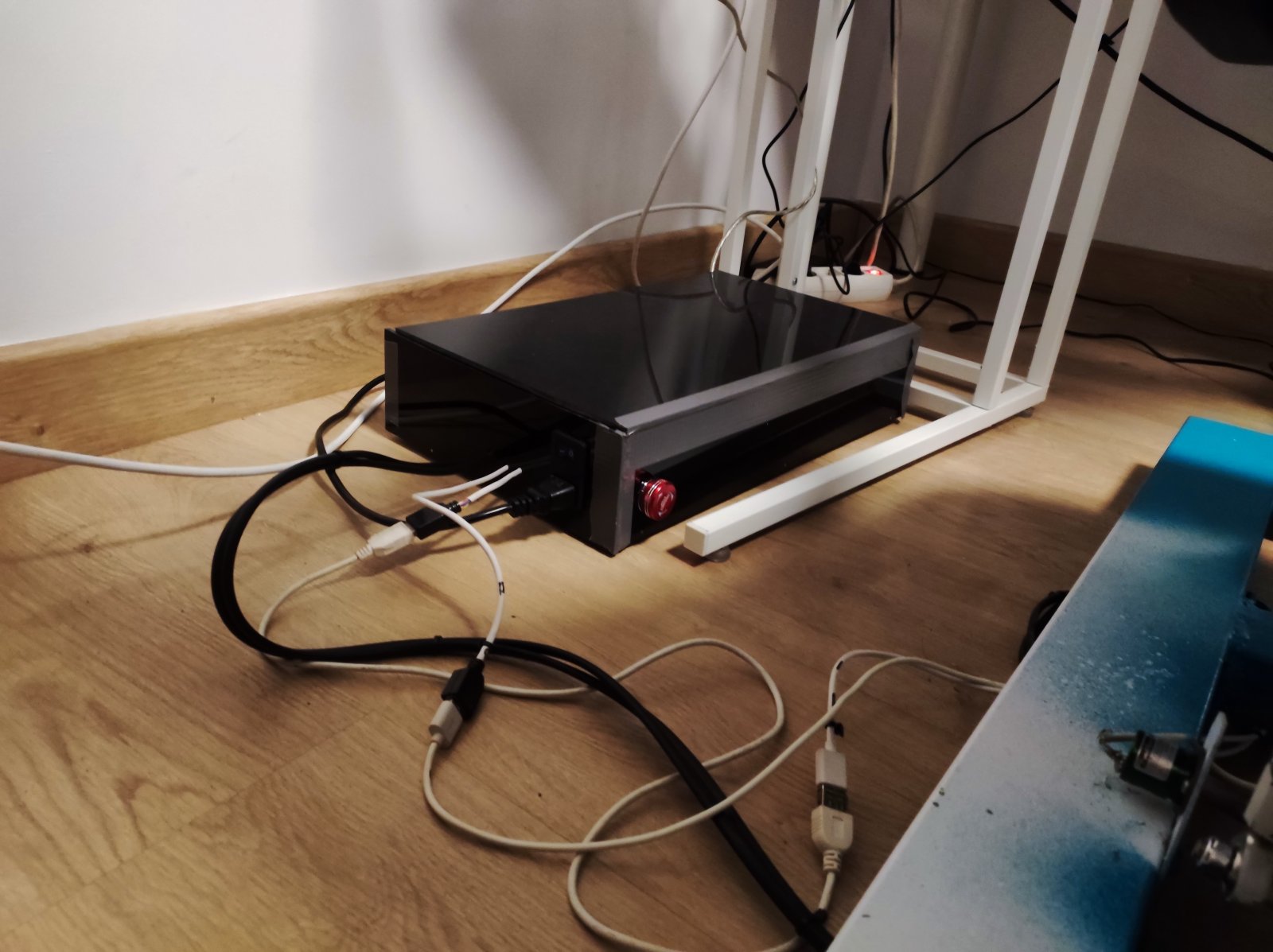

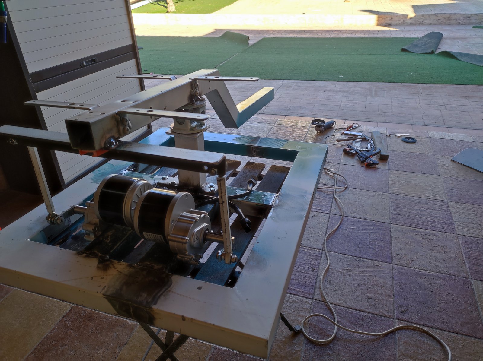

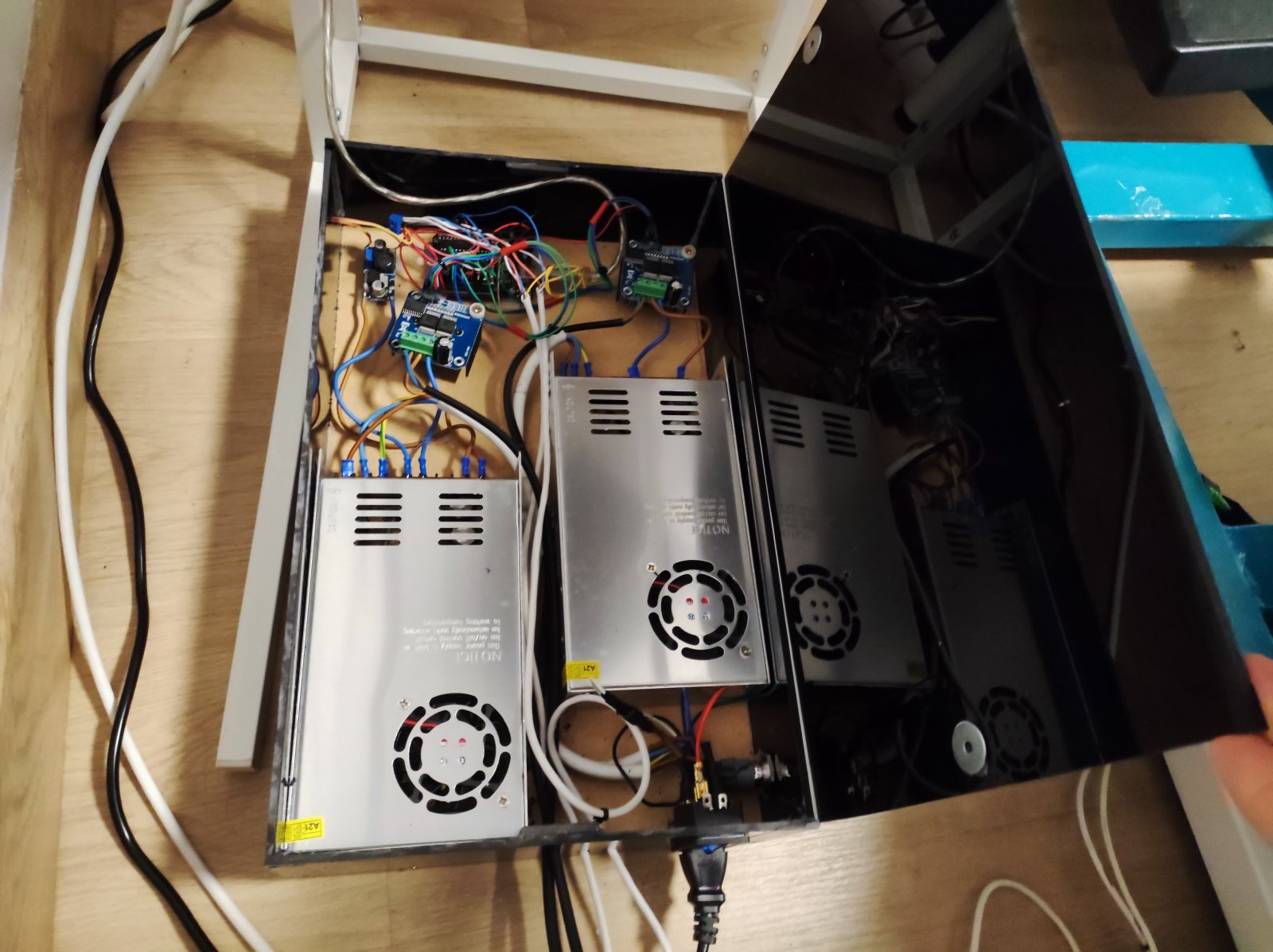

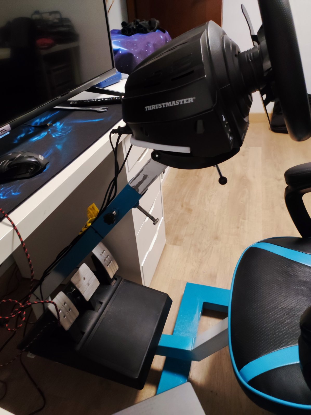

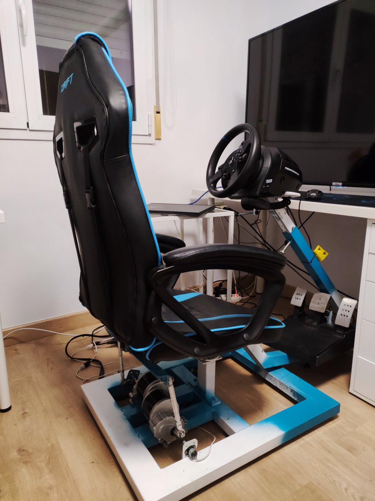

    This simulator has been built from the SCK Gaming tutorial, although I have not been able to make a tutorial, but here I leave all the photos that I can contribute, although some details and adjustments are still missing. I hope it will be very useful for those who want to start the project.
    Greetings.

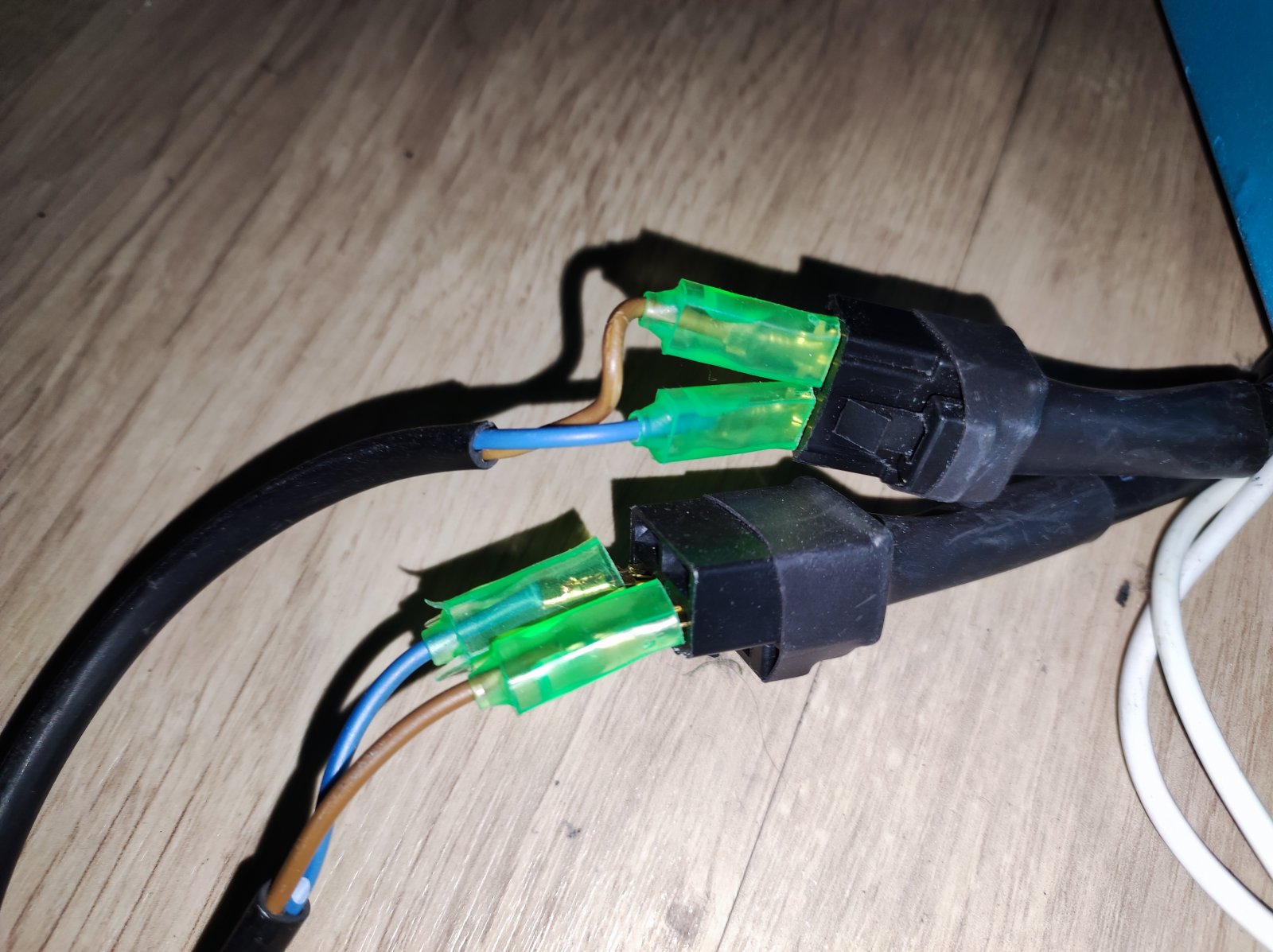

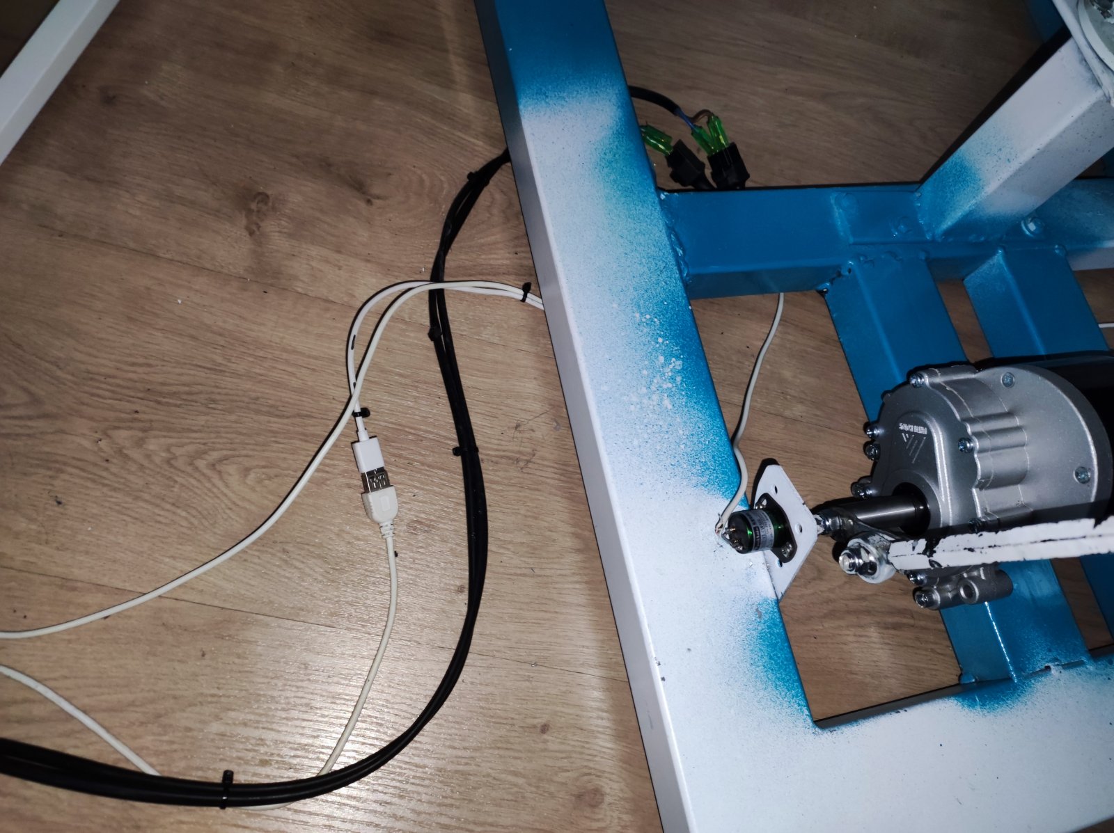

    Hi, I will use the SCK Gaming tutorial for my build of the 2 DOF + traction loss and in future surge system. I have the question about your connecter cables for the motors. What kind of connector do you use, because i want to build controllbox wit the Arduino and the motor controller and power supply and have a portable simulator rig because of the WAF ;)

    Hello, the connector of the motors came with the motors themselves and I put a male faston terminals, with a 1.5mm cable section that I recycled from an old vacuum cleaner, that for the power part and for the signal part, which would be the potentiometers, I used a usb cable from some smatphone chargers that I no longer used. I hope I have helped you, even .
    Greetings.

    Anyway those connectors are provisional, I want to change them for others that have a more secure connection, because as I said before it lacks some of the sizes still to be improved.
