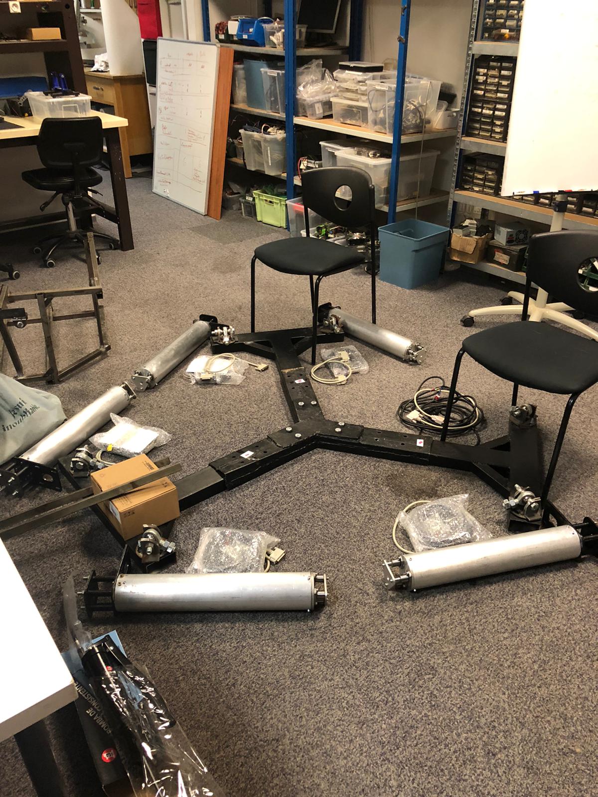

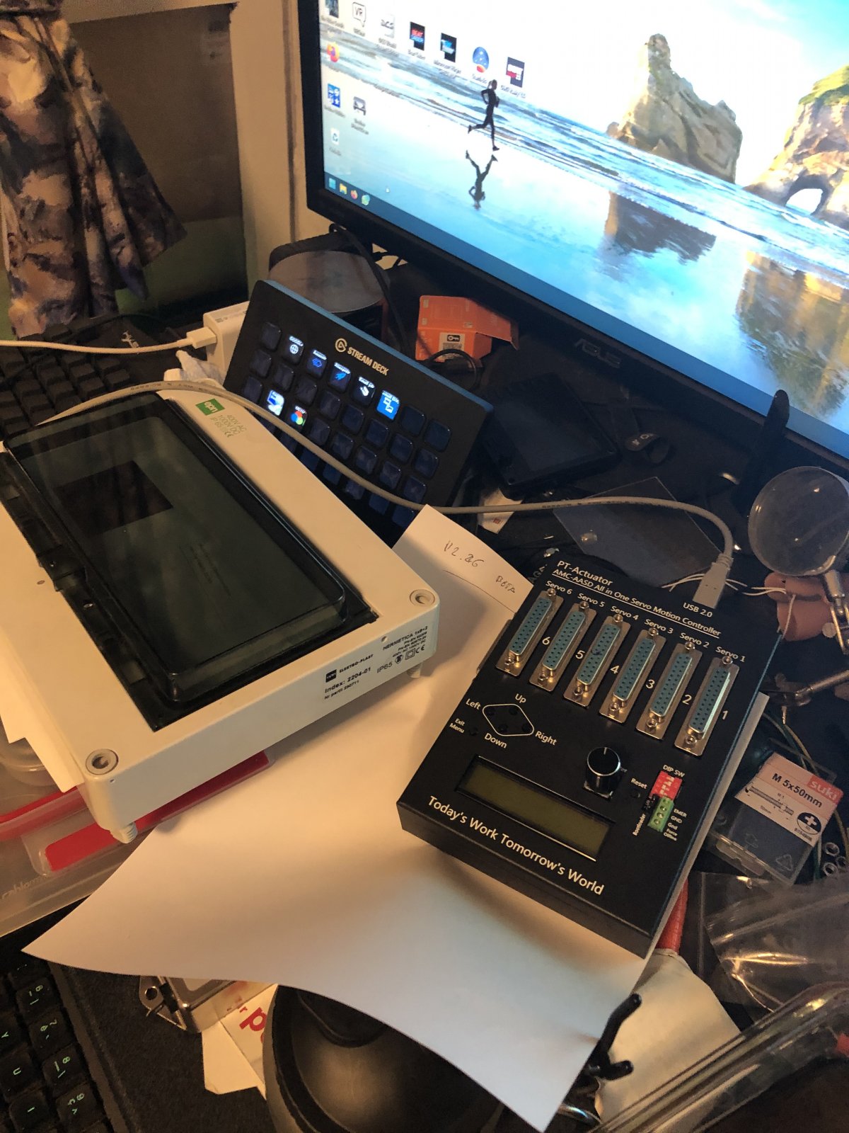

    Hello
    After a long thinking i start to build my 6DOF simu.
    It ll be a usual frame with 6 aasd15 servo drivers and thanos controller.
    I build this sim in one Fablab, LabSud of Montpellier city ( south of France ).
    At the begining, i started with 3D printers but now i change for alluminium.

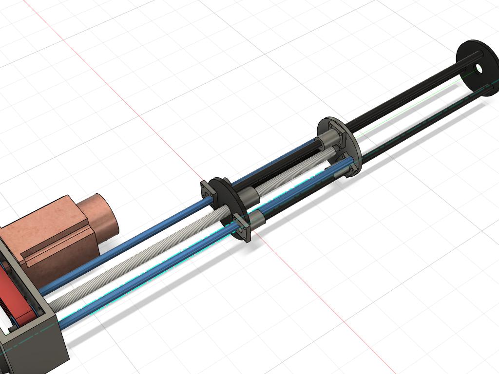

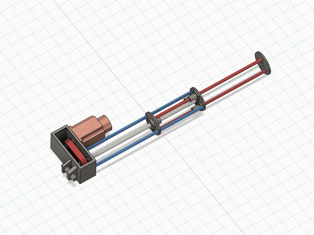

    i ll follow Peacmaker ideas ;) for mine excpet i must to dismount/mount esasyly becaus it s in the middle of my dinning room. VerinElectrique v16.jpg
    i start to build this idea

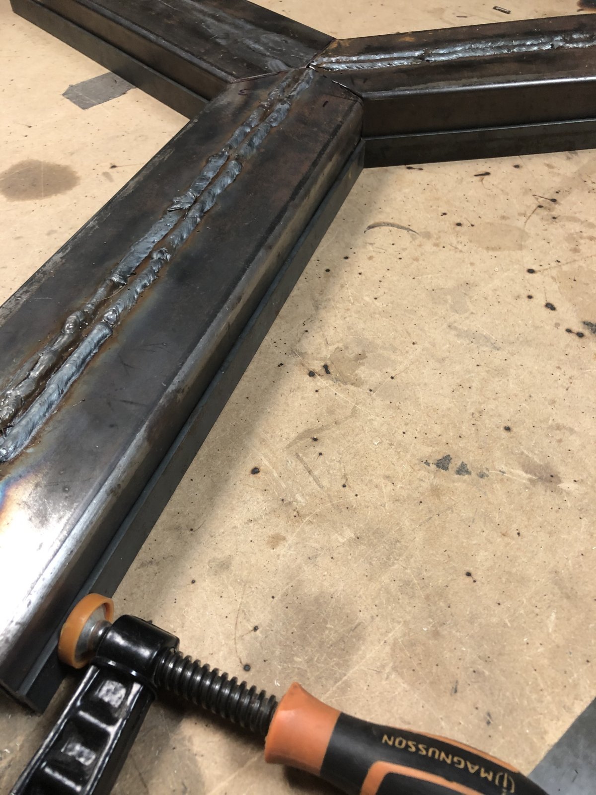

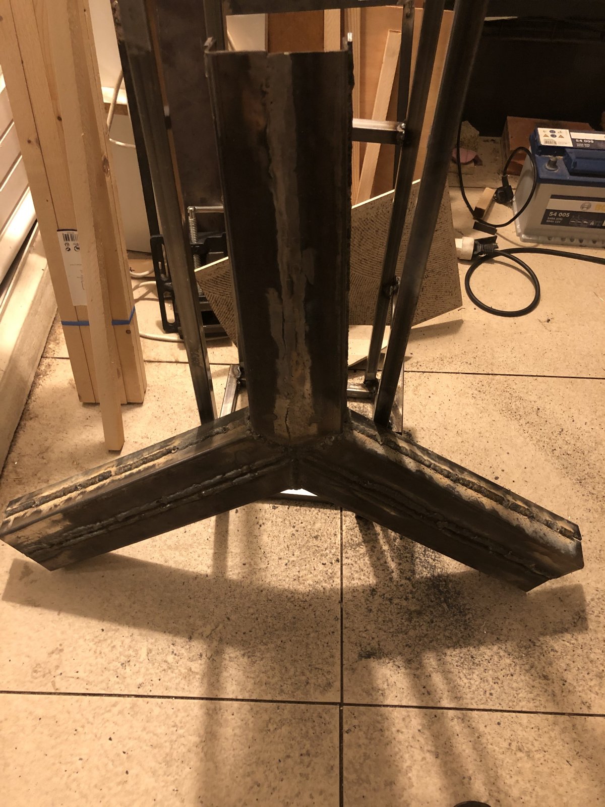

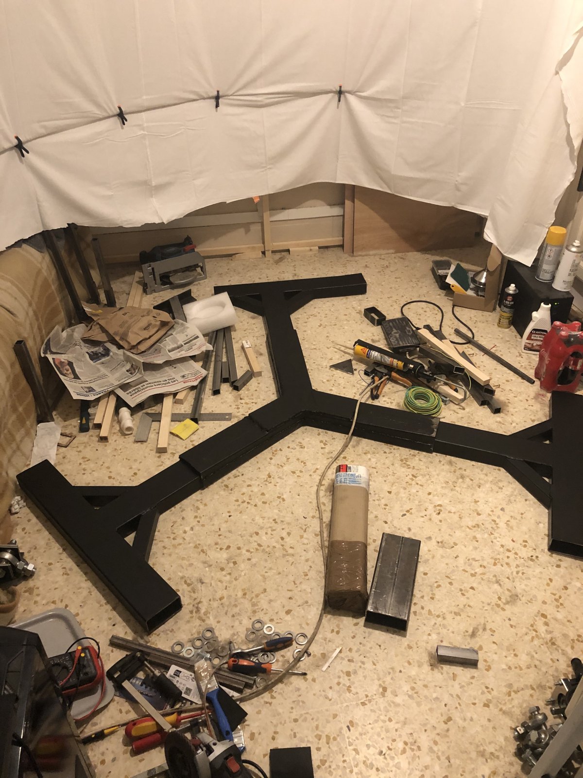

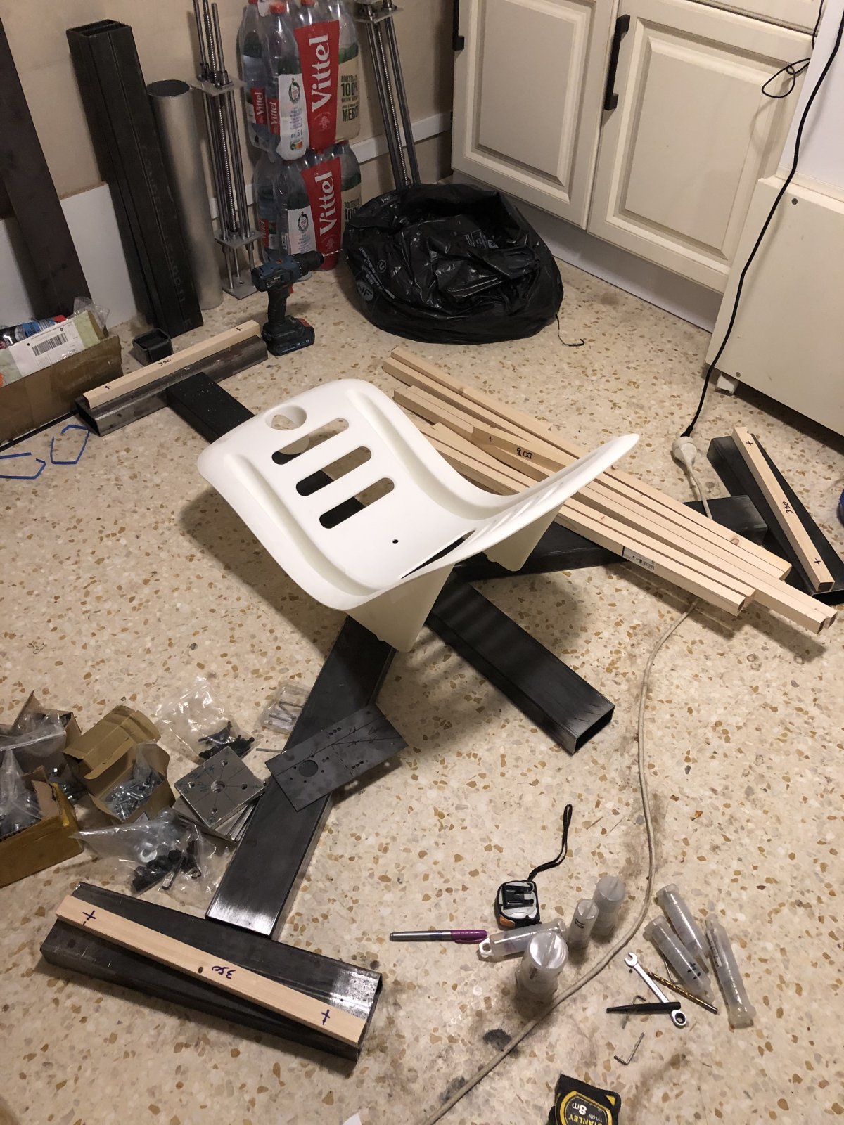

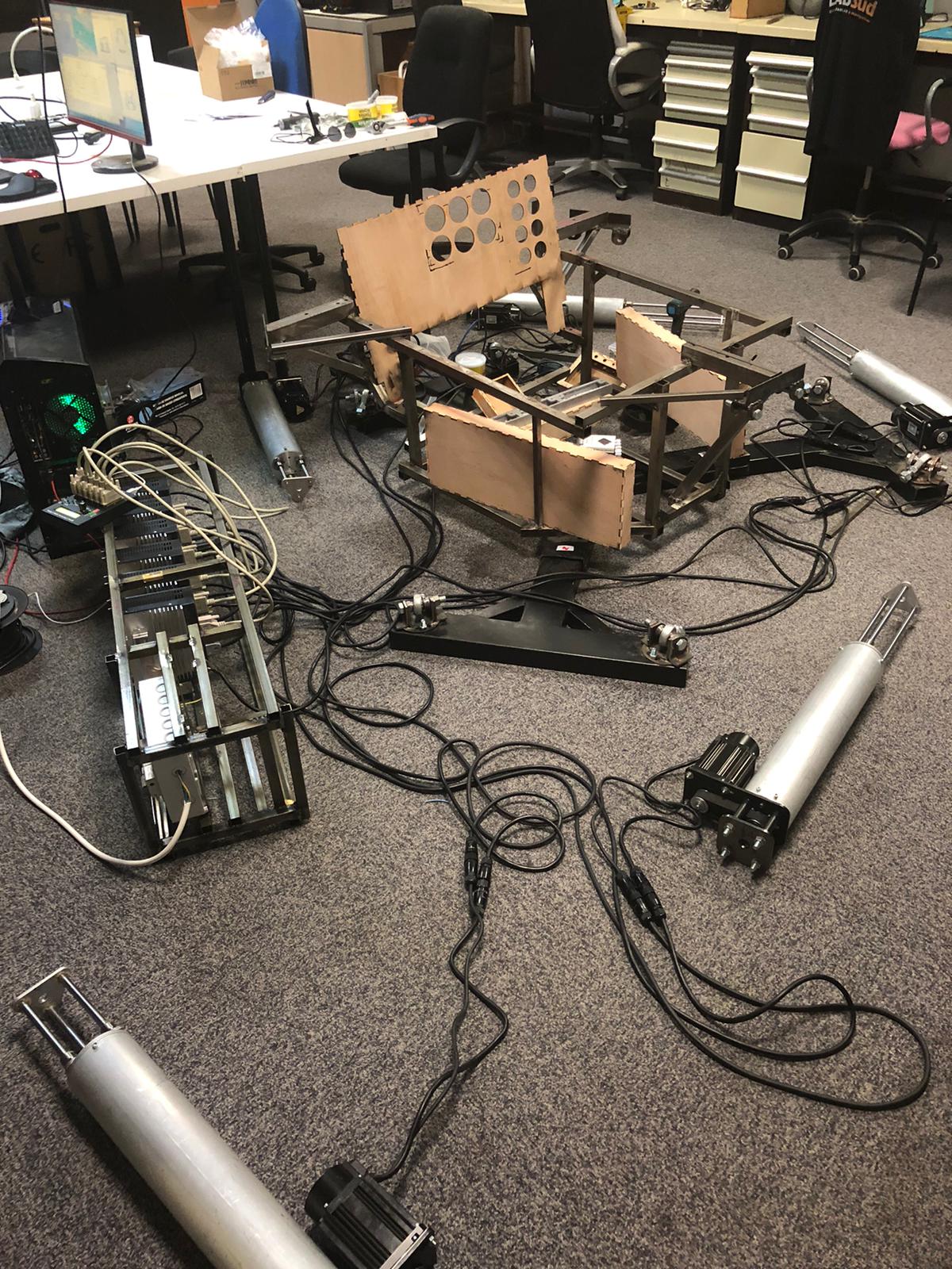

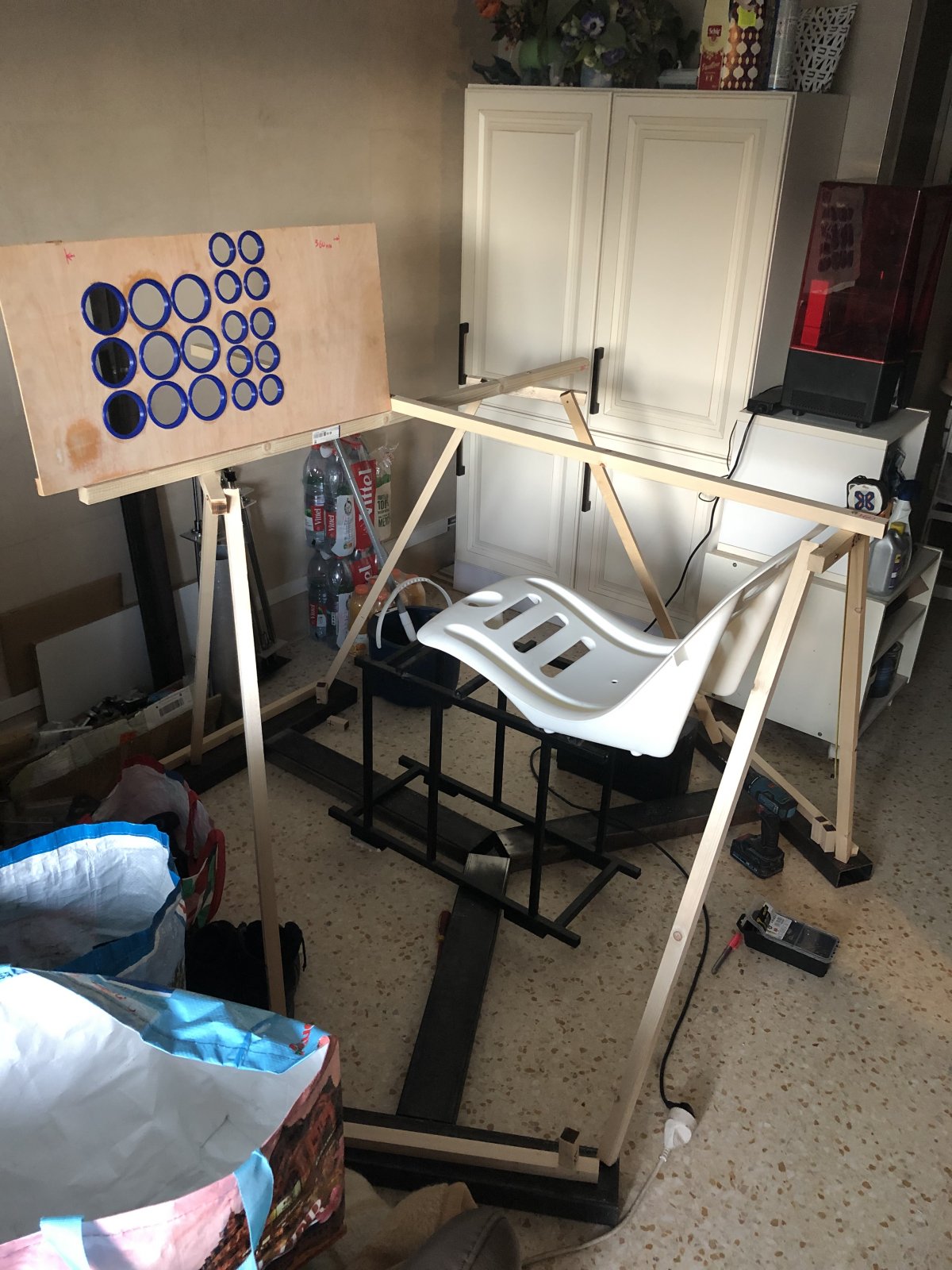

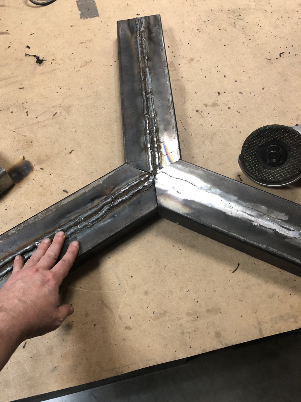

    I start in wood
    The place ll look like this
    I start with the frame on the ground
  3. GRAP
    GRAP Member
    Nov 4, 2023
    32
    Dog handler, Maitre chien
    Montpellier
    214Coins
    +36 / 0 / -0
    Need to clean and paint but first part is finish. i ll use bolts IMG_7124.JPG IMG_7126.JPG to dismount / fix all.

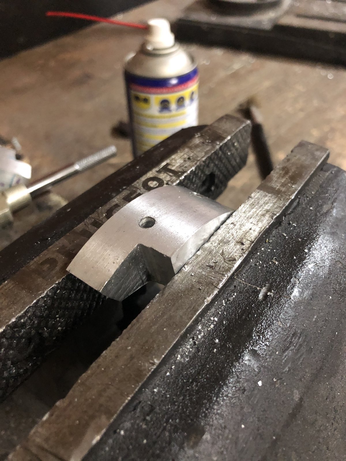

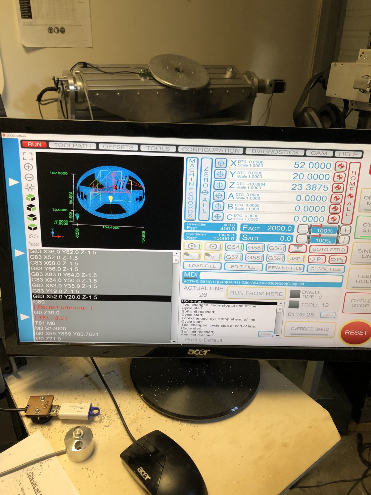

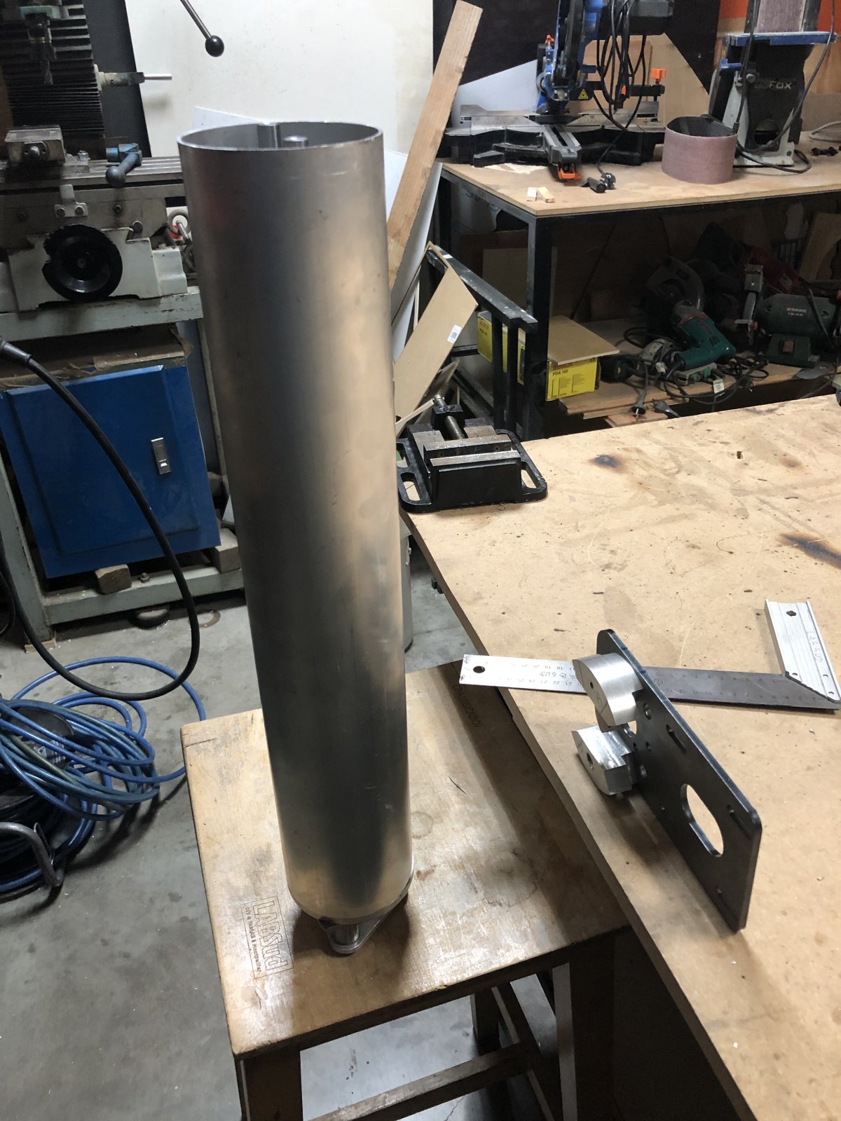

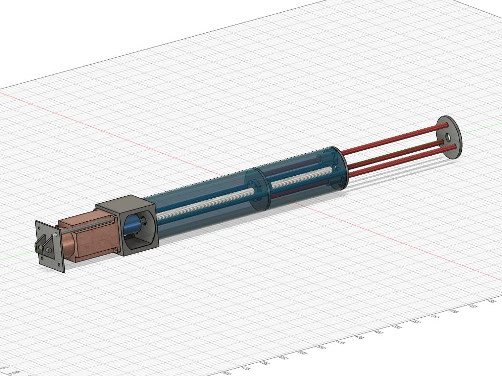

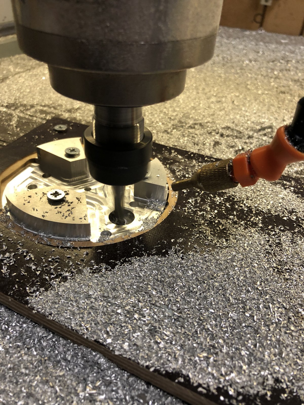

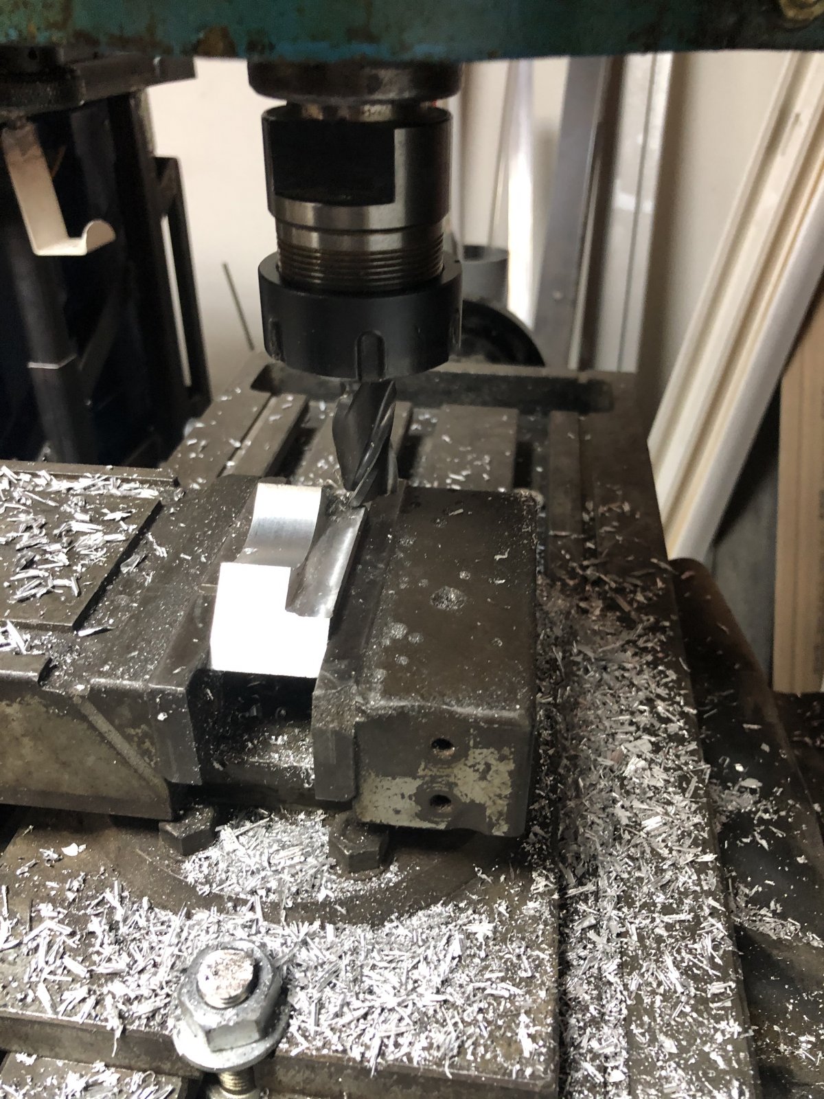

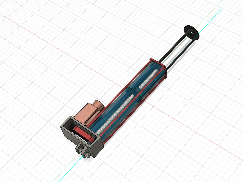

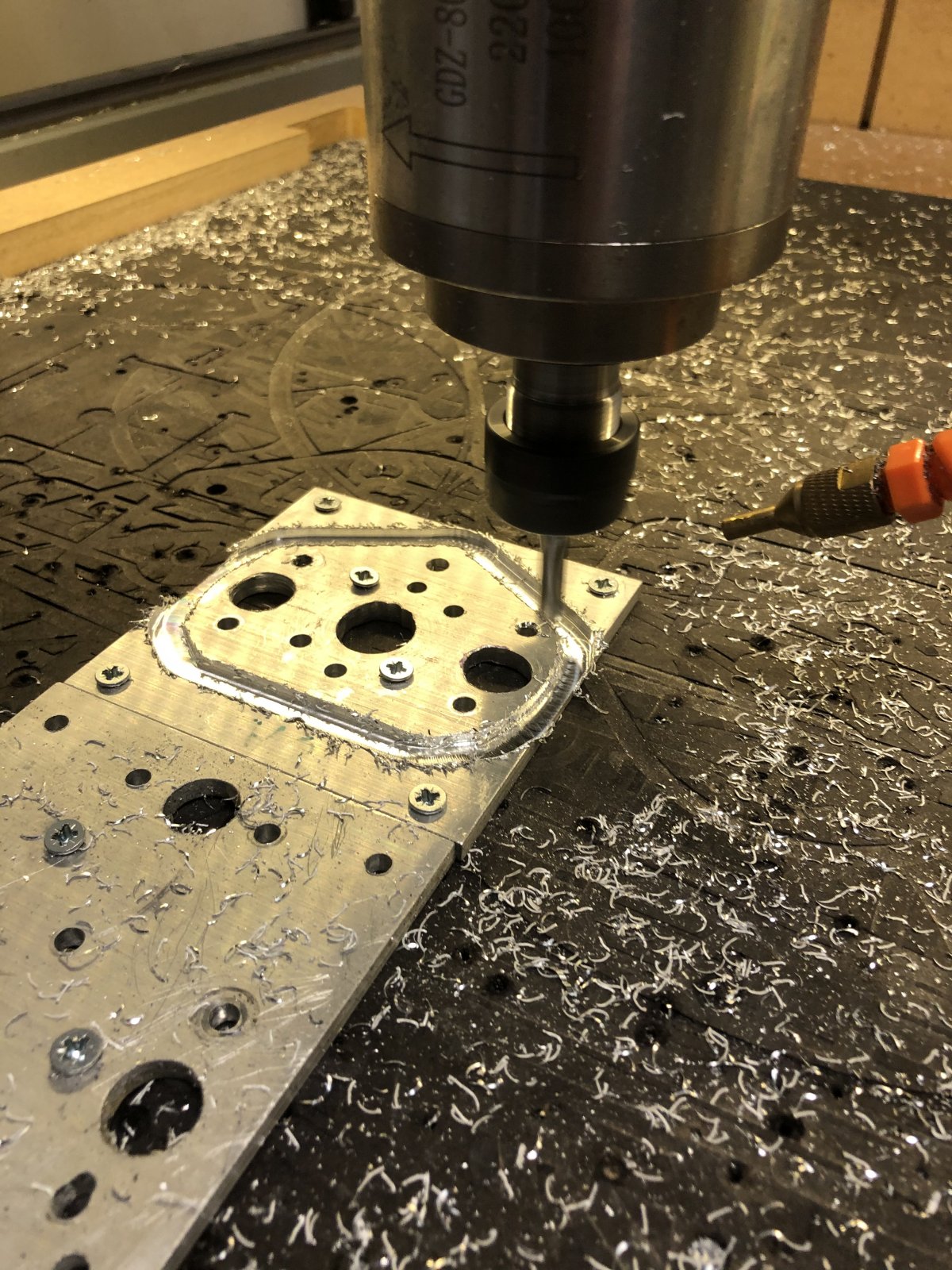

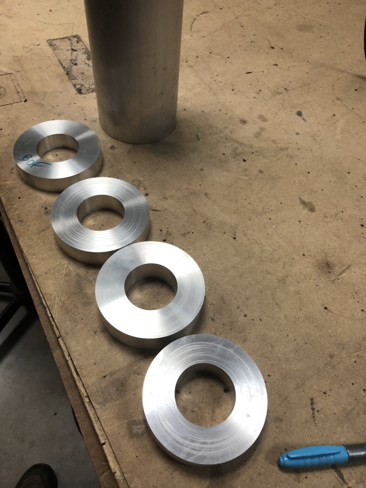

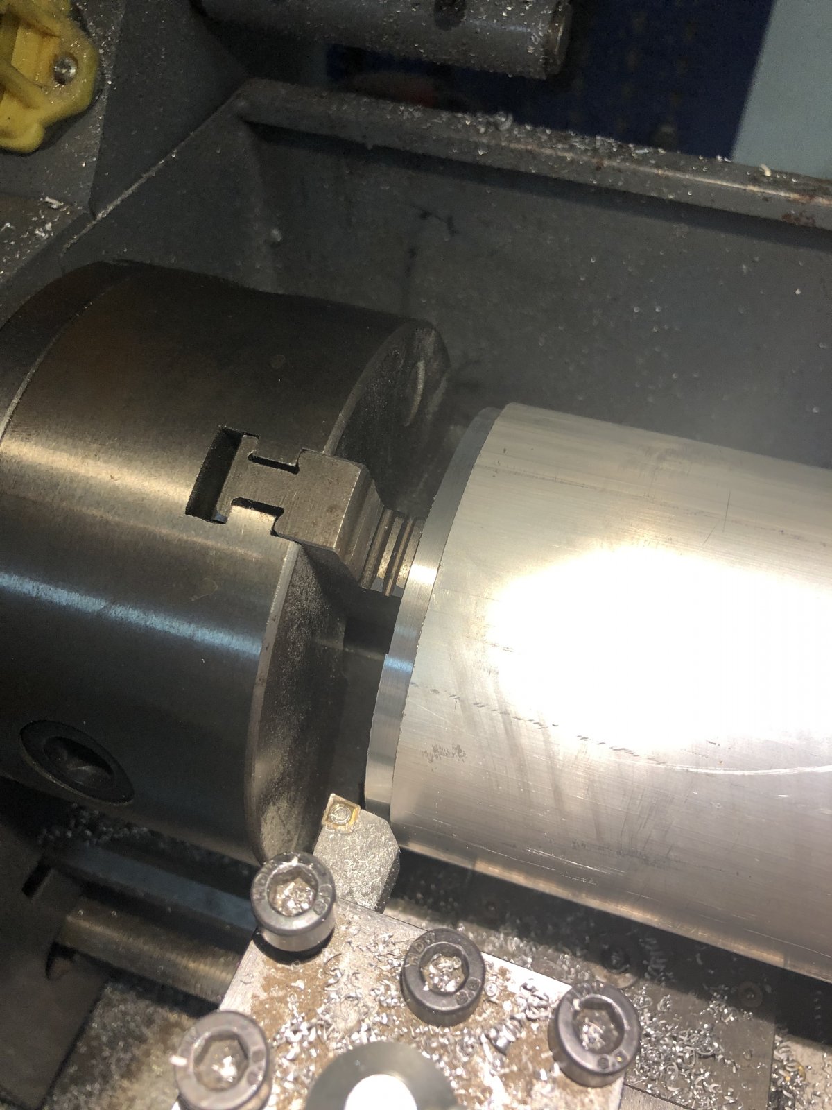

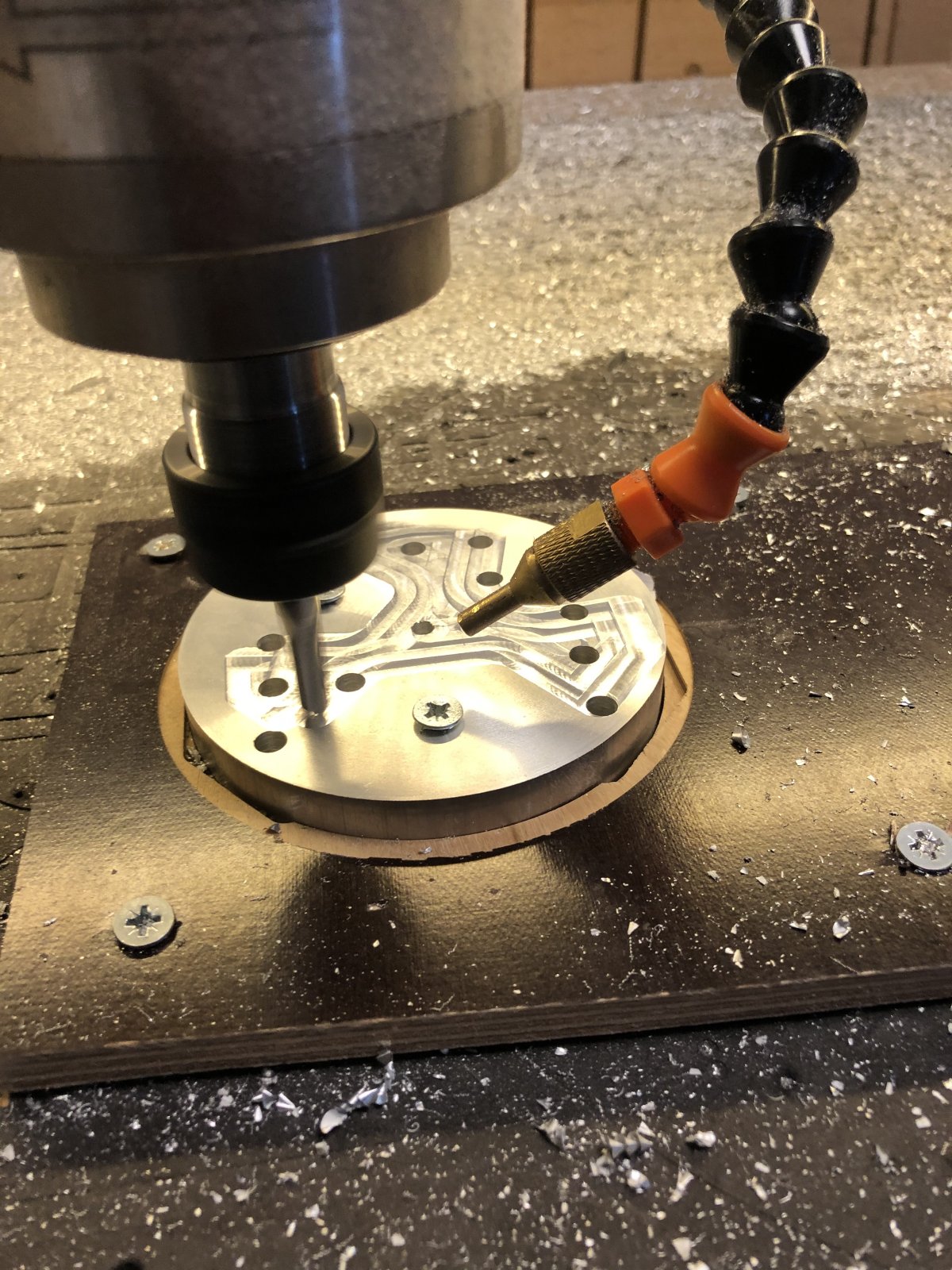

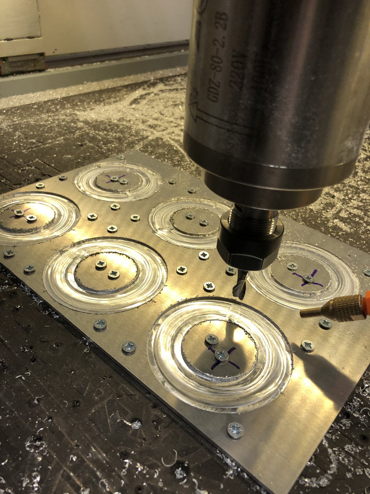

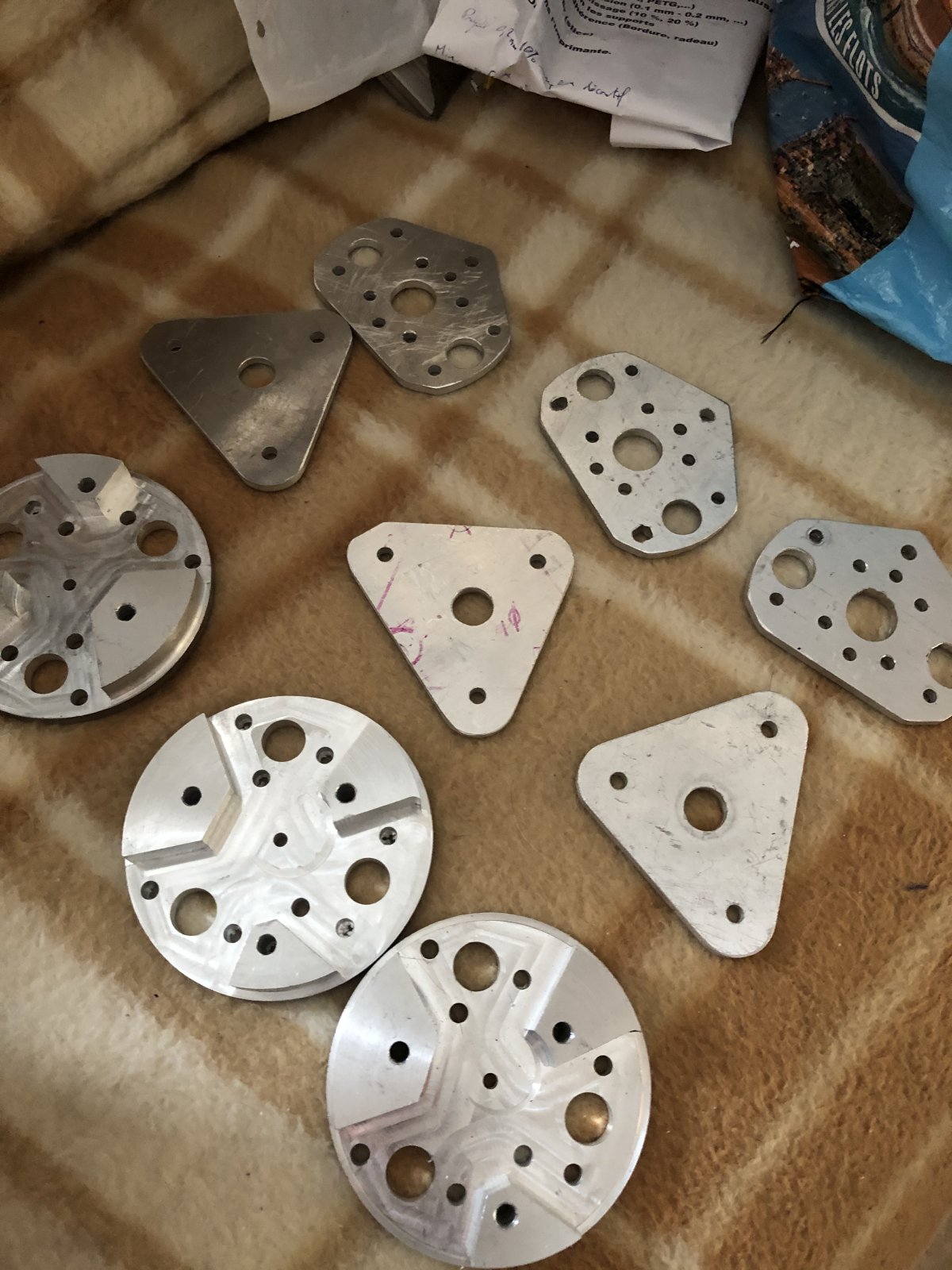

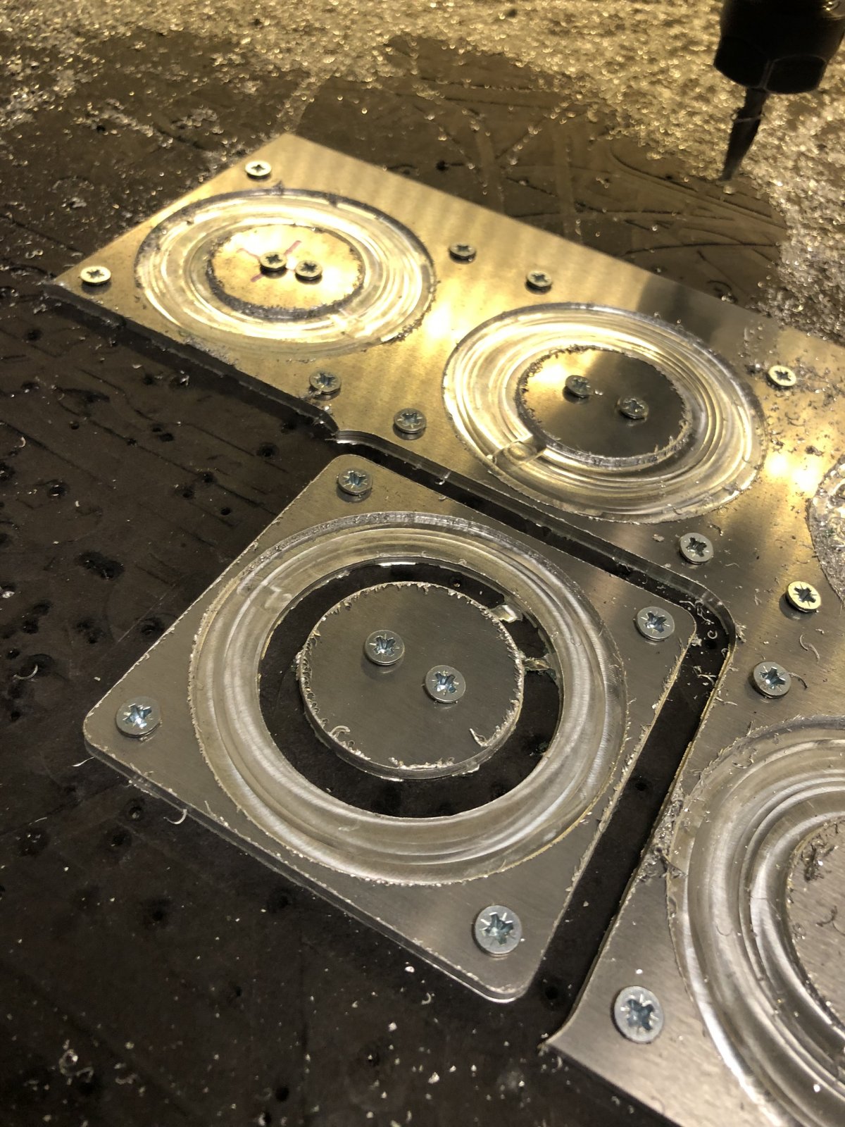

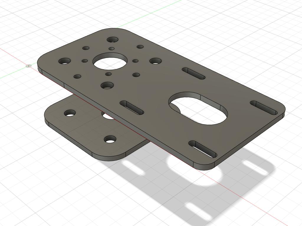

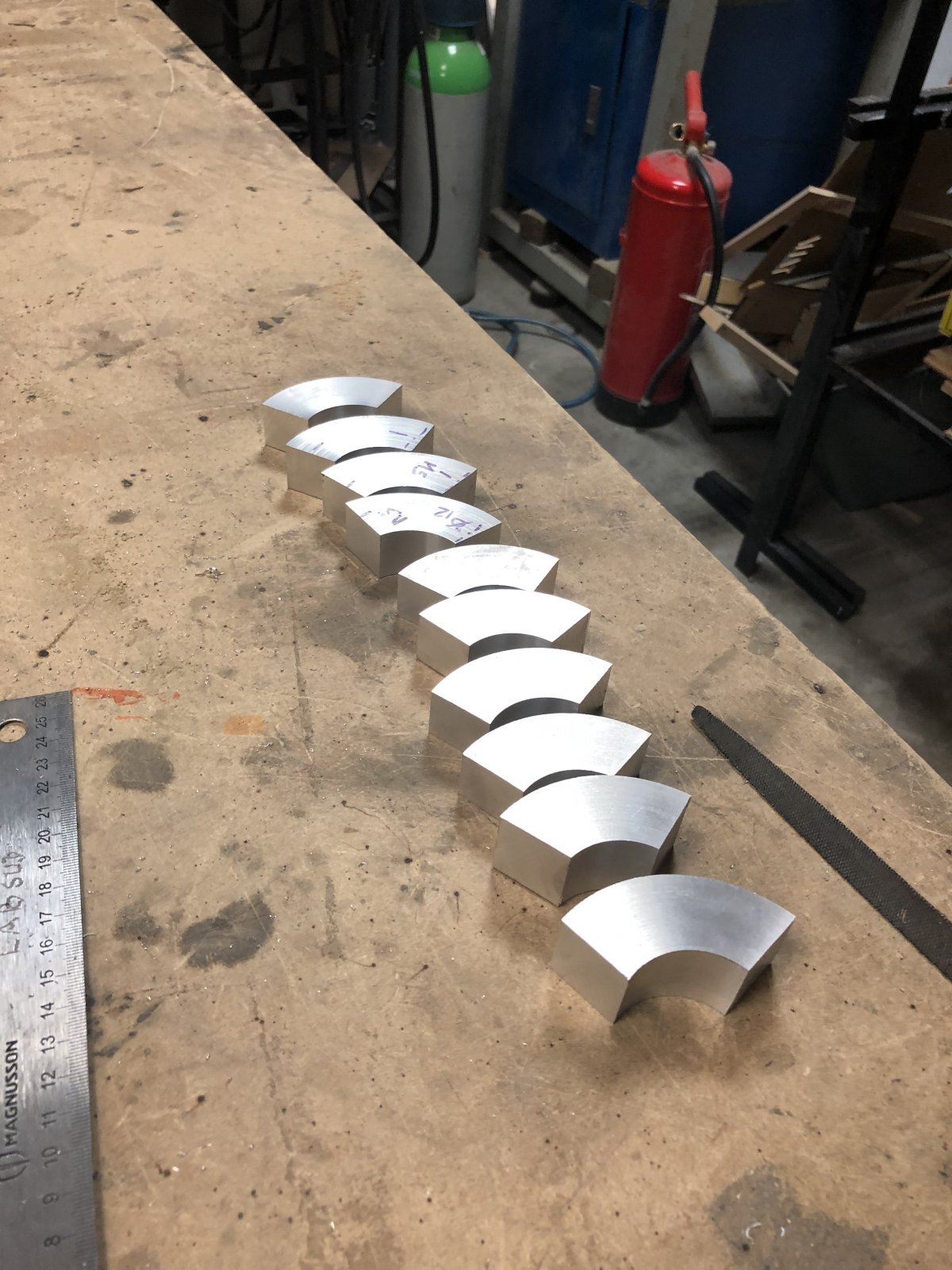

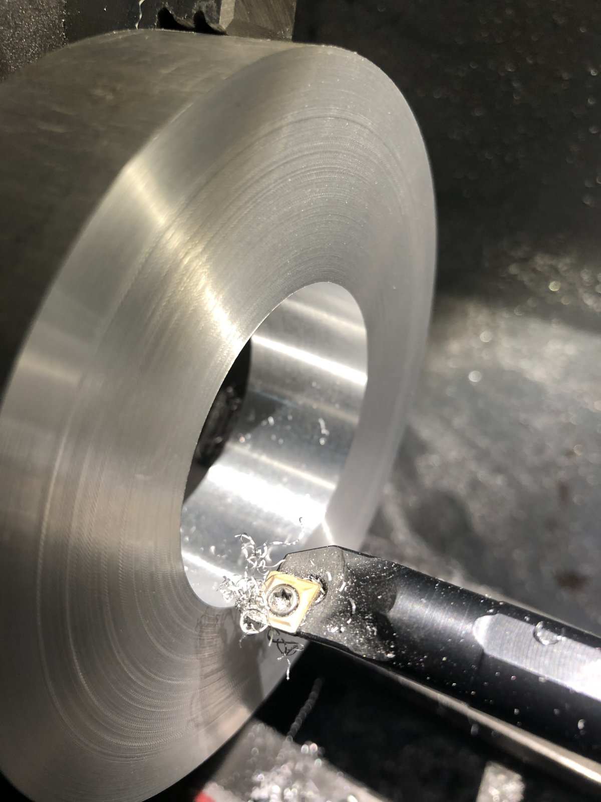

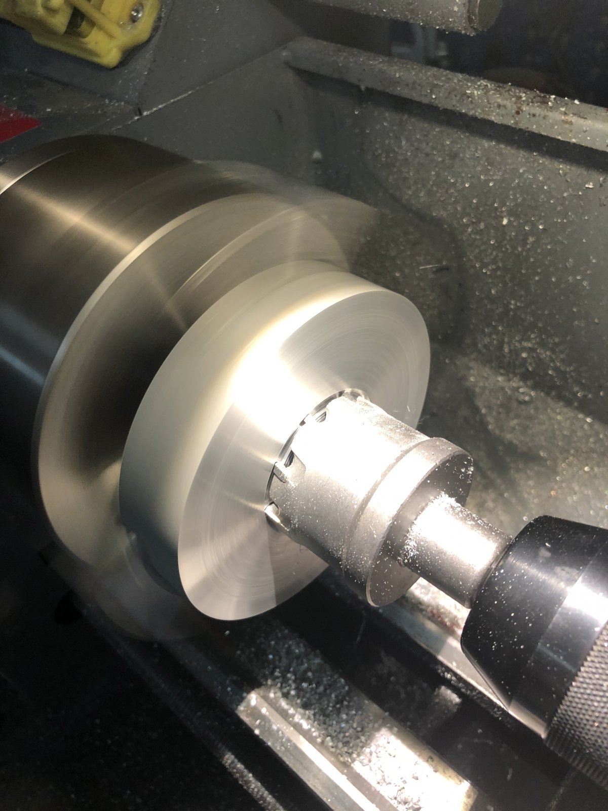

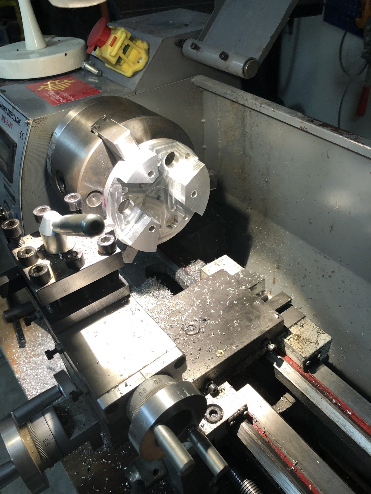

    size of my actuator diam 100mn lenght 550 mm
    It s time to play with the CNC of my fablab
    I ll try in aluminium instead 3D printing IMG_6896.JPG IMG_6903.JPG IMG_6905.JPG IMG_6918.JPG IMG_6920.JPG IMG_6951.JPG

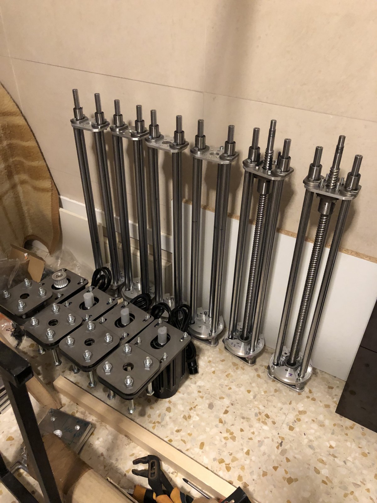

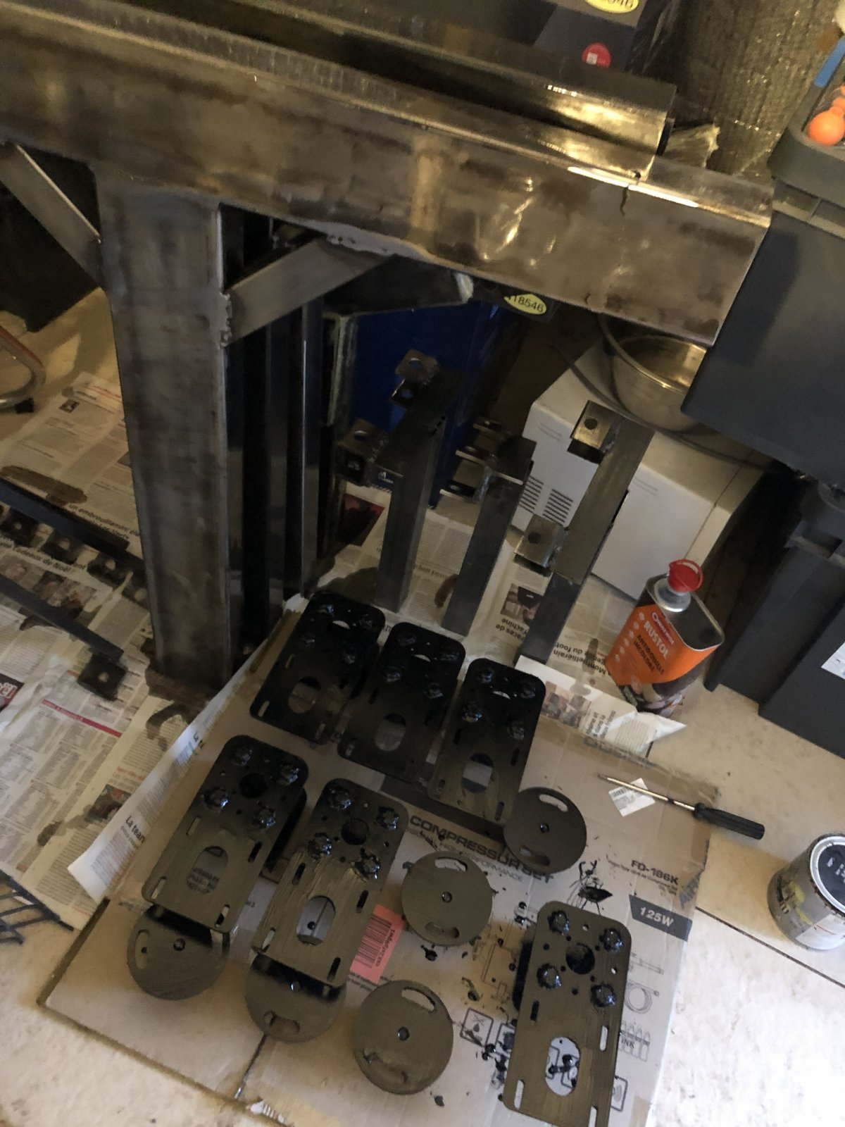

    +36 / 0 / -0
    and next work IMG_7056.JPG IMG_7057.JPG IMG_7070.JPG IMG_7073.JPG IMG_7077.JPG IMG_7079.JPG IMG_7093.JPG

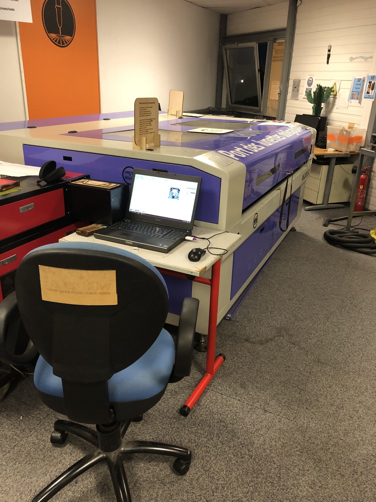

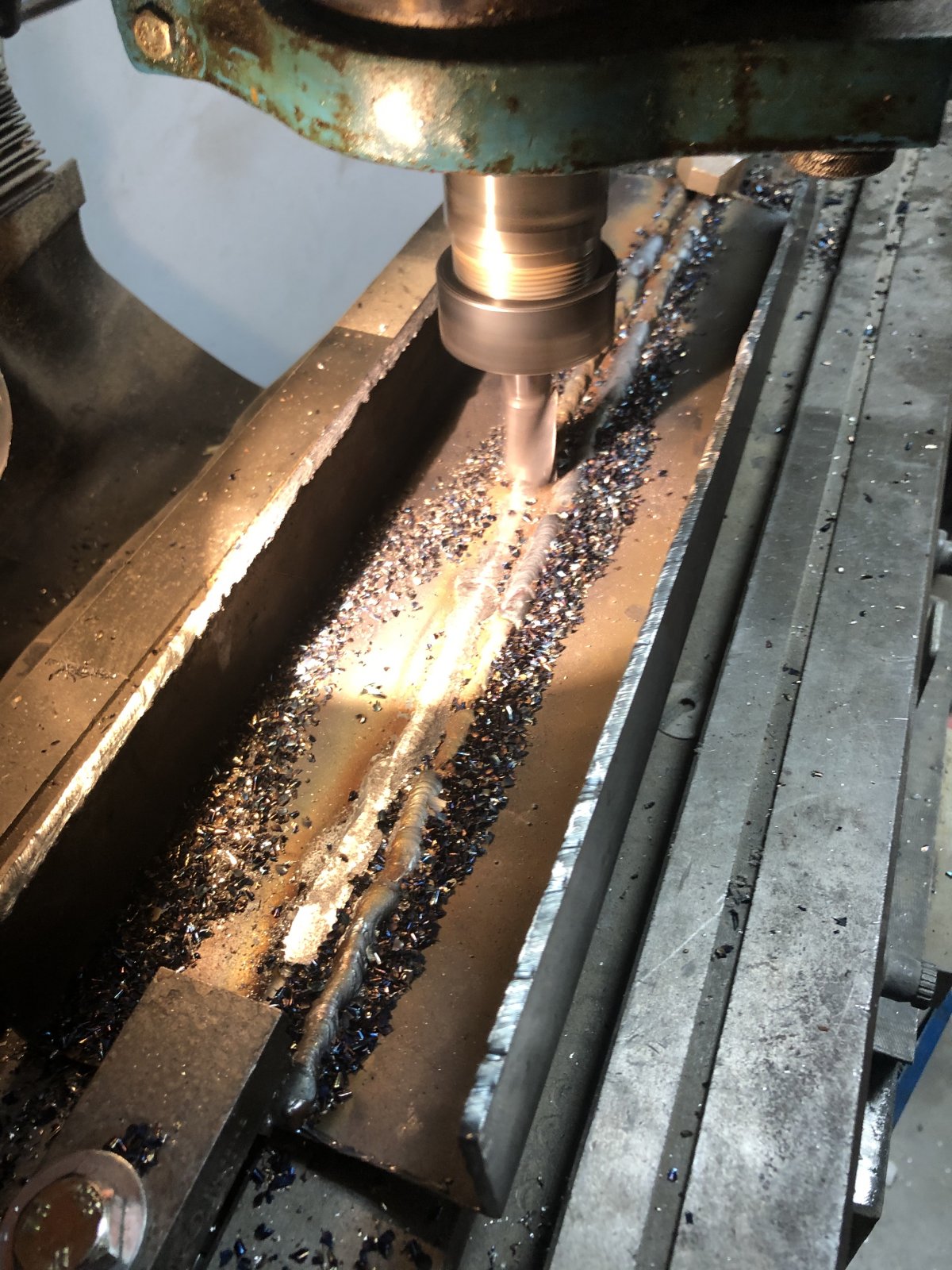

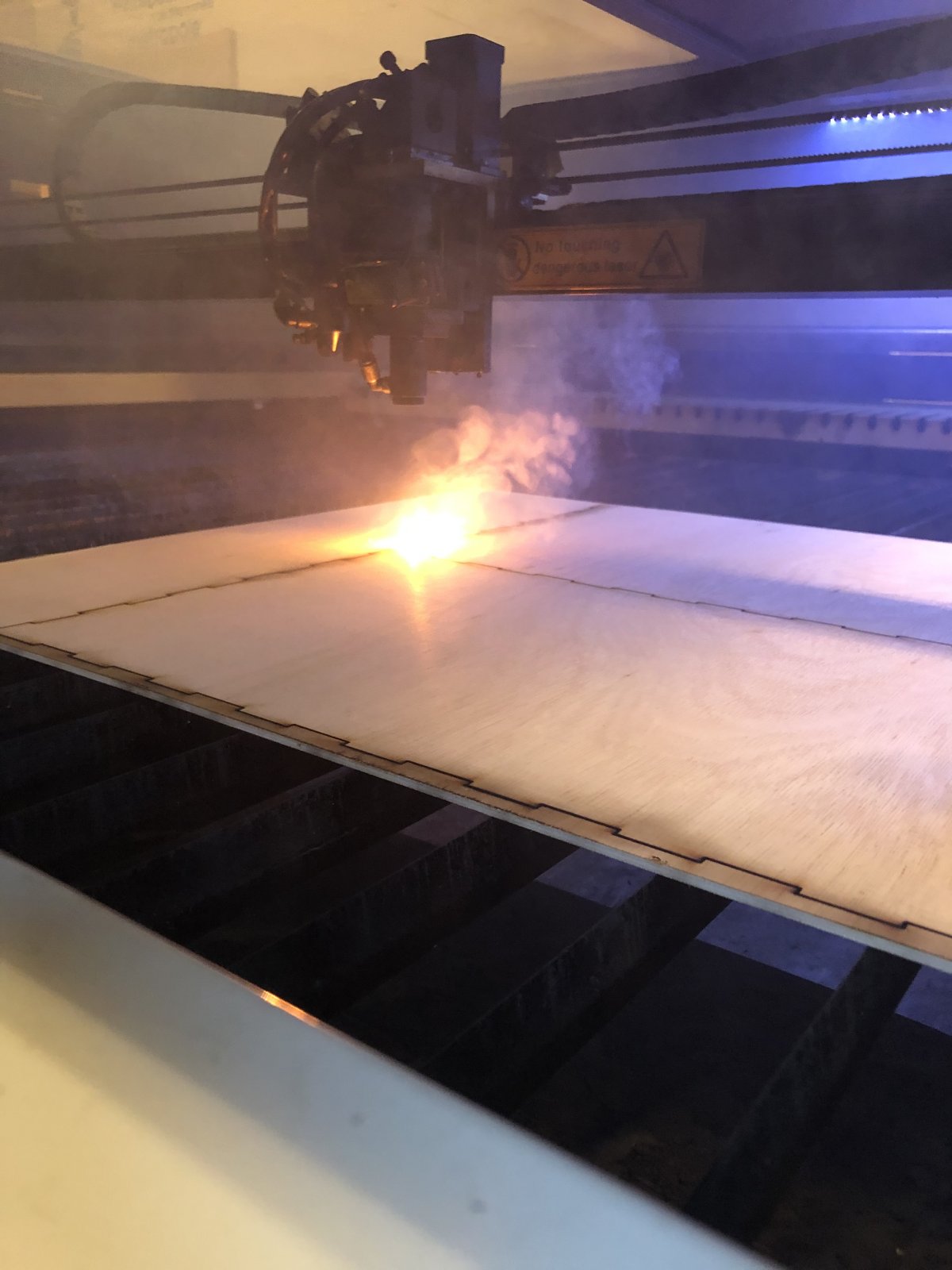

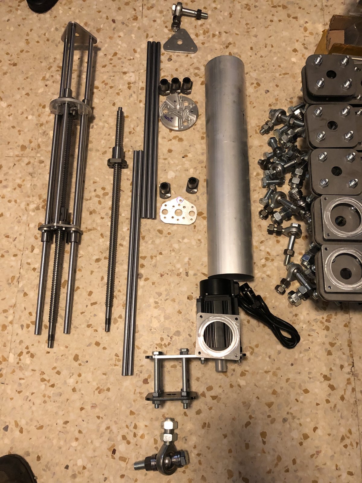

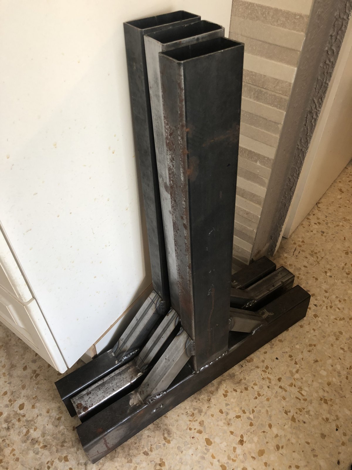

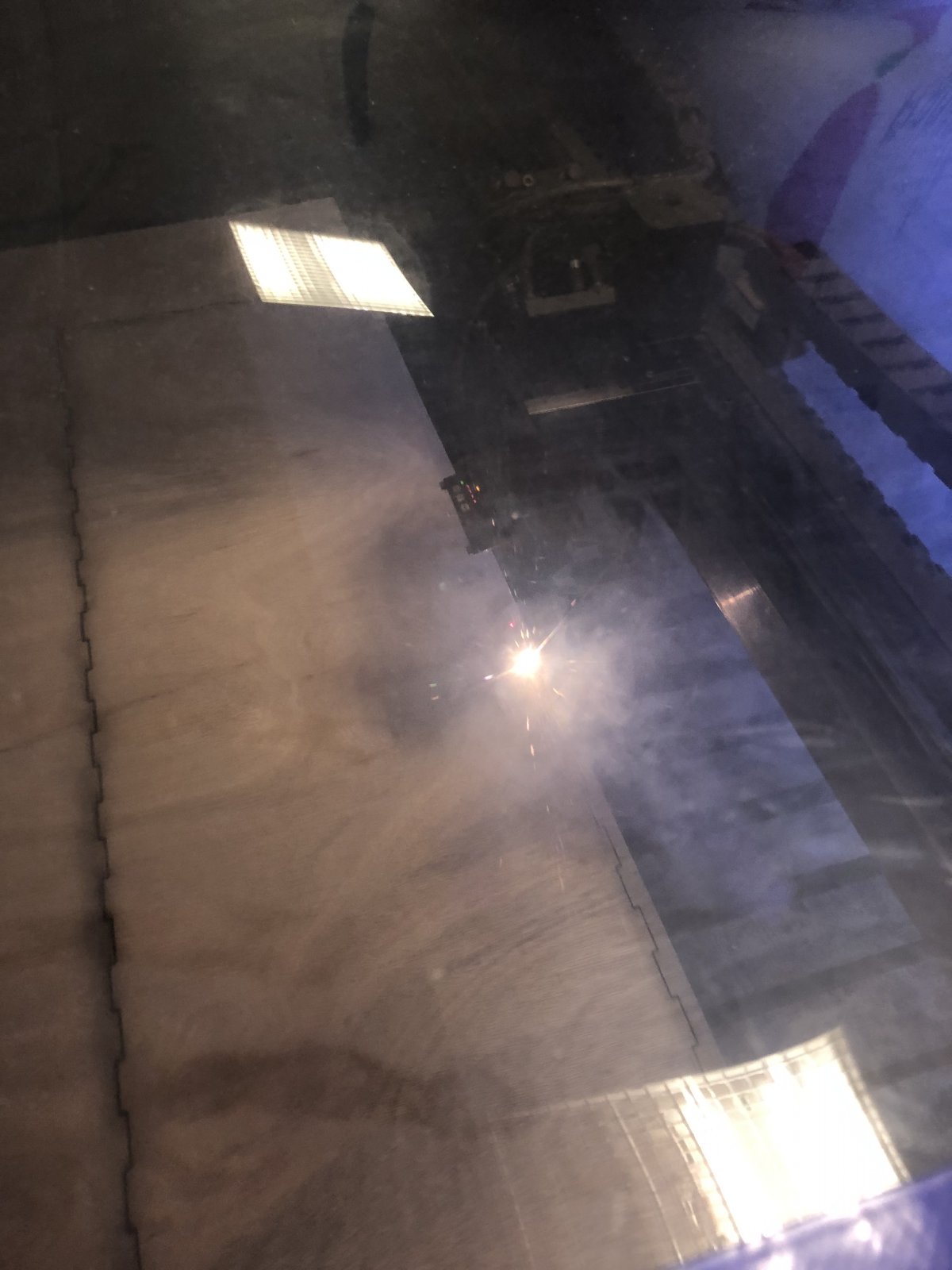

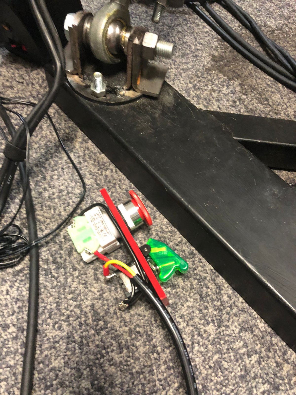

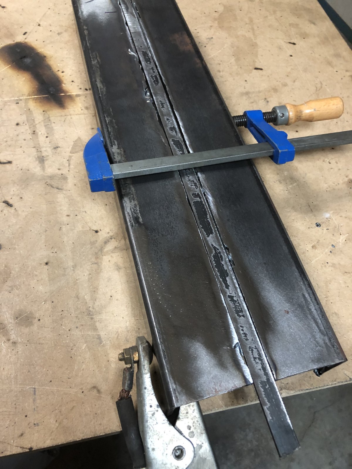

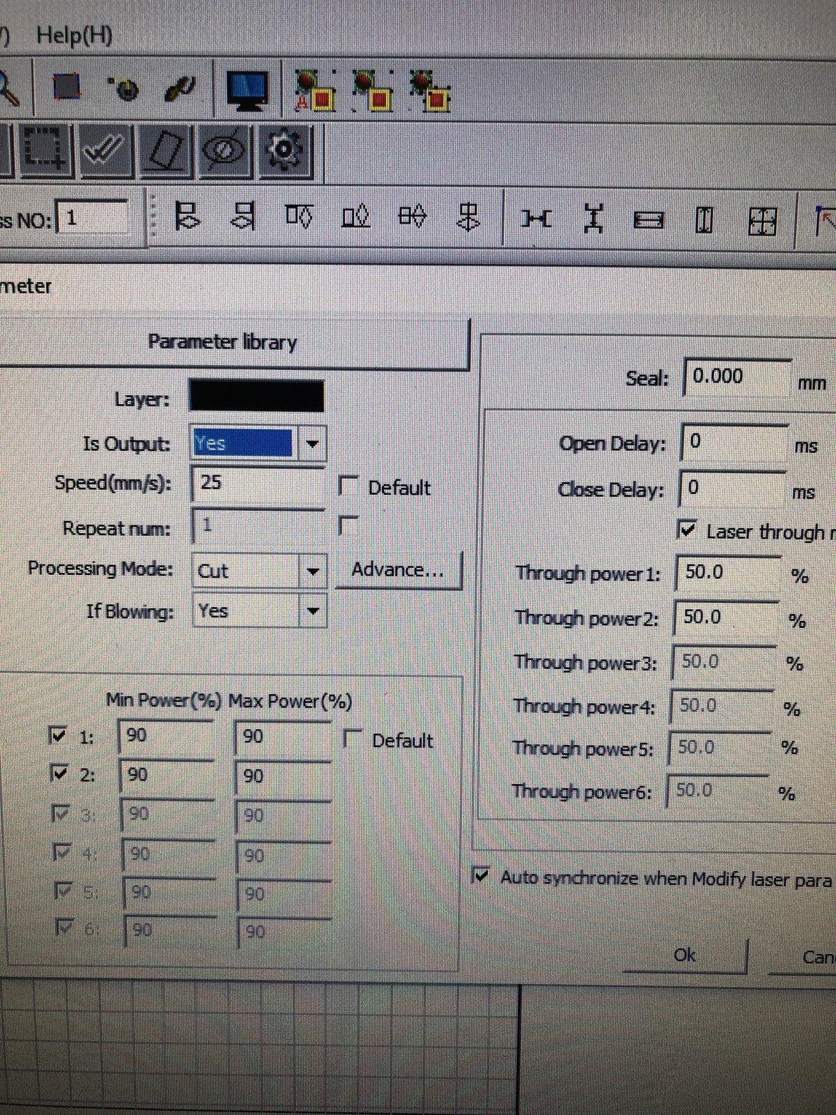

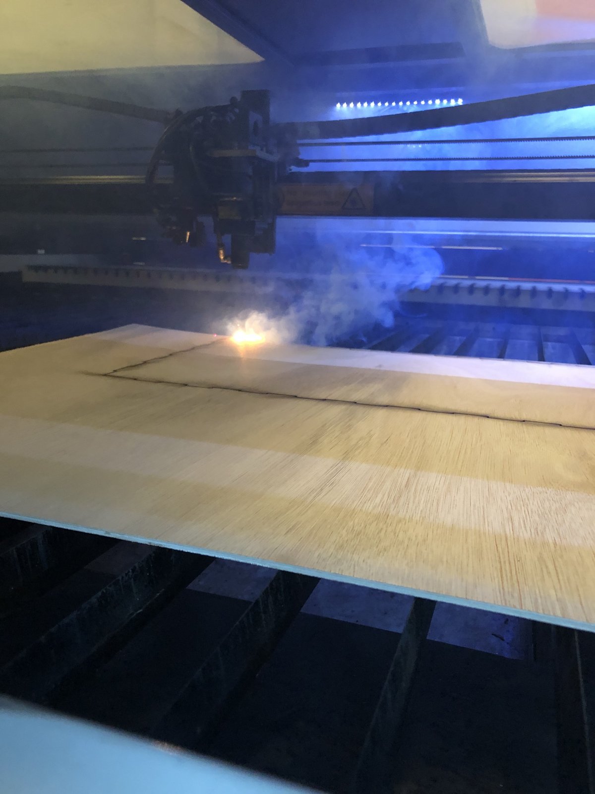

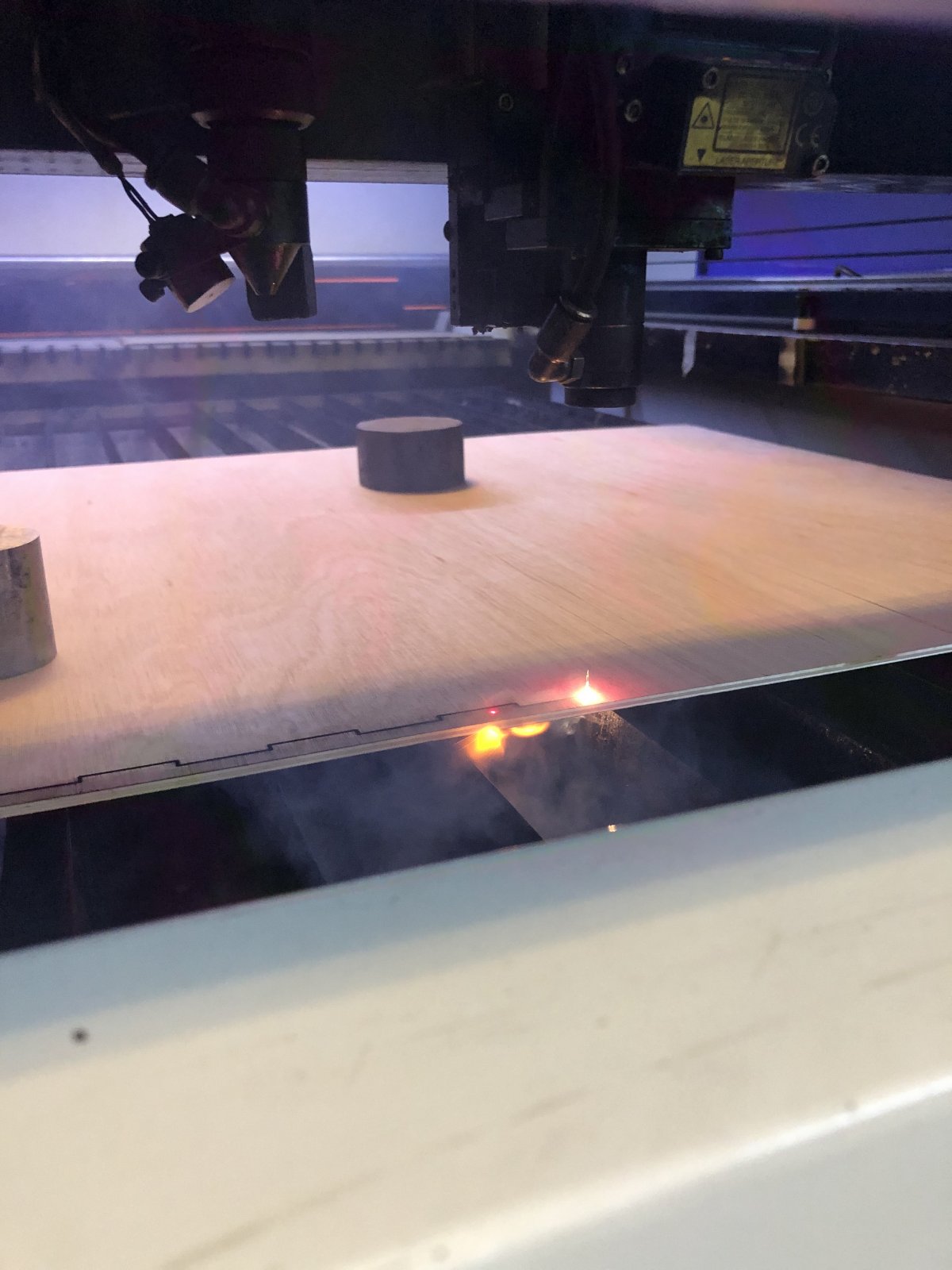

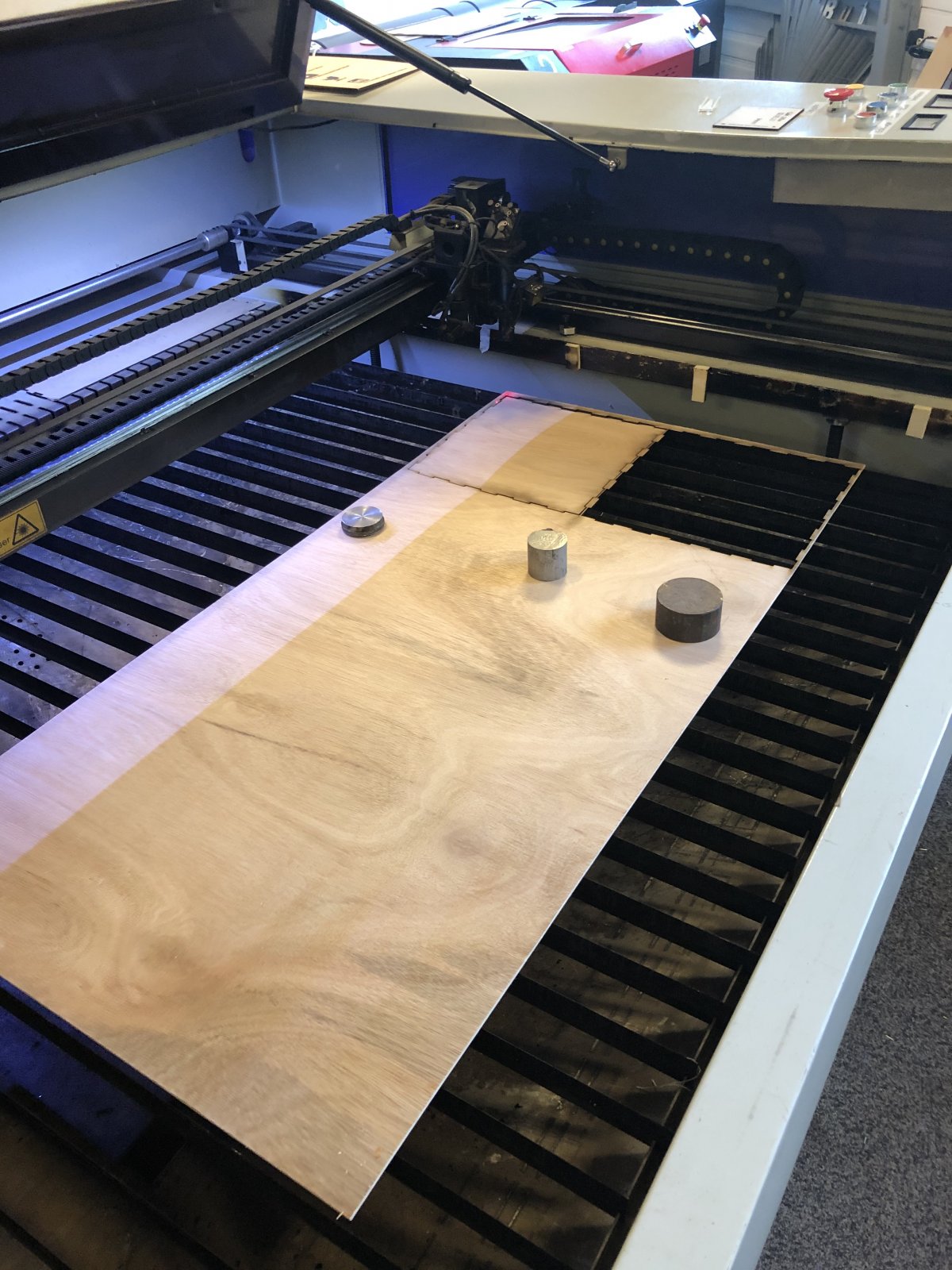

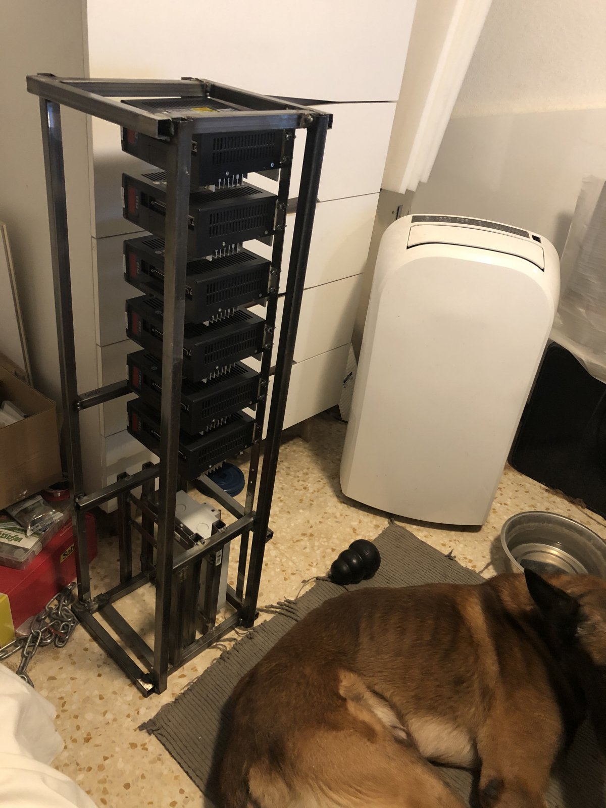

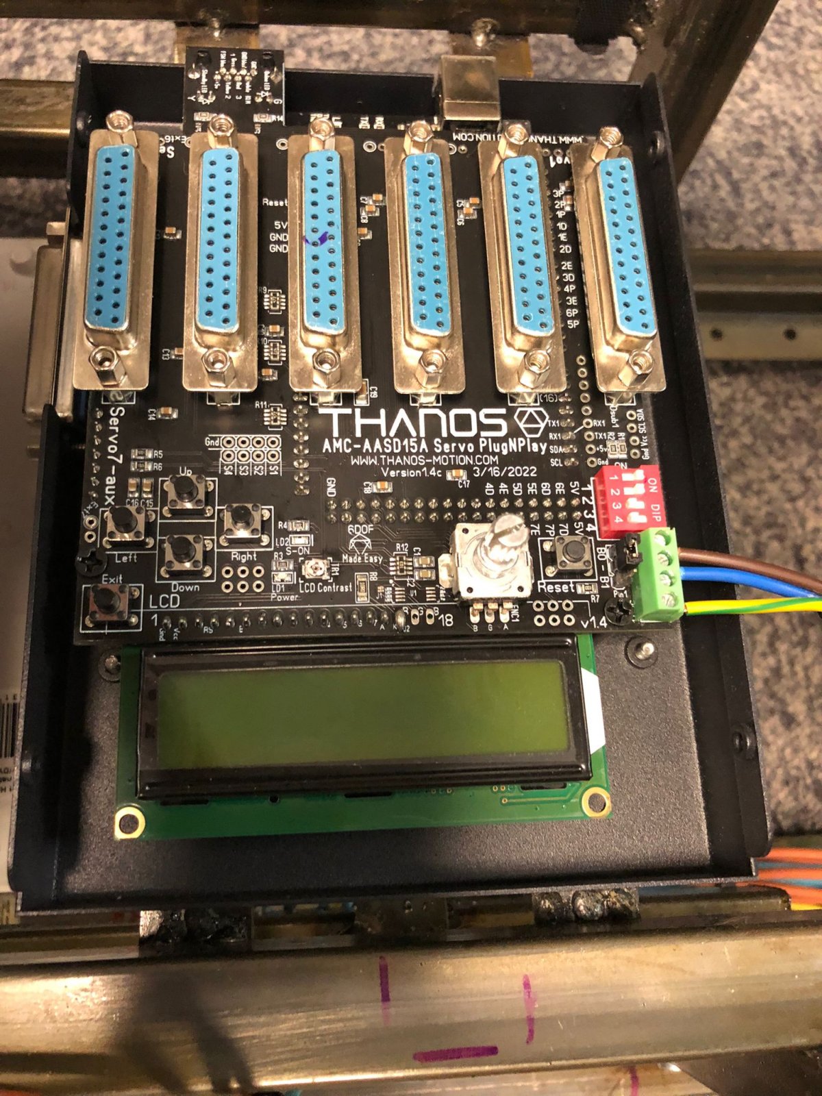

    Actuators are not fully finish because i m waitting one pice so time to take care of power controller.
    One steel fram and one box in wood around. Big box ll cut pefectly with 180w lazer. IMG_7144.JPG IMG_7146.JPG IMG_7148.JPG IMG_7153.JPG IMG_7159.JPG IMG_7169.JPG IMG_7172.JPG IMG_7186.JPG IMG_7195.JPG IMG_7197.JPG IMG_7198.JPG

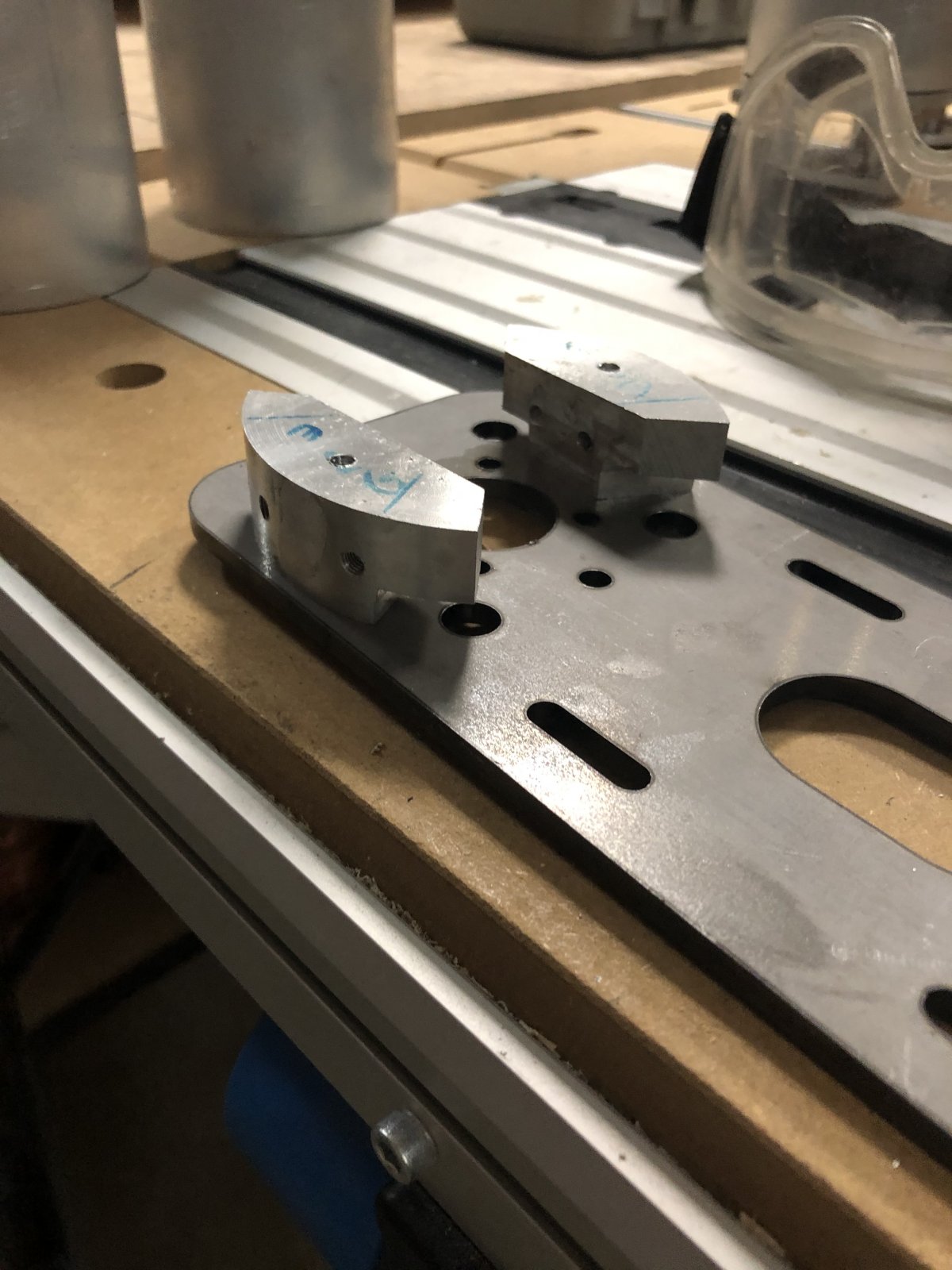

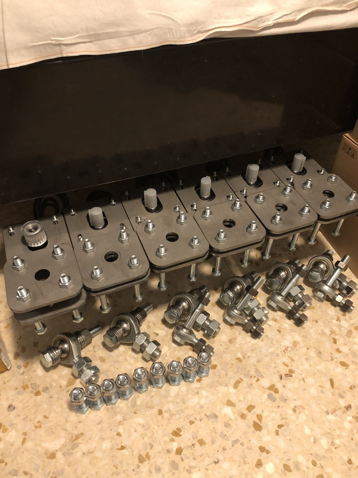

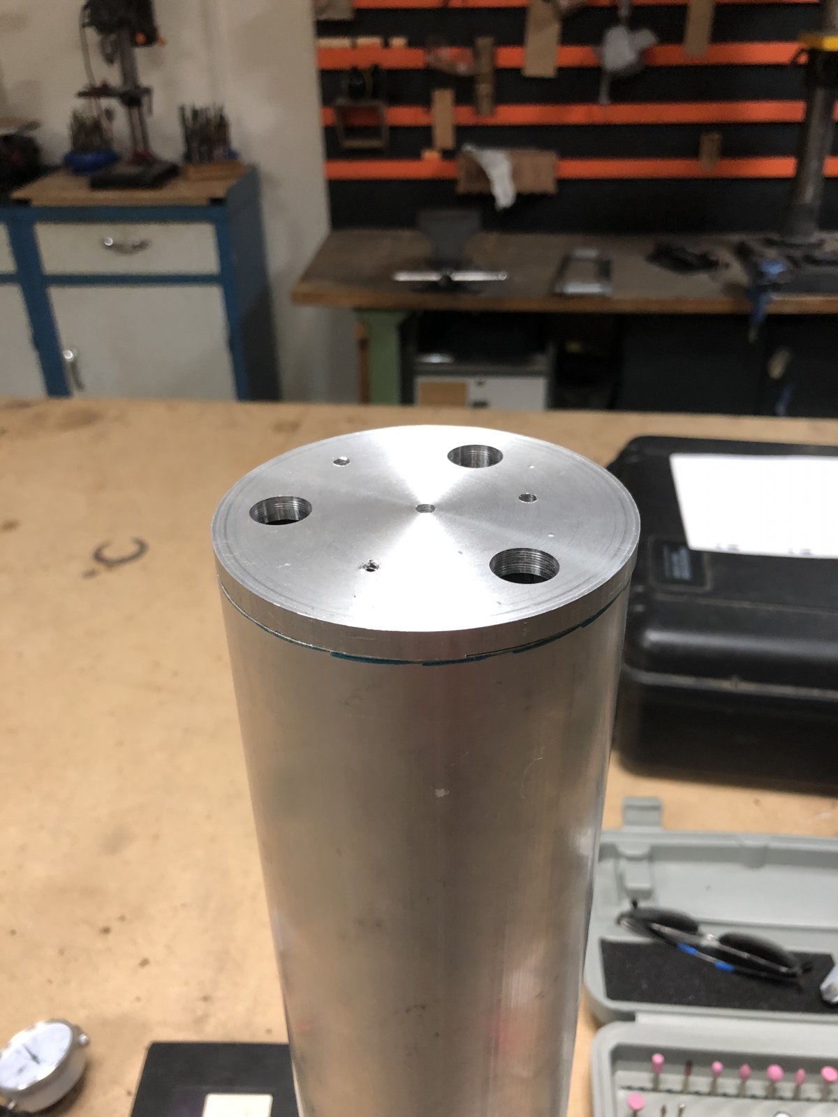

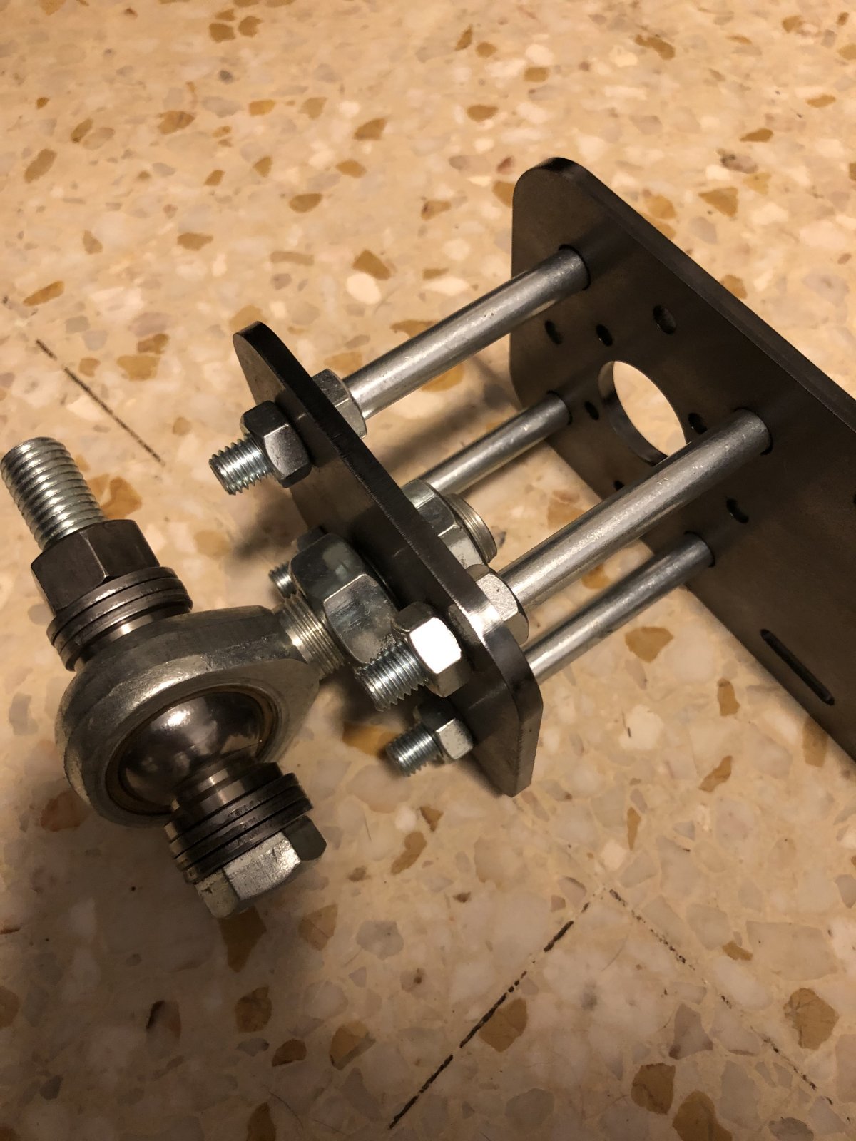

    Ccreation of the cylinder fixing.
    To finish the actuators , the up and down axes are now just missing.
    IMG_7107.JPG IMG_7112.JPG IMG_7115.JPG IMG_7116.JPG IMG_7191.JPG IMG_7192.JPG IMG_7224.JPG IMG_7223.JPG IMG_7221.JPG

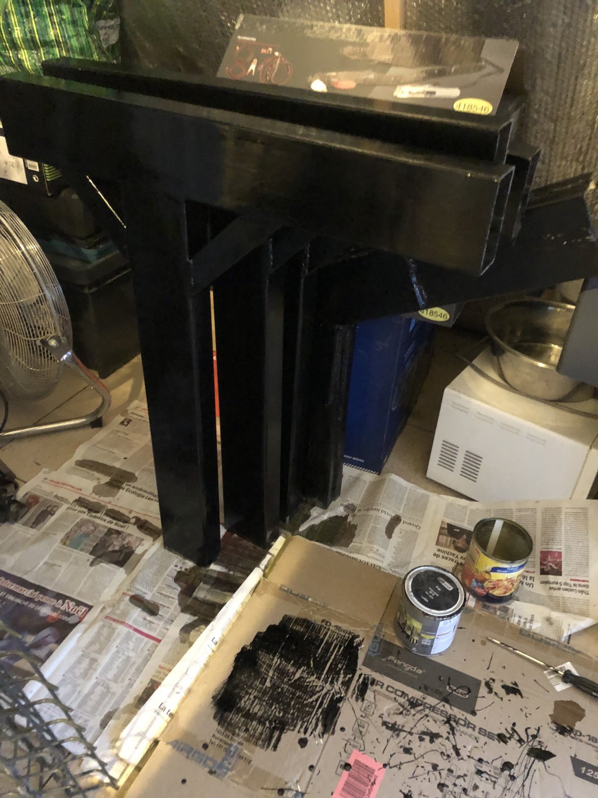

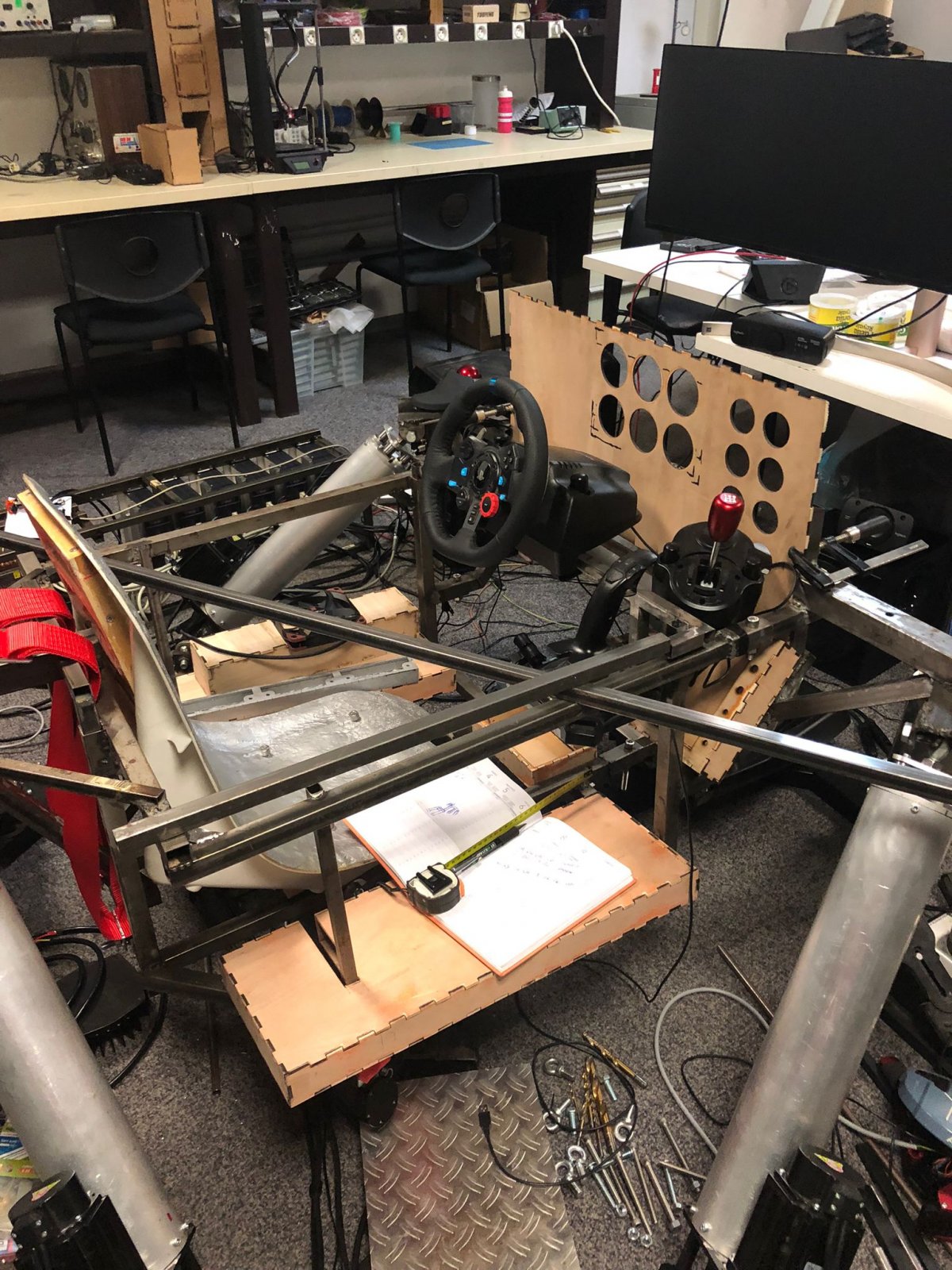

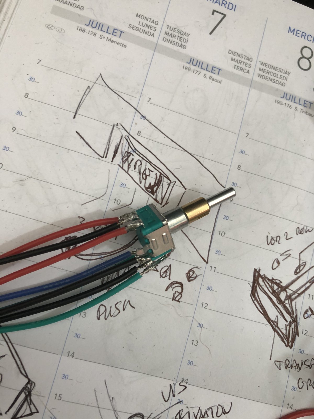

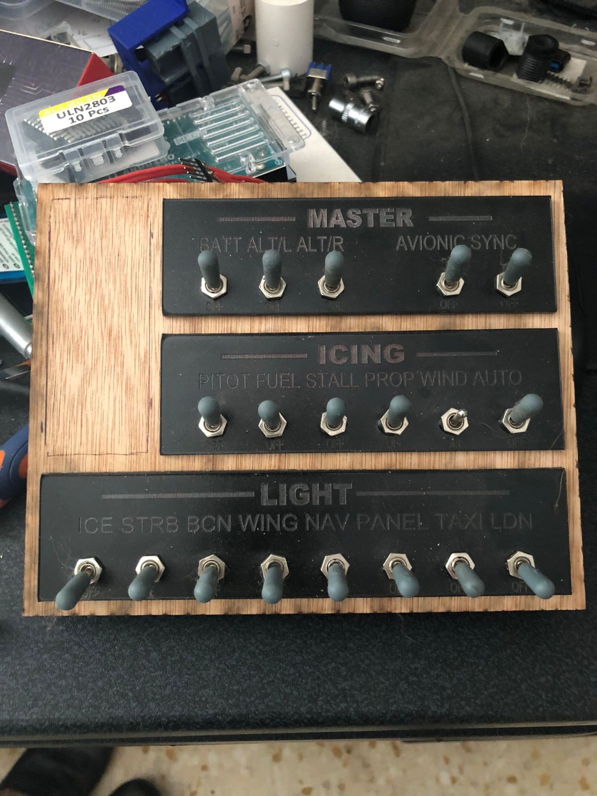

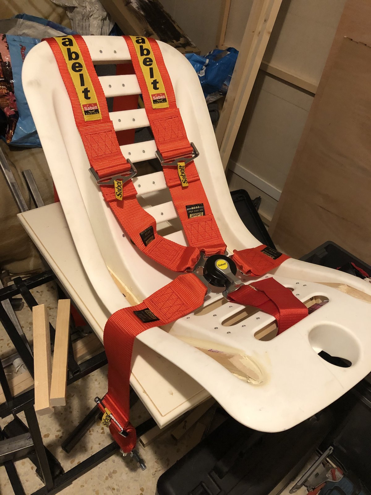

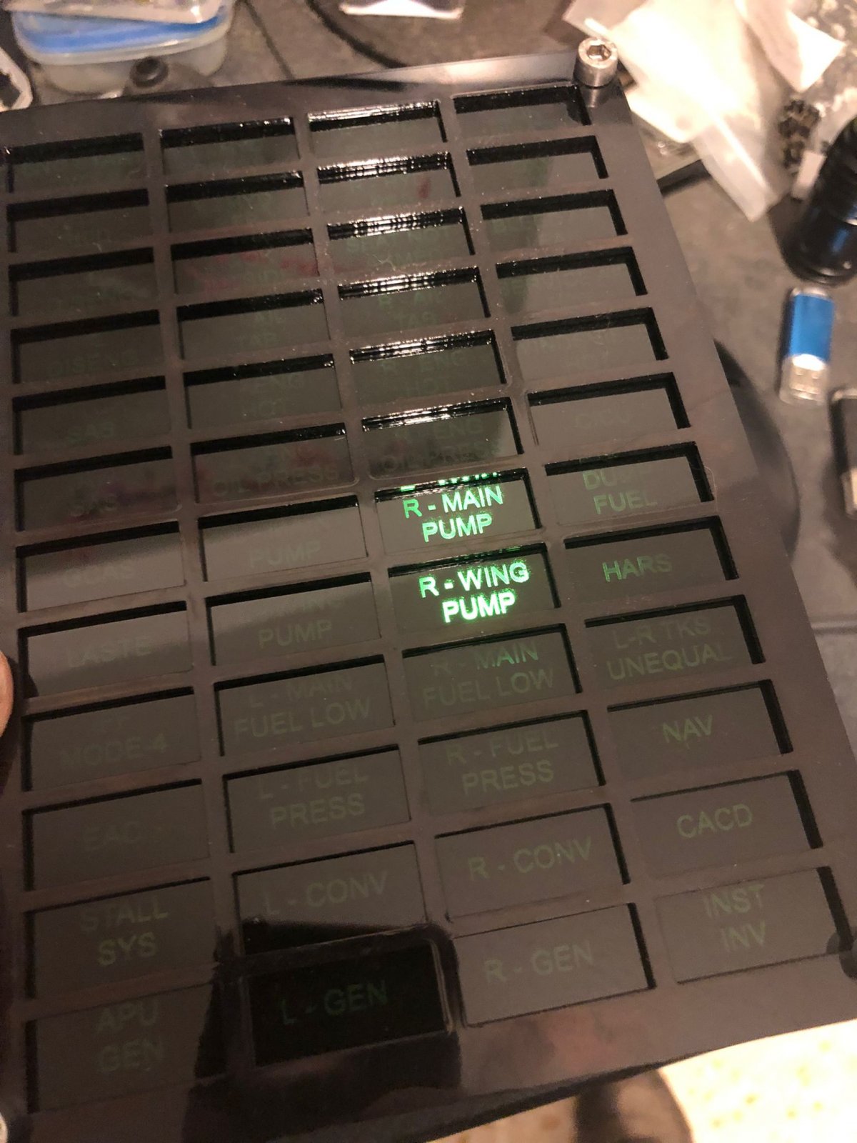

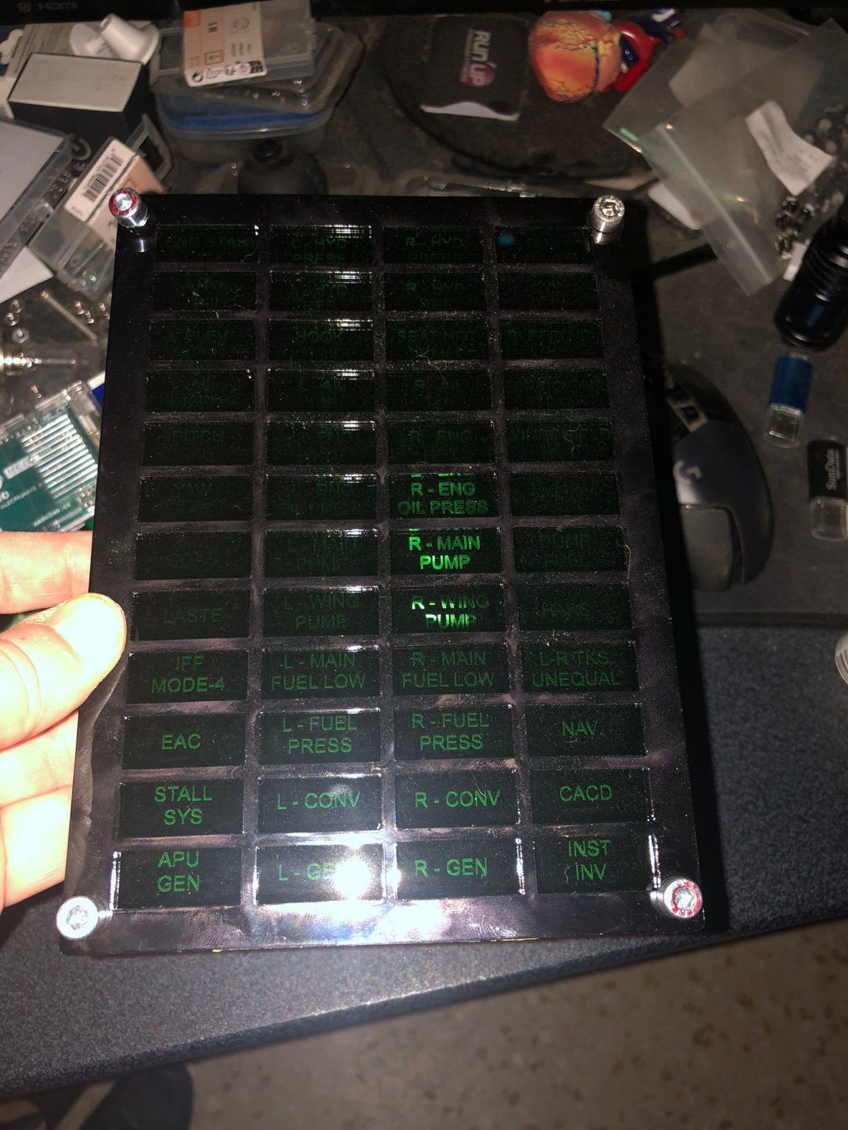

    +36 / 0 / -0

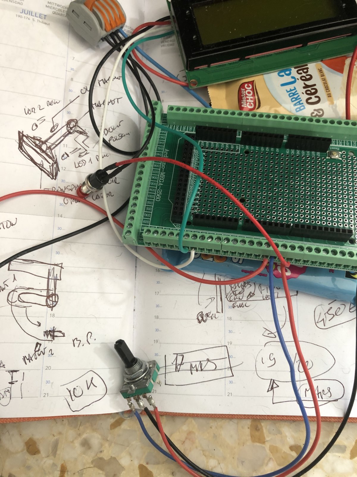

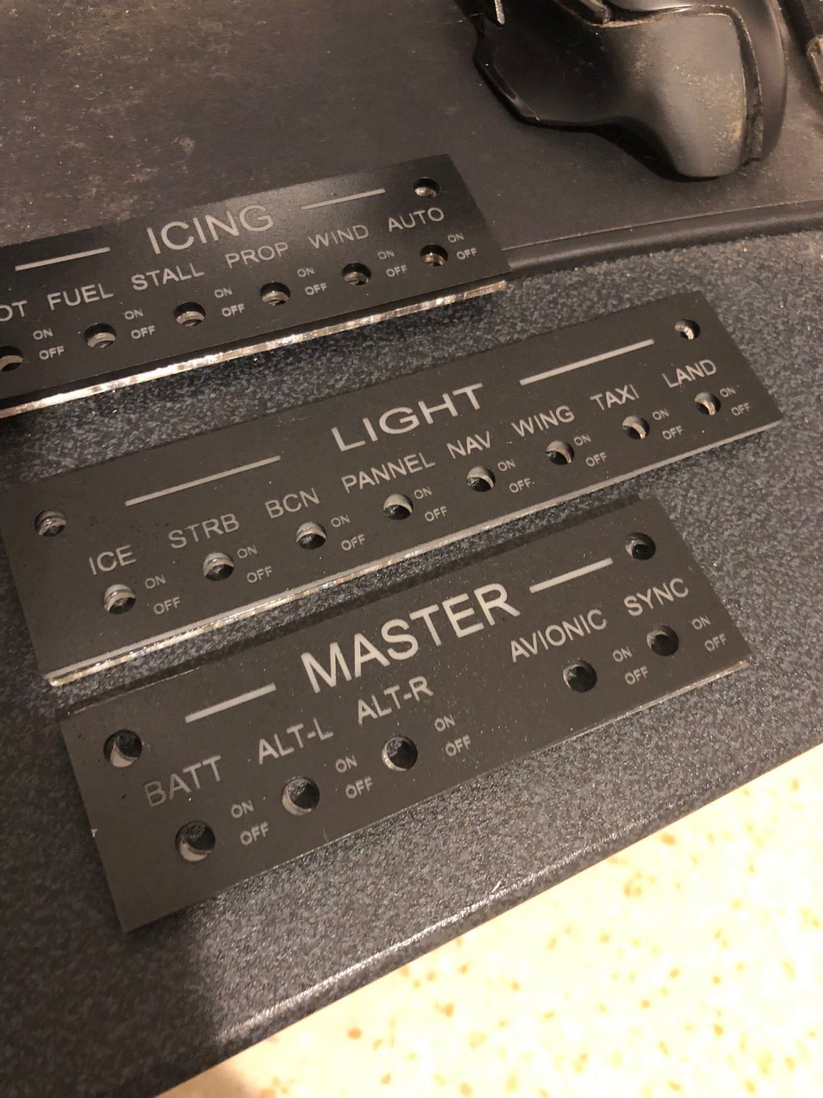

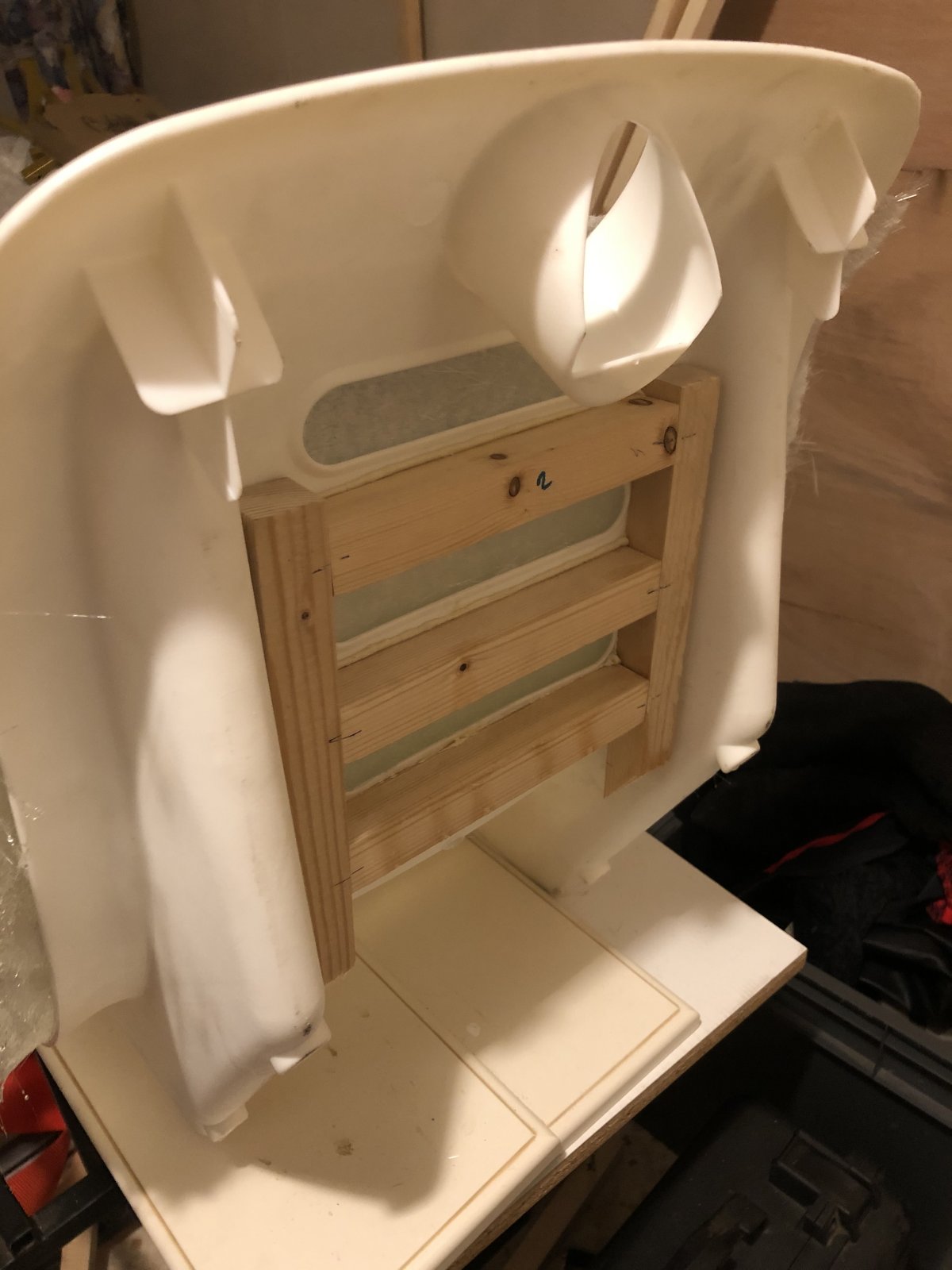

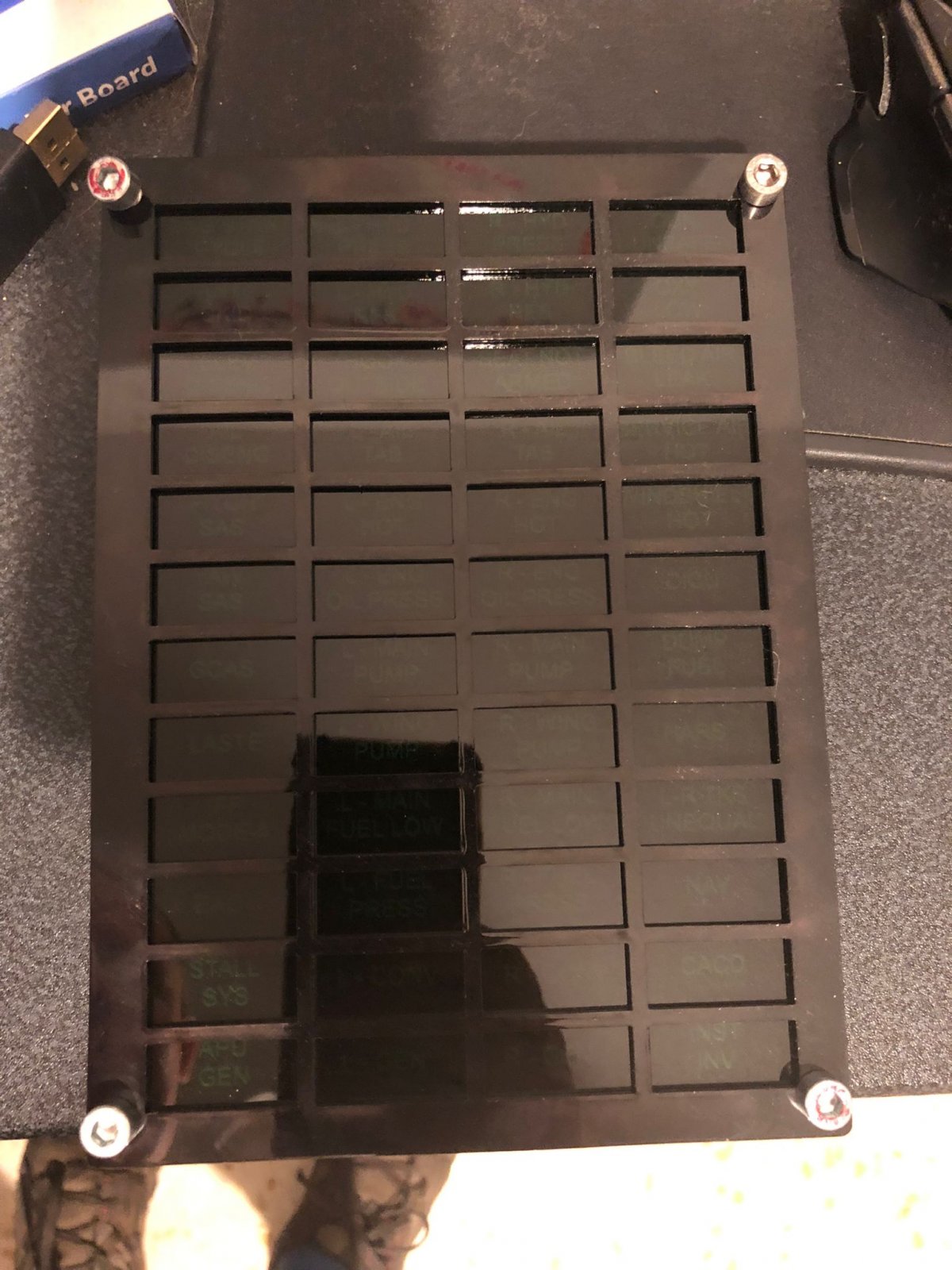

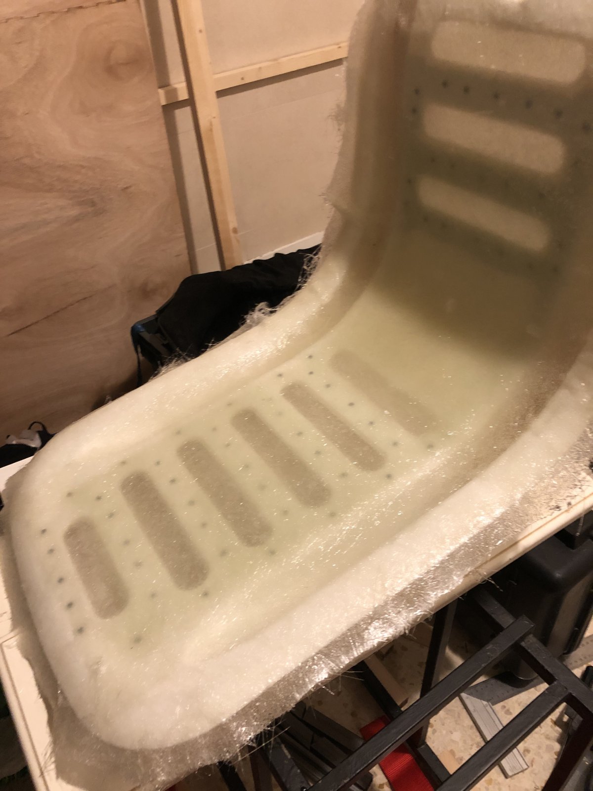

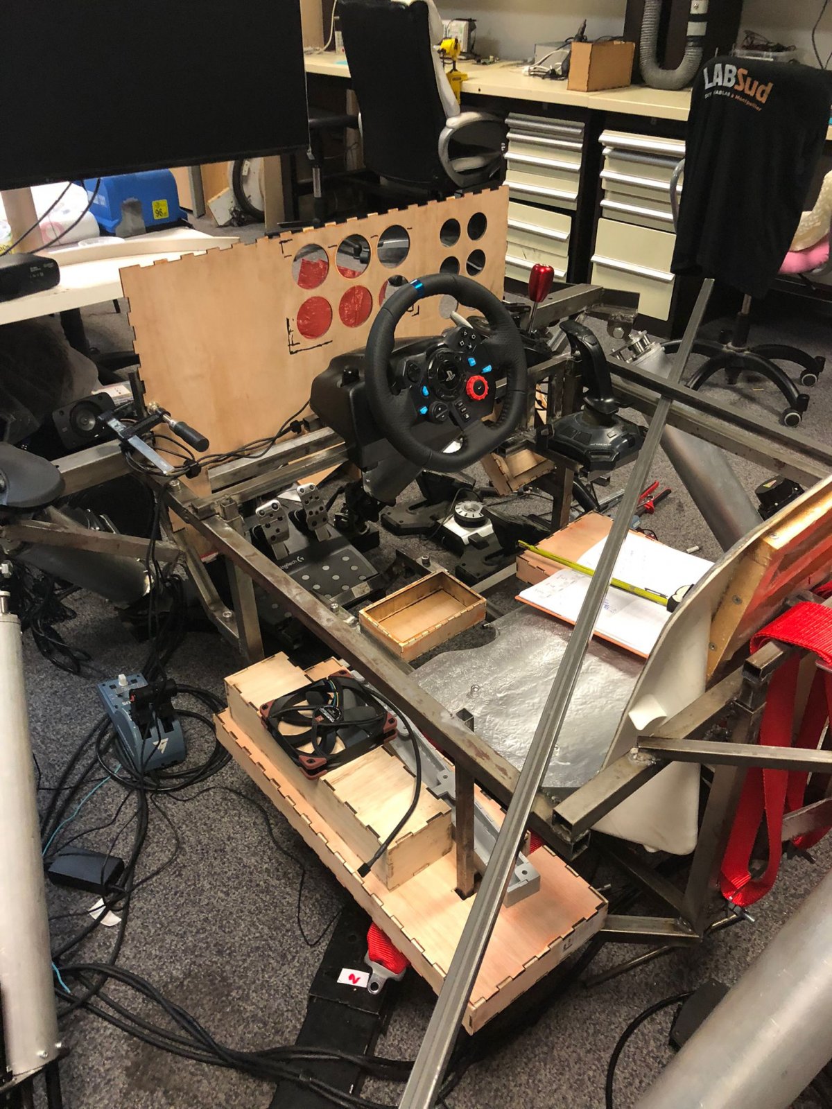

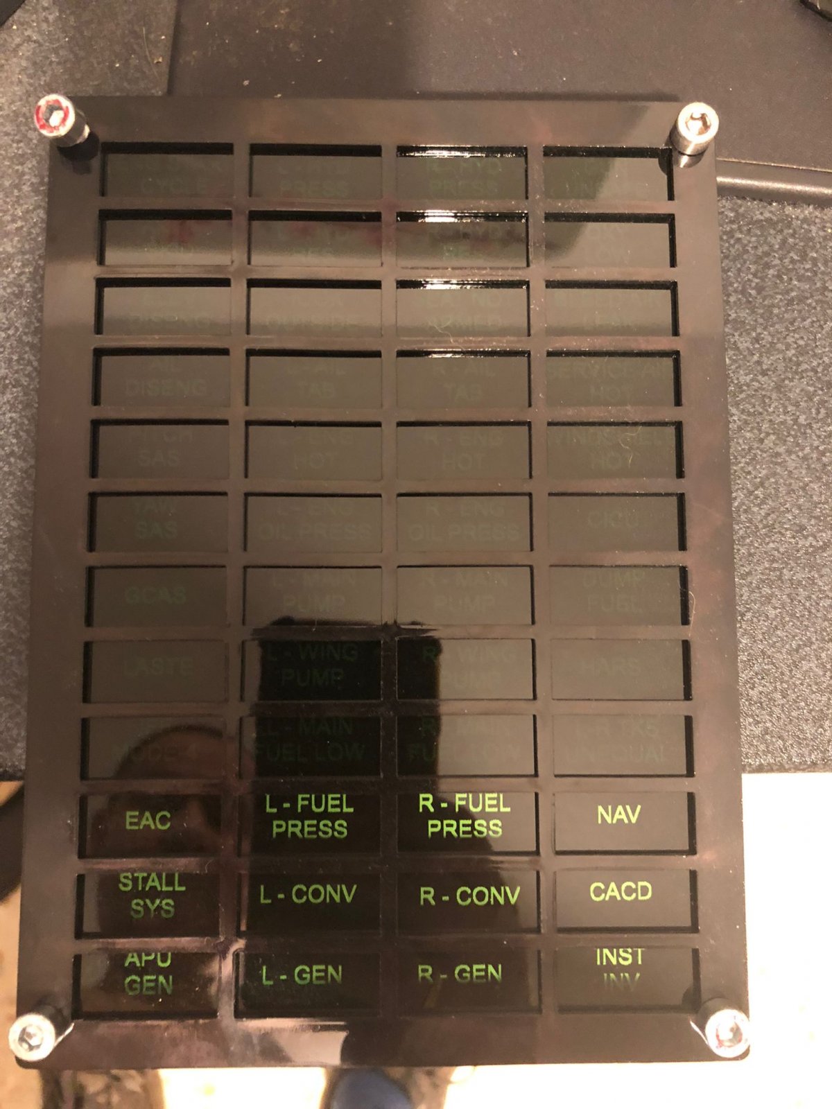

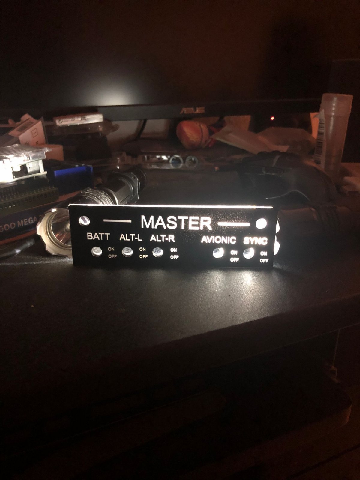

    Painting time., i start the seat and the electronic for the cockpit IMG_7574.JPG IMG_7590.JPG IMG_7597.JPG IMG_7600.JPG IMG_7601.JPG IMG_7608.JPG IMG_7609.JPG

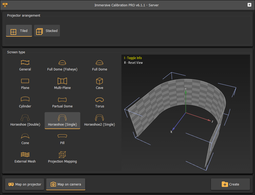

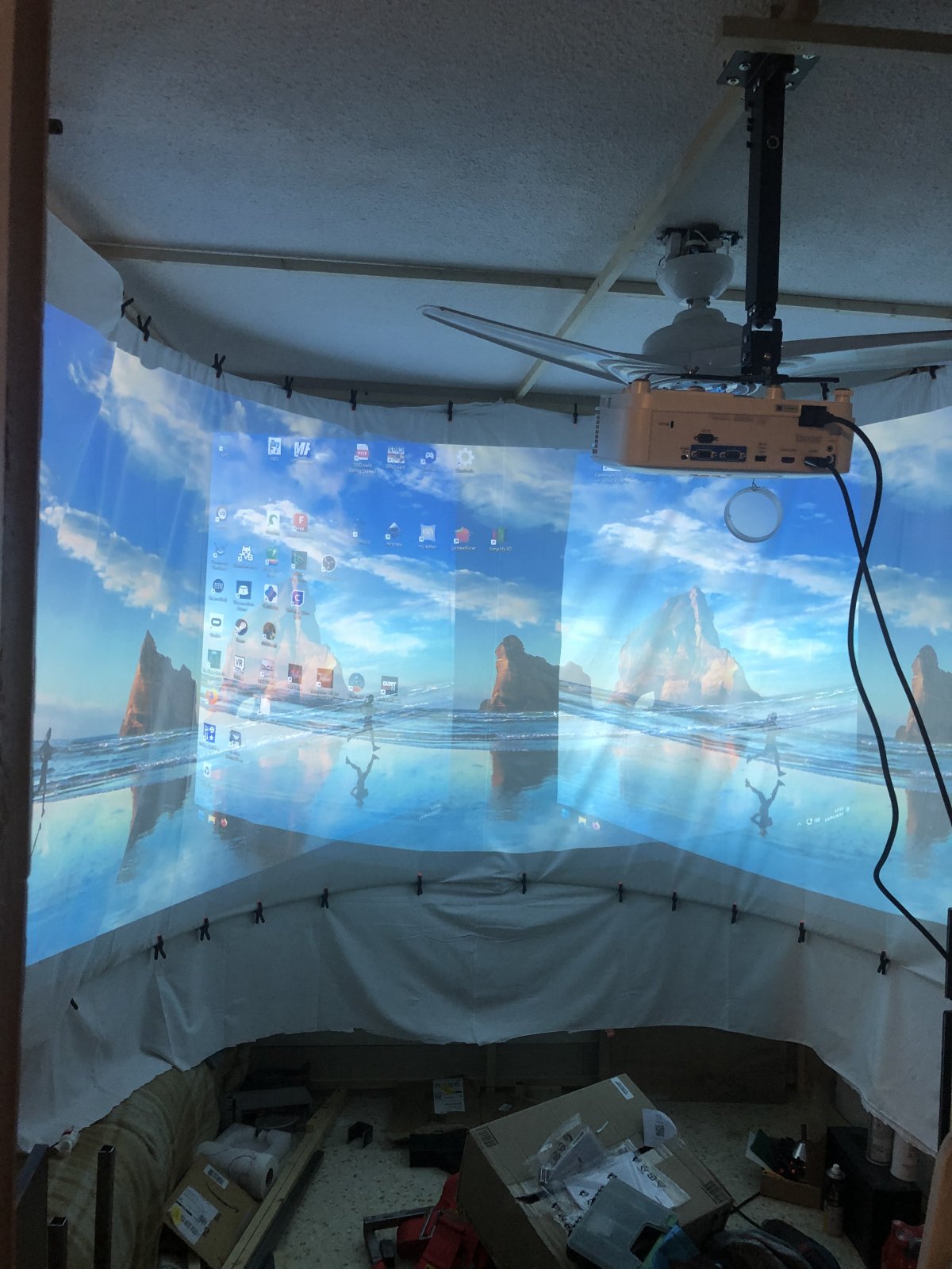

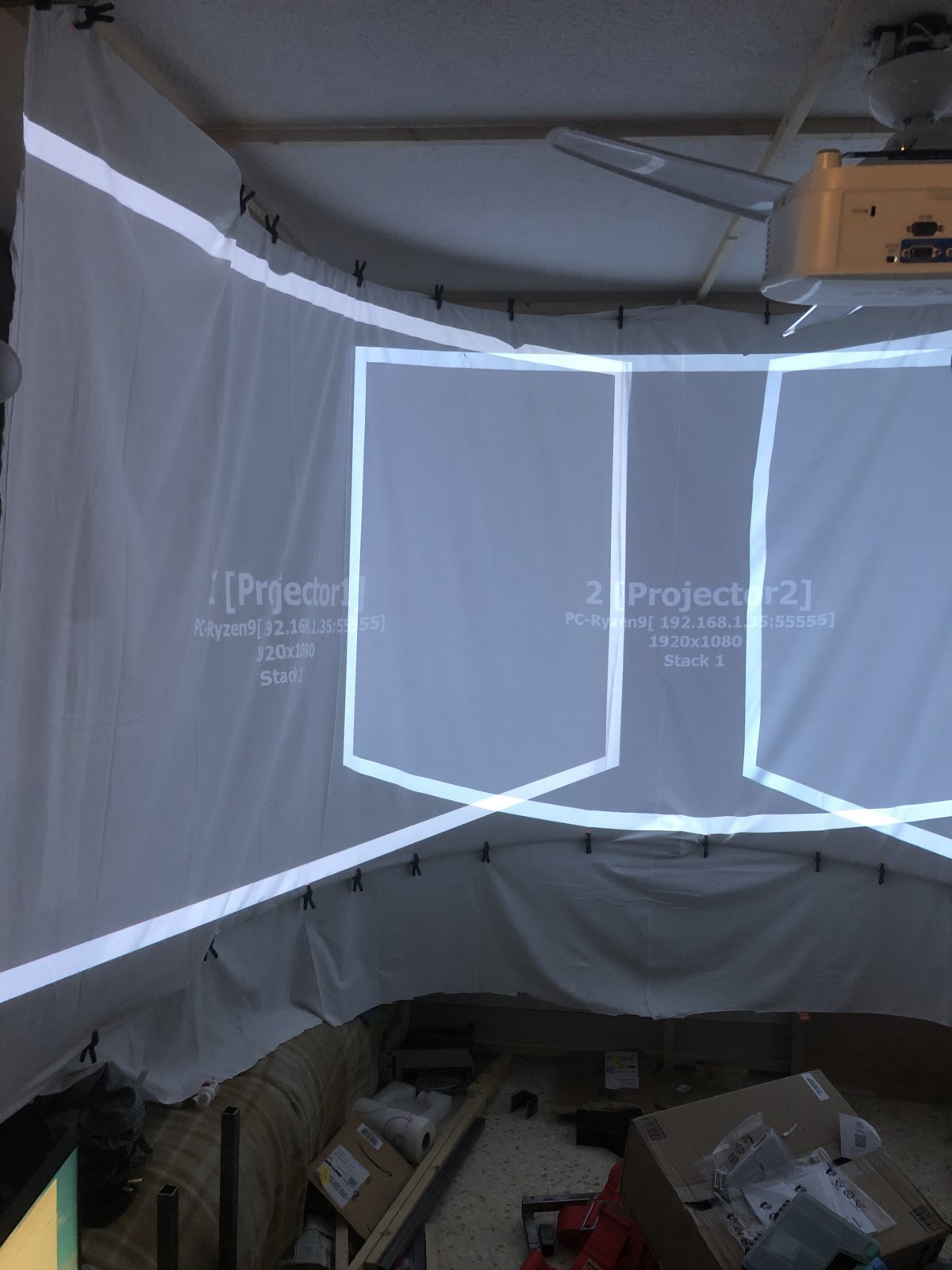

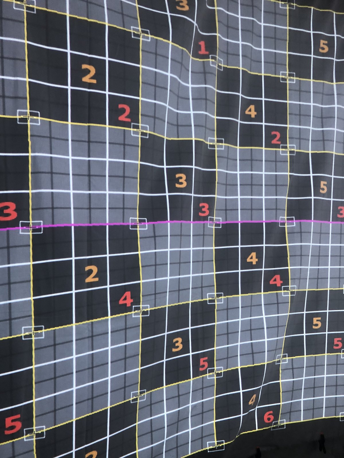

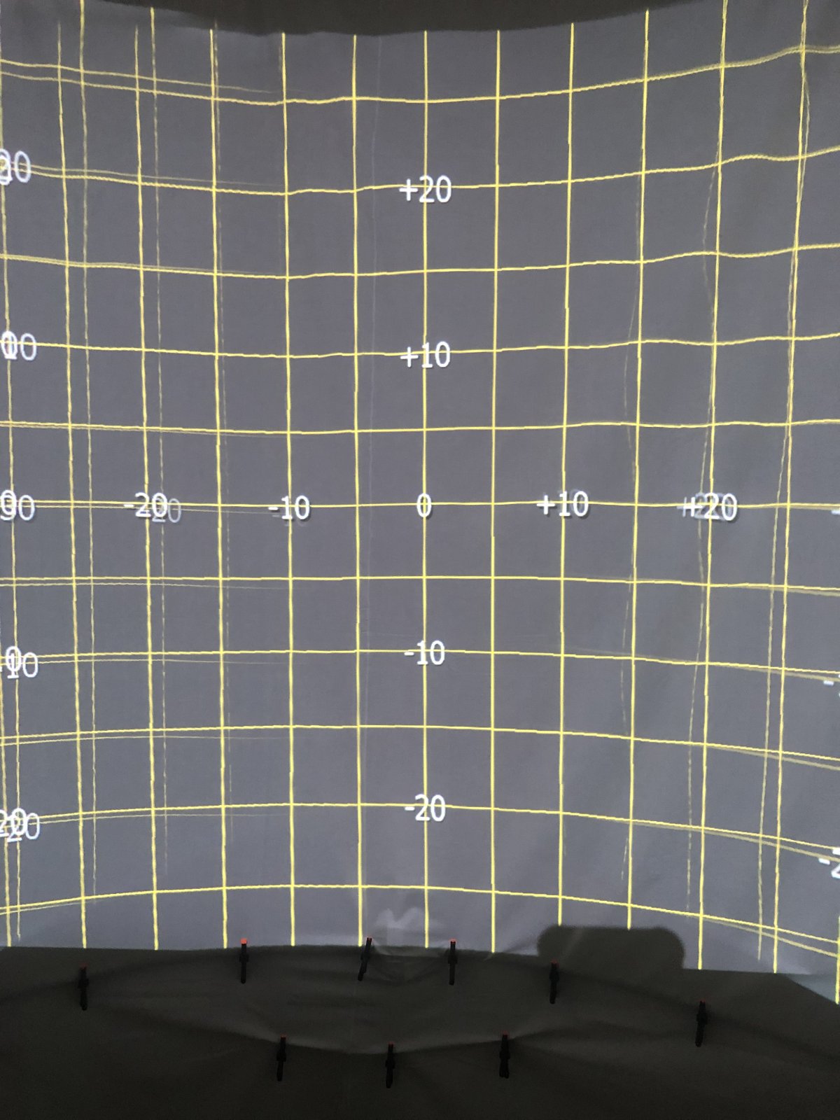

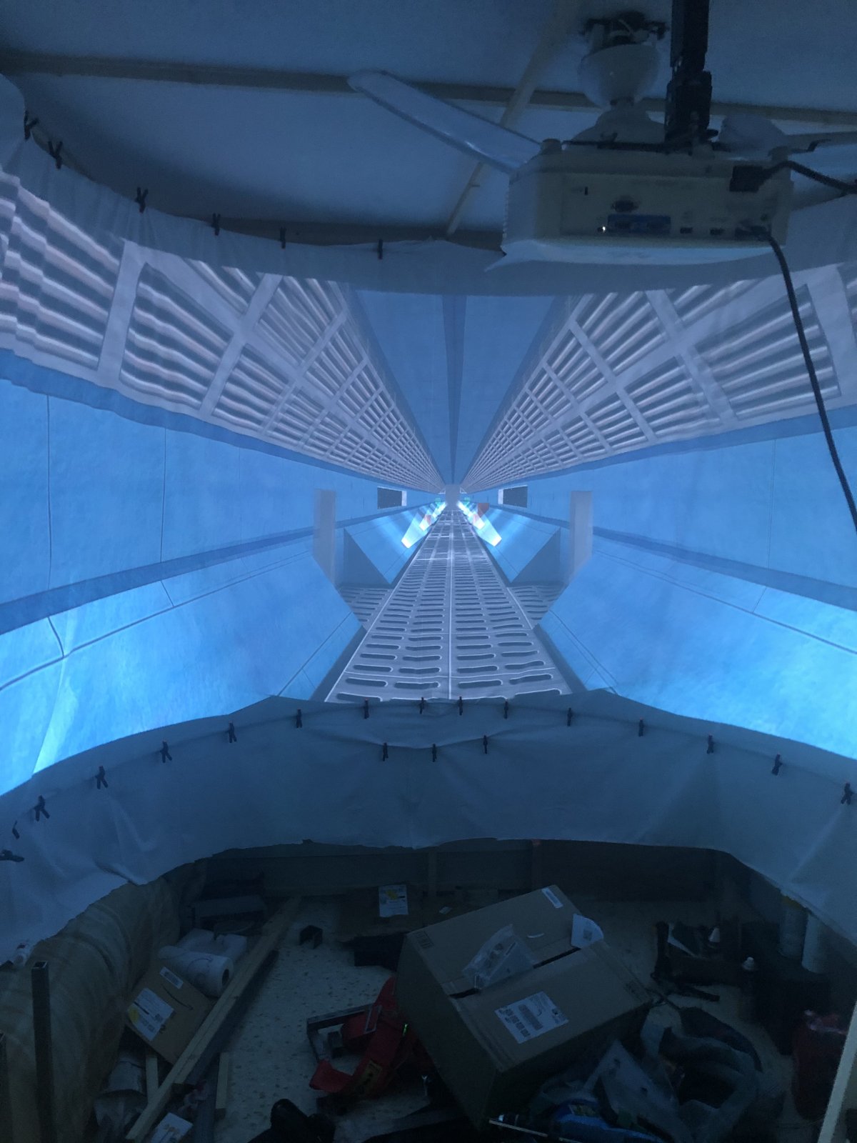

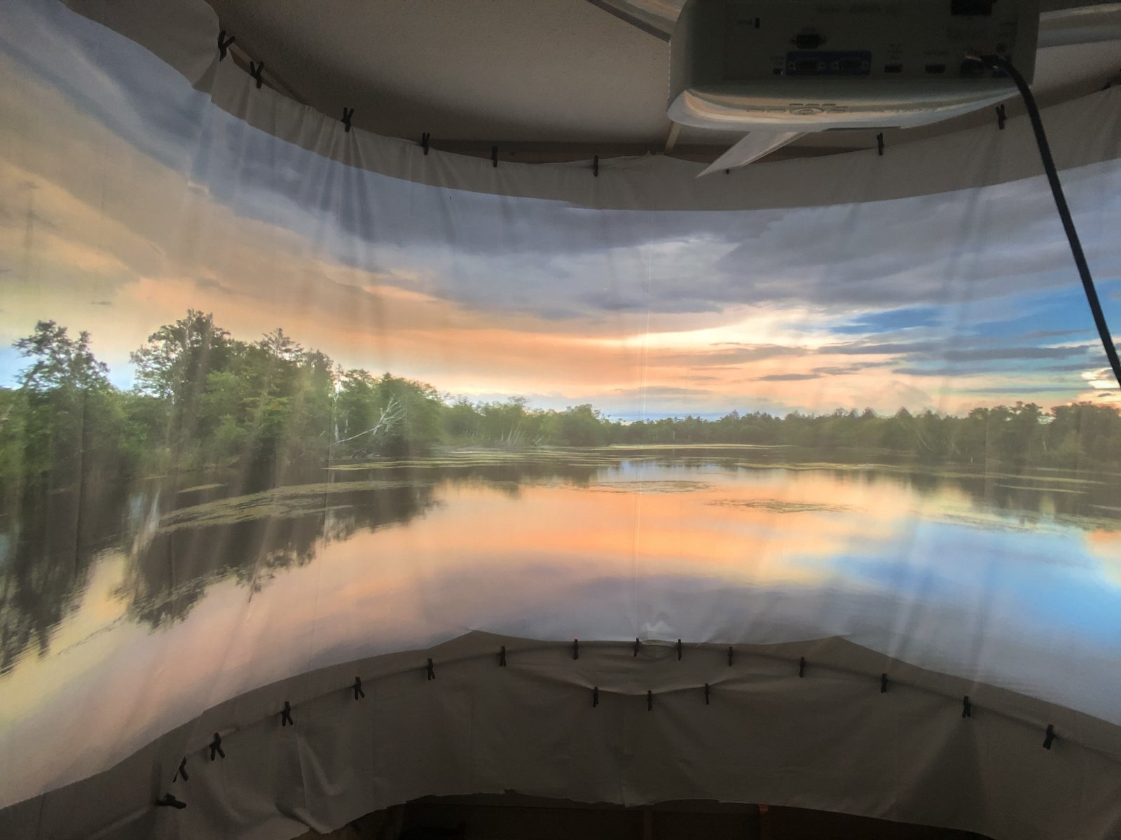

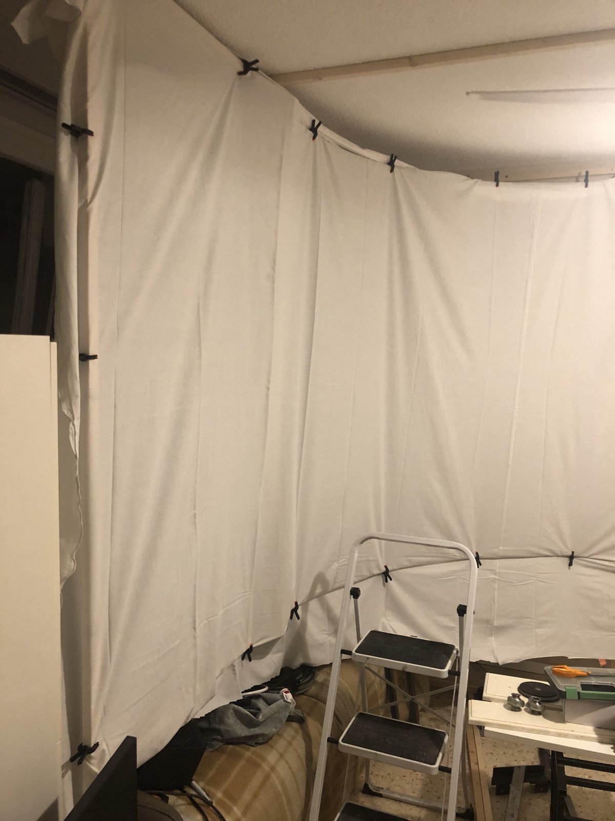

    This week, it was video test with 3 projectors
    IMG_7669.JPG IMG_7671.JPG IMG_7708.JPG IMG_7709.JPG IMG_7718.JPG IMG_7723.JPG IMG_7725.JPG IMG_7727.JPG

    No, it's being tested because I don't know the height. It's just a white sheet hung with pins

    Will you be using a cylindrical projection in combination with a 6DOF platform? Will those projectors and projection surfaces be mounted on the platform?
    I hope so, 'cos that would be a first! Awesome!
  16. GRAP
    GRAP Member
    Nov 4, 2023
    32
    Montpellier
    214Coins
    +36 / 0 / -0
    Hi
    It is not really cylindrical but it is a half-cylinder of 2.20 m in diameter with a U on both sides of 90 cm.
    I don't have enough space in my apartment at the moment since the 3 projectors are fixed to the ceiling. I will need a gymnasium or a cathedral....

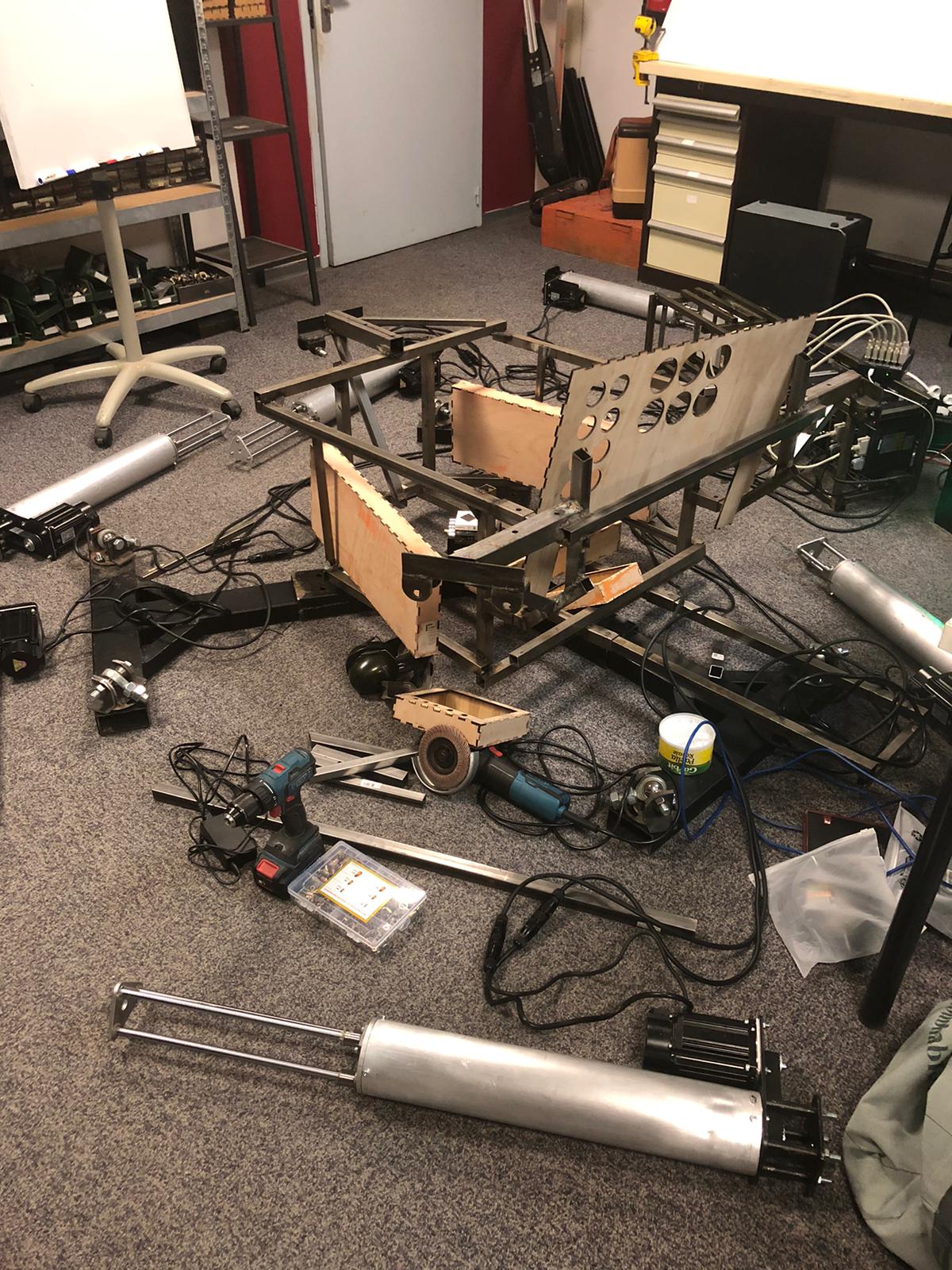

  17. GRAP
    GRAP Member
    Nov 4, 2023
    32
    Montpellier
    214Coins
    +36 / 0 / -0

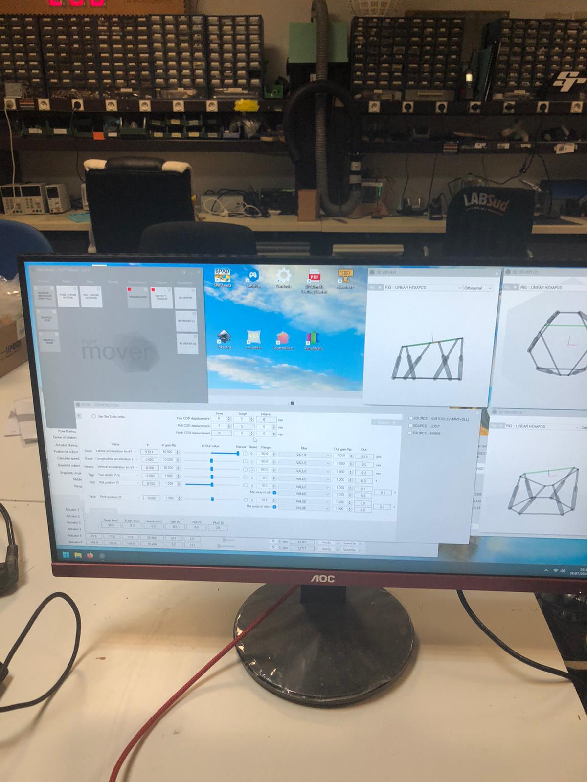

    i test the motion today and it s alive !!!!
    I dont see where to add direct video mp4 so i ll add pictures.
    WhatsApp Image 2024-07-26 à 03.15.06_4df977ef.jpg WhatsApp Image 2024-07-27 à 02.06.19_6a0e1d0a.jpg WhatsApp Image 2024-07-27 à 02.06.19_de5b2b59.jpg WhatsApp Image 2024-07-27 à 02.06.20_8e222c5d.jpg
    Next, i ll test 1 transducteur and 1 double fan for the wind.

    Fist test with one humman ....
  20. GRAP
    GRAP Member
    Nov 4, 2023
    32
    Montpellier
    214Coins
    +36 / 0 / -0
    IMG-20240810-WA0001.jpg IMG-20240810-WA0002.jpg IMG-20240810-WA0003.jpg IMG-20240810-WA0005.jpg IMG-20240810-WA0006.jpg IMG-20240810-WA0007.jpg IMG-20240810-WA0009.jpg IMG-20240810-WA0012.jpg IMG-20240810-WA0013.jpg IMG-20240810-WA0015.jpg IMG-20240810-WA0016.jpg IMG-20240810-WA0019.jpg
    Time to build the simpit inside.
