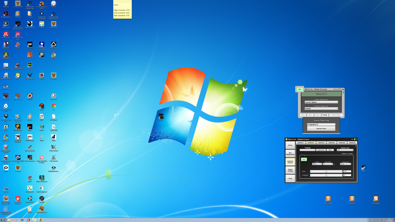

  3. chris1962
    chris1962 New Member
    Feb 17, 2015
    14
    325Coins
    3DOF, SCN5

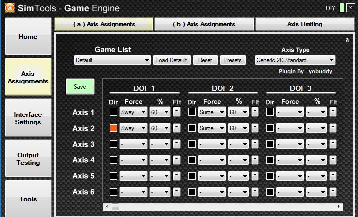

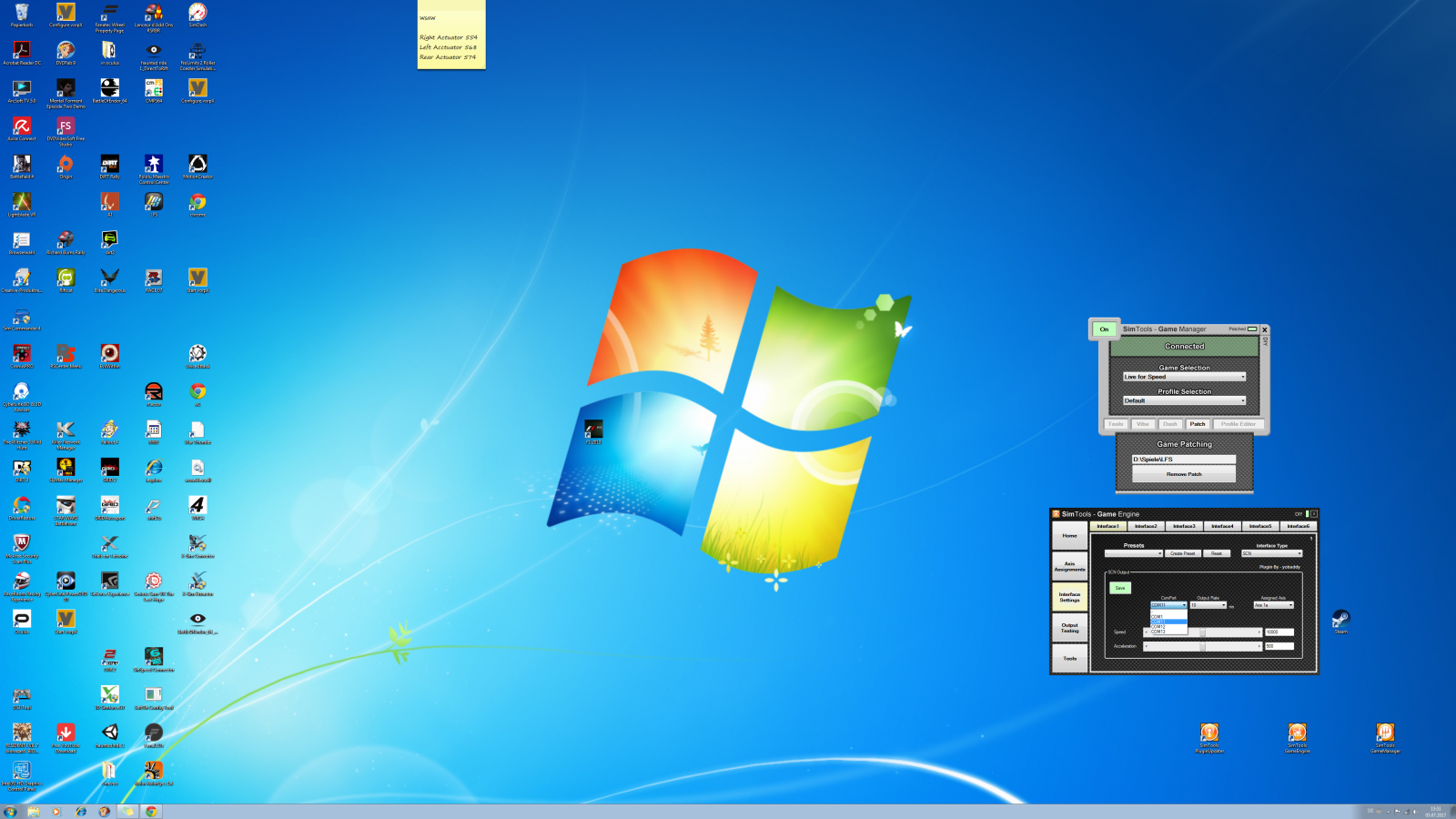

    here are the screenshots from Game Engine and Manager.
    Many thanks in advance for help
  4. yobuddy
    5,133
    47,902Coins
    +5,027 / 16 / -0
    Its a bit small buddy, I can't really see what's going on, sorry man.
  5. chris1962
    Feb 17, 2015
    14
    325Coins
    3DOF, SCN5
    oh, sorry. It is indeed very smal. I will post it again a little bit better.
    Best regards.
    Chris

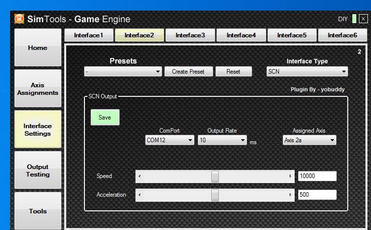

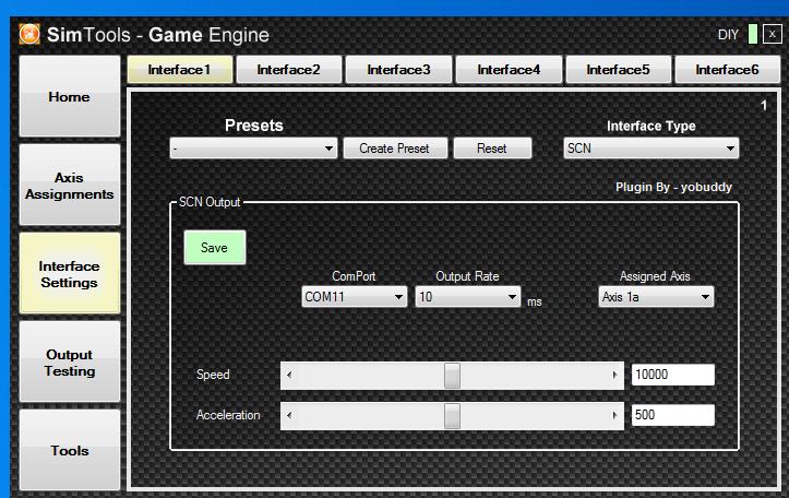

  6. chris1962
    Feb 17, 2015
    14
    325Coins
    3DOF, SCN5
    Hi again,
    her some better picture hoprfully
    cheers Chris
  7. yobuddy
    5,133
    47,902Coins
    +5,027 / 16 / -0
    The scn driver only works for com ports under 10.
    That's the problem buddy.
    Use the device manager to give them both com ports under 10, and you should be golden!
    let me know if you need help with that buddy.
