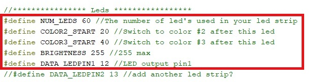

    Once the file is opened, be sure to set the settings below.
    - the number of led's in your led strip.
    - when color#2 starts
    - when color#3 starts
    - max brightness of your led strip (255 is max)
    - the pin number for the led strip to connect to.
    And you can edit the 3 colors you want to use in your strip here
    (It's RGB values where 255 is max and 0 if off)
    Then upload it to the Arduino you are golden!

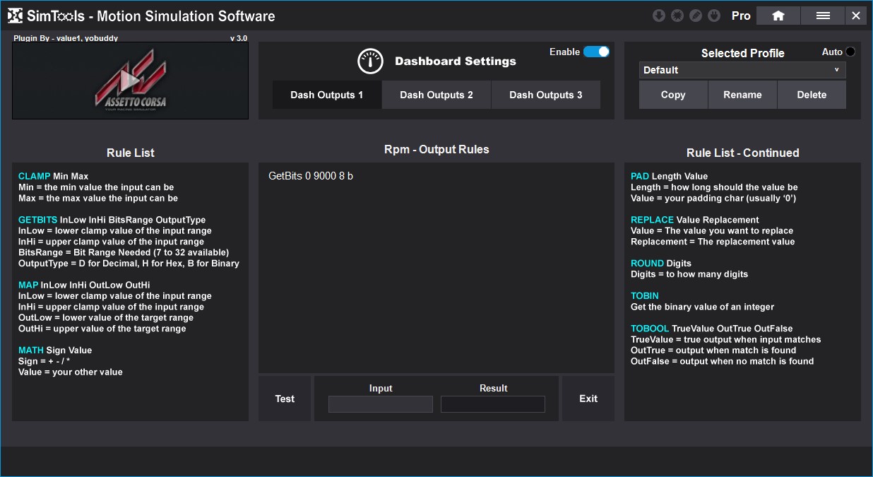

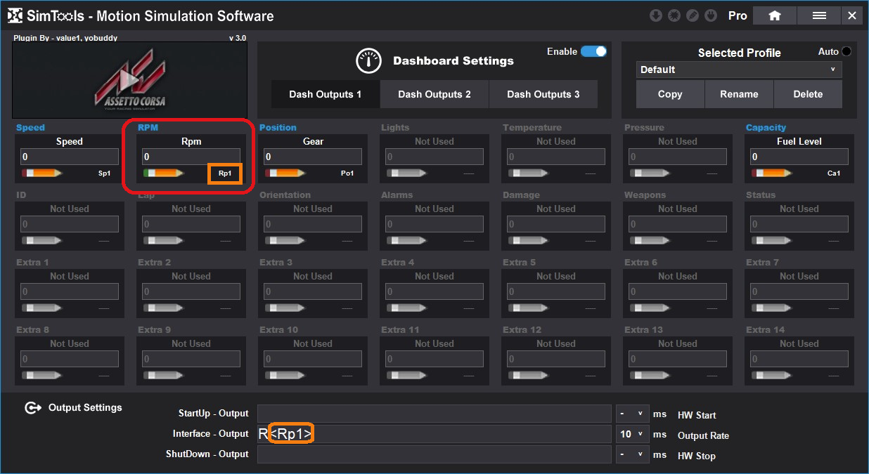

    SimTools v3 setup.
    Go to the interface settings and connect your new led bar
    Then go to the edits for rpm and set the command GetBits 0 9000 8 b, where 9000 is the max rpm you want to use for the profile.
    And lastly, tell SimTools what to send for output
    That's it, now run the game and enjoy!

    What values do I have to change ?
    I have led strip with 72 leds, Using RaceRoom game. When I start the game 12 leds (all green) lit up. More rpm the blue light up (20 leds are green, and after 20 blue leds lit up and then red lit-up max 6 red leds.
    so the maximum number of leds that lit up is 46 while I ave 72 leds :)
    I want default 3 leds on, then with higher rpm 25 green on, than 30 blue and than 17 red when rpm is max.
    thanks for any help on this

    If you have set the proper settings in the sketch here:
    if you still don't get all led's on, take a look at the Hi/Low settings for rpm for the game.
    My guess is the Hi values is to Hi is all.
    Let me know how it goes buddy!

    thanks for the tip
    I have Race Room Experience and used this settings: Getbits 1550 5500 8 b. The ledstrip works great now. By default 1 led is on and with full RPM all 72 leds lit up.

    Hi @yobuddy , Thanks for this example. I am trying to use the same settings I had in Dash for Simtools 2.x in the MSFS2020 plugin that drives a force feedback actuator (based on airspeed) and a wind generator (based on RPM) in the Dash for Simtools v.3 for the MSFS2024 plugin.
    The FS2020 version relied on the converting of the return to HEX. This code is no longer accepted in the V3 FS2024 by the looks of it? So in the Output Rules it does not accept the TOHEX statement. What code should be used now please?
  13. yobuddy
    51,392Coins
    +5,202 / 19 / -0
    @RJ Stausebach,
    I will take a look, and make sure ToHex is in the next release.
    For now I believe you can use: GetBits 0 255 8 H

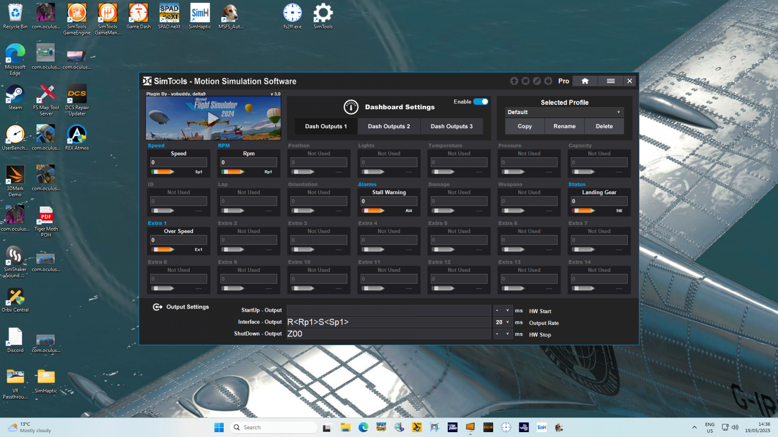

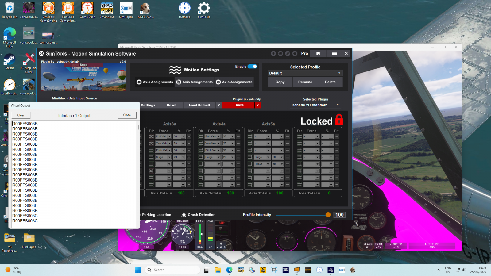

    +13 / 0 / -0
    Hi @yobuddy , so gave it a try. That did not work. Let me qualify, the Airspeed (still) works (it worked before without the Hex code). The RPM still does not work. I suspect that the MSFS2024 plugin may not be identifying the RPM correctly? I am looking for the Prop 1 RPM. It worked in the MSFS2020 plugin. For the MSFS2024 plugin you do not specify what RPM it is looking at?
    At 8 bits the 255 is not enough to cover the expected 3000rpm range, I can see that using 16 bits my max RPM is showing around 32000. So it is picking up something but not sure what. My range, converted to Hex, would need to be between 0 and 3000. What coding would achieve this?
    Thanks,
    Roel
    ps. the Virtual Output confirms that speed is being read and RPM maxes out at 255.

    This is the screenshot for virtual window

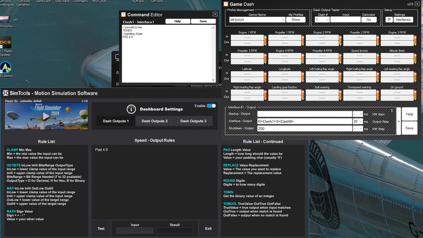

    The 2024 plugin is using RPM 1 for the input.
    Code:
      MFS2024_simconnect.AddToDataDefinition(DEFINITIONS.Struct1, "PROP RPM:1", "Rpm", SIMCONNECT_DATATYPE.FLOAT32, 0!, 10)
    I finished adding ToHex to the dash output commands this weekend. I have a few more things to do and will then push the update out (probably later in the week).
    Take care! :thumbs
